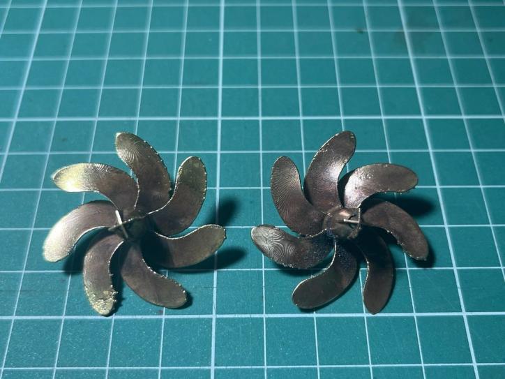

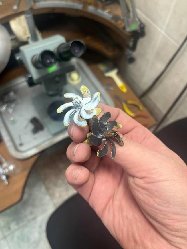

    By the way, casting jewelry in gold or silver is actually easier than casting a complex model like this.
    This model contains several mistakes, starting from step one and continuing through other stages of the process. I will point them out and explain them to you.
    I hope you will find it informative and educational.
