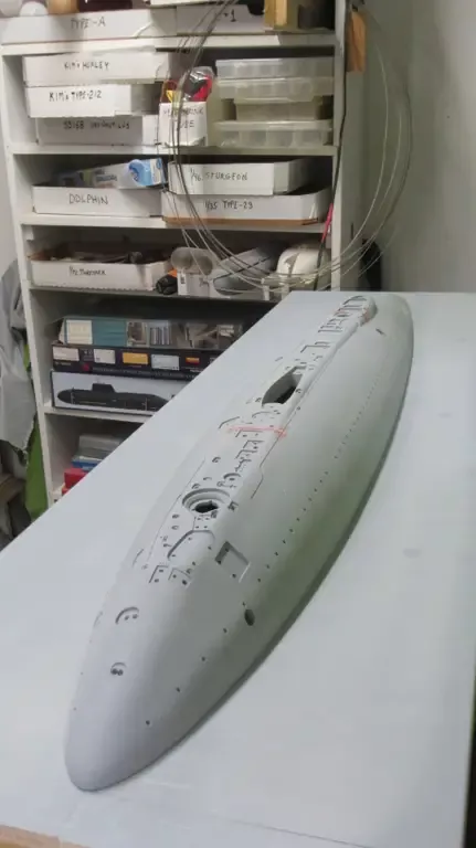

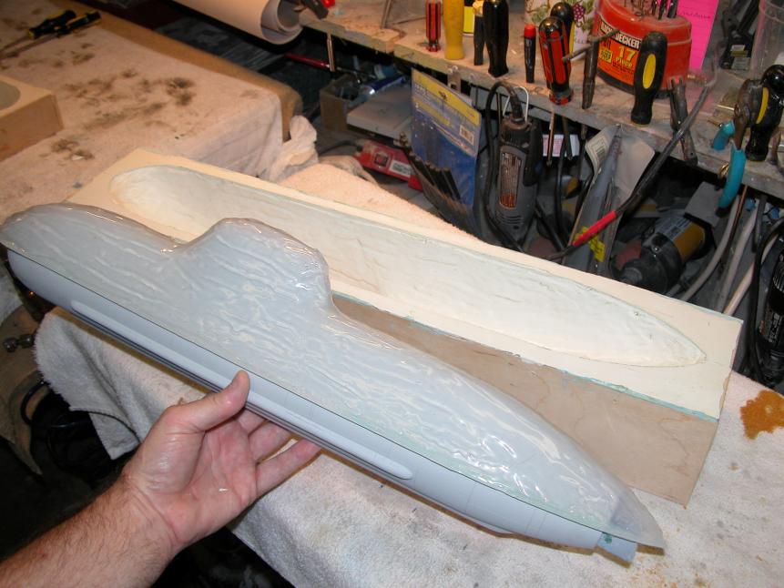

              Is that brass tool acting as a broach or a former/shape to fill around?
                • 14014
                #3682
                A former to retain the square outline of the limber holes as I compact blanking clay to form. The master limber holes were pass-throughs and had to be partially blanked off so the tool making rubber would not leak through.

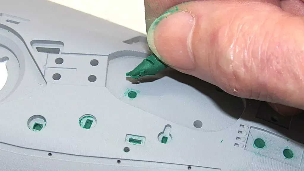

                            From the neophyte bleachers: David, what is the green stuff please? Thanks.
                              • 14014
                              #3689
                              Plasticene oil-based clay. There to keep the rubber (while in the freshly poured liquid state) from running through open holes and into the interior of the master.
