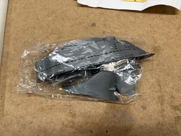

            David, is this XXI you posted the same as this one below? Was going to ask you in email but since you posting those pics.

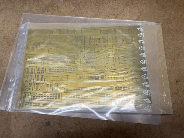

                OK thanks. The one that I have. It's like Skip's Marlin. Styrene with no details on the styrene. Will require lots and lots of scribing to make it look like something more realistic, weld lines etc. Although it has the photo etch which I have not work with before. I think Bob said the kit is from someone in Czech area or someplace around there in Europe? It would be a real challenge to make something of it. Should I accept the challenge in your opinion, or not? If I did it would be on the shelf for a very long while until I finish many many other projects that I have lined up.

                  It would be a departure from you usual plank-on-frame work, Ken. Do it for the change of pace; one of those shelf-queens you never finish but play with occasionally. You did the MARLIN, so you know what horrors await you with that kit. I would double check the scale of the PE parts before getting too invested though.
