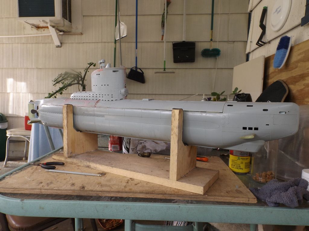

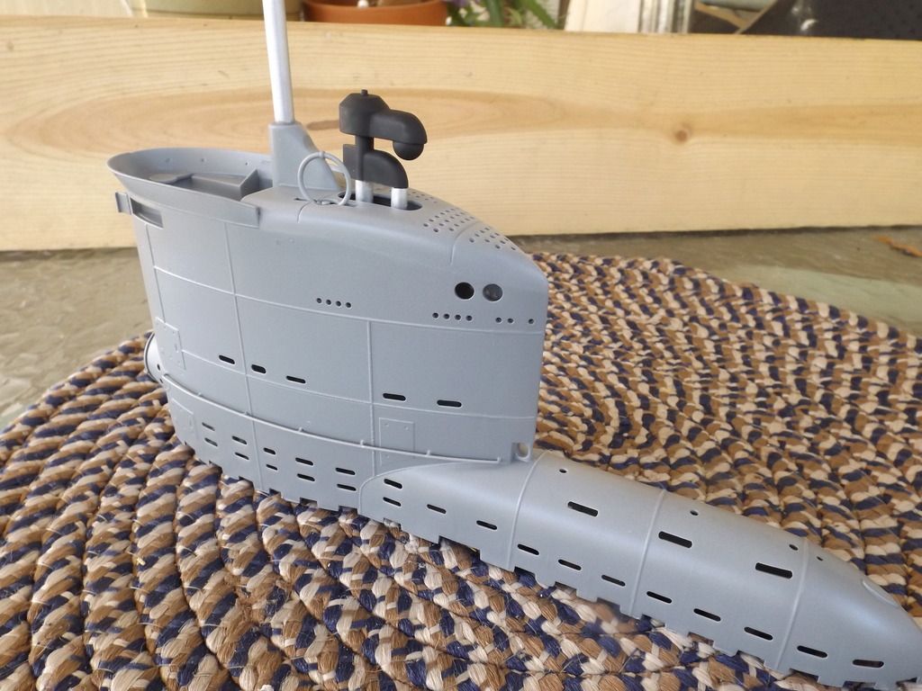

                    So today I spent some time getting her ready for paint. Sandpaper and body filler..........and more sandpaper. I got the upper hull and sail/conning tower painted first a grey primer and within 15 mins. I went back over them with Smoke Grey to represent the light grey color that my paint scheme calls for. I spent some time finishing up the sail by installing all the hand rails and doing some body filler touch up.
                    As far as the lower hull is concerned it will be painted a darkened Charcoal grey. But before I can do that Ill need to complete the finish work on it.

                        Today I was able to devote a few hours to it. Scuff sanding the whole thing as well as working on a few problem areas. I hope to get some paint on the bottom hull tomorrow.
                          #192
                          Looks like tomorrow was last year. I did get some Dark Grey on the bottom hull. I had to make it, blending light grey with a dark grey(which was too dark) to achieve the desired color. I spent a lot of time filing and sanding all the seams which for some reason seemed to have a slight mismatch, even though I put the pin in the hole during assm. Also, to my embarrassment, something got on the hull in storage, that melted the Evercoat and ran down the side. It didnt hurt the plastic, but whatever it was didnt like the body filler. It smelled like Turpentine or something like that. So I had to reapply evercoat to address what was melted. I got a good primer coat on and the paint came out very well. I still have to tape off and paint the white stripes and then put on some clear flat. Keep in Touch.

                              Im looking at the height of this scope and am saying to myself. Its way too high. Then it occurred to me that this is a little submarine, as evidenced by the large diameter of the scope mast. So I guess it looks ok. I wonder if the Bronco people are going to come out with another large submarine? I hate those little 1/400 models that have flooded the market.

                                Nice work Mark, you''re getting there, as for the scope, the lenght had to be that long because of the schnorkelmast, with the scope you just can see over the schnorkelhead, during underwater travel they tend to go up and down, in real live there was a kind of mechanical levelkeeper onboard, it wasn't that accurate, so the boat went up and down within a few meters, when your scope is too short, the conningtower will break through the surface, a captains nightmare.
                                Correct me if i'm wrong, but the germans used 7 or 9 meter long peroscopes, depending on which boat, on my type VII they are 9 meters long.
