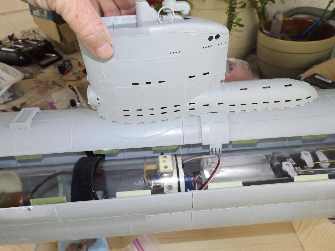

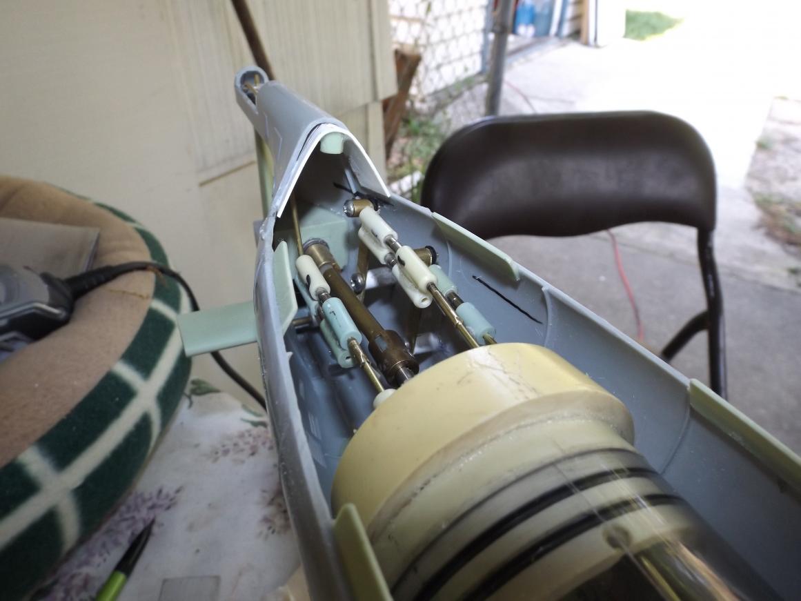

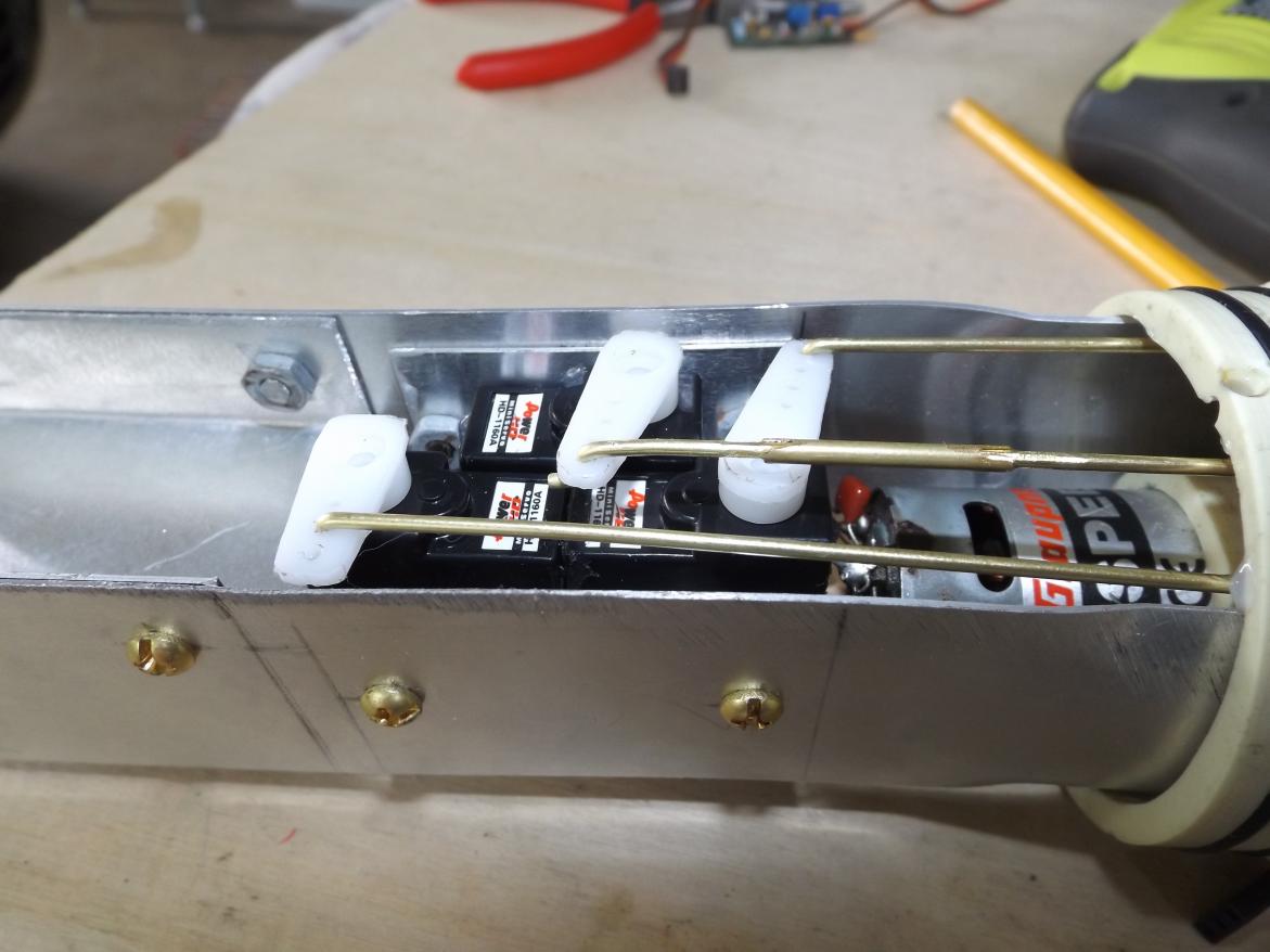

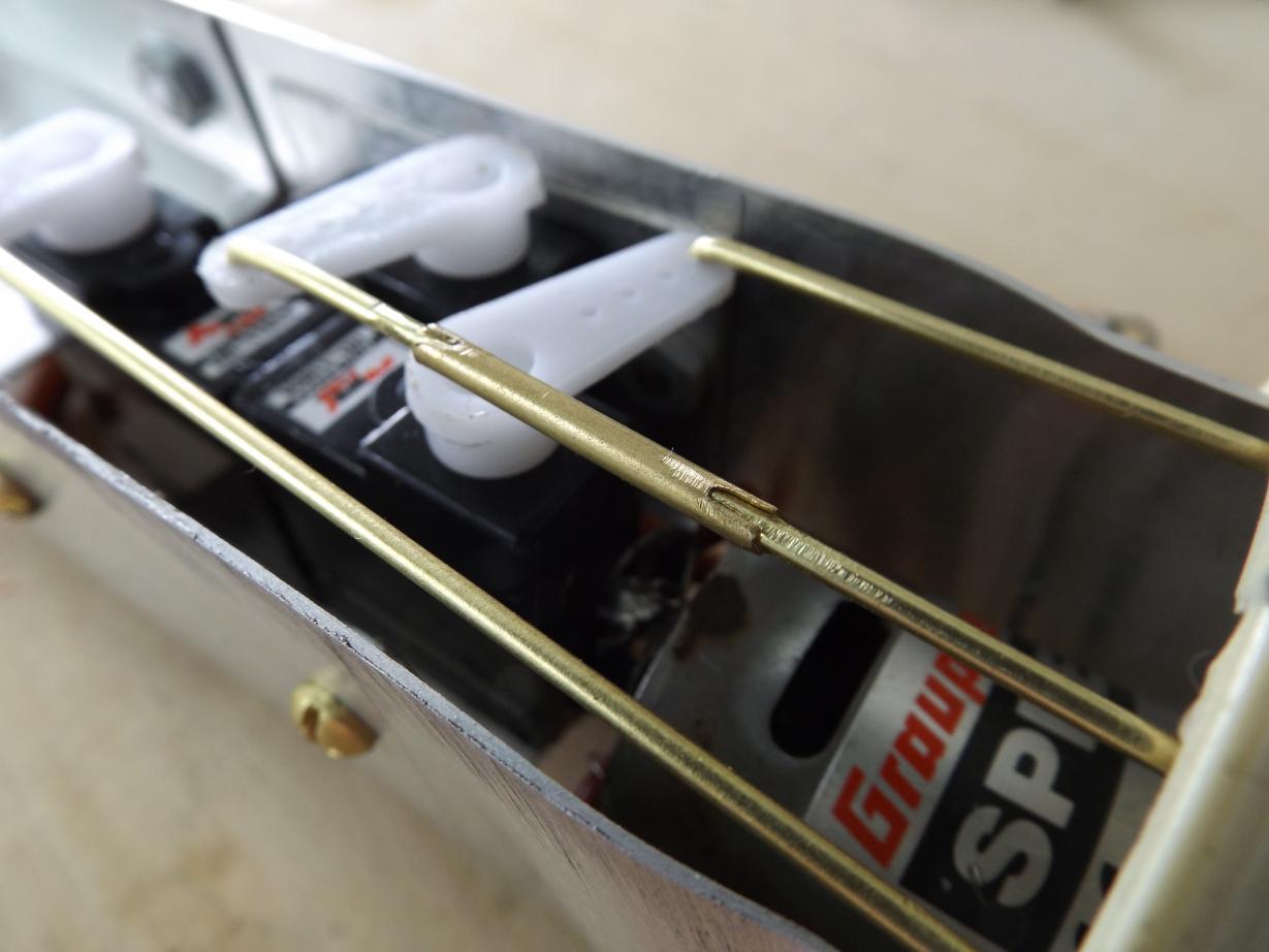

My servo installation. Odd arrangement but it serves well and lines up nice. The servos are either all the way to one side or in the middle so that a good amount of space for wires to pass by on the one side. Unfortunately one of these servos turned out to be bad right out of the package. Caswell offered to replace it at no charge. As far as the servo pushrods are concerned Ive always had difficulty trying to get them just the right length without having to try again and again. What I have done is to make them up in two pieces. At both ends put them where they are supposed to be, all lined up with the radio on, trims in nuetral, control surfaces where they are supposed to be. I join the two pieces together with a 1/16" I.D. piece of brass tube with a slot cut in both ends and the 1/16" brass rods roughed up with a dremel cutoff wheel to give them good texture. When all is good, hit them with the real thin CA and watch it soak up inside the tube.

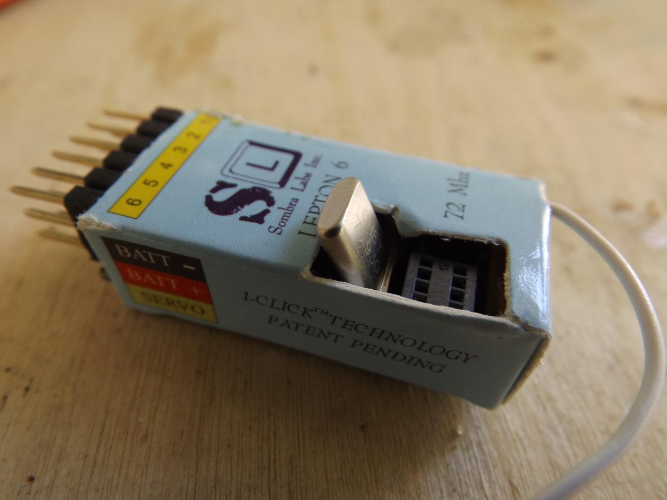

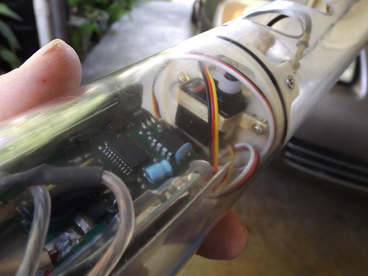

OK now, I got in the crystal for the Lepton receiver. Thats really weird. You would think that the pins for the crystal would sink all the way down into the circuit board ,just like every other one Ive ever dealt with. But NO! It goes in maybe a 1/16" and stops. I kept pushing and bent the pins of the crystal, but it works. Ive got two of the receivers and two of the crystals, and its the same for both. WEIRDIT TAKES GREAT INTELLIGENCE TO FAKE SUCH STUPIDITY!Comment

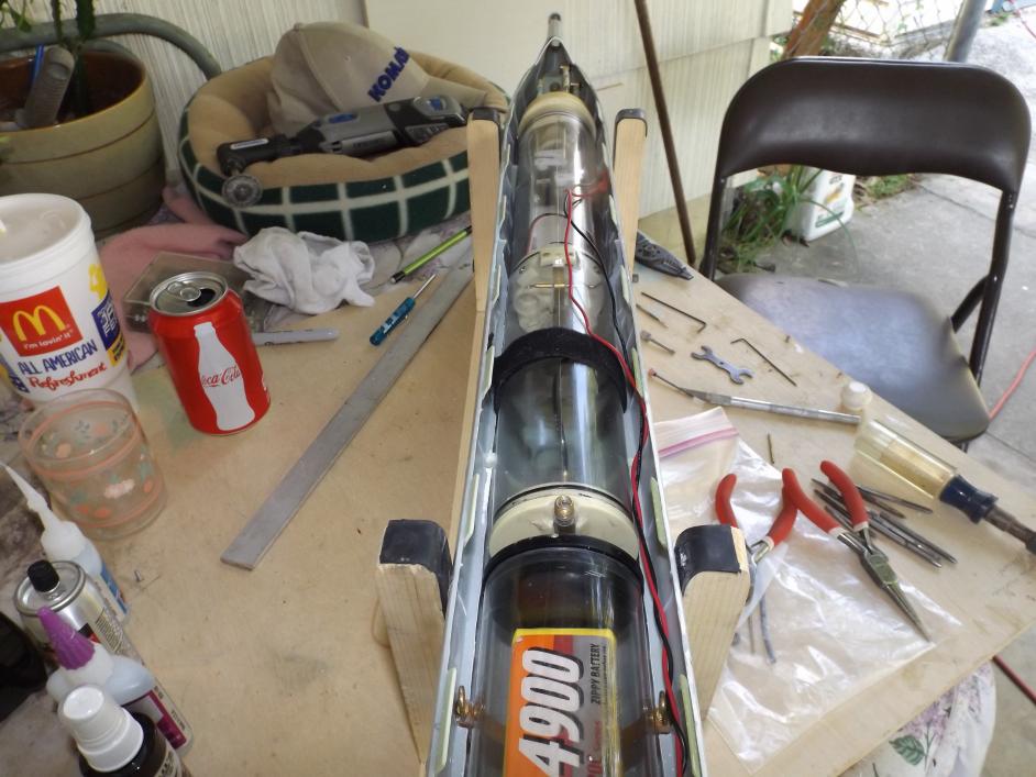

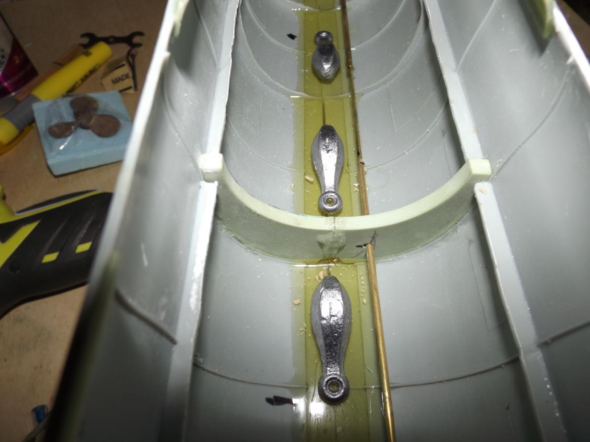

Everything is coming together real good.Im using 1 ounce fishing weights to get some weight into her to start with. Ill use the flat ones that I always use in 1/4 ounce increments for trimming.
All the double magnets in place.

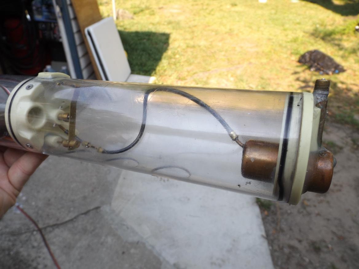

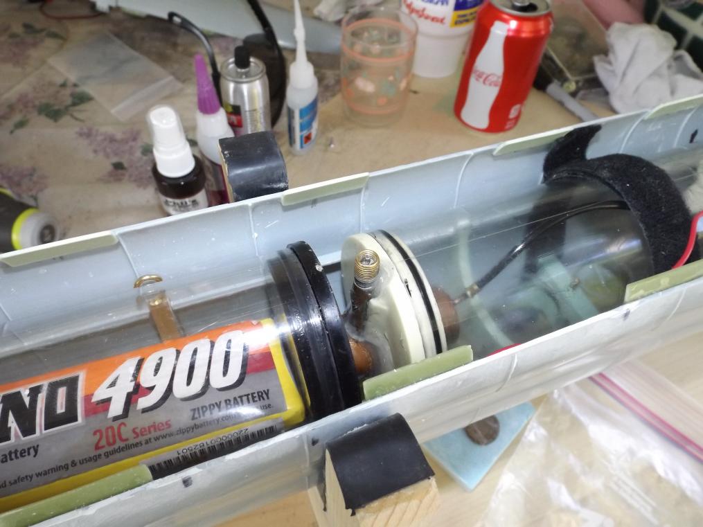

Here we can see the placement front to rear of the ballast tank. The vent valve is pretty close to the center of the sail. The center of the ballast tank is about 3/4" behind the present balance point of the sub. We will have to see how this works out.
Now that I got my supply of Clippard hose in Ive finished the ballast tank. READY FOR TESTING.

Funny you should mention the crystal pin "thing"!! I had the exact same problem!
I ran, very carefully, a very small diameter drill bit into the sockets which helped a little,
but didn't want to get too carried away for fear of screwin' up the Lepton!! Very strange
design glitch, there!!
Really like the keel weights!! Great call!! Gotta file that one away for future reference!!

Rainy today, so it was kinda low key around here. Started fooling around with this thing and the servos would just sit there and jitter. I dont like that. Only one of them was doing it the other day and I replaced that one. Since then all was good until today. So I tried a different BEC. Still the same. So I tried a different crystal which meant changing the frequency. LOW AND BEHOLD!!!...............that was it. Channel 87 was very noisy today....apparently, so channel 89 I guess will be it.
I had to resort to grinding down the crystal pins with a Dremel wheel, to taper them, so that they go in well. I then put some good vinyl electrical tape over it so that it cant come out. The silicone holding the receiver in place is drying. Tomorrow Ill get the APC into place and then all thats left is trimming in the bathtub.IT TAKES GREAT INTELLIGENCE TO FAKE SUCH STUPIDITY!Comment

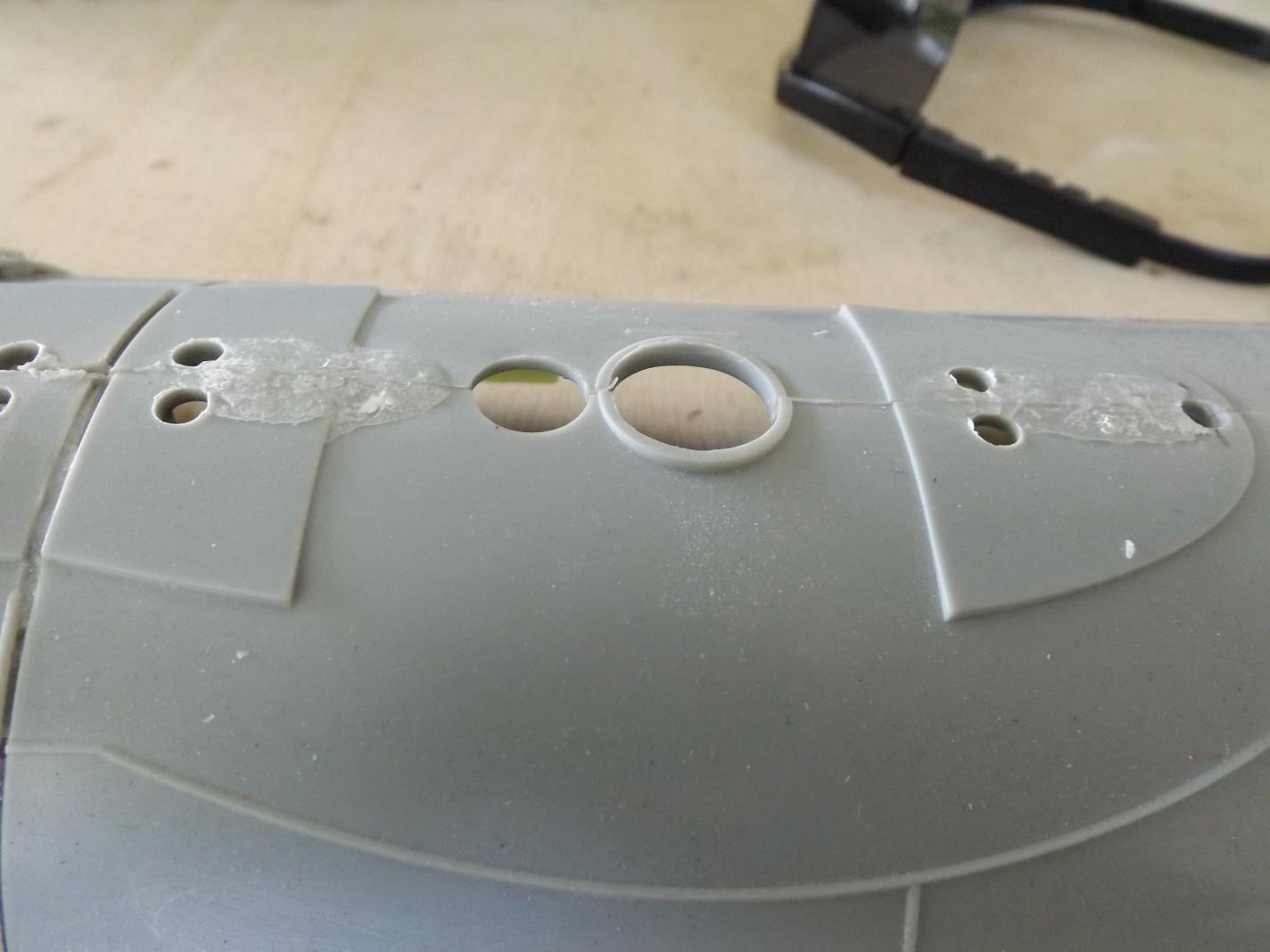

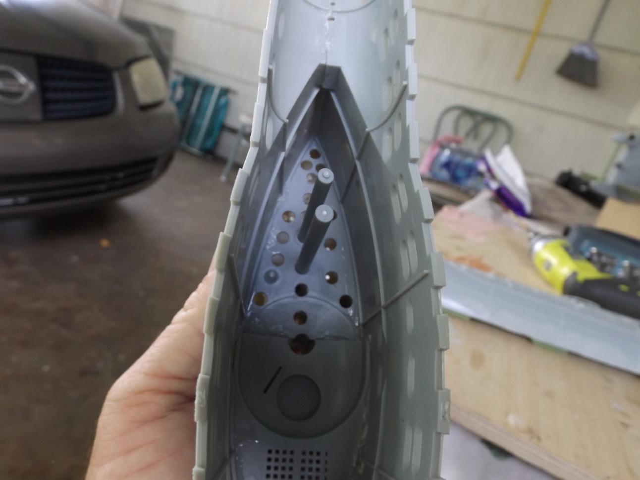

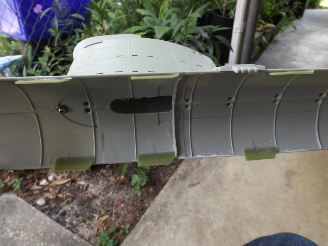

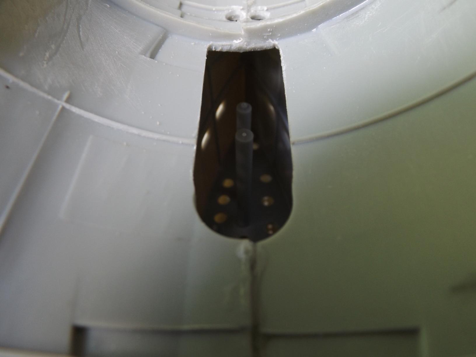

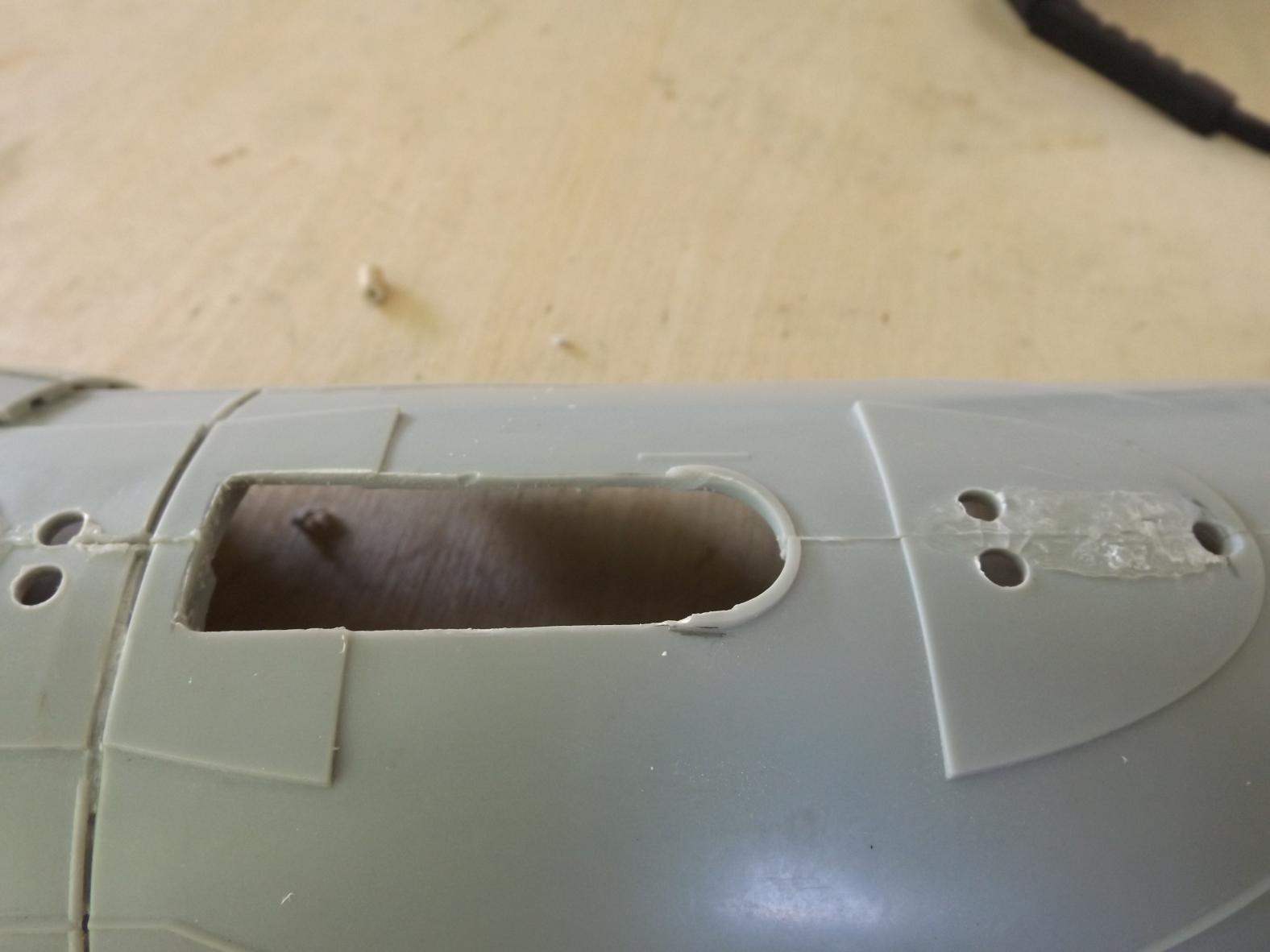

A few more mods to keep bubbles from building up in the conning tower. I didnt want to take out too much material and weaken the upper portion of the hull. Afterall, its got a lot of tabs on it to help hold and pull everything together, donchano. I also drilled a bunch more holes in the lower platform of the Conning tower too. Also , the Garage Sale/3"/2&1/2"/mark 1/heavy mod/ Subdriver is all together and ready for the bathtub. The gas system has been tested today and all is well with it. Tomorrow I should have the whole sub in the tub for some trim work.IT TAKES GREAT INTELLIGENCE TO FAKE SUCH STUPIDITY!Comment

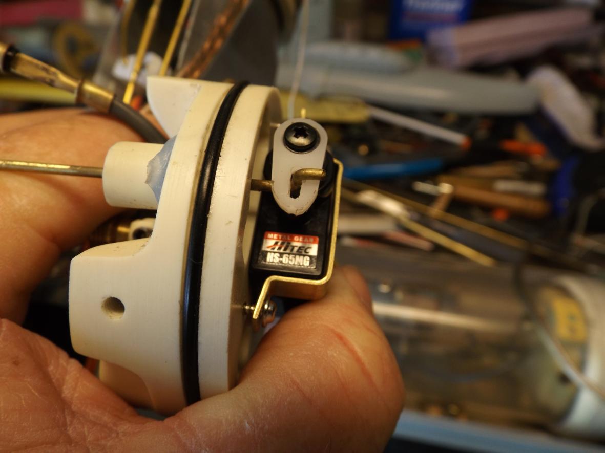

Nope, not the shaft seal. It was from a hole I cut in the bulkhead to bring a power cord in. I sealed around it with silicone seal, but it leaked anyway. However, water got in and ruined one of those little blue servos. since I already had one of them fail for reasons unknown I decided to buy a real good one. That ballast servo is all important. If it fails ............Im stuck. The new micro servo is on the way. In the meentime, today I put the second coat of the electroplating job on the prop. After the bronze plating turns a little darker in a couple of days Ill paint over it for protection using Minwax clear gloss. That should be about right.IT TAKES GREAT INTELLIGENCE TO FAKE SUCH STUPIDITY!Comment

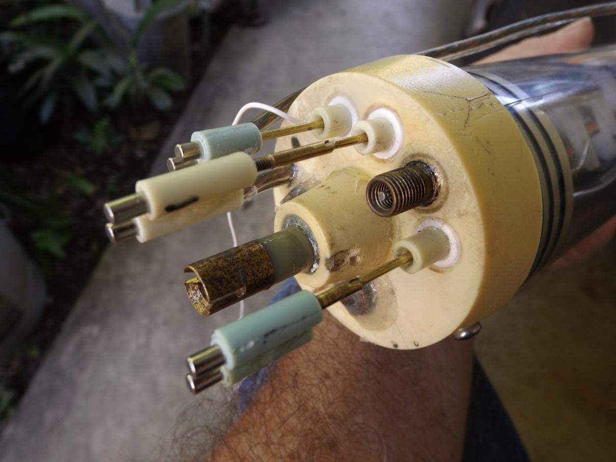

I took the liberty to install an extra drive shaft seal on the outside. Two has to be better than one, even though the first one was not leaking. I left a little room between the brass dogbone coupler and the seal so that I could get a little oil in thar. Heres the new ballast tank servo in place. Should have it at the pond on Monday for testing.IT TAKES GREAT INTELLIGENCE TO FAKE SUCH STUPIDITY!Comment
