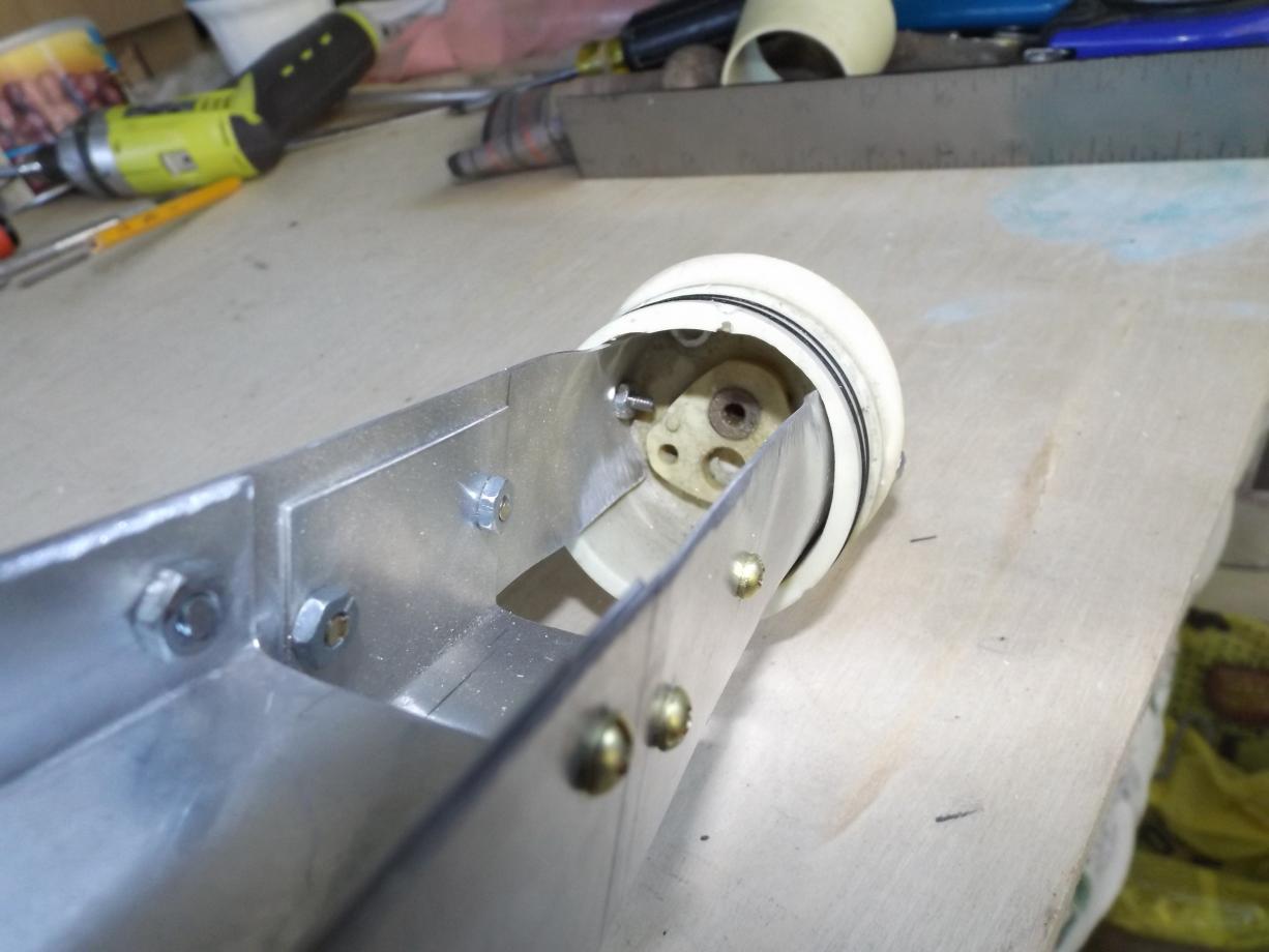

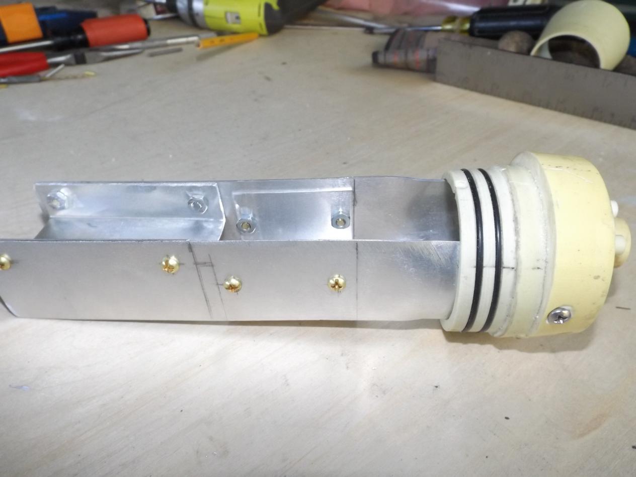

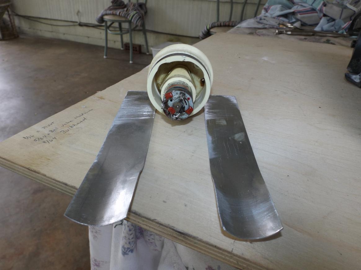

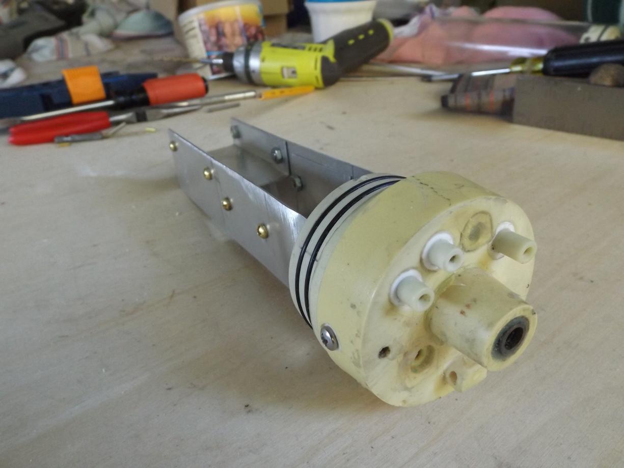

        GENTLEMEN........................and I use the term loosely. Take note............if you will ,of todays progress on this boat. If youll recall, the motor bulkhead is a conglomeration of a o-ring flange from a 2&1/2" cylinder and a gearbox, motor and housing from a 3" Albacore WTC, from the D&E era. The only way I could think of attaching alluminum sheet to build the servo trays was to cut out flat sheets 1&1/2" wide by 8" long and bend a radius in one end of them. That end would go up inside the bulkhead and be cross bolted there. Then equipment trays would be attached between them.Click image for larger version

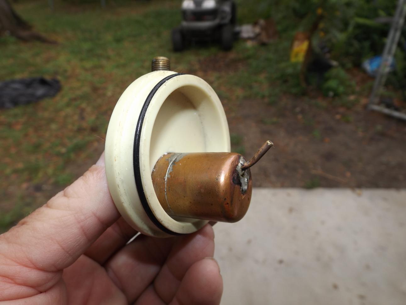

          #109
          Here we have the Propel tank siliconed into the endcap. I really like Daves departure from the normal style of Tank. Really cool!Click image for larger version

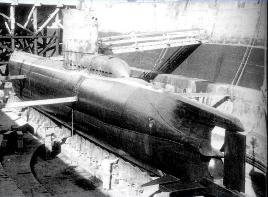

                      It was painted on a sub post war.
Name:	Type 23 Post.jpg

                          Thanks Tom, I have a larger version of that very same picture somewhere but I never noticed the stripe on it. Ill have to dig it up.
                            #118
                            Here it is:Click image for larger version
Name:	U2326 stripe zoom.jpg
ID:	90807That, however differs from the drawing in that the picture shows no light grey below the stripe as it does in the drawing.Click image for larger version

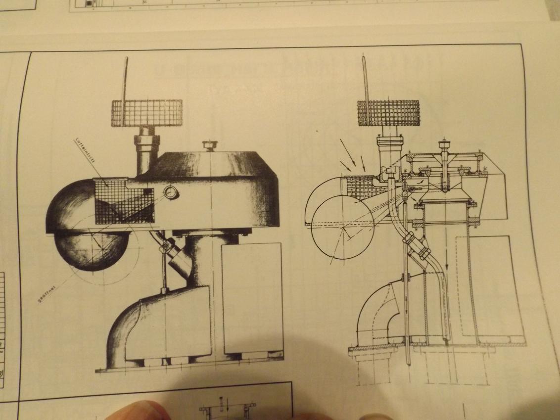

                                #120

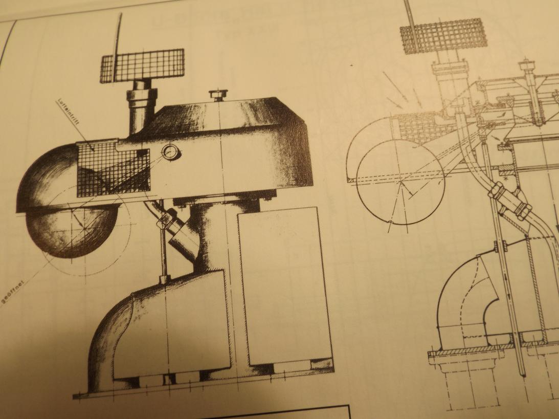

                                Your probably right about that, what I meant to say is the radar looking thingy..........thing. Heres a picture of the thingy on top of the snorkle and here is the drawing. Way too big. Itll have to come off.Click image for larger version
Name:	Fuji transfer 808.jpg
ID:	90822Click image for larger version
Name:	Fuji transfer 766.jpg
ID:	90823Click image for larger version
ID:	90824Although this is on a different type of Uboat I think that its the same Gizmo as far as relative size is concerned.
