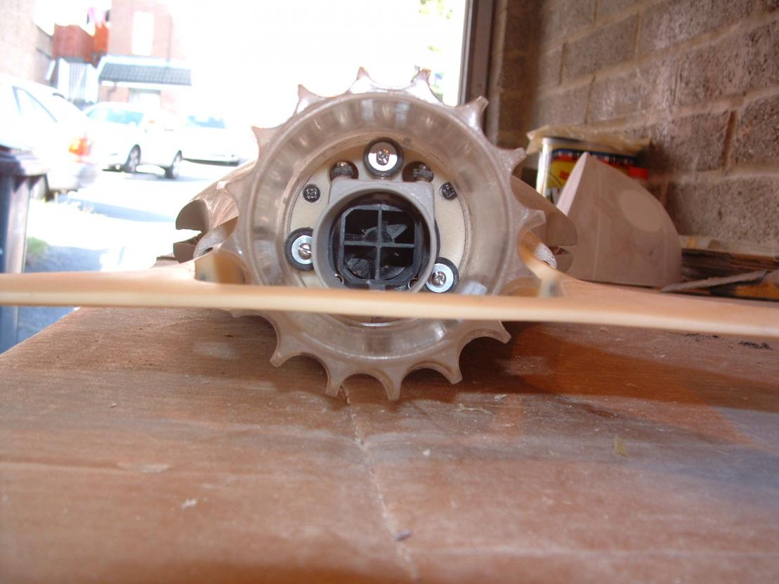

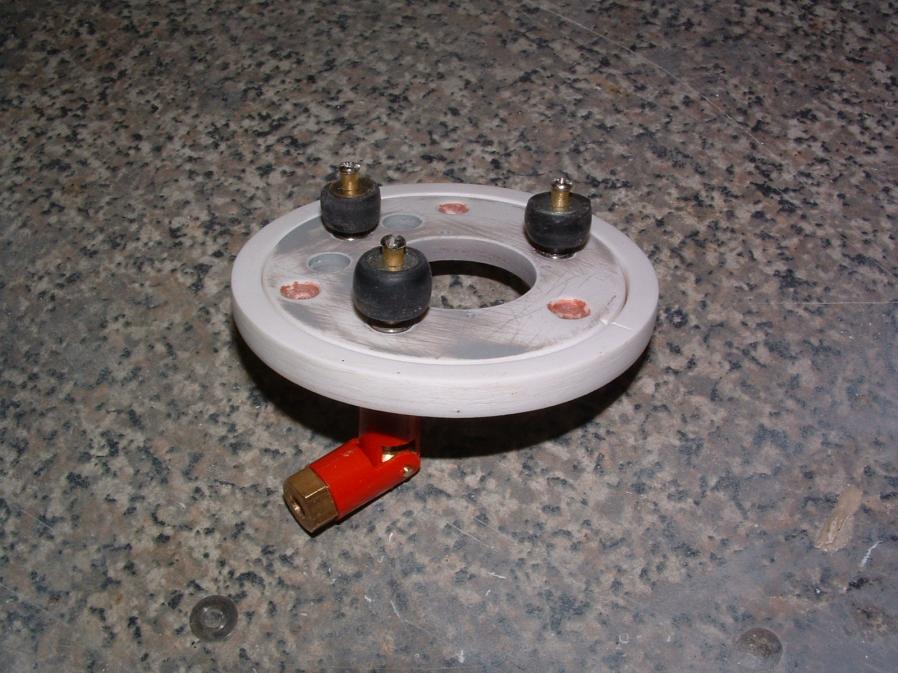

        Thanks David, Just a quick update, I have made a backplate up to replace the one seen in the vid. It now has built in Bearing housings for the rollers and I will mould and cast it for those that want to use it. The rollers are those Dremal rubber things that you put a sanding ring on (cant remember the name, lol). This is by no means the best way to do it being very low tech, An Internal ring gear and small pinion would be better but I'm having trouble finding one that fits. Pic tommorow.

          Sanding drum mandrels. Neat!

              HPC do internal gears. Not a cheap option, the gears are machine cut as opposed to moulded, so they cater to just about any size. You will need to machine the outer part to fit though.

                Cheers Subculture, Just been on the phone to them and they do plastic gearing as well.

                  If it's machine cut it'll probably be in acetal/delrin, which is difficult to bond if you are glueing the gear in.

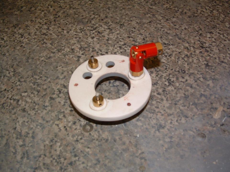

                    The Gear I will be ordering is actually bigger so it will have to be screwed to the Ratemaster face and trimmed down. Im in the trows of making an adaptable fitting for the rear so that different "modules" can be used. So at the moment its the Mandrel one but when I get the gear I can make up another to accomodate that. Pics at the end of the day.

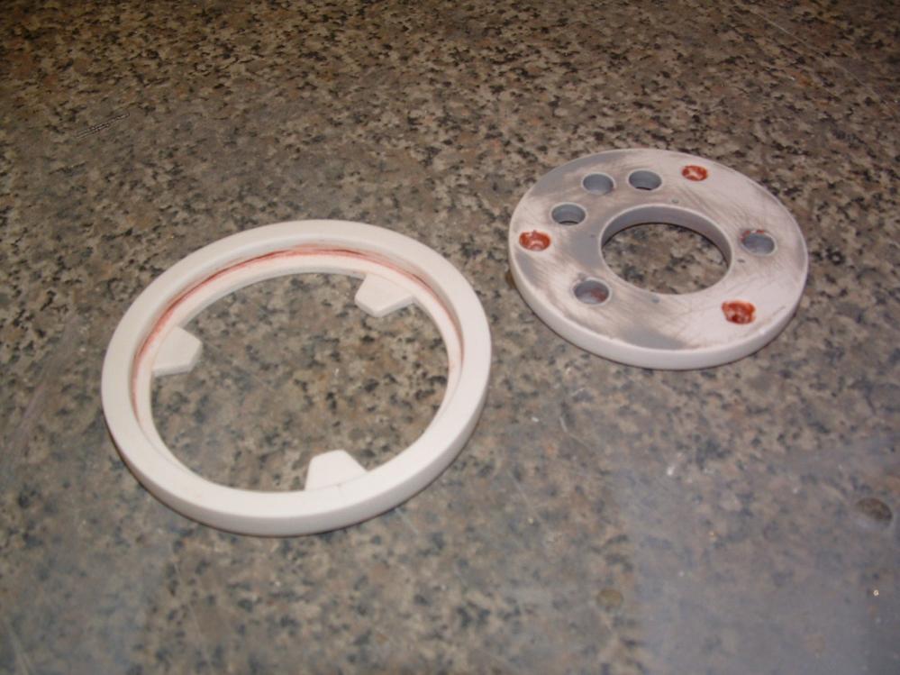

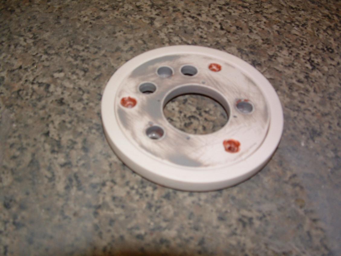

                          Ok here goes, First off I know this would be miles better milled from Aluminum but I dont have the where with all to do that so here are my styrene ones which I will take a mould of and do in resin (I will see if there are any decent Resins/Powders that are better than what im using now for the models.) The inner one is designed to be replacable for newer/updated parts as and when and when I get the internal gear rings.

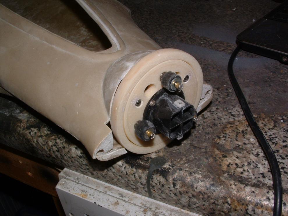

                            Cast the parts and as you can see the method works. With a bit of development (Tweaking) it will be even better(I hope)

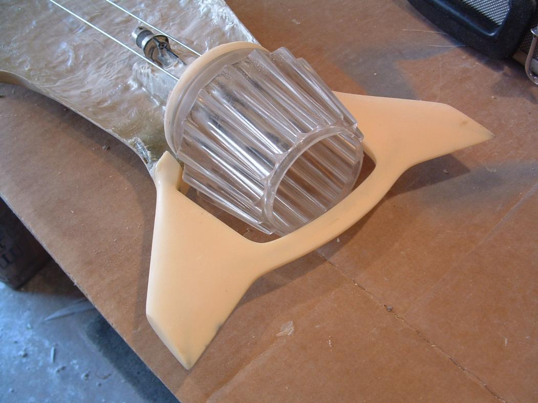

                              Got the decals done and I added the tail fin to see if I could get the Ratemaster assembly in and out without it fouling the back of the tail. And its fine. All servicable.:biggrin:
