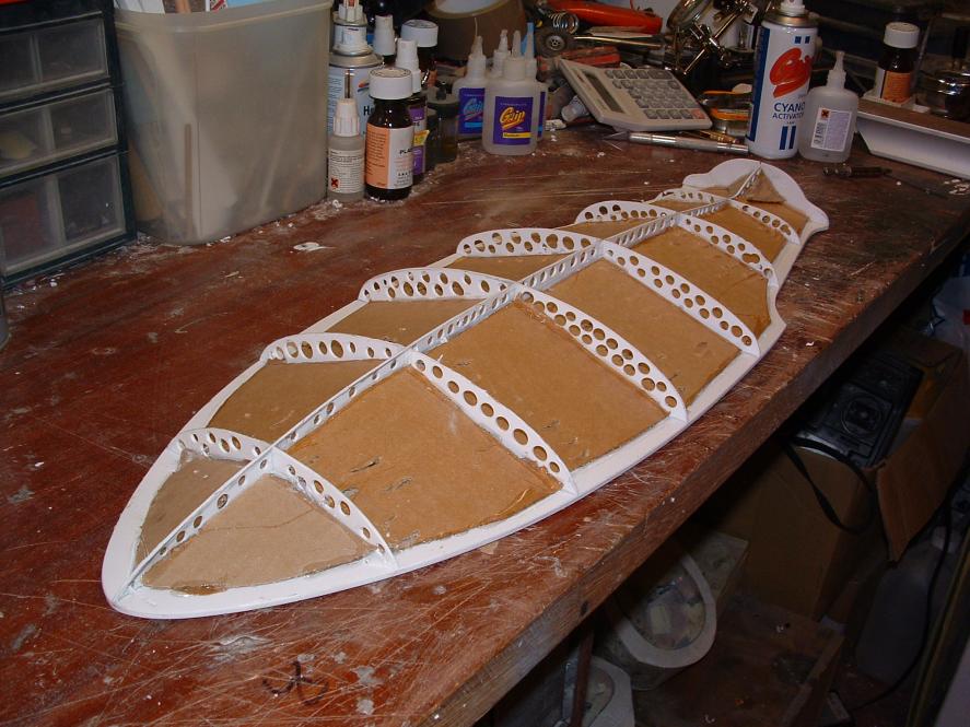

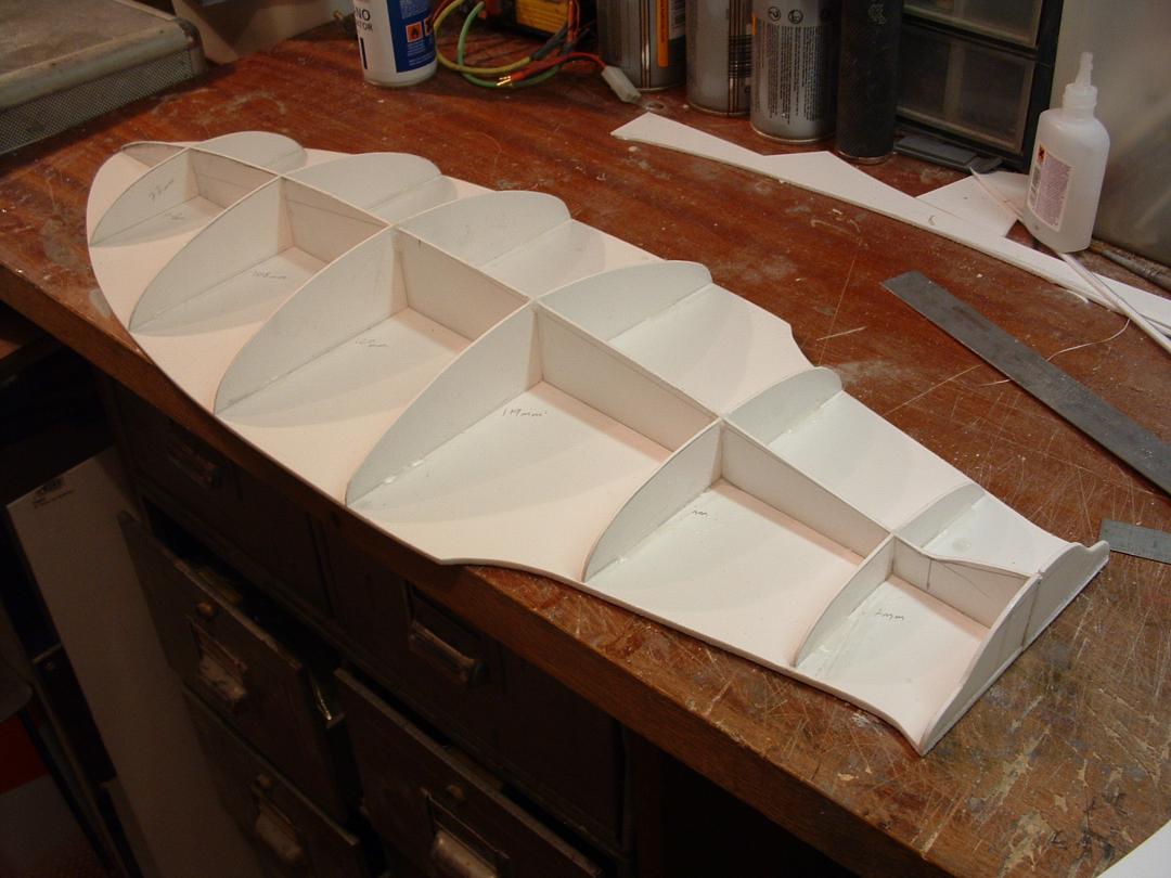

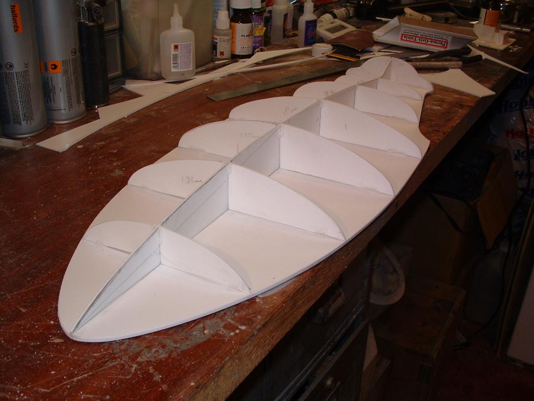

                        Had a bit of a busy spell today, cut the ribs, glued them in and back filled with card to limit the amount of filler I would use. The belly on skydiver was made the same way but had plasticard filling, so as card is being used here and is not as strong, I need to make sure the seperate compartments of filler meet so as to be more stable. As you can see I have drilled holes in the ribs to allow the filler to flow thru so to speak.

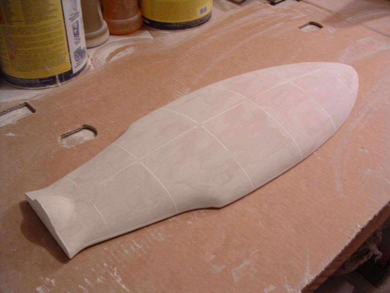

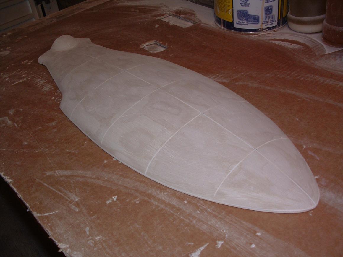

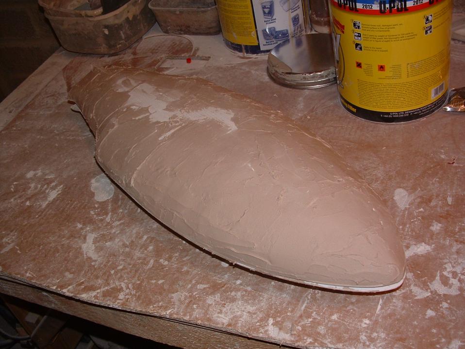

                            Today I filled and sanded the bottom hull, I now need to burn out the plastic and refill with filler.

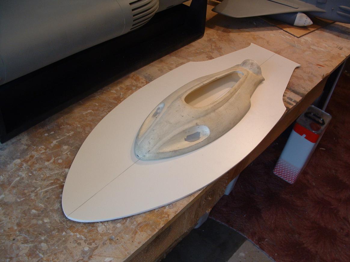

                              Top Hull, Needs sanding back then the upper layer needs to be done as well as the ratemaster blob.
