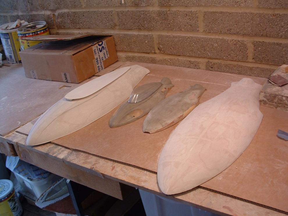

            Hi Guys
            In this case the shrinkage is not going to be a problem as I'm building this model without a size reference so far. To Clarify, When I'm happy with the hull sections the shape and the mating of them I will take measurements and determine what scale it is then build everything around it to that scale. At the moment its just a case of getting the shape right, I'm aiming for 32 inches in total length. To be honest this is the first time I have ever started a build without a firm scale to work too and this as I said in the first post was to seperate this build from any others out there.

                      Its all good, Who did the Masks just out of interest? I'm coming along with it at the moment, just having a spot of lunch. Ill get it to a point and take some shots and post tonight. Then as I'm off tommorrow I will make a start on the upper raised section.

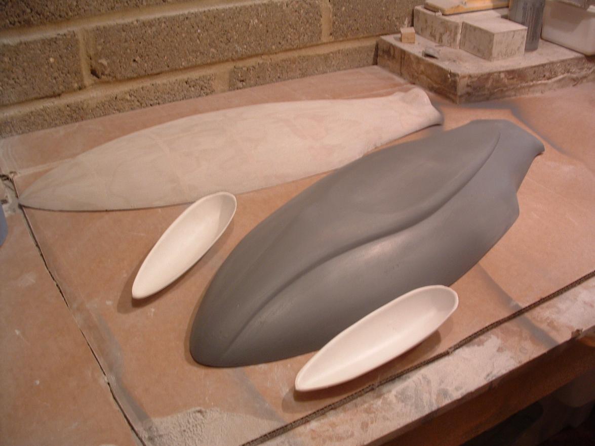

                        Done a bit more today, Have to do the upper level where the cabin sits next.

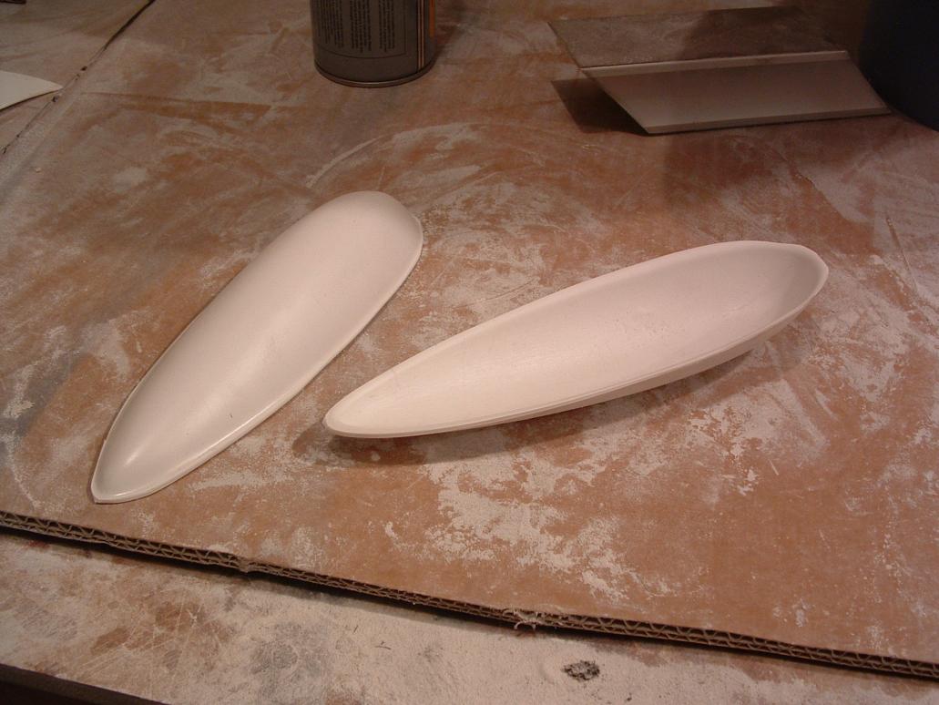

                          Had a bit of time off today so I went at it, The top layer needs softening a bit but other than that I'm quite happy with how its turning out, the white bits are the torpedo "tubes" which will be placed in holes that I will cut out.
