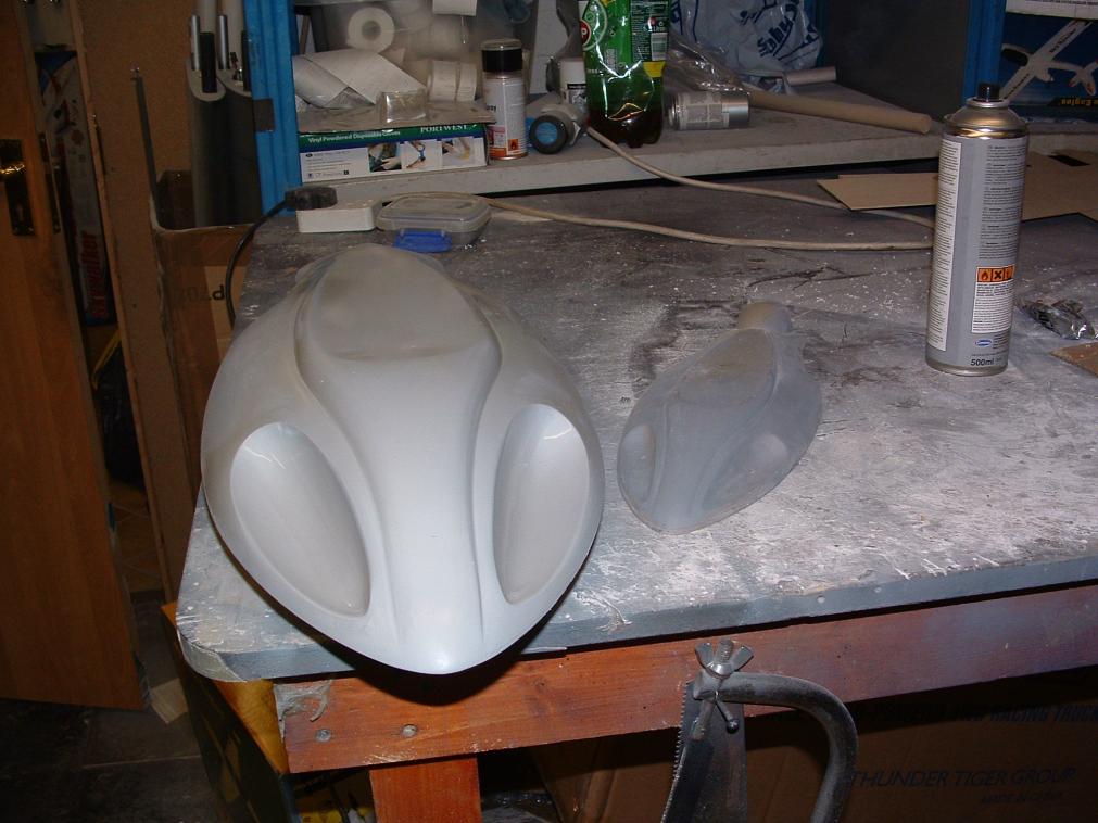

          #34
          Done a bit today, Added the tubes, they need tweaking a bit but overall im quite happy with the way there turning out, I also made the rear top Bubble which I will do using filler.

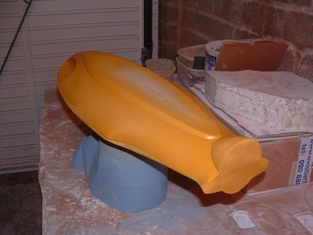

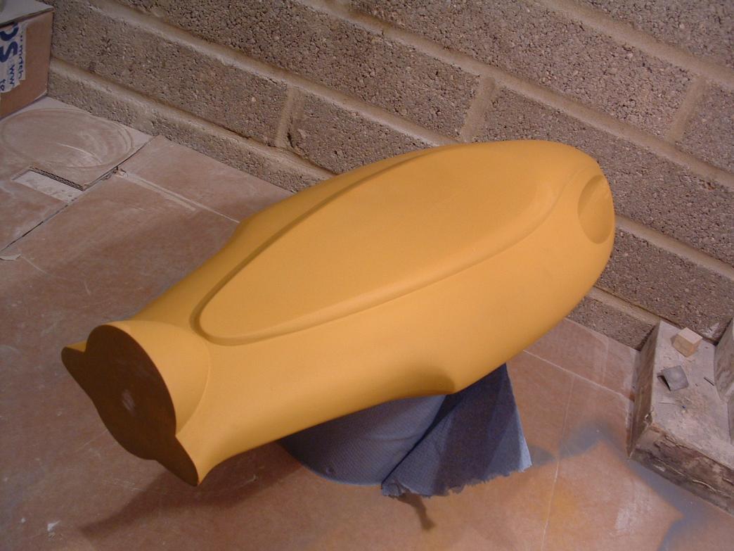

            #35

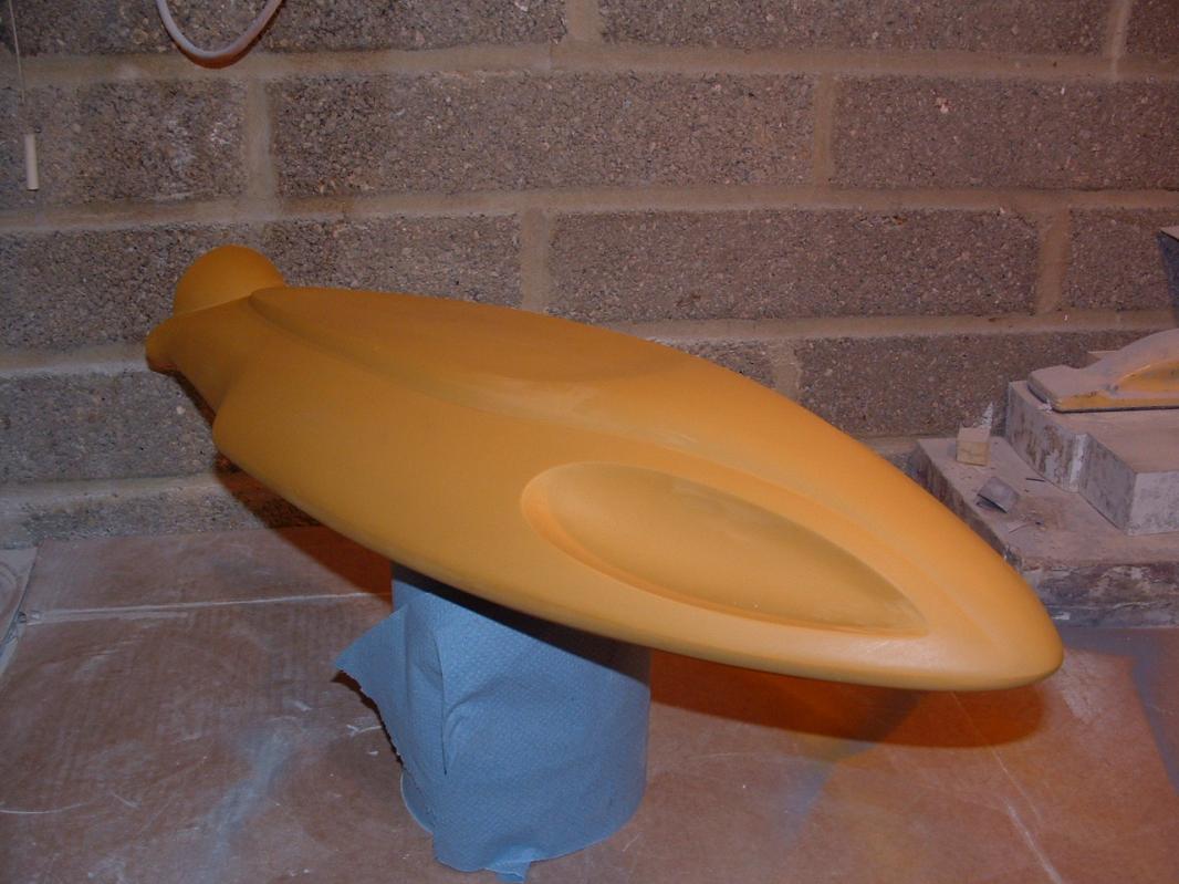

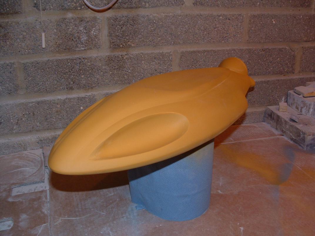

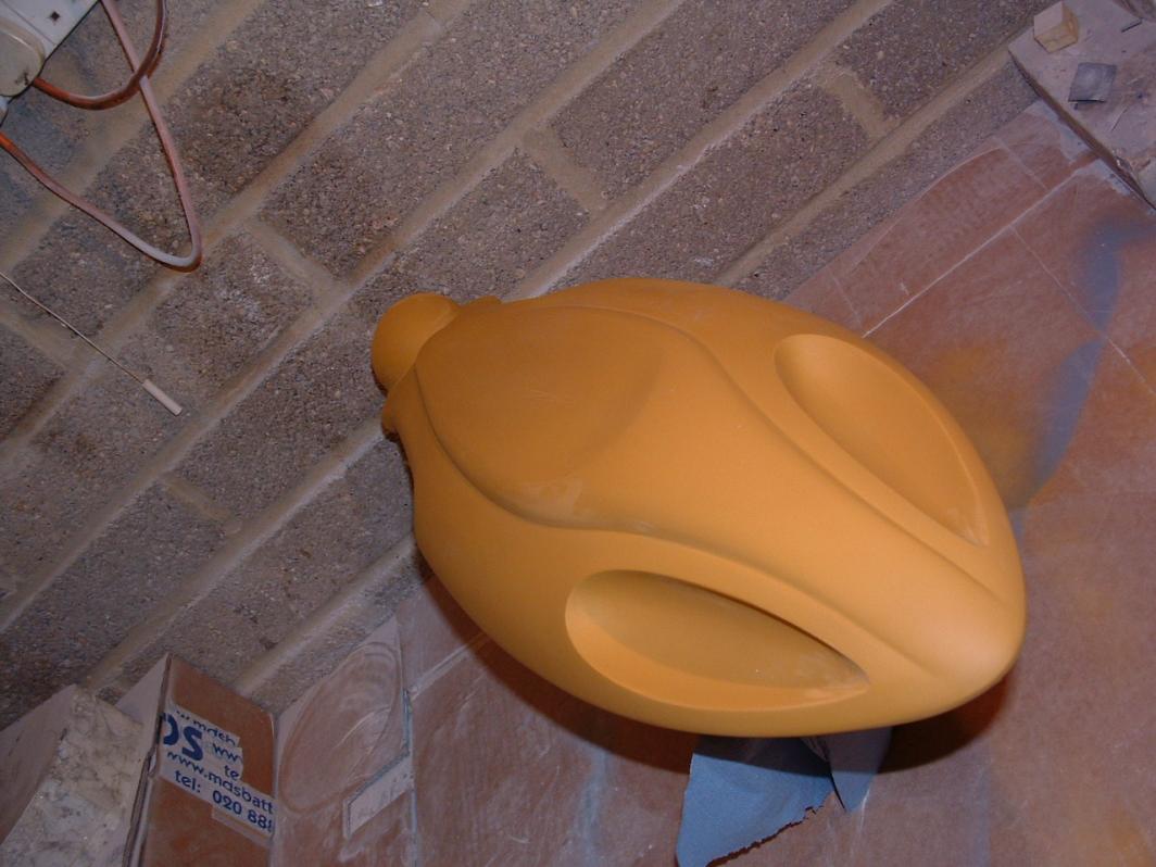

            Good Day, today I did a bit more, sorted the ratemaster bulb top and bottom and tweaked the missile tubes, they need a bit more I think and put the hulls together to make sure they will match out of the mould. need to tweak the upper bulge a bit as I was a bit heavy handed with the sanding on one side, lol.

                #37
                Lol, same way I did with the smaller one I think, that one had a graupner mini jet with vectoring rudder and the side fins were on 2 mini servos and mixed thru my transmitter (Elevons). It worked really well, to the point that it flipped over in the water when I turned to fast. In this one I want to use the same jet as in the Skydiver ones, going right thru the ratemaster which I will attempt to make spin as well. I have an idea how to do that, perhaps a ring spur gear on a small pinion. but thats for later.
                BTW the small one now resides with my Brother as he pesuaded me to swop it for a 1/5 scale RC petrol (GAS) car. As I had another one in the works I agreed to it (thats the White shell you see in the early build pics)

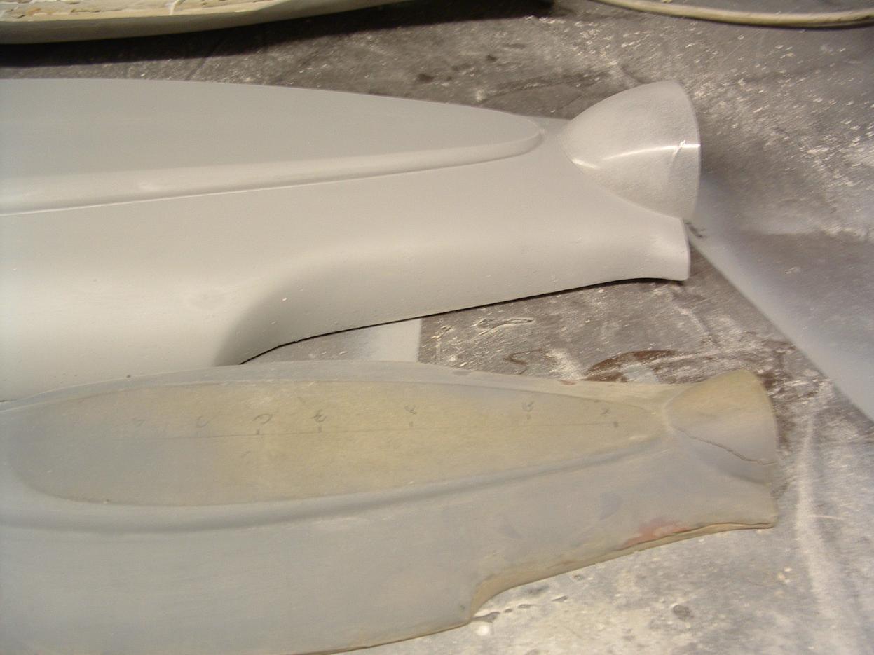

                  #38

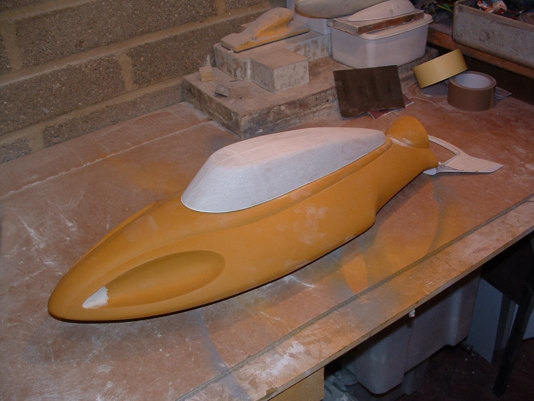

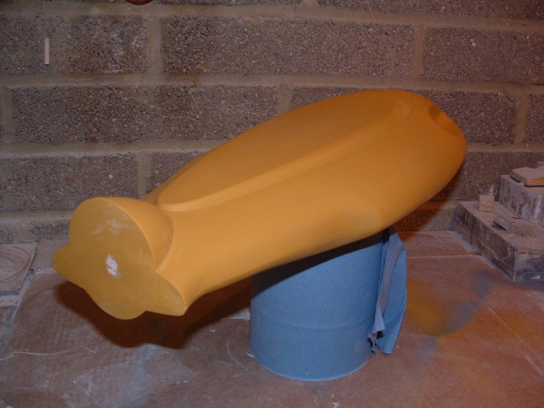

                  Done the tweaking and happy, just a few blemishes to rub out and then the cabin.

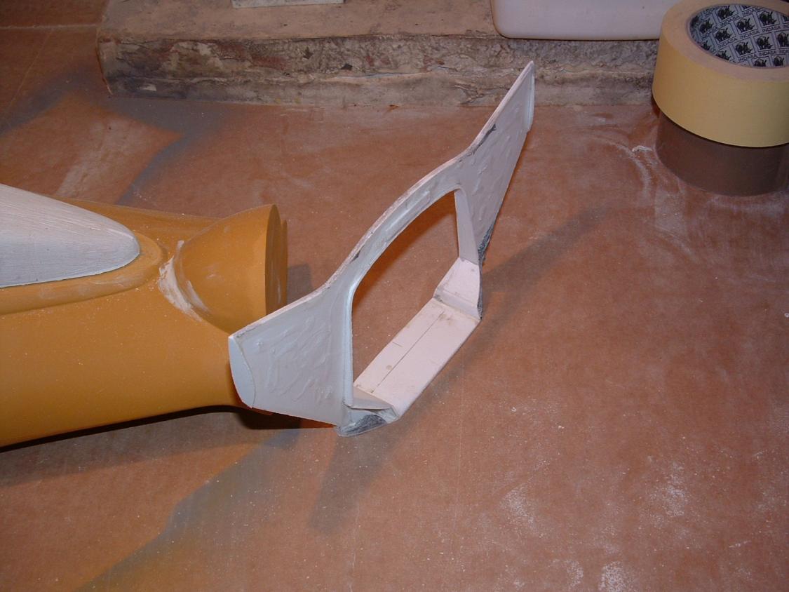

                      #40

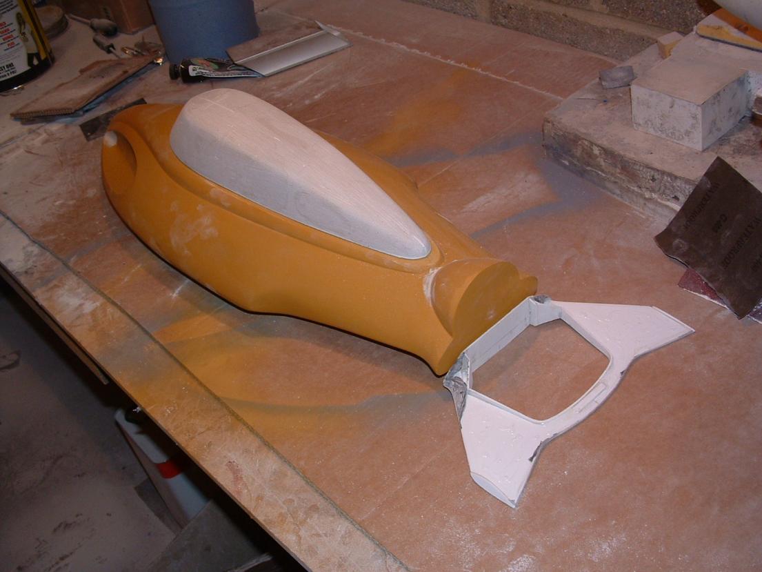

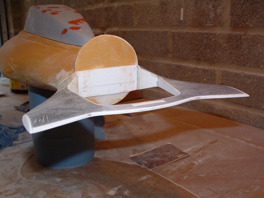

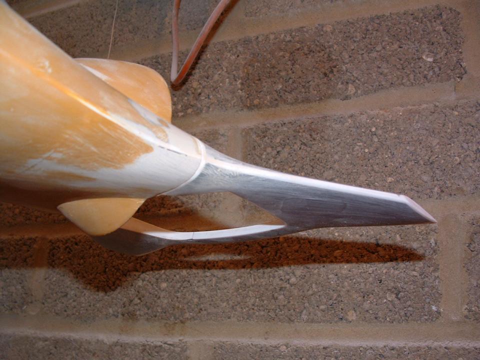

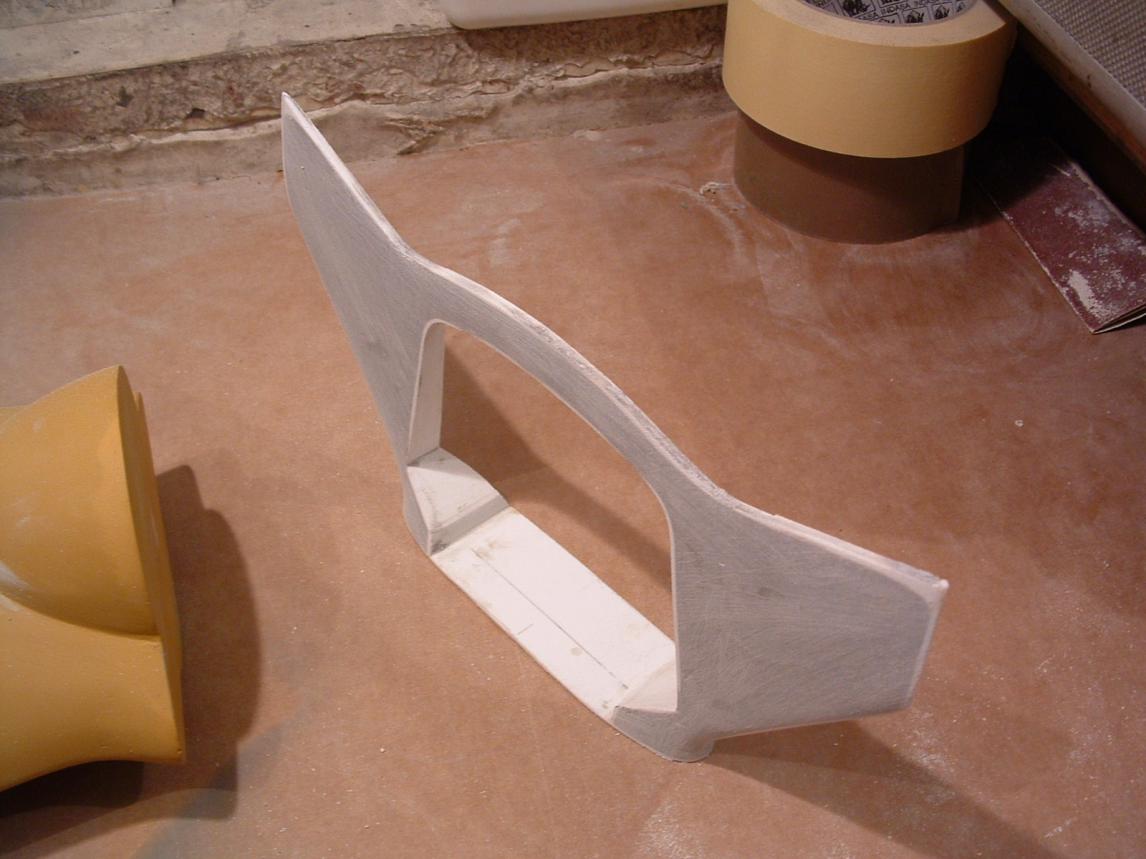

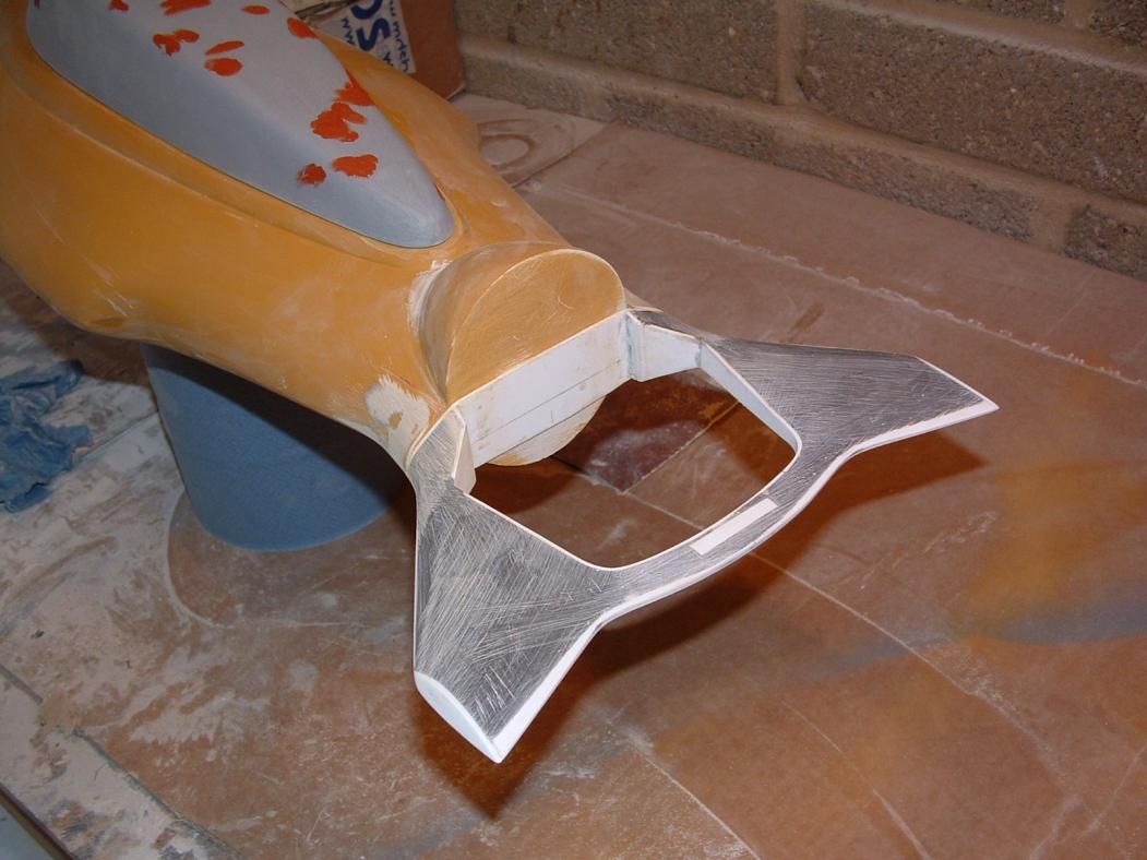

                      Made a start on the cabin and tail section yesterday and will finish them up this afternoon. Same method on the cabin as the main hull but I'm using plastic bumper (fender) filler on the tail. It retains a greater degree of flexibility when set.

                          #42

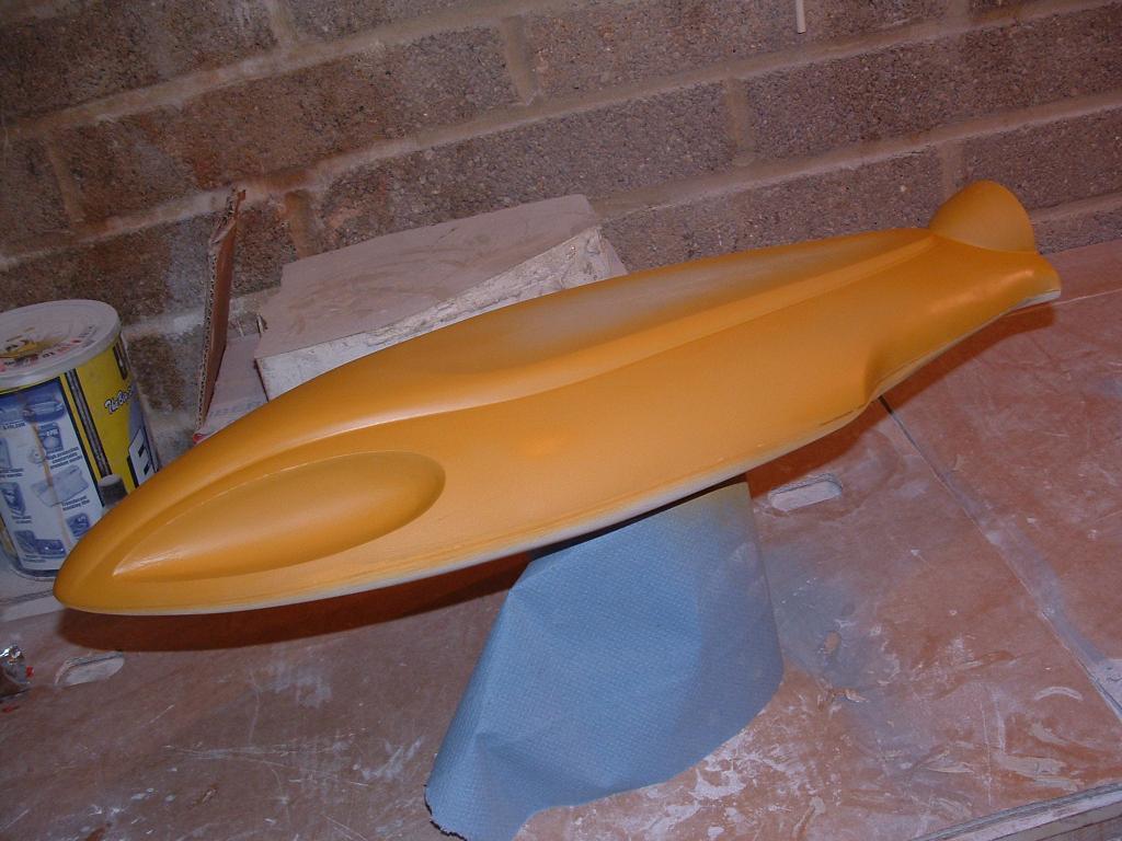

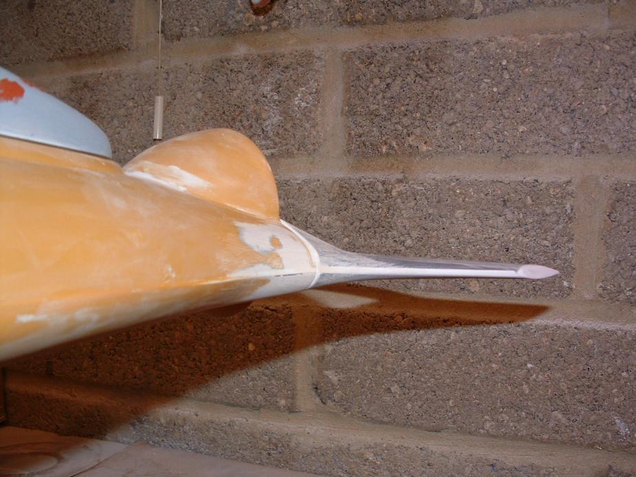

                          Thanks David. Done a bit more, Cabin Primered but still needs fine work done and tail mated to the back end.

                            #43
                            Your trick of establishing the inner and outer contour points on the stern is an example of simple, functional, lay-out work. You make use of rigid materials (the plastic card) for the basic structure, and leave it to the formable filler to fill in the blanks. The basic means of dictating final form of tapers and compound curves to a complicated sub-assembly. Even using the existing stern as a guide. No flubbing around; no mis-steps; and FAST.
                            You strike me as being both an intuitive throw-it-at-the-wall-and-see-what-sticks sort of guy; but also one well versed in the disciplines of pattern making (plan interpretation, lay-out, materials selection and use).
                            Who the hell are you, and where have you been hiding all these decades?!....
