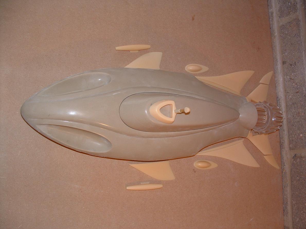

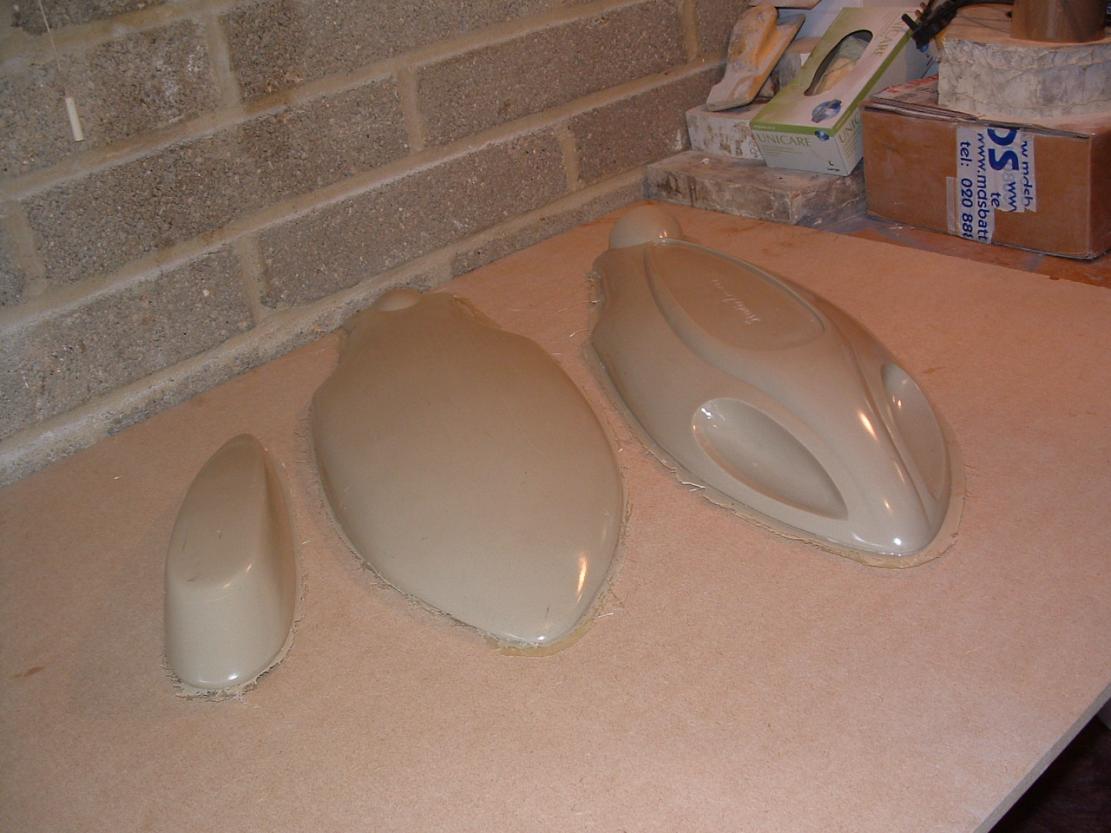

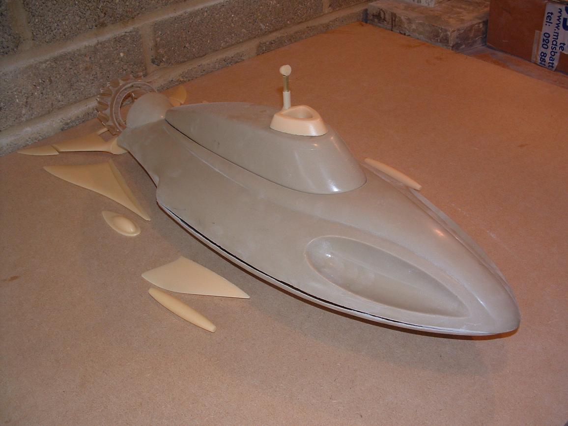

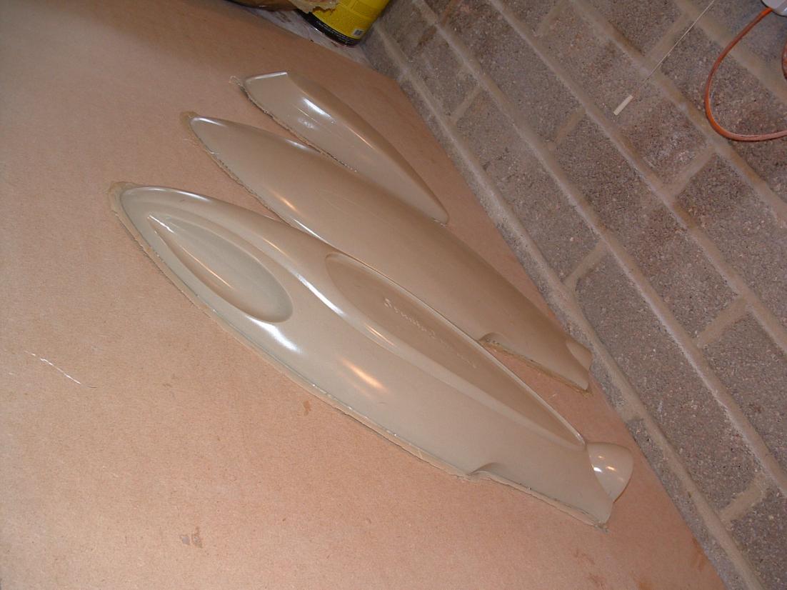

    Done! heres the first one out of the moulds, I have to say that I am utterly totally well happy with the results. :D

                #142
                Very nice, anything can happen in the next half hour

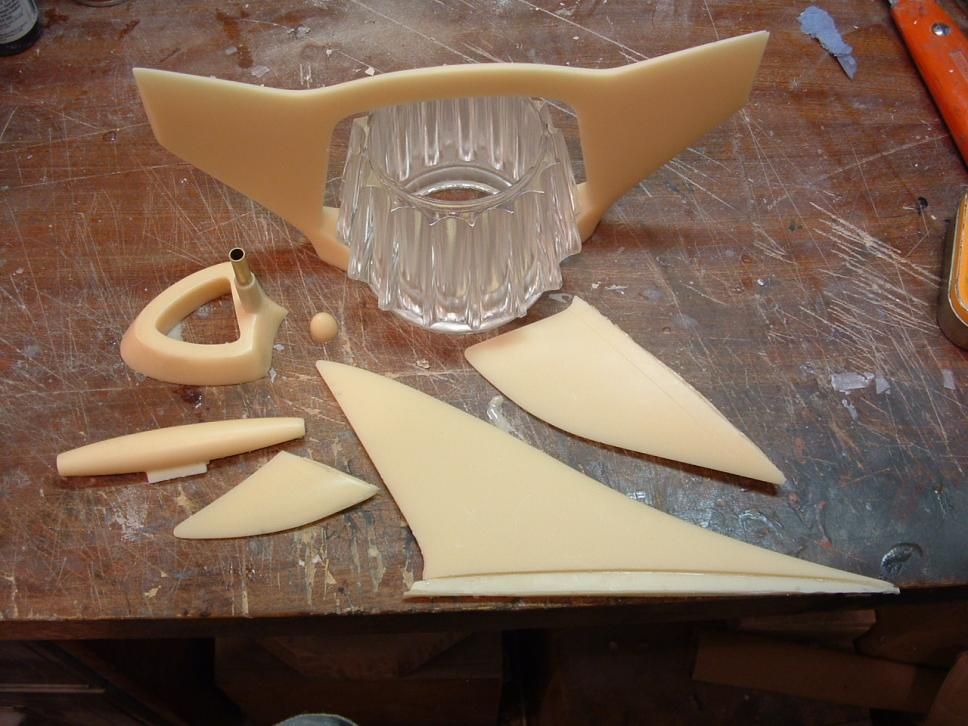

                  These pics show all the parts for Stingray, Note that the Aquasprites will be in clear plastic vac form, Decals will also be included.
                    • 2633
                    #144
                    Could you not cast those bubbles (aquasprites) in the clear resin the ratemaster is cast from? If vac formed they make a nice air trap for a working model (assuming it submerges).
                      • 13962
                      #145
                      A solid cast, clear compound curve structure (the Sprite cockpit bubble) like that would refract light like a kaleidoscope.
                      A thin walled bubble would register as 'real' when seen in air and through water. If you seal the bubble (two of em') to keep them dry at all times then they merely becomes another buoyant element to compensate for during model trimming.
                      Yeah, vacuform those critters.

                            And I take full responsibility looool, BTW I started to clean up the hulls and removed the cabin opening.....Must slow down!!!!

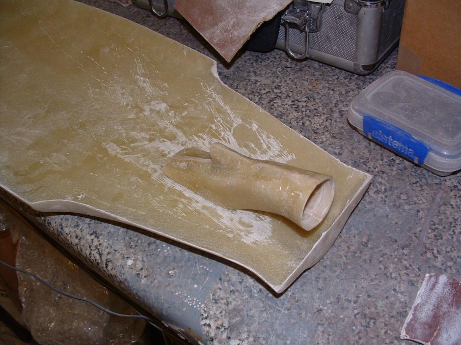

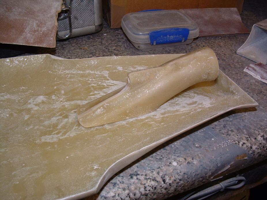

                              Just a teaser, The Graupner jet will be here tommorrow but in the meantime as with the Skydiver jets I made my own intake up (The Graupner ones are flimsey vacformed plastic) The trick here will be to position it so I can get the ratemaster rotating bits to fit inside and still steer the thing.
                                • 13962
                                #150
                                would you send me a copy of the PJ intake? I would help me with the slide-valve needed to de-water the hull. Better my work matches yours than burdening you with trying to match my work.
                                What is the approximate wall thickness of the lower hull? And will you build up a foundation (flange) in the floor of the lower hull over which the PJ intake duct you've made will screw down onto?
