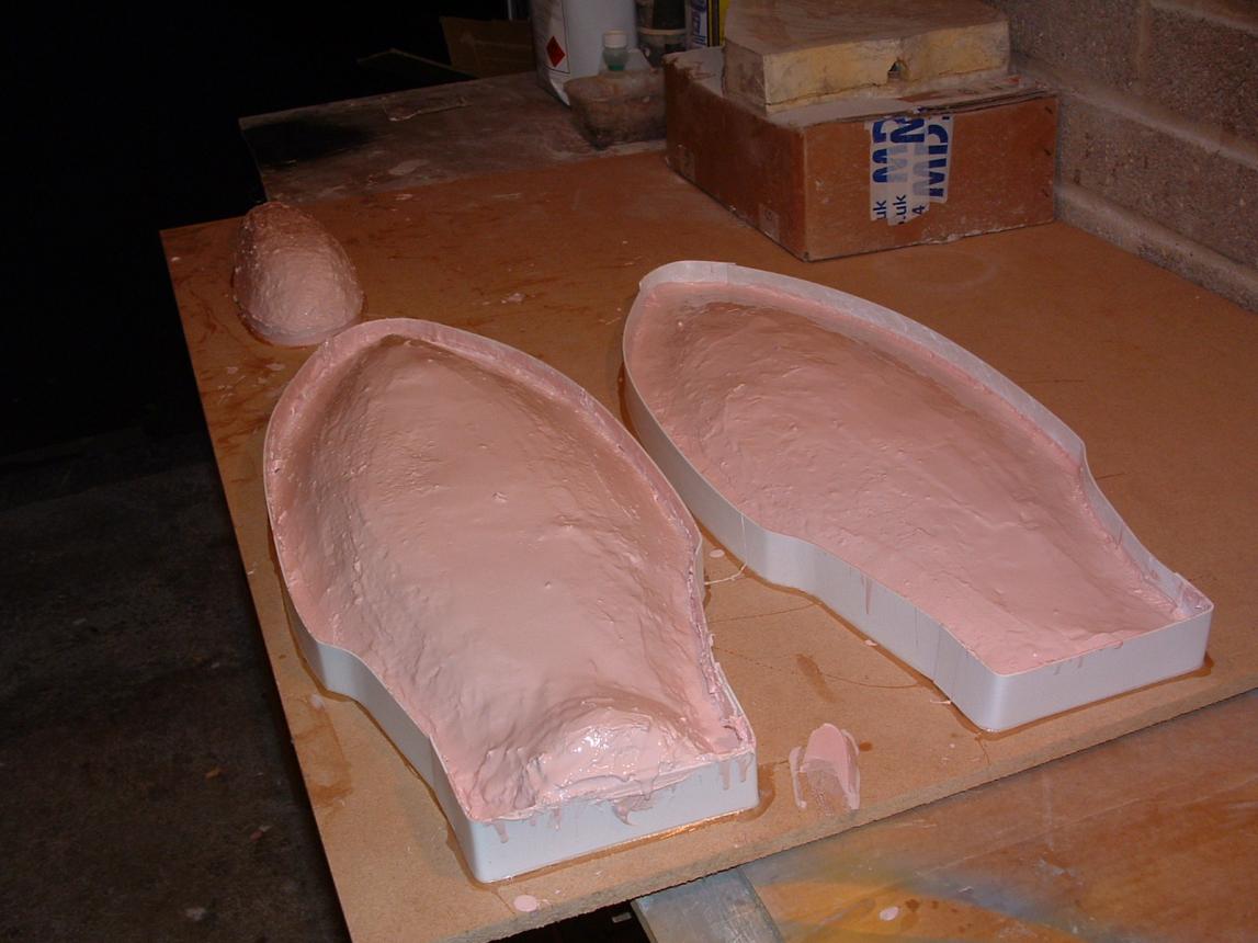

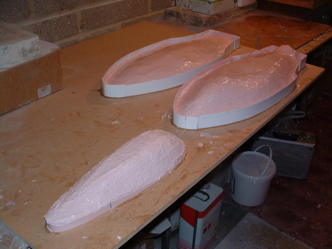

    Yeah, had to make a parting mold-board as I was dealing with a full-up hull casting. Great minds think alike. You're already deep into the rubber end of things. Wow. I better get hot on that PJ valve I bragged about above ...
    Yep, lol. Well if all goes to plan and my fibreglass resing gets here tommorow I can see me doing a pull sooner than the weekend. Phew!
    • RCnut
      • Apr 2012
      • 441
      #122
      Well as it turns out my fibreglass was with my good neighbour so I'm in business lol. Rubbers all on and just letting it go off and do the jackets tommorrow morning, Good thing I'm on holiday.

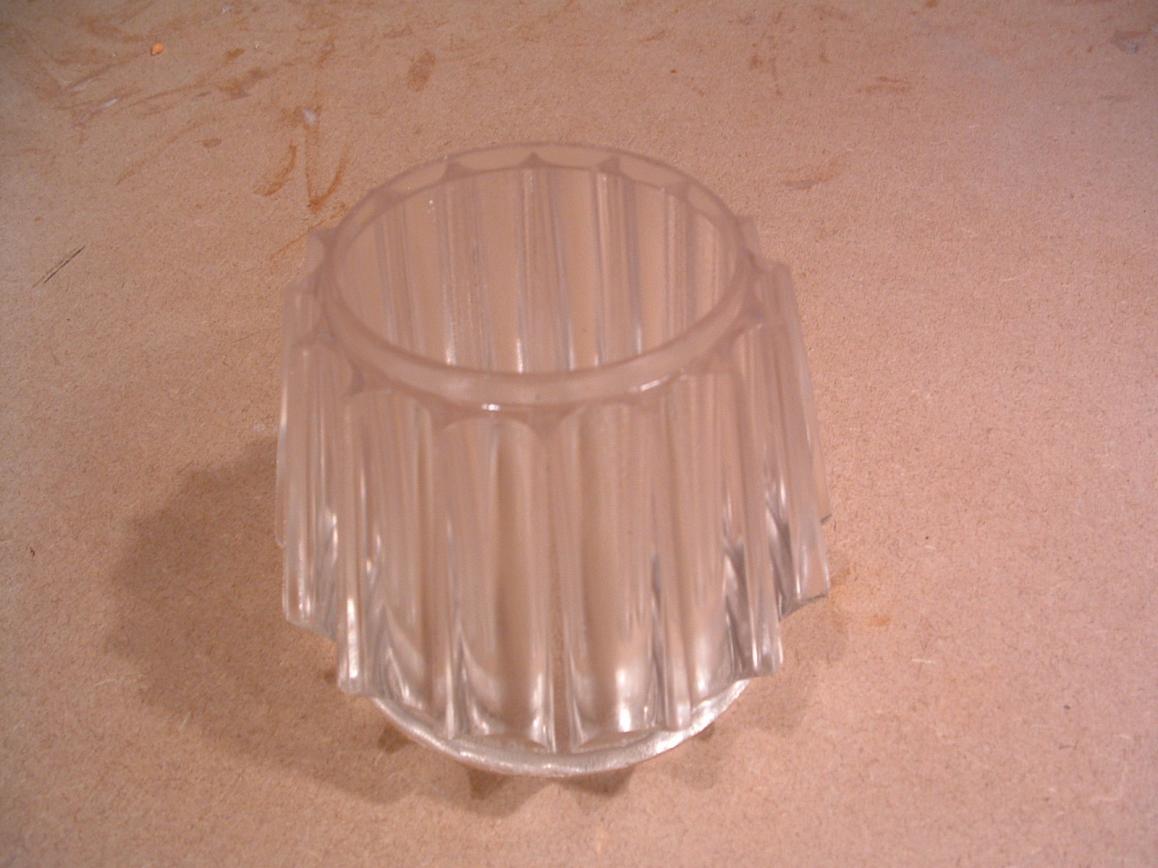

                    Whilst waiting for the rubber to go off I thought I'd do a cast of the Ratemaster and lets face it the whole model depends on this being nice and clear. So it is with great joy that I can say its come out dam well, no stickiness and virtually no shrinkage.

                      #130
                      Looks great. What clear casting resin did you use, a polyurethane or Polyester base?
                      • RCnut
                        • Apr 2012
                        • 441
                        #131
                        Polyester, and dispite warnings of doom and not ever going off and such I poured it last night and demoulded it this morning. Quite chuffed (Happy) really.
                          • 2627
                          #132
                          Only polyester gelcoat resin that doesn't go off in rubber tools. Is it the bonda brand you've used?
                          • RCnut
                            • Apr 2012
                            • 441
                            #133
                            Nope, its by Polycraft, (Polylite) Got me a tad worried at first, Was green in colour then went clear. lol.
                              • 2627
                              #134
                              I looked that up, and saw it's acrylic modified, which sounds good. I've used acrylic modified glues and they're incredibly tough. Do you know if you can you polish this stuff if it gets scratched?
                              • RCnut
                                • Apr 2012
                                • 441
                                #135
                                No Idea yet, I will have a go and see what I can do to it, but your right it does seem to be really tough.
