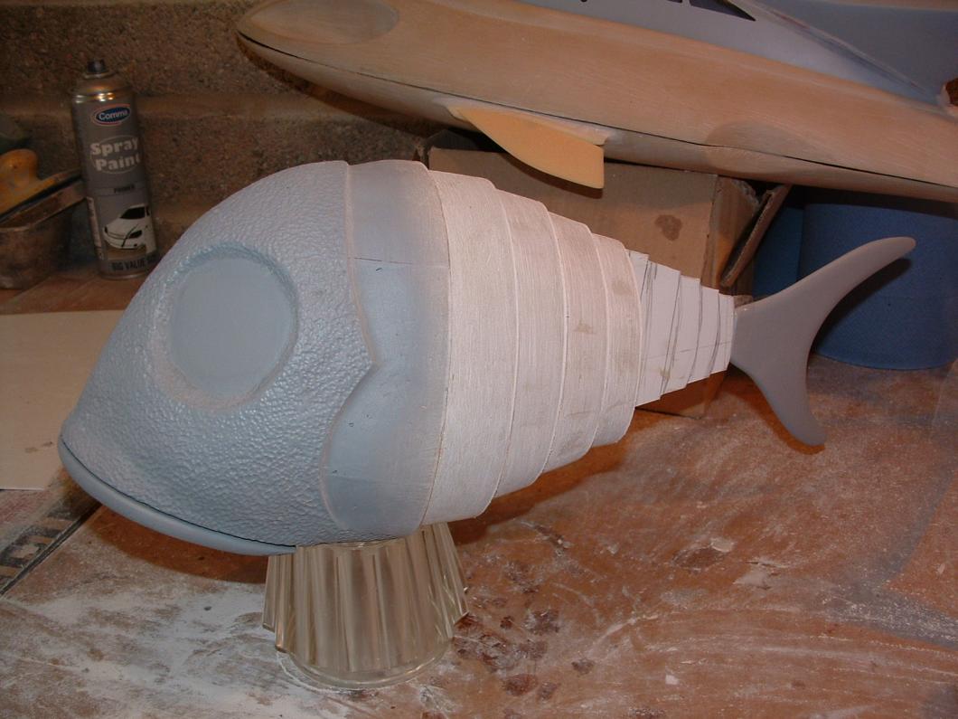

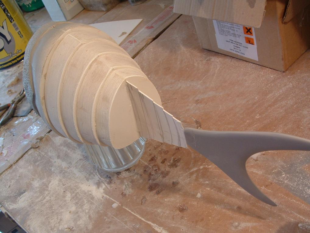

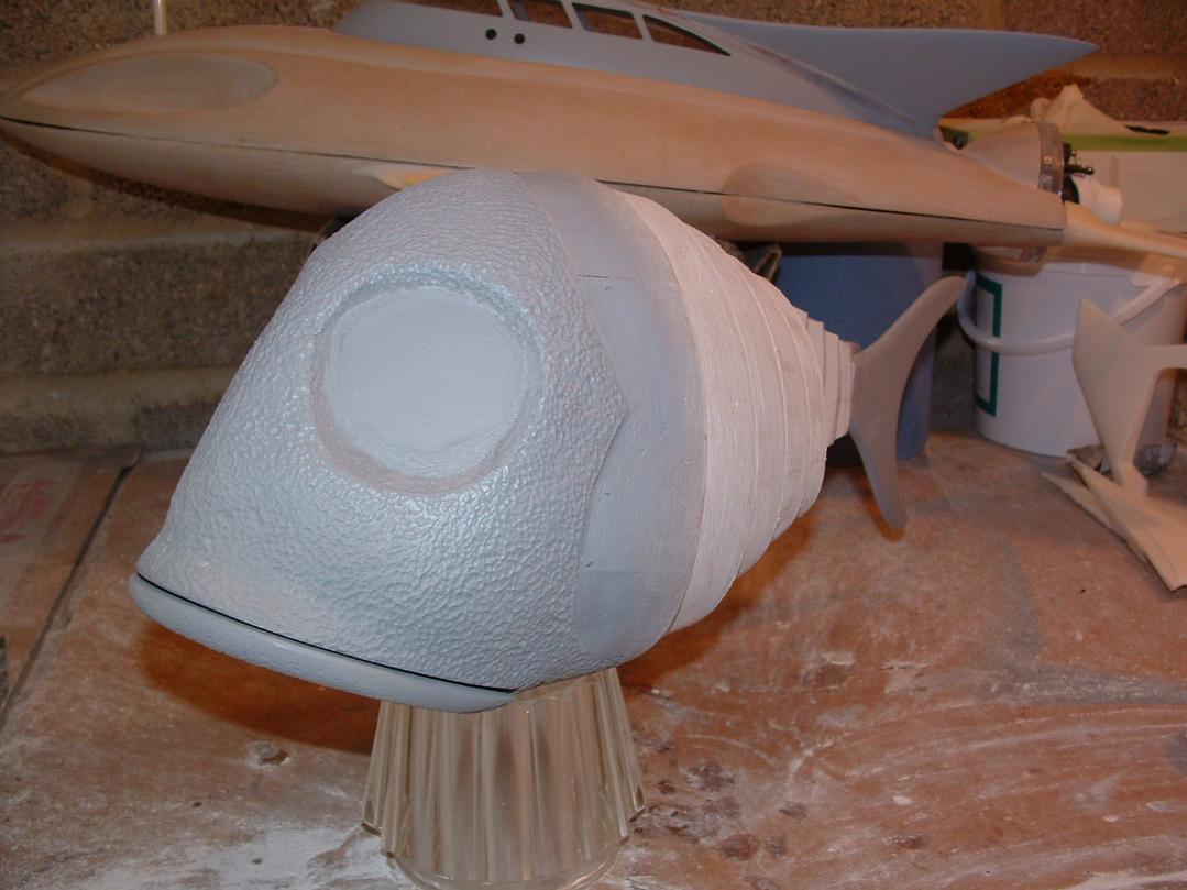

          Just thought you guys might like to see what My Partner is making, Just a little bit related to this thread subject lol.
          It is planned that this will be radio controlled as well.:biggrin: That way we can go to some model boat/Sub shows and do the chasing bit....you know leaping out of the water and blowing...........oh wait, sorry just dreaming lol.

                Now that fish vehicle (X-20's ride) is a project! Love the mottling effect at the front. Details! OK, propulsion and steering is obvious. How are we gonna control this thing in pitch?
                (watch Andy jump in with the very European, shifting-the-battery-weight option).

                  You're going to end up with a skipjack inserted where you get to blow ballast if Ellie reads this!
                  Weight shifiting is an option if the fish is fairly slow. I'd have thought tiltable twin jets, with steering in a tank style would be best for this. IIRC, the Terror fish didn't flap its tail for propulsion.
                    LOL. Indeed! Today's mission to to keep her away from the monitor as I pull up this thread!
                    Good catch, Andy. I assumed (you know how that word breaks down!) it flapped its tail. Wrong! I should shut-up till we see how this thing matures as a master.

                      #280
                      It does wave it's tail but it's all for effect not really for locomotion. This did get me thinking however that a good swimming effect could be made with just the water flow over the model, it may mean a few compromises like changing the tail from a rigid material to soft flexible film or fabric. I am thinking for the motion that a limit switch or lever could be used to tilt the tail (rudder style) from a little port to a little starboard attitude, you wouldn't need much just enough to send it in the opposite direction. I'll try to find a few minutes to draw what I mean but it would be based on a clock ratchet armature where the water flow would over the tail would stand in for the pendulum or balance wheel and the rocker would alter the tail pitch to change it's direction. If the motion was left to cycle it would go first to one side then at the limit of travel actuate the angle of the fin to travel to the opposite side. I think this would capture the motion of the screen used model quite elegantly.
