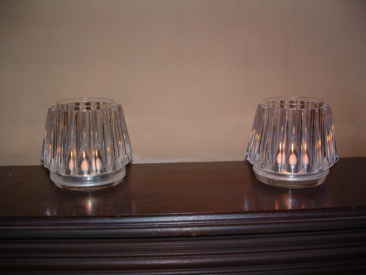

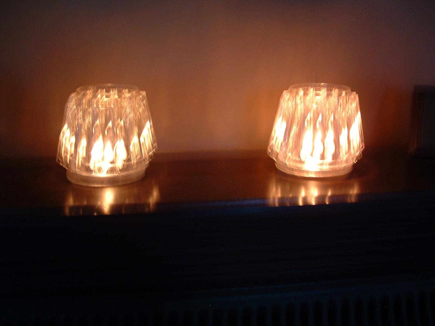

                In this day and age of a throw away society im so pleased to show you recycling at its most imaginative, lol. This was brought to you By Mrs RCnut.

                  AH! Perfect candle holders. Good for the Gulf states during Hurricane season.

                    SACRILEGE!!!!!!!!!!!!!!!!!
                    (over my shoulder, Ellie looking at the monitor, nodding in agreement .... women!)

                      Lol, There the old ones before the nice machined one was made, I was just gona bin them anyway.
