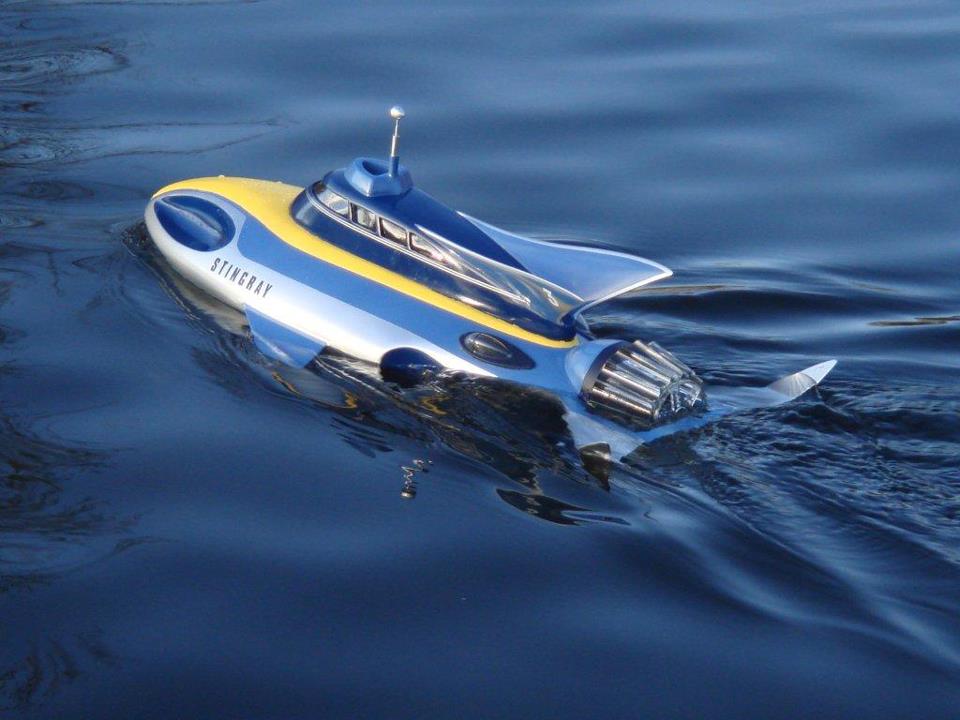

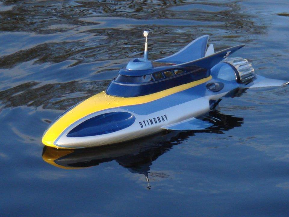

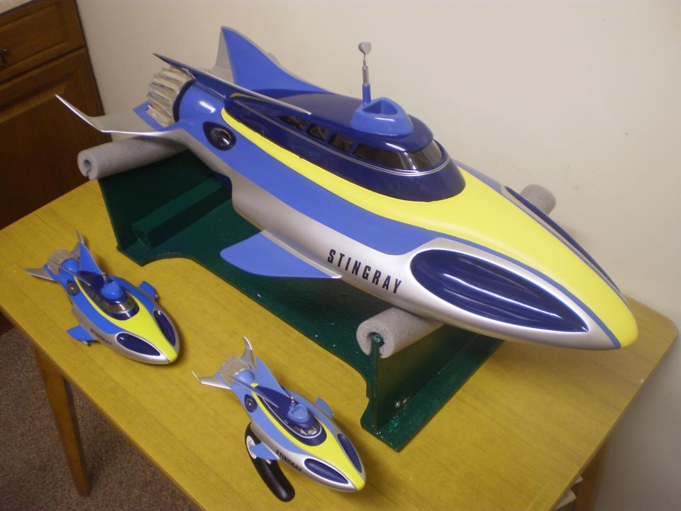

        This just in, A customer friend of mine has finished his Stingray kit and has made it a surface runner.:biggrin:
        Pictured here wiith 2 smaller ones.
          • 2641
          #394
          That looks very nice.

              And here it is in the water, This one has a conventional Prop and rudder to power it.

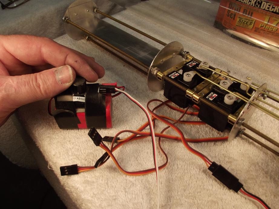

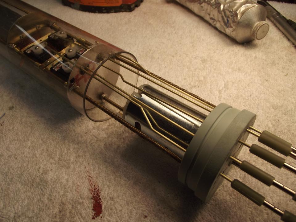

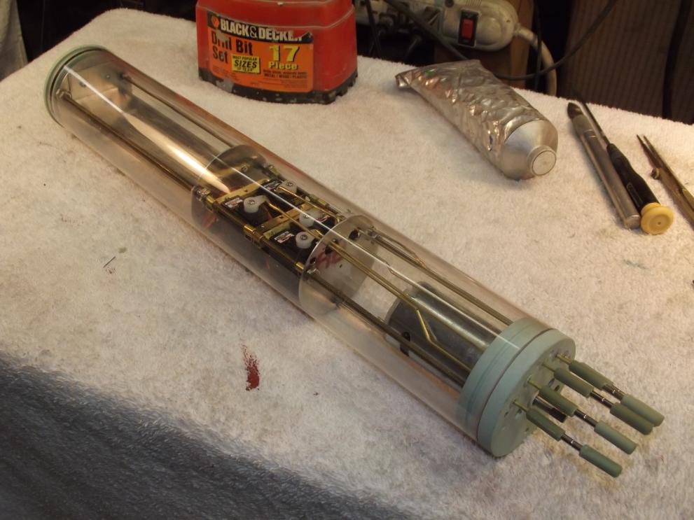

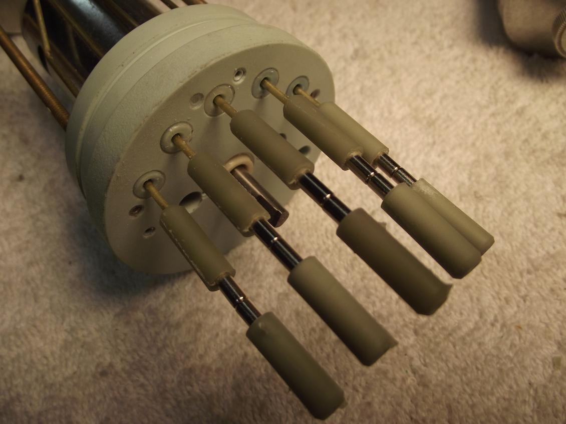

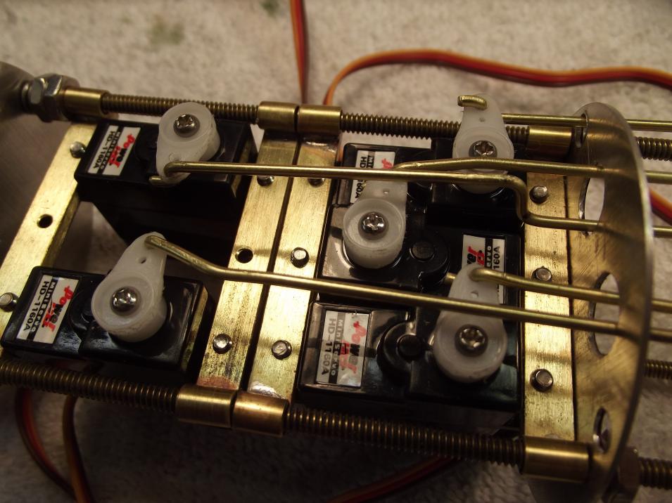

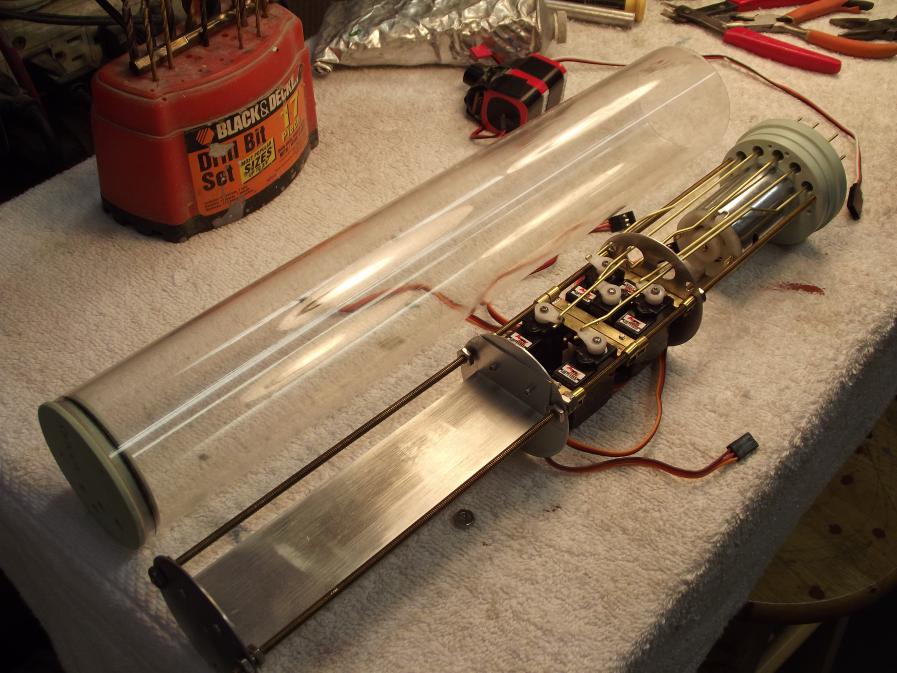

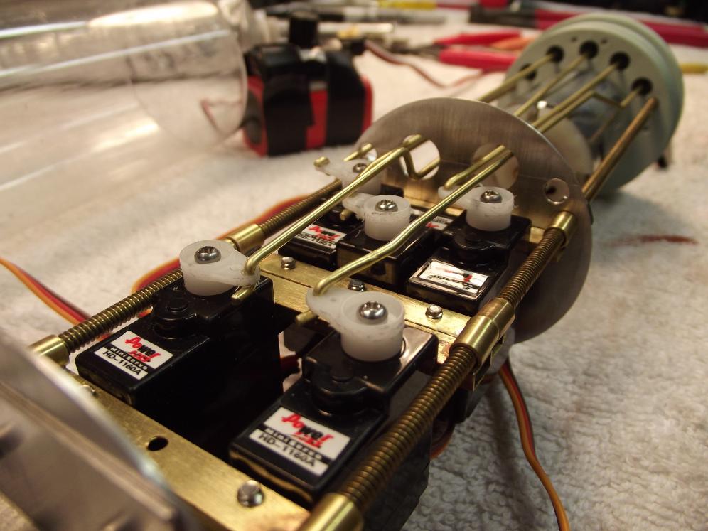

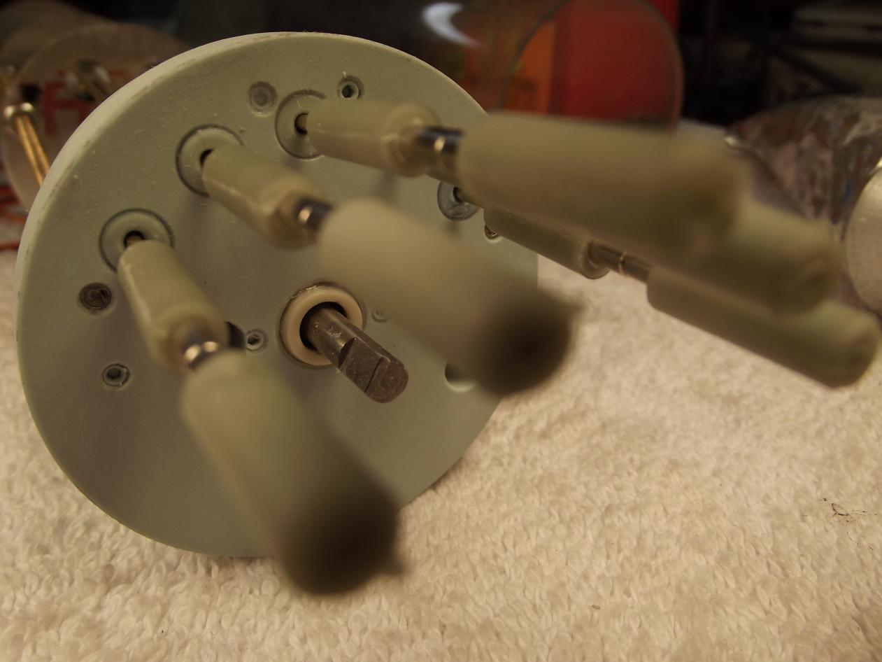

                It's been almost FIVE MONTHS when I posted that I would have the two SD's off to Mamas for his STINGRAY models, by the end of the week. Didn't happen, they're still here! I'm so behind in stuff.
                Anyway, feeling very guilty (and Mamas has been a real gentelman about it), I've spent a good portion of the weekend working out the five servo pushrods and getting them all to pass through their respective watertight seals without too much binding. Here are the gorry pictures to prove it:
ID:	76453Click image for larger version
ID:	76454Click image for larger version
ID:	76455Click image for larger version
ID:	76456Click image for larger version
ID:	76457Click image for larger version
ID:	76458Click image for larger version
ID:	76459Click image for larger version
                All that is left is to work out the little SD that houses the RateMaster motor and gear unit, make up the devices to the main SD, get things running, and THEN get this long promised item off to Mamas.
