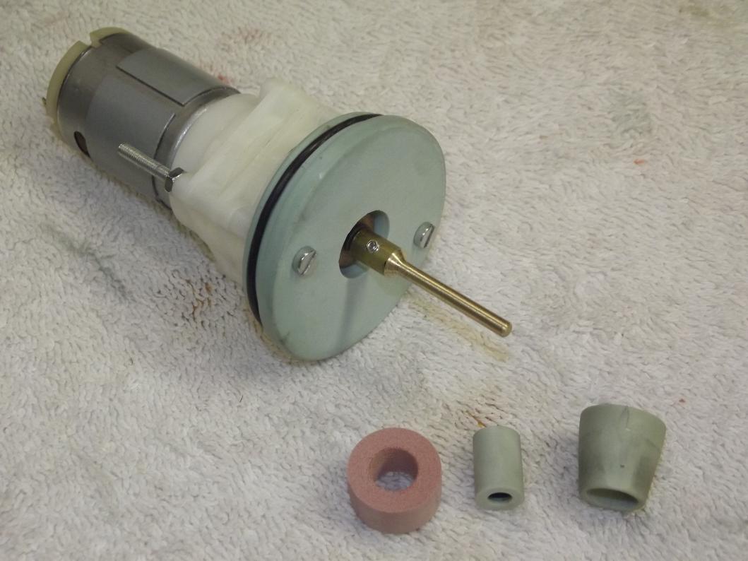

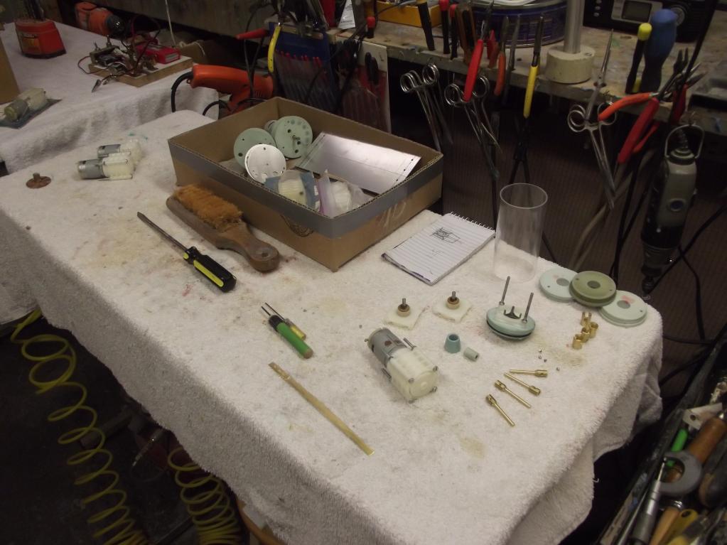

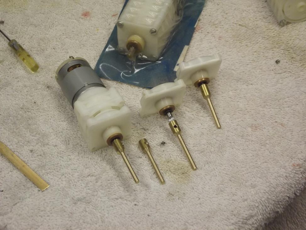

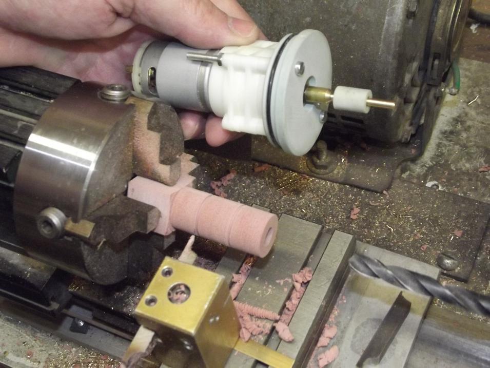

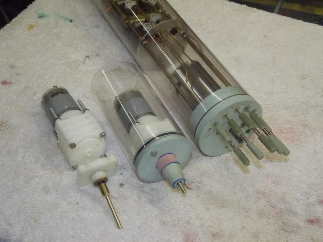

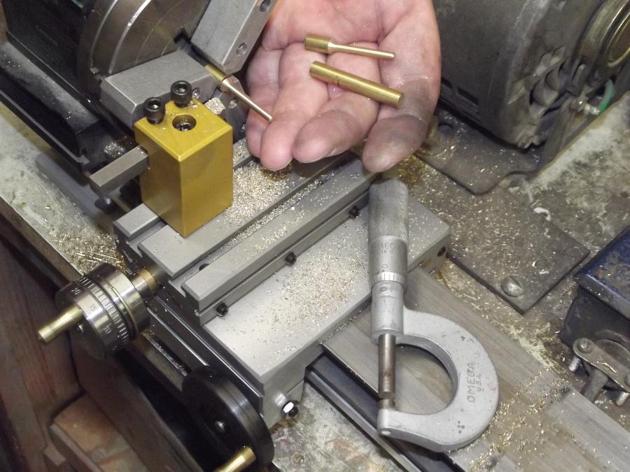

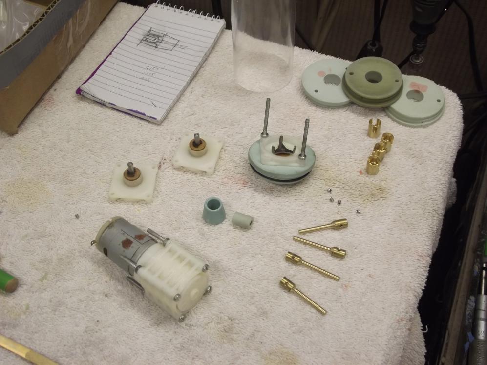

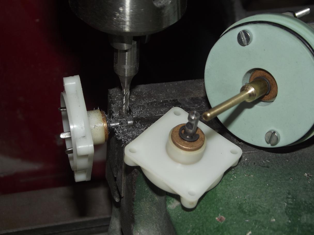

        Mamas: My sincere apology for being out of touch for so long. Things piled up here and I lost what little spare time I had for non-production work. However, there is no good reason for not keeping you and the readers up to speed on why there has been such a delay. It was irresponsible for me to just drop out of sight like that, and I won't let that happen again. My rate of progress may not be high from this point, but it will be consistent.
        That said, I re-engage with the project.
        Today's work involved producing the watertight seal and associated fittings for the little WTC that housed the motor that will operate the RateMaster:

                                Yes, for the main cylinder -- they (I'm making two systems for you, one for me) will arrive with an installed 555 motor to drive the pump-jet and you'll have two blank motor-bulkheads that will permit installation of your own drive-motor.
                                What I'm showing in the last two posts are the work on the separate RateMaster WTC. Not to be confused with the main propulsion-control WTC.
