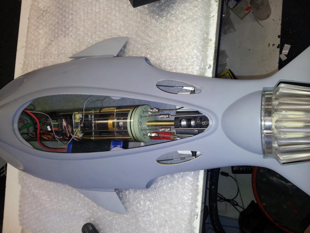

                  #443
                  Its been a while but now doing some work on this, After David kindly sent me the WTCs, I have done my best to get one installed and working. I have incorporated the ratemaster rotation inside the main cylinder and replaced the Brushed motor with a Brushless one, I'm only using 3 servos as there is no up and down on the nozzle only left or right. There is way too much slop on the dive planes so they will need to be beefed up and the ratemaster spin mandrell will need tweaking some to get it right. Apart from that Im happy, :)

                    #444
                    That is SLICK! How are you going to manage pitch control?
                    • RCnut
                      • Apr 2012
                      • 441
                      #445
                      Hmmm Andy asked me that, The RA Stingray I converted a few years ago to RC worked well and I had used the side fins to control pitch, It was very fast and twitchy in the water but I'm doing the same with this one, We shall see. If it dont work then I will try and sort out a pitch function on the nozzle. Was thinking about actually making the back fins into functioning ones. I dont like the idea of visible control links though.

                        #446
                        Keep it simple.
                        Just put a pair of horizontal von Braun type 'jet-vators' (think: V-2) aft of the yawing pump-jet nozzle. Still hidden within the RateMaster. Hell make them out of clear Acrylic and they will hardly be noticeable. No matter which way the nozzle yaws, the jet will impinge on enough jet-vator to produce the desired pitching moment.
                        You got the servo and seal in there already, Mamas. Why not use 'em?
                        Put an angle keeper on that pitch servo and you're in business.
