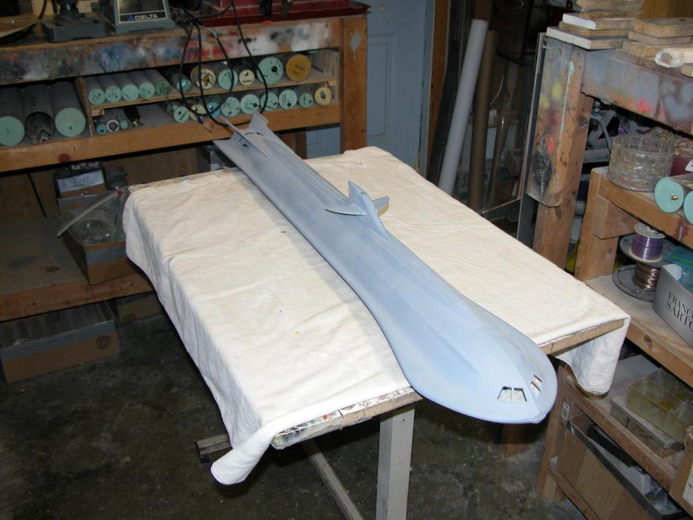

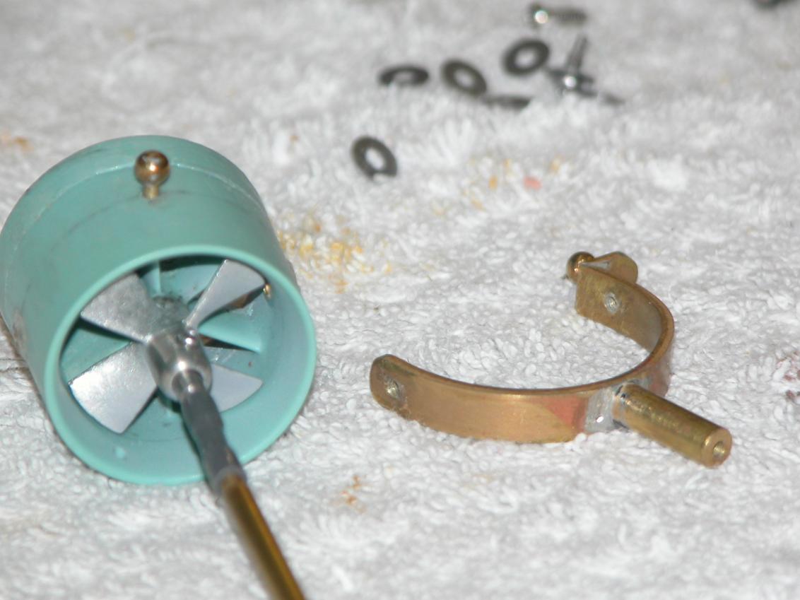

      Me? I like making weird things work well in the water. Below is the Rick Teskey kit r/c'ed.

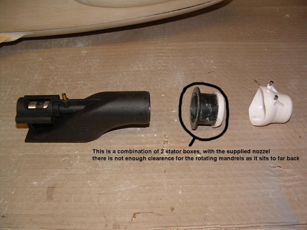

        Ok Heres the first thing, The kehrer I was going to send is junk as they have upgraded it anyway. this is what you will need.
        And this is what I had to do to make it conform. So You would have to order a spare Stator box as well.

          Will do. I'll get that unit and take it from there.

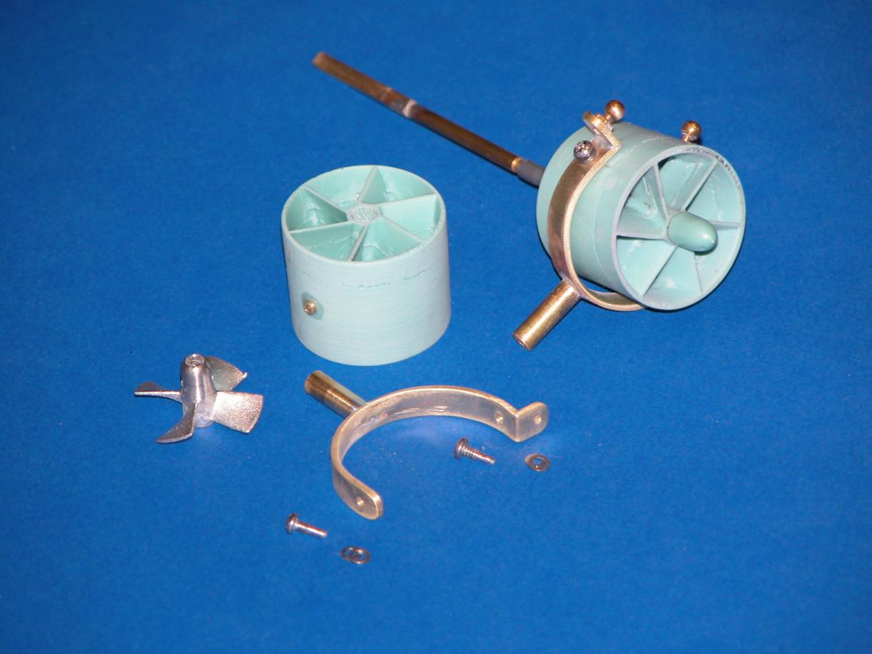

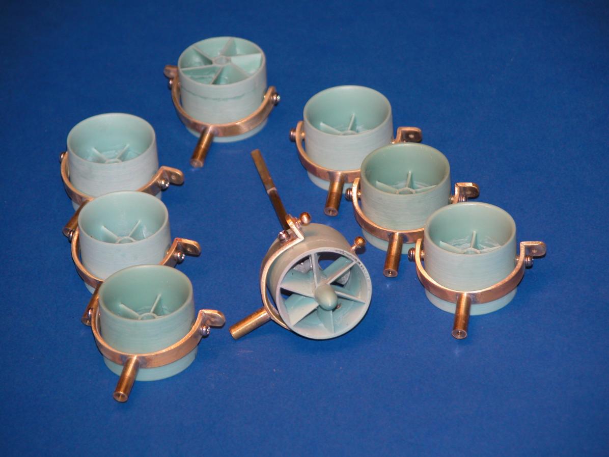

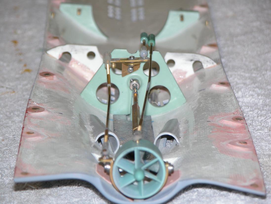

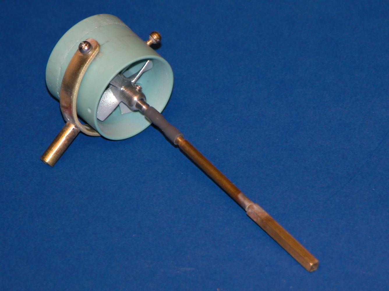

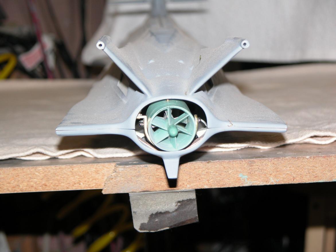

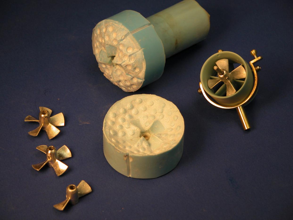

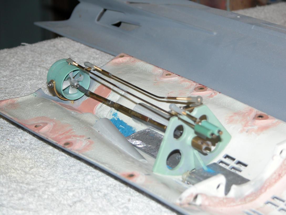

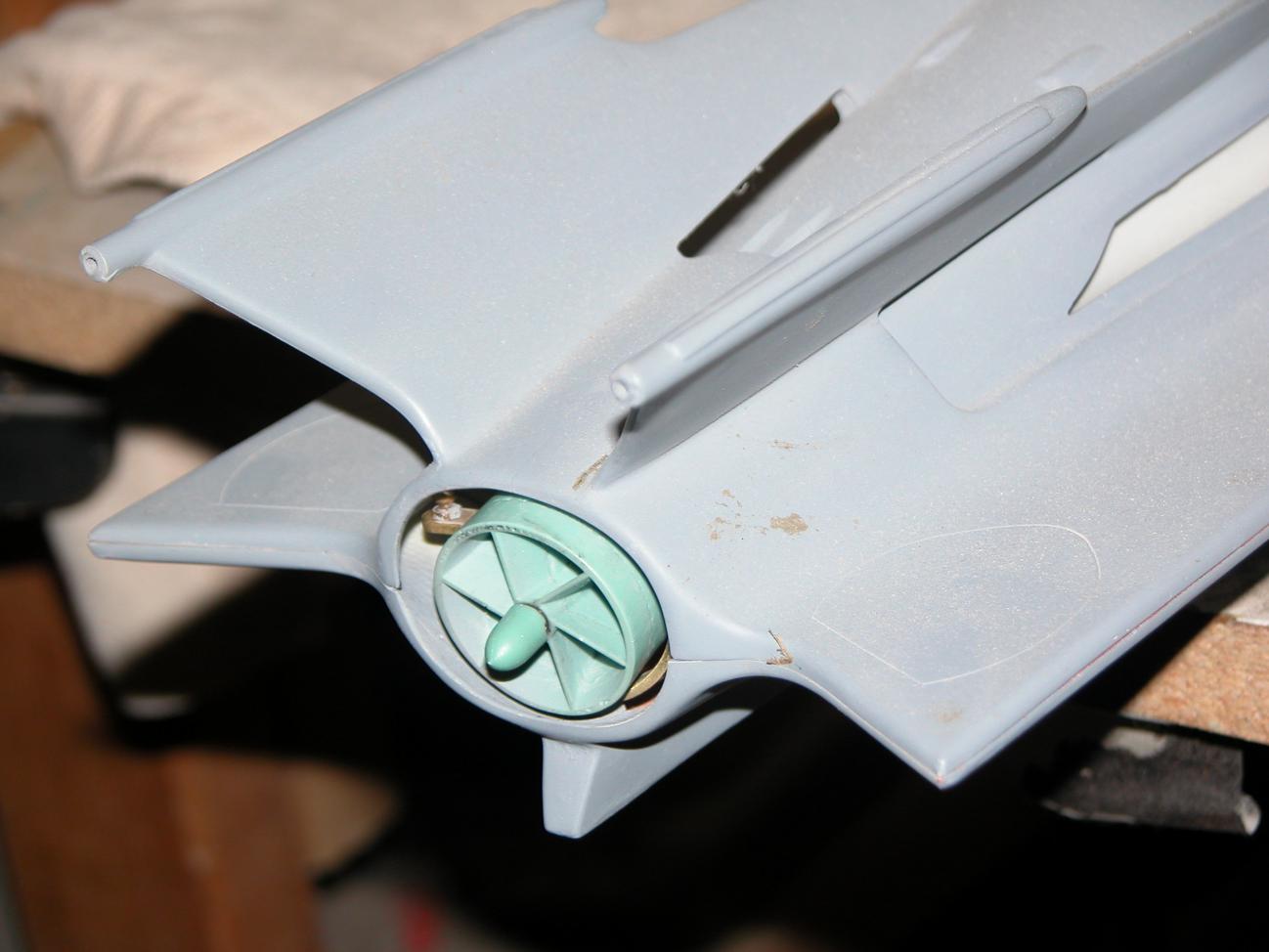

          I also realize, after examining that ad photo of the pump-jet nozzle, that the nozzle is not gimbaled -- it only provides for one-axis pointing of the stream. Yaw only. I'll have to work up a two-axis gimbaled nozzle that will fit over the stator tube and not get in the way of your RateMaster drive wheels. That will happened when I get the parts in hand and can size things to work within the geometry presented.
          Below are shots of the two-axis PJ I worked up to steer and dive the DeBoer Concept-2 SEAVIEW model:

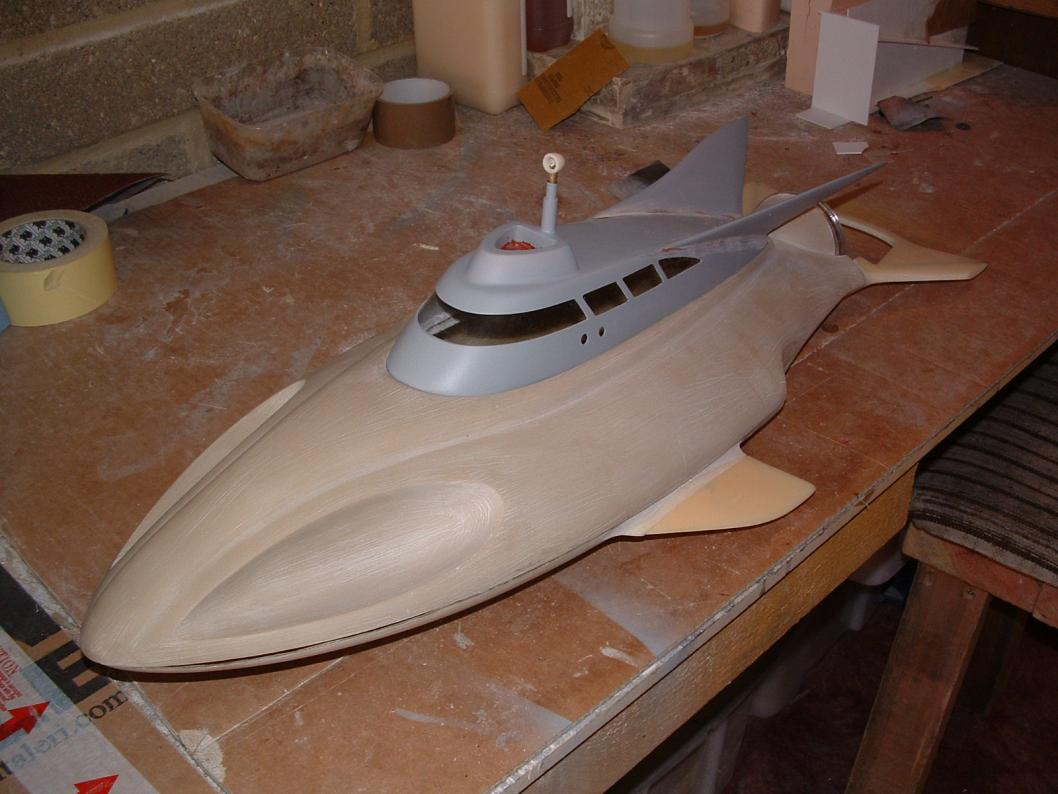

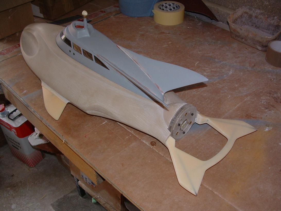

            That's an interesting Seaview model, looks like the next evolution, I like it.
            What effect do you think the cabin wings will have on the dynamics of the model when submerged?

              Yeah, I'm worried about those two big dorsal fins too, Captain. They look to have positive incidence to the boats longitudinal centerline. They're very close to the boats CG, a bit aft of it, so the pitching moment is short and they won't be much consequence to the dynamics of the thing. But, man! the drag they will introduce!

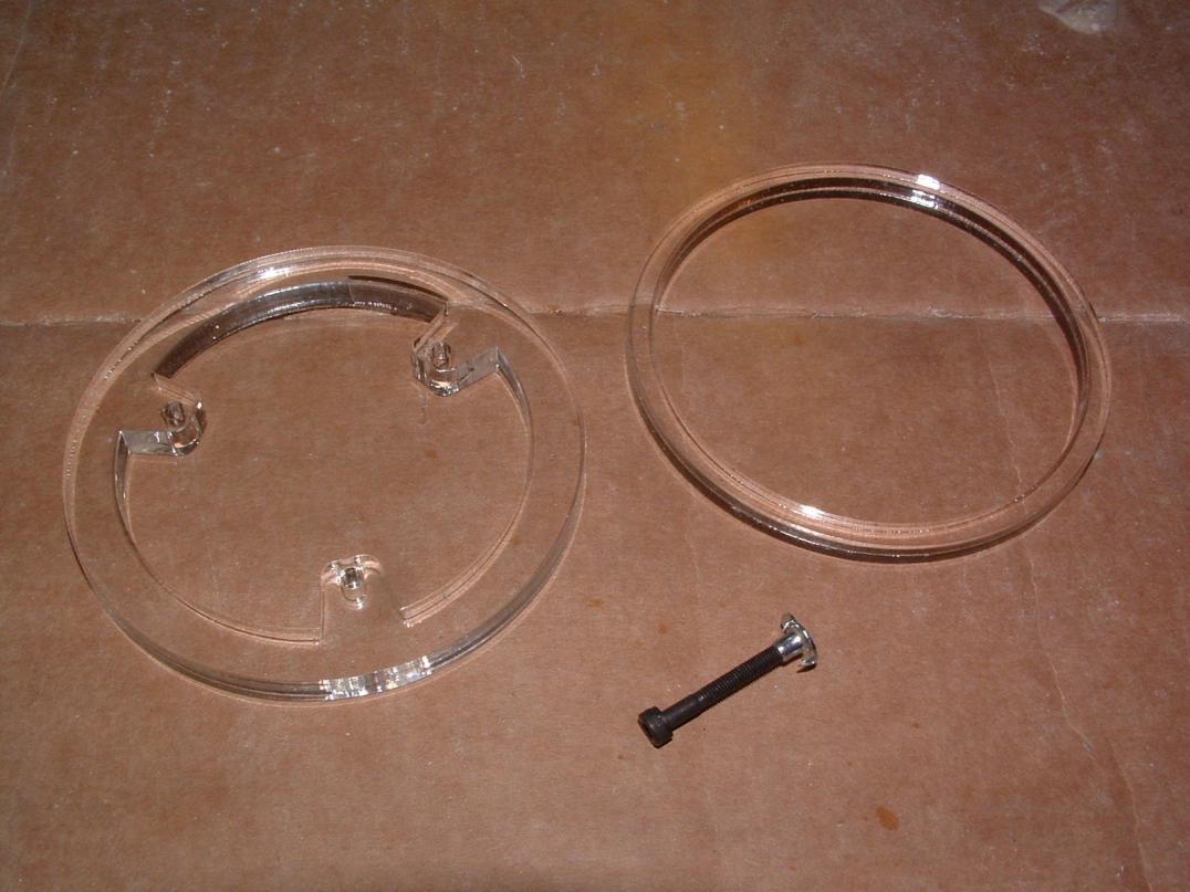

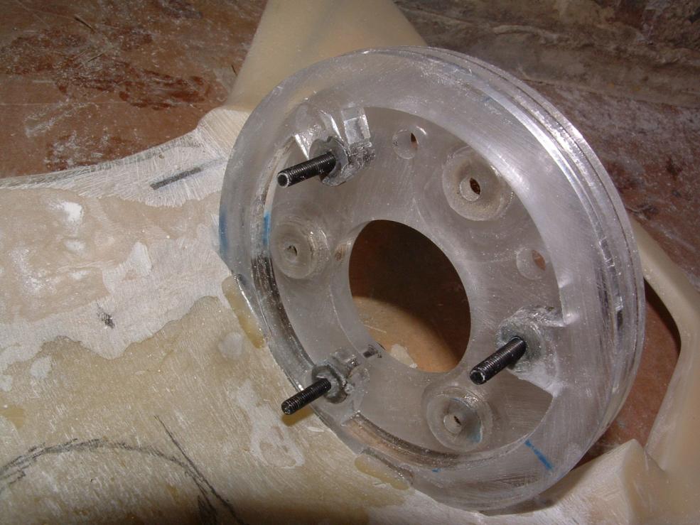

                                The RM housing rings as supplied will need to be glued together with solvent weld. Three Blind nuts will need to be fixed to the back so the modular part, whatever its function can be inserted using three screws. I heated up the blind nuts and pulled them into place and reinforcing with Superglue. As you can see quite a neat little affair. Next the jet installation.
