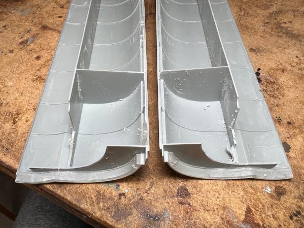

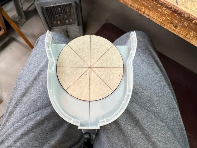

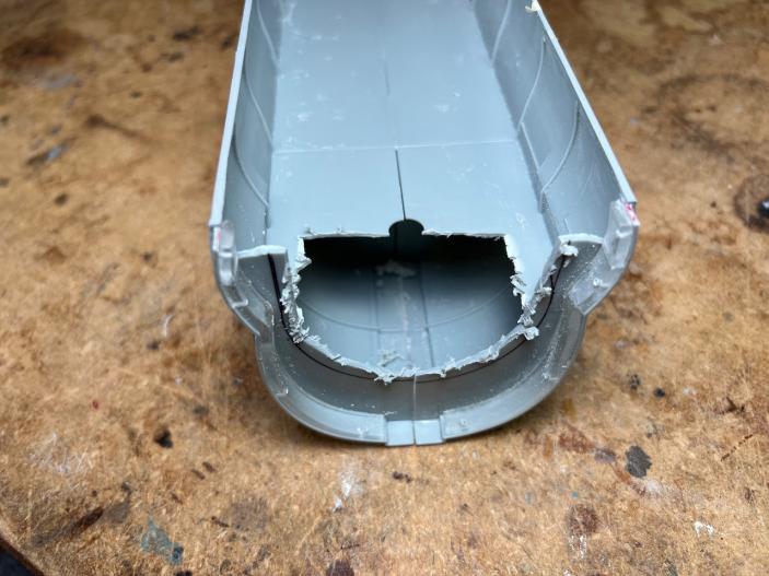

      Cutting away the box
      Positioned the disk template where to begin cutting away the internal support structure.

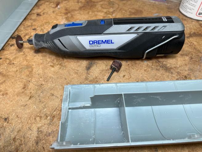

      And began cutting with the Dremel abrasive disc
      Used the Dremel drum sander to clean up and get it down to the drawn line. Trial fit the SD in position.
      The central support cleaned up.
      Got this 8250 for Christmas. Before I used it thought about returning it but didn't. I love using it over the corded ones. Highly recommended to have in the shop.
      Box cut away with abrasive wheel.

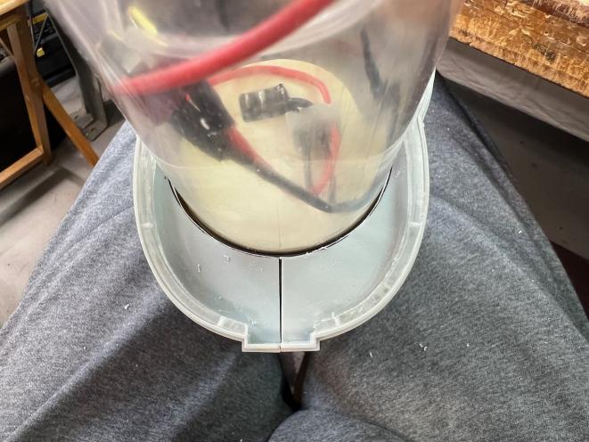

      Trial fit of the SD. I left some of the box as support for the hull to maintain some rigidity.

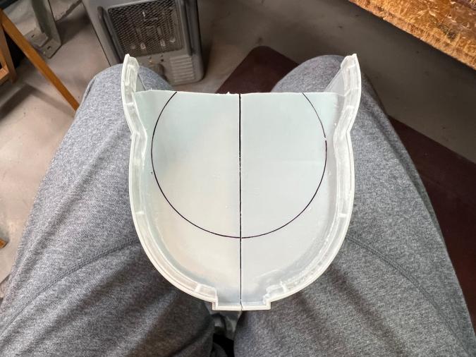

        I fashioned templates from scrap card stock of the interior. I used the aft section of the hull, placed it on the card stock and drew a general outline (no picture of this). This gave me an interior outline to work with. It was easier to draw half the hull, fine tune the shape and make a second half and tape them together. There will be three foundations, one forward, one glued to the center support and one aft. The forward and middle one are identical.

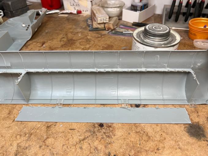

        Rough cut from 0.1" Plastruct styrene.

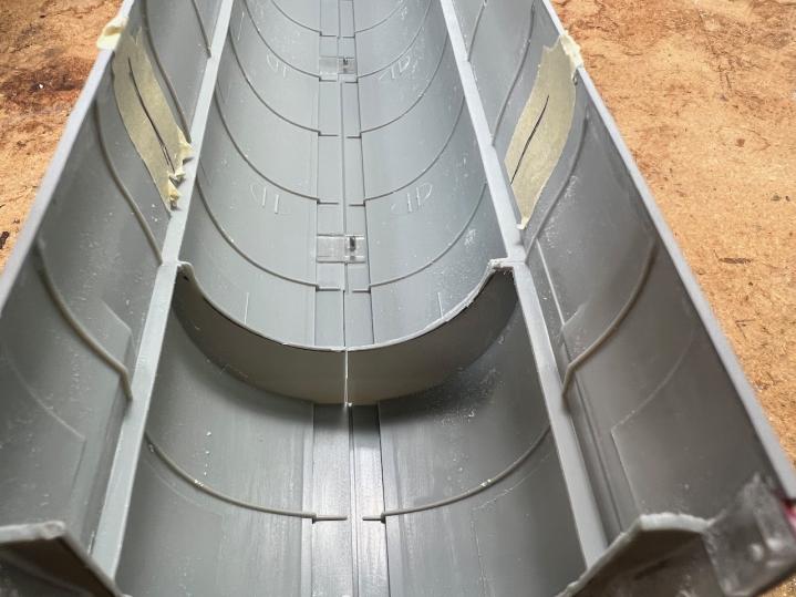

          Sub Driver Foundations Part 2

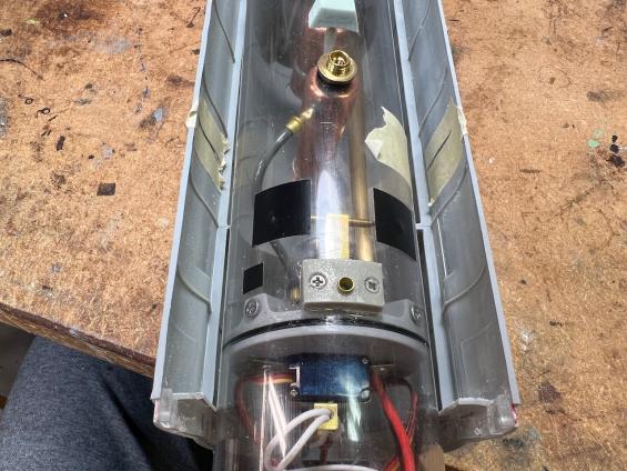

          Now that the SD foundations are cut to shape, they need to be fastened to the hull. Since the four hull sections are bolted together, each of the three foundations will need to be glued to certain parts of the hull sections. Two of them will be glued to the port forward section and one will be glued to the port aft section.
          With the hull sections bolted together they were all glued in place with the usual solvent. Here the forward foundation is attached to the port forward hull section. Note that the hull section on the port side had a cutout for the rib that I left in place. For the starboard hull section which will be bolted on, I added a reinforcement where the rib is since that portion of the foundation is thin and would be weak. The top piece is a pivotable section which will be a hold down for the sub driver.
          Click image for larger version  Name:	B_IMG_9703.jpg Views:	0 Size:	52.1 KB ID:	189402
          Here the hold down is pivoted upwards. The hold down is three layers of styrene. There is enough friction on the starboard side that no pin would be needed to lock it down. Besides, once the deck is in place, the deck will not let the hold down move.
          Ya think I over engineered this??? LOL
          Click image for larger version  Name:	C_IMG_9705.jpg Views:	0 Size:	54.3 KB ID:	189403
          From the backside.
          Click image for larger version  Name:	D_IMG_9707.jpg Views:	0 Size:	55.9 KB ID:	189405
          The pivot point.
          Click image for larger version  Name:	E_IMG_9729.jpg Views:	0 Size:	53.8 KB ID:	189408
          With the SD in place.
          Click image for larger version  Name:	F_IMG_9708.jpg Views:	0 Size:	54.1 KB ID:	189404
          And locked down. Again the deck will lock down.
          Click image for larger version  Name:	G_IMG_9709.jpg Views:	0 Size:	53.3 KB ID:	189406
          The aft foundation with lock down lever. One lock down lever forward and one aft since this is a 22 inch long SD.
          Click image for larger version  Name:	H_IMG_9726.jpg Views:	0 Size:	52.4 KB ID:	189407
          Click image for larger version  Name:	I_IMG_9727.jpg Views:	0 Size:	52.4 KB ID:	189411
          Click image for larger version  Name:	J_IMG_9711.jpg Views:	0 Size:	55.6 KB ID:	189410
          Click image for larger version  Name:	K_IMG_9713.jpg Views:	0 Size:	53.7 KB ID:	189409
          Nice to see an internal cross section view.
          Click image for larger version  Name:	L_IMG_9715.jpg Views:	0 Size:	59.4 KB ID:	189412
          Click image for larger version  Name:	M_IMG_9717.jpg Views:	0 Size:	56.0 KB ID:	189414
          Click image for larger version  Name:	N_IMG_9720.jpg Views:	0 Size:	54.1 KB ID:	189415
          Here is the mid section. No hold down lever needed here.
          Click image for larger version  Name:	O_IMG_9731.jpg Views:	0 Size:	53.8 KB ID:	189413
          Before I glued them in I scanned the foundations. In a few posts I'll posts those scans. If anyone wants to build the XXIII, they can used those scans to make the SD foundations for themselves.
