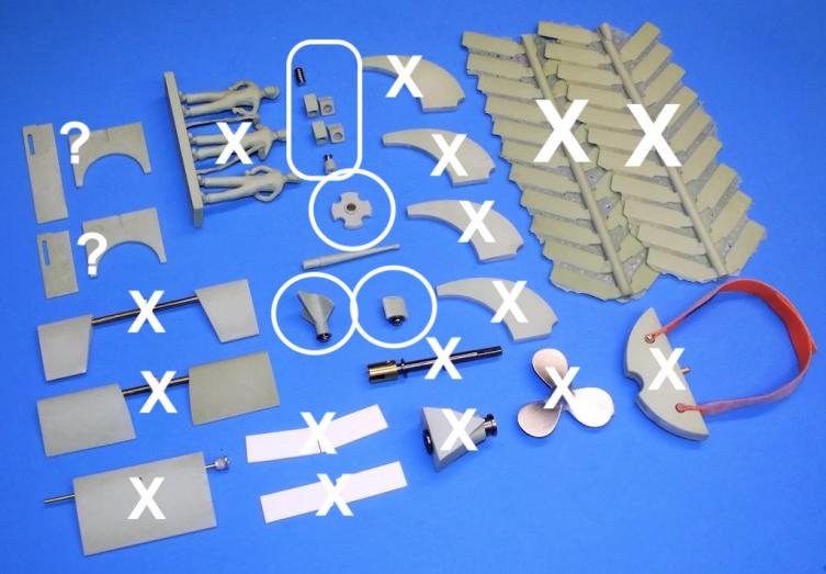

    If I look back at David's fitting kit, at this point I have already made most of what was in the kit, those with the X. The figures, do not need. Not sure what the question mark items may be for, or the ones that are circled. The ones in the square, not sure either, but I suspect something to do with attaching the sail to the deck. Maybe magnetic contacts?

      I’m sure David will chime in, but IIRC, the two items on the left were for mounting a camera in the tower.
        • 14011
        #138
        Yup.

          Gotcha, thanks David. I will not be using those. At least for now, may make some other type in the future.

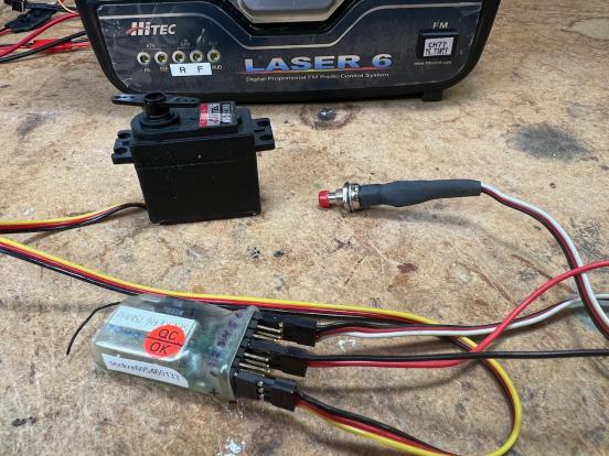

            I added a wire to extend the antennae to the Sombra SL-8 and connected a servo. Turned on the transmitter, then the receiver with the plug. Waited a minute or more for the receiver to sync to the transmitter. No luck when I move the transmitter channel. No response at all.
            Click image for larger version  Name:	IMG_9928.jpg Views:	0 Size:	56.3 KB ID:	189670

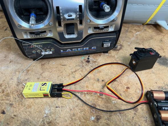

            Did the same with the Seeker6. Pressed the button and applied power to the receiver. Nothing.
            Click image for larger version  Name:	IMG_9926.jpg Views:	0 Size:	54.4 KB ID:	189669

              #141
              Did you put the bridgeplug on channel 8?
              • Ken_NJ
                • Sep 2014
                • 1006
                #142
                Yes I did. On both of them.

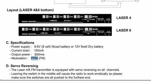

                        #146
                        Would they be PPM or PWM? I presume my older 75Mhz Hitec is only PWM. And it cannot be changed. If I had the Shadow Programmer like Manfred mentioned could the receivers be changed to PWM? Could not find the Shadow Programmer for sale anywhere (eBay)
                        EDIT: I'm apparently wrong, the transmitter specs are PPM.
                        Click image for larger version  Name:	Screen Shot 2025-08-19 at 9.38.37 PM.png Views:	0 Size:	97.4 KB ID:	189679
                        Laser 6 Manual
                        Then why is this not working? Hmmmmm
