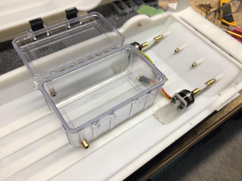

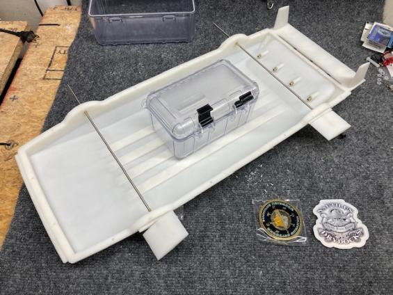

            Brass sleeves for the dive planes are in. Plenty of room for testing and motor placement. Dry box is going to be a bit tight so might need to scale the battery size back.
              18650's in the wet?
              • ffr2608
                • Oct 2009
                • 348
                That is possible but will try to get it all in the box. I could also add the low-profile s3 box to place the battery separately. Not ideal but possible.

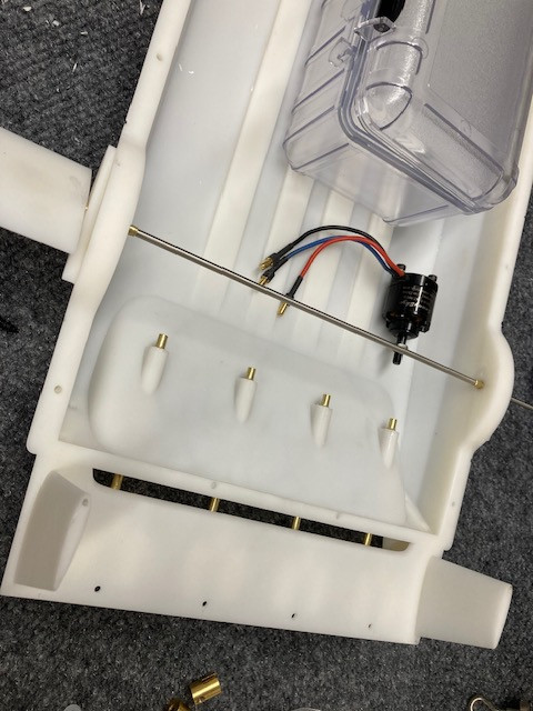

                        Motors mounted up and bonded to the hull. Decided to go analog from this point forward. Acrylic, brass, stainless and styrene. I did find some old Subtech SBS seals so I will be mounting the pressure box tomorrow.
                          This is looking solid. I'm still amazed about how small these motors are. Didn't know that existed. Very cool and keep it going please.
