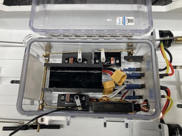

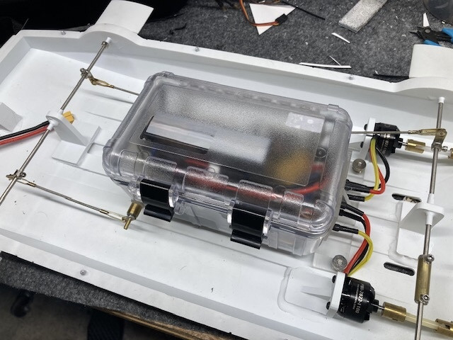

      Tub test went great. I got the motor control dialed in with the ability to pivot and hold position in a small space. Electronics box was bone dry so on to foam placement and ballasting. I plan to place the foam on the upper hull to keep things clean. She is currently a sinker but should be an easy job using a plastic tub in the garage.

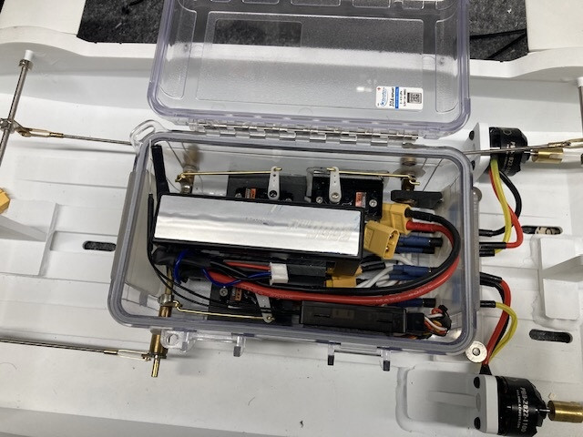

            Last bit of work on the electronics box. Going with a 2s 5000 to start and will add a cell if performance is too low. Foam is placed in the upper hull so time for a float test and ballasting.

                  Final tub float test. I have 1/8” of roof above the water for a good starting trim. Using Velcro in the corners to do the fine tuning. Radio box is complete and I was able to get the 900mhz antenna pretty vertical and the 2.4 at the highest point of the pressure box.
                  Lake test this weekend.
