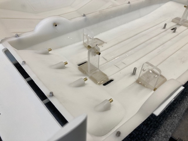

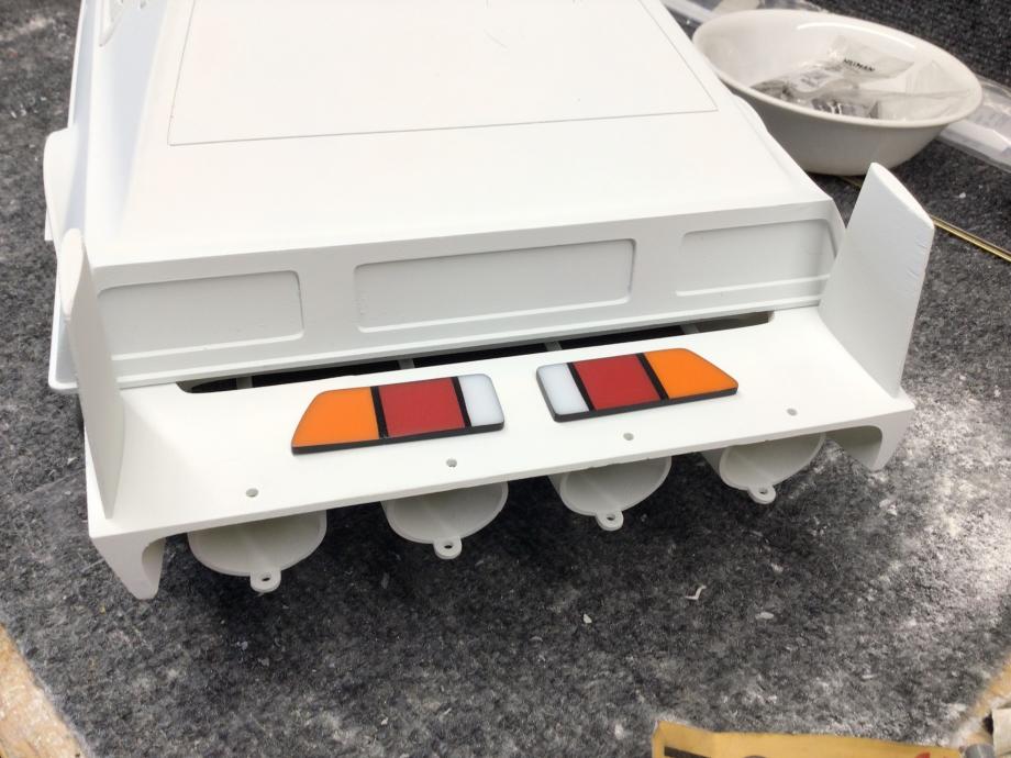

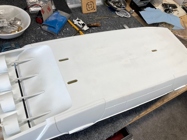

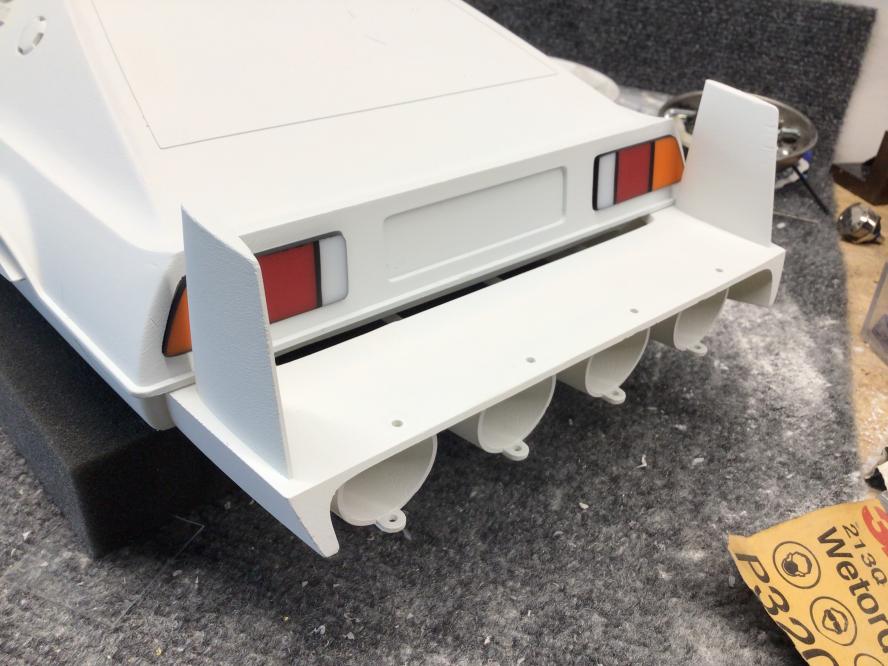

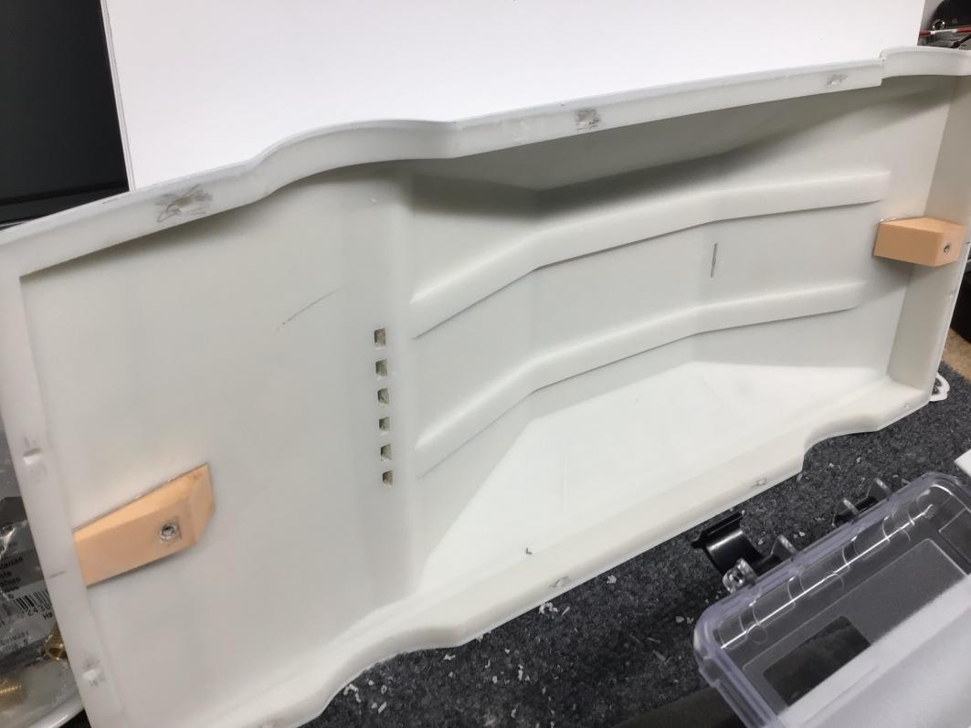

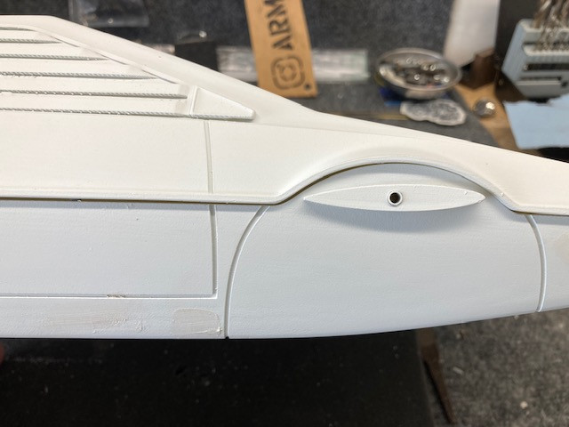

        More work on the limber and vent holes. I didn’t want to put too many on the bottom to screw up the visuals. Hull mating pins were a piece cake.
        I also built the taillights out of colored acrylic and painted a black perimeter.

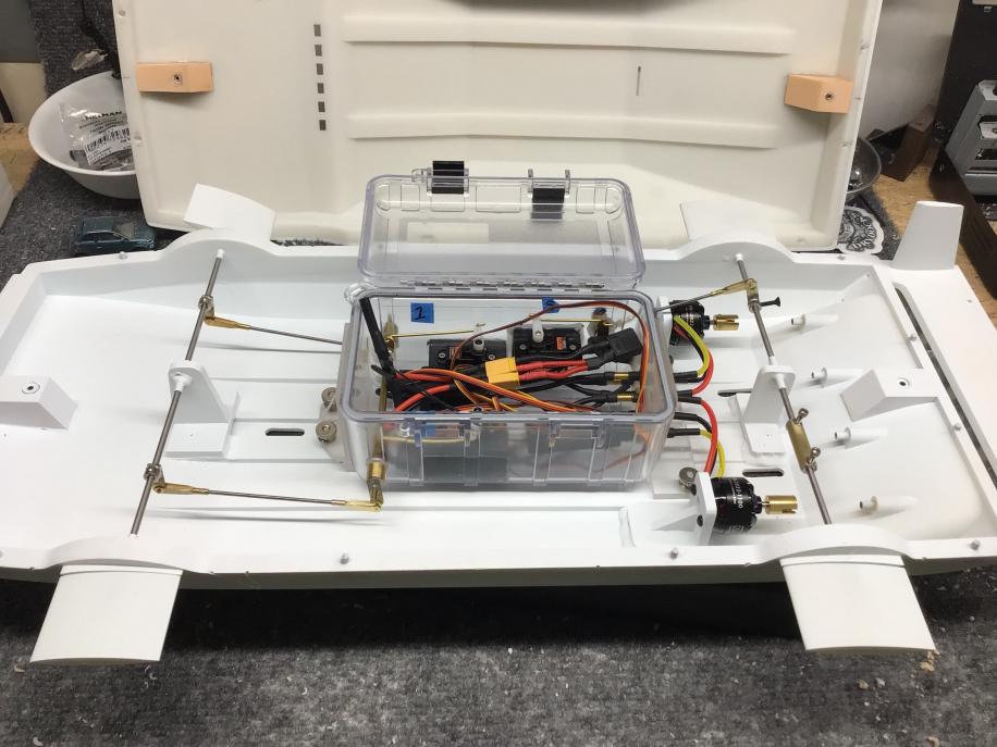

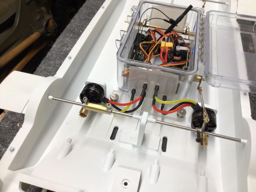

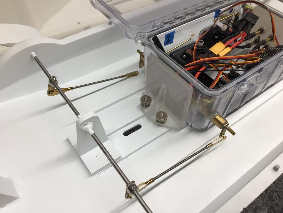

                Linkages are complete! I also built the hatch hold down mechanics using some brass threaded inserts front and rear with 4/40 hardware. The last task is to test propellers and set up the transmitter. I did get the X18 channels all mixed but need some help on limiting the throttle travel when turning. If anyone has experience, please PM me.
                Someone on RCGroups (named Submodeller) with a Proteus gave me advice and I’m wondering if he’s on this forum..

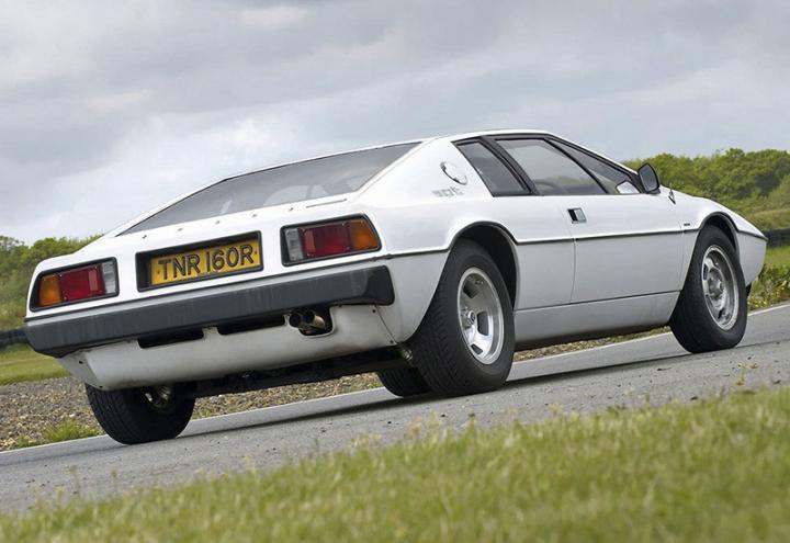

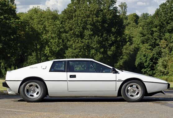

                    This is an absolutely fantastic project. I am very impressed with your progress so far. The real "wet Nellie" reportedly had a tendency to dive all the time due to the fact that a car (especially a high performance car like the Esprit) is designed for down force. This is very evident in the movie. At the end of every shot it is heading for the bottom and planes are usually deflected to full rise. Even the picture shown in the first post of this thread shows this. This is often a problem when real world physics meet fiction (like the Seaview). But this is part of the challenge that can be overcome.
                    I absolutely love the 3-D model that was created but I must point out a few flaws. Although the Esprit has an overall very angular appearance there isn't actually a straight line on it. In particular the windscreen (A pillar) is not flat but is curved and especially the rear window (C pillar) is very curved. The centre of the bonnet/hood on the model is raised where on the real car this part is indented up to the six hvac vents where it then rises above the bonnet line.

                            Schmitty, Thanks for the kind words and constructive criticism. As a 15 year CAD surfacer for a big car manufacturer, I can appreciate your eye seeing the differences between the road car and submarine model. I modeled the movie prop which has a TON of low spots, straight / negative lines and poor bodywork. It was a challenge to go against my training to build a body with correct curvatures and styling. That being said, I am aware of some compromises I made in the interest of time or oversight. Some will be rectified in primer.
                            Even the actual car is quite rough compared to its competition of the day. Look at how flat the glass and pillar surfaces read in these images. To be fair to Lotus, it was fiberglass so things have settled over the years.
