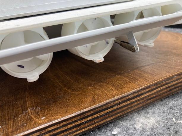

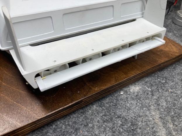

            Ready for the lake for testing. Based on Bobs excellent Lotus video,I went with a full length plane behind the props and added a control horn. I might attach it to the stern plane servo or adjust and fix it as needed.
            • Schmitty1944
              • Mar 2021
              • 136
              #81
              Clever idea. Something I noticed in Bob's video: when he gives it throttle the deflectors he added to the rudders keep it fairly level while under power since the thrust/prop wash is going directly over them but as soon as he lets off the throttle and the model still has forward momentum it's starts drastically pitching down. As previously mentioned this was a problem with the real Wet Nellie. The shape is not ideal for a submarine but I am really enjoying seeing the different ideas created and implemented. Proper job!

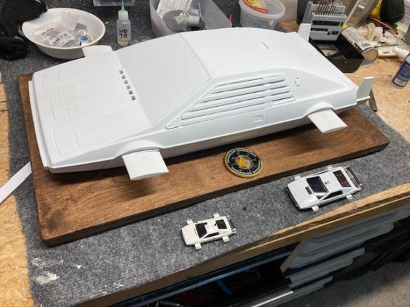

                First trip to the lake for some surface testing. I need to get away from the silty water but happy with the initial performance. This body of water is 600 miles long so I am hesitant to get crazy here.....I plan to tune at Subfest with the assistance of the pros..... Extra linkages will be brought to try different control arrangements.

                      Leaving the boat in white primer for Georgia but added some car wrap to the glass surfaces. Better than nothing… I also added a linkage to the stern plane behind the thrusters. Now linked to the normal stern planes and may eventually get a leveler.
