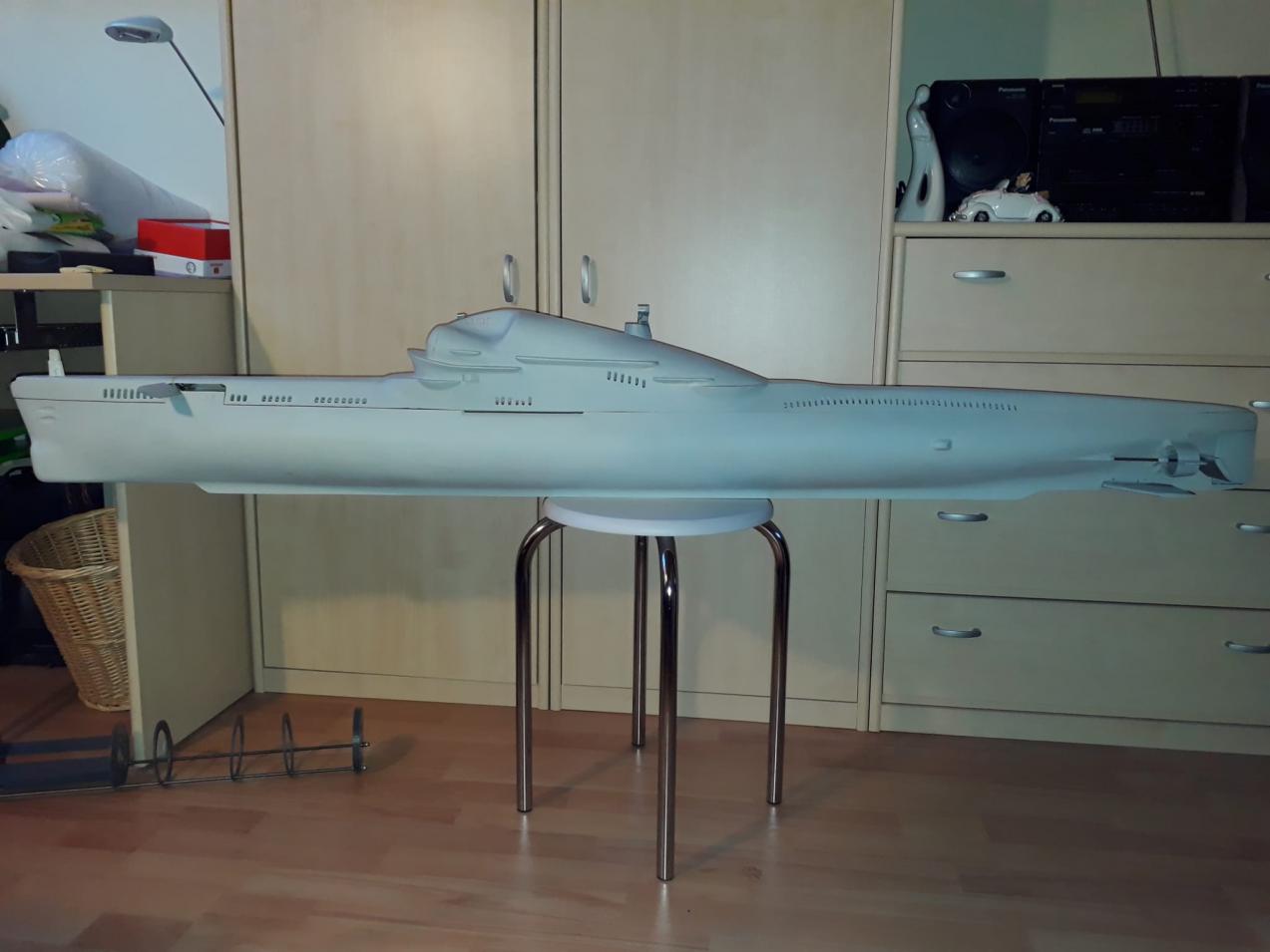

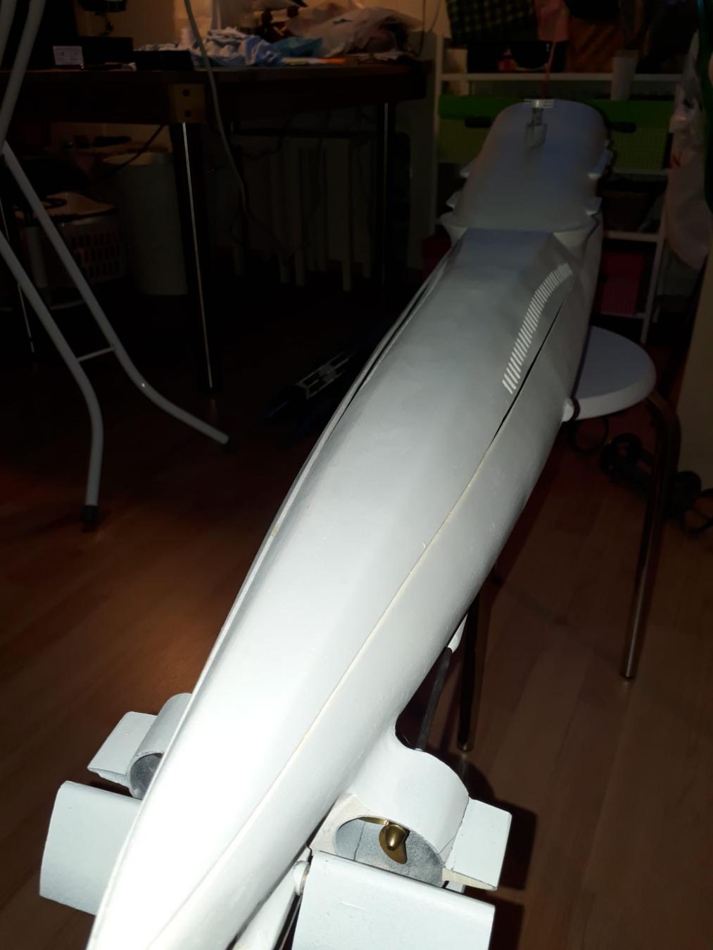

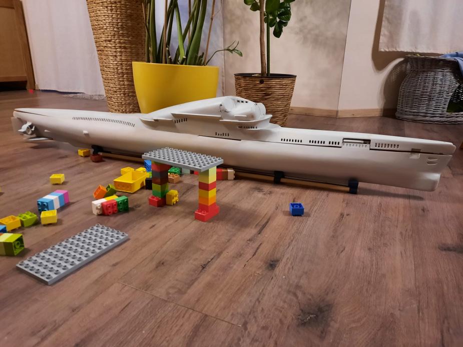

    Project 665 Whiskey long bin 1/50

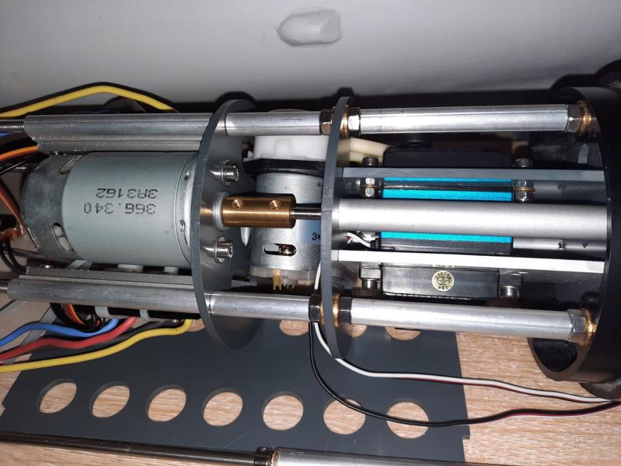

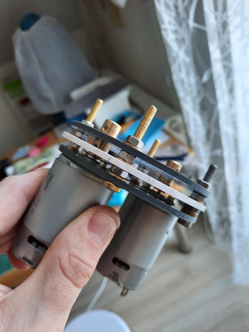

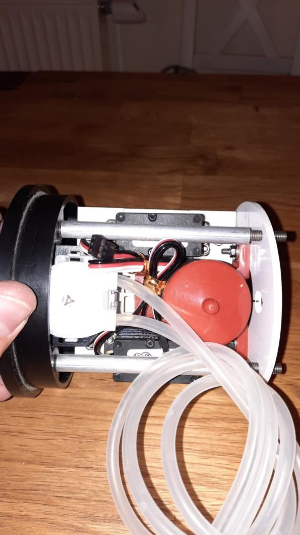

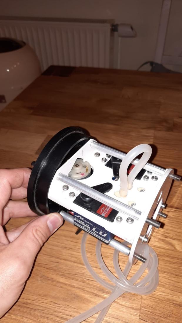

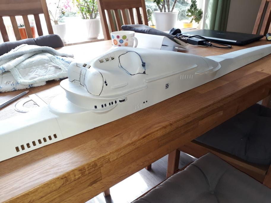

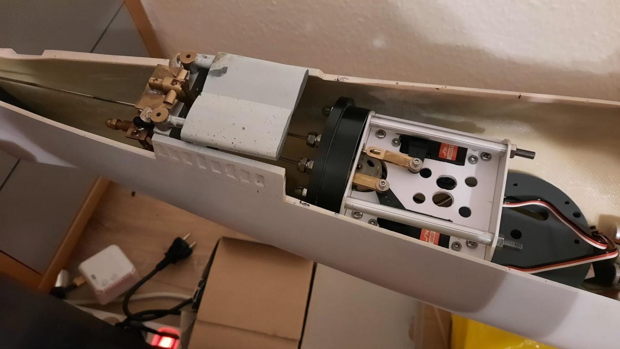

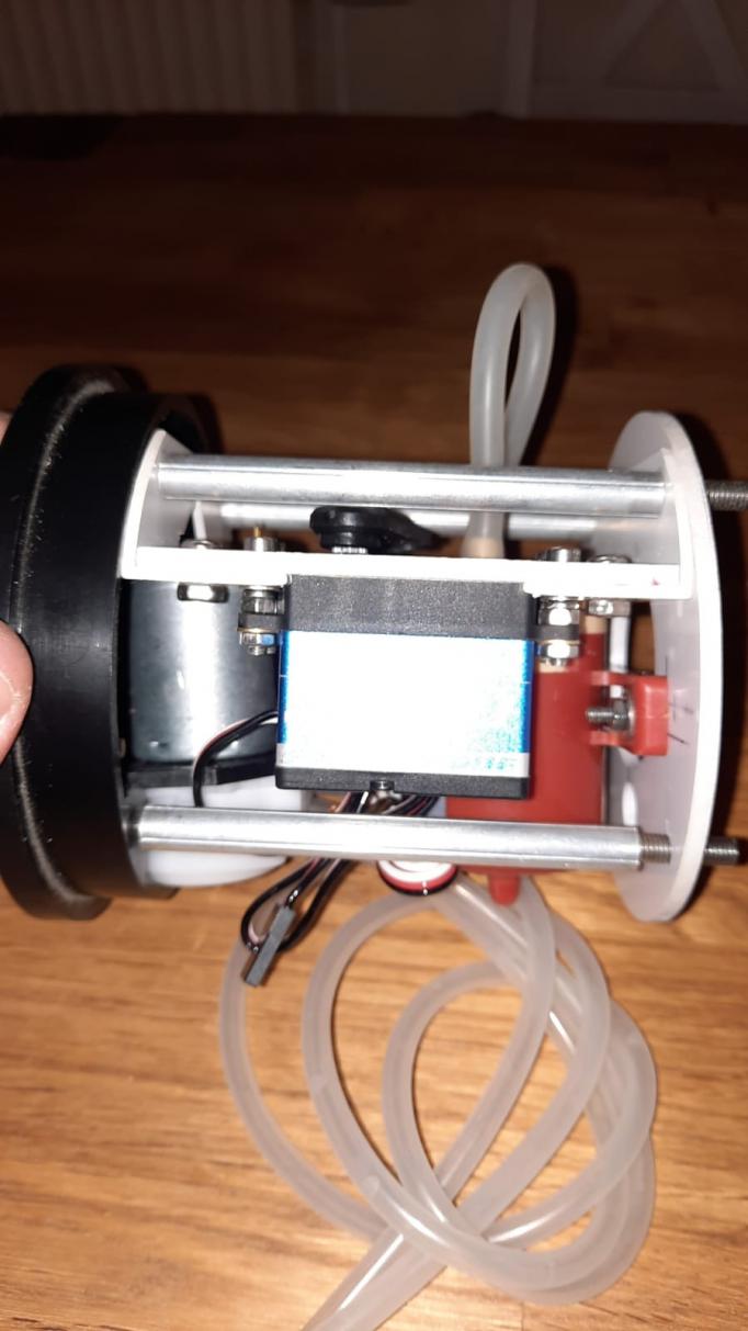

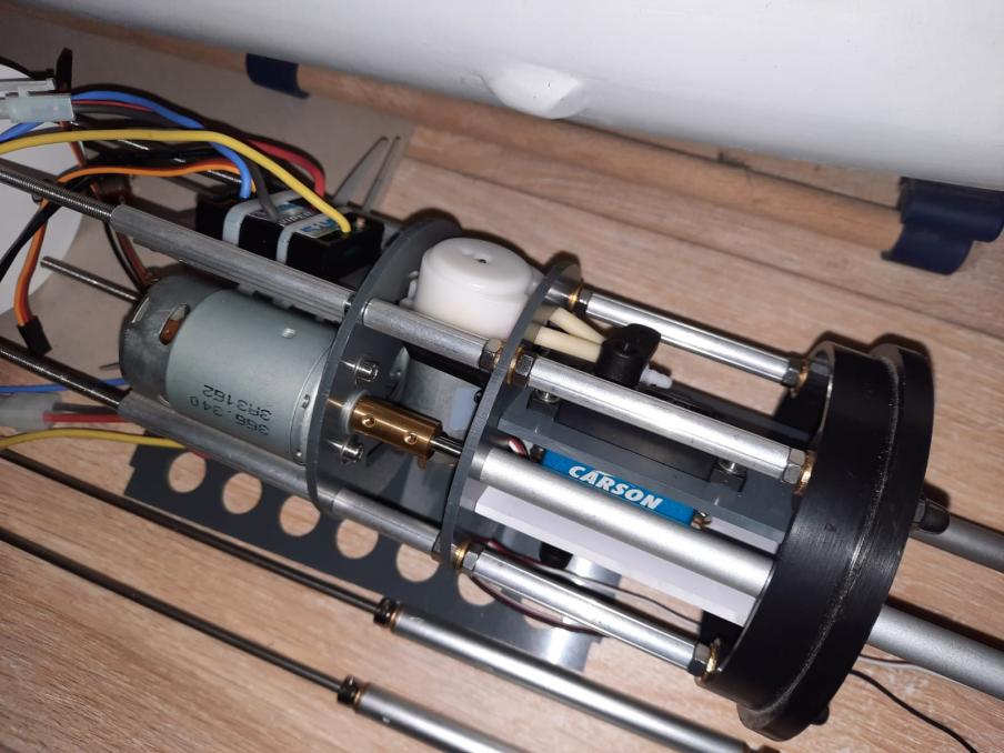

    Hi! This is a short presentation of the assembly and outfitting of the 1/50 Kit once produced by Mr. Lazar Kerzmann. I purchased it in 2018. It tourned out beeing the prototype that had been partially assembled by himself and soon was given to a fellow modeller who later returned it to Mr.Kerzmann. Originally build as a dry hull like the large old Engel kits, i am converting it into a wet hull with 2 dry compartments, a large snort balast tank, main drive and separate service battery, retractable bow planes, retractable masts.The pictures show the config with a small piston trim tank that will most likely not be installed finally. No newer pictures yet. The plane mechanism provided with the model was useless and had to be rebuild.

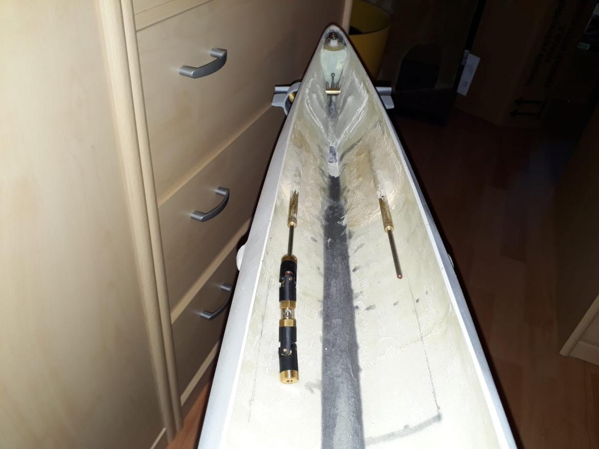

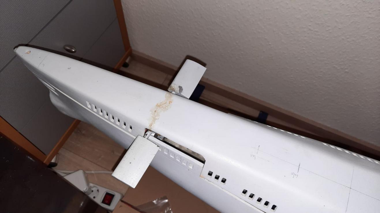

    Status as delivered :

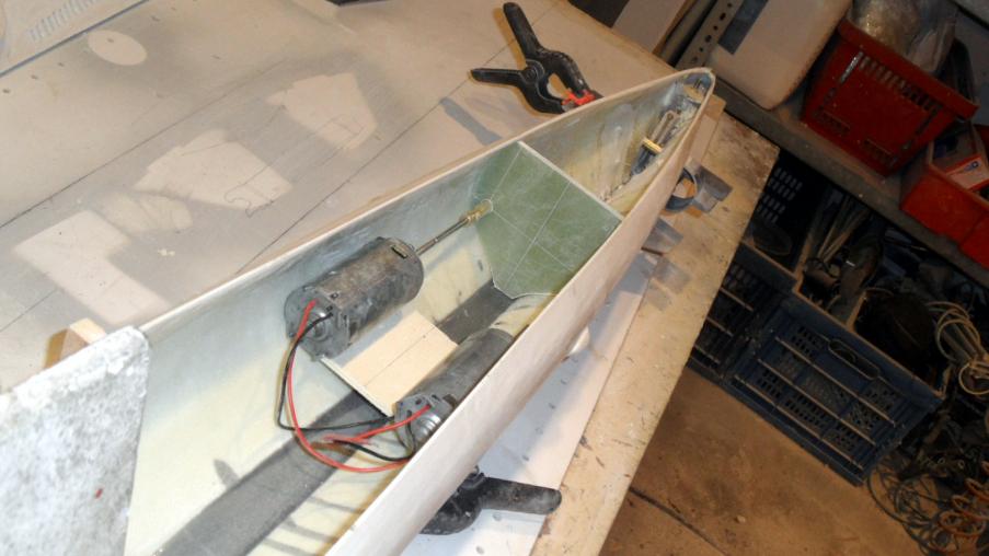

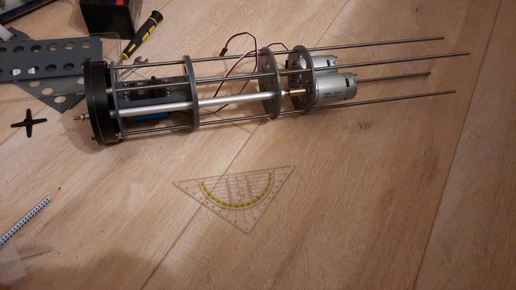

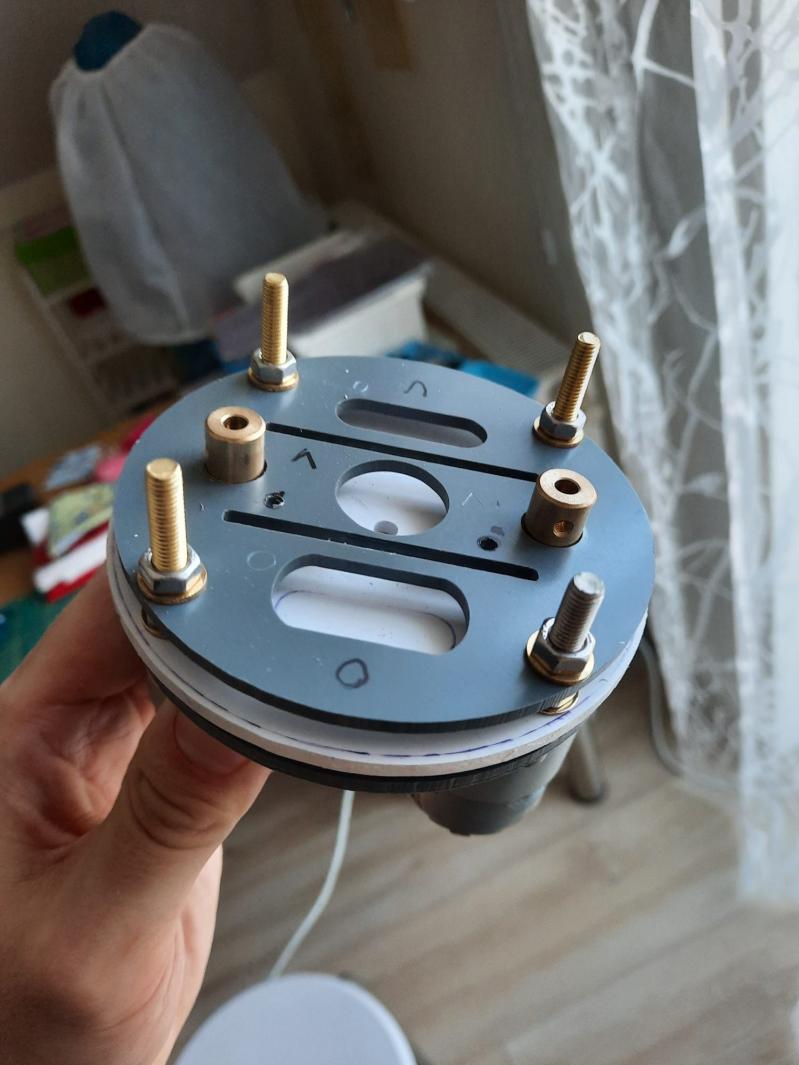

    Construction of the main compartment: Click image for larger version
ID:	172900Click image for larger version
ID:	172899Click image for larger version
ID:	172905Click image for larger version
ID:	172906Click image for larger version
ID:	172907Click image for larger version
ID:	172898Click image for larger version
ID:	172902Click image for larger version

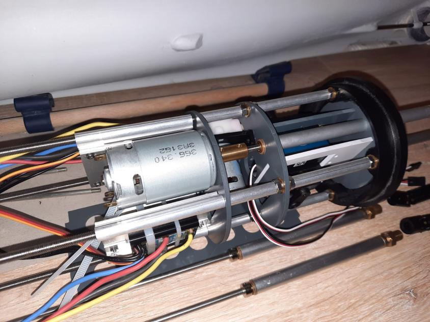

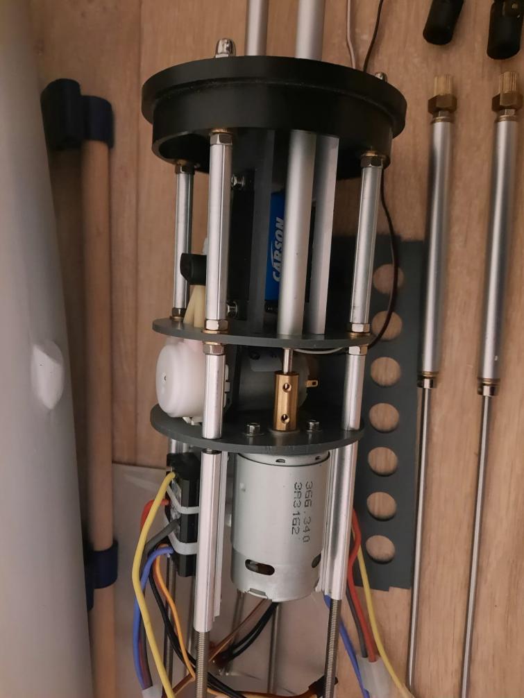

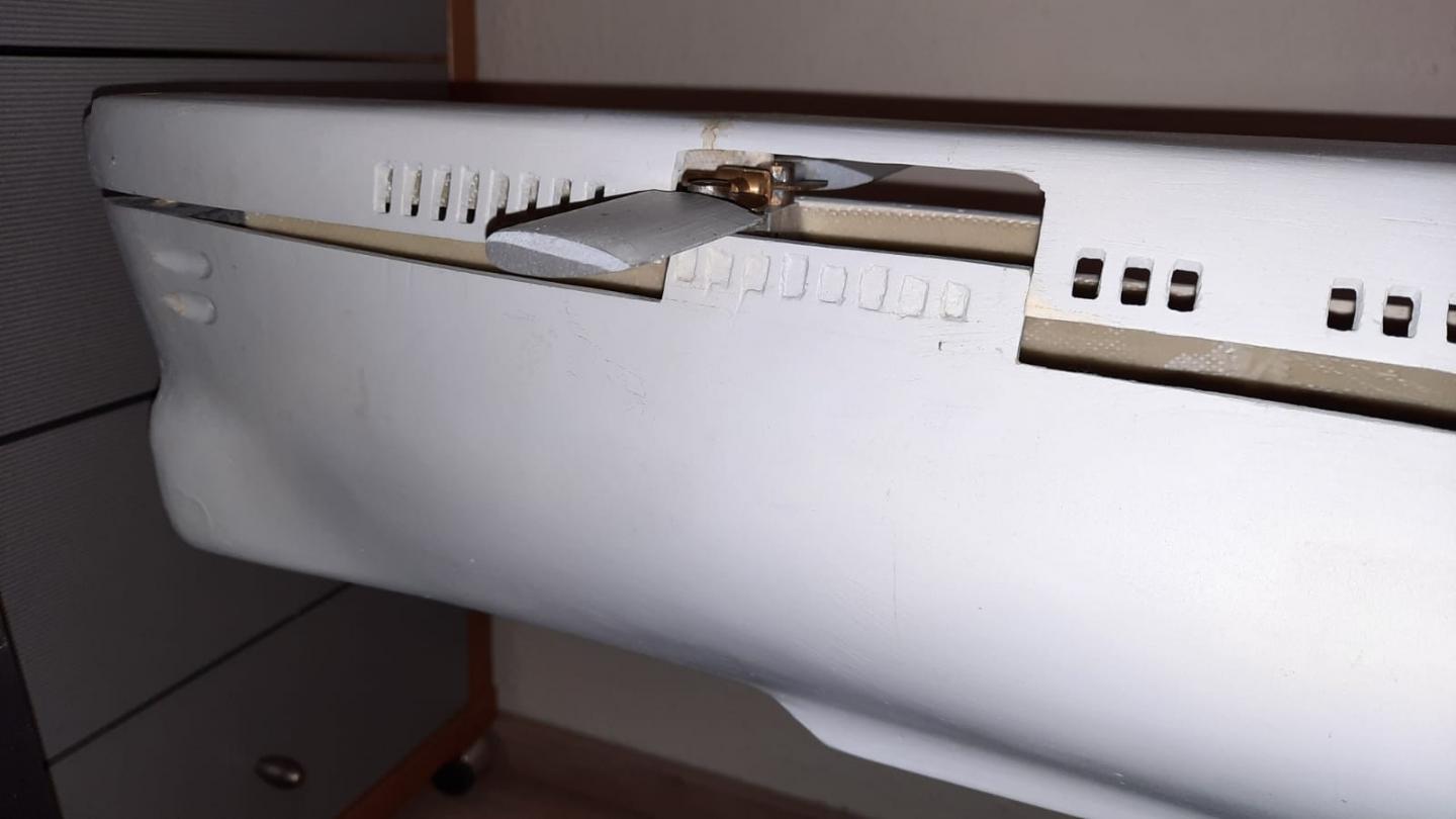

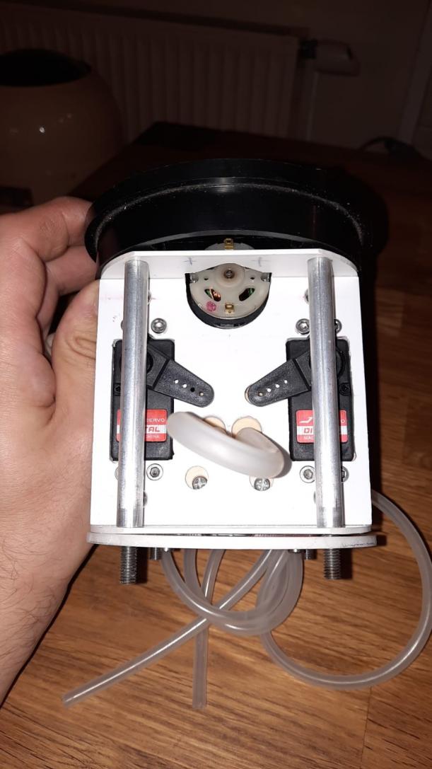

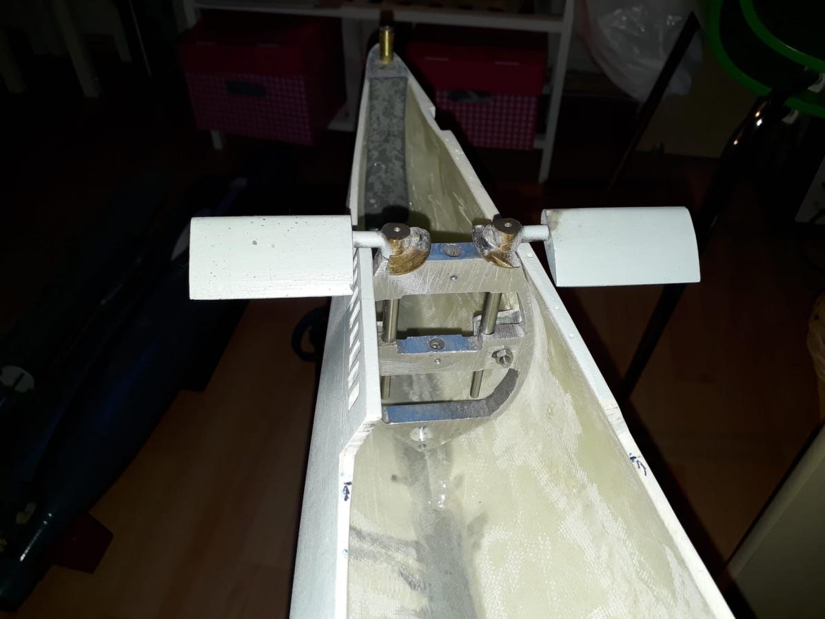

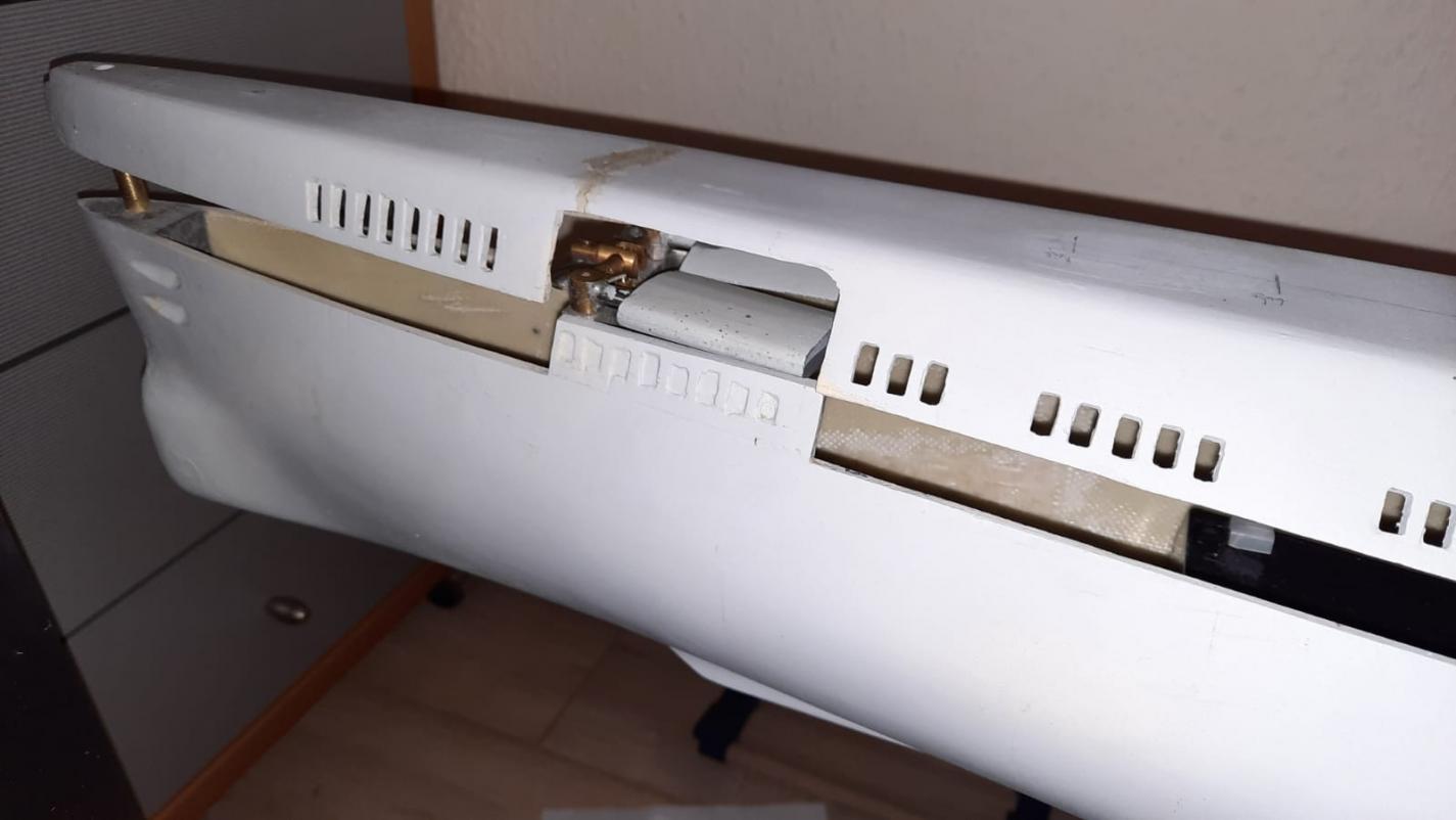

    forward compartment for bowplane and mast operation:
ID:	172916Click image for larger version
ID:	172917Click image for larger version
ID:	172918Click image for larger version
ID:	172919Click image for larger version
ID:	172895Click image for larger version

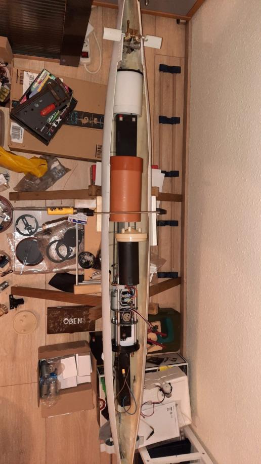

    Overview of the principal layout, no wtc cylinders in place:

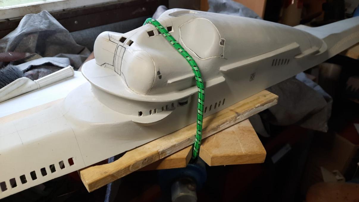

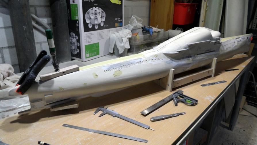

    working on the upper hull: Click image for larger version
ID:	172904Click image for larger version
ID:	172908Click image for larger version
ID:	172910Click image for larger version

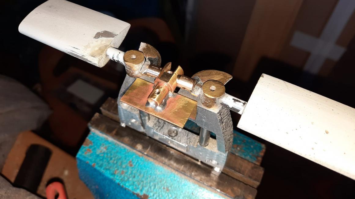

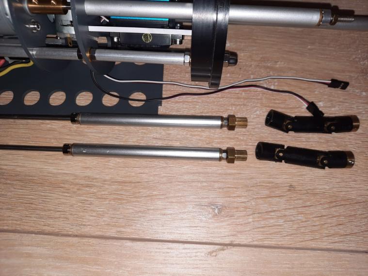

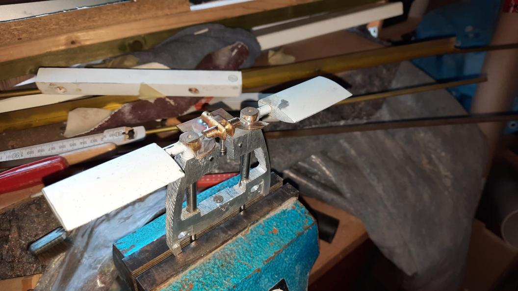

    Reconstruction of the foldable forward planes: Click image for larger version
ID:	172901Click image for larger version
ID:	172903Click image for larger version
ID:	172909Click image for larger version
ID:	172911Click image for larger version
    Not yet on show are the changes to the main compartment.i will delete the trim tank and its roller pump for saving space, mostly for safety concerns. That boat will have a slighly positive bouyancy, gollowing Bob's suggestions about large boats in his book. Will also shorten the compartment. The pre-installed stern tubes were cut free from the surrounding epoxy with a specially self-made cirkular saw and shortened a lot more, too. This helps moving the balast tank further to the boats centre. The gear for the rudder has been replaced with a normal rudder lever.

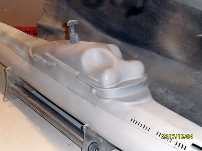

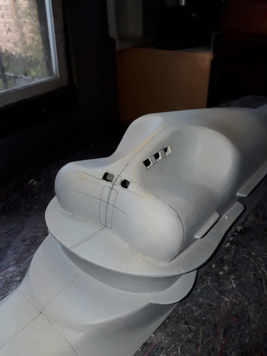

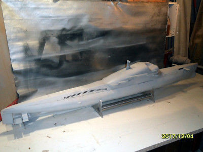

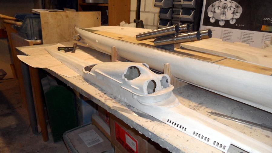

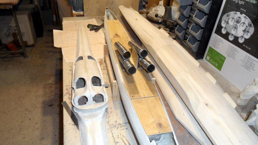

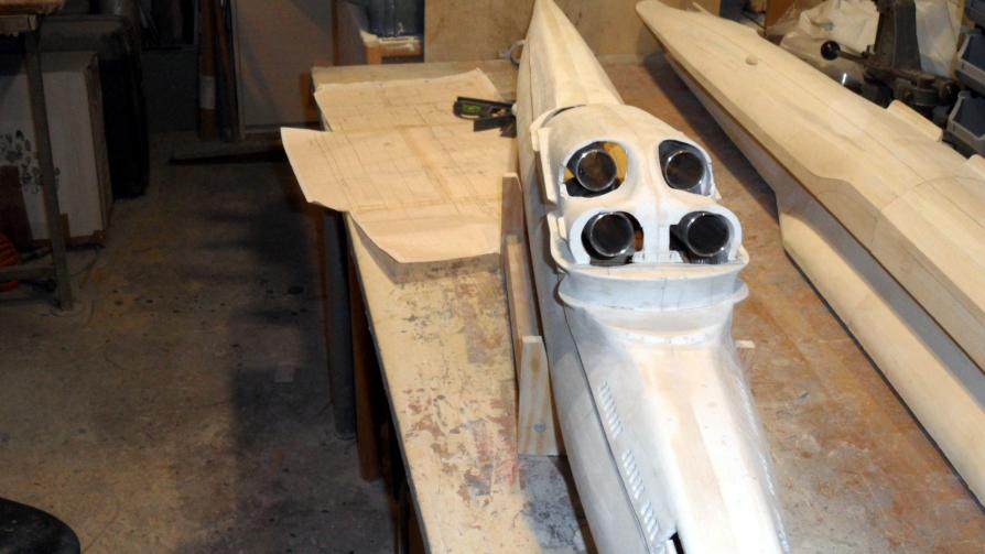

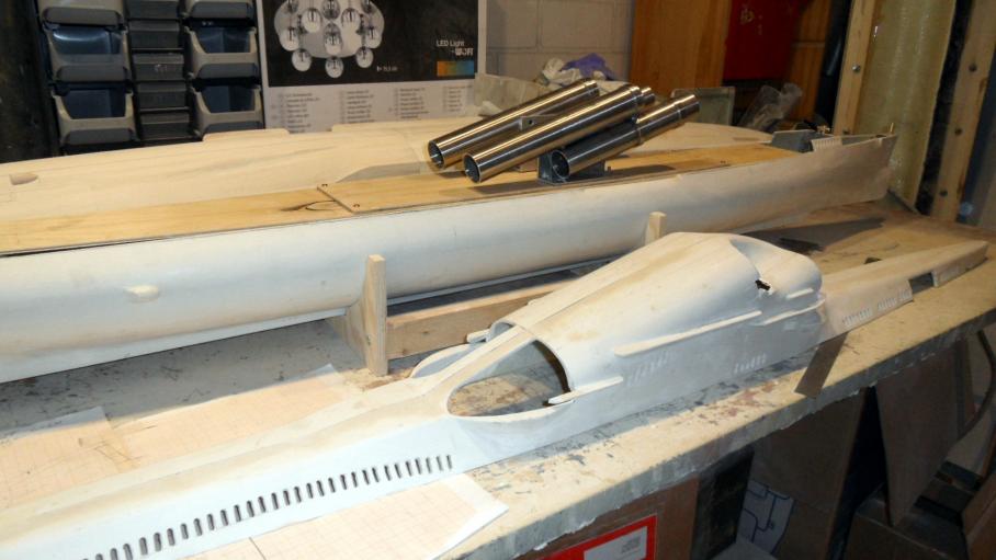

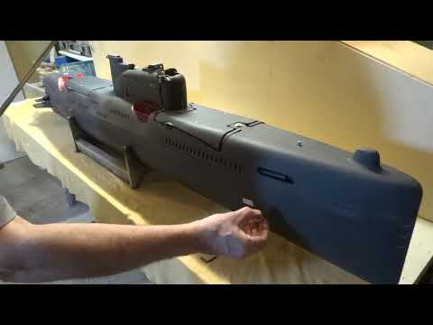

                Lazar Kerzmann had a build report on a russian forum, showing how he made the master, the hull halves, and assembly of the model. He intended to install four launch tubes from stainless steel, but later sealed, filled, saded and primed all the openings he cutoff the sail prior to selling the boat to me. Click image for larger version
ID:	173067Click image for larger version
ID:	173068Click image for larger version
ID:	173069Click image for larger version
ID:	173070Click image for larger version
ID:	173071Click image for larger version
ID:	173072Click image for larger version
ID:	173073Click image for larger version

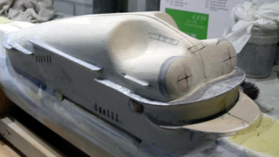

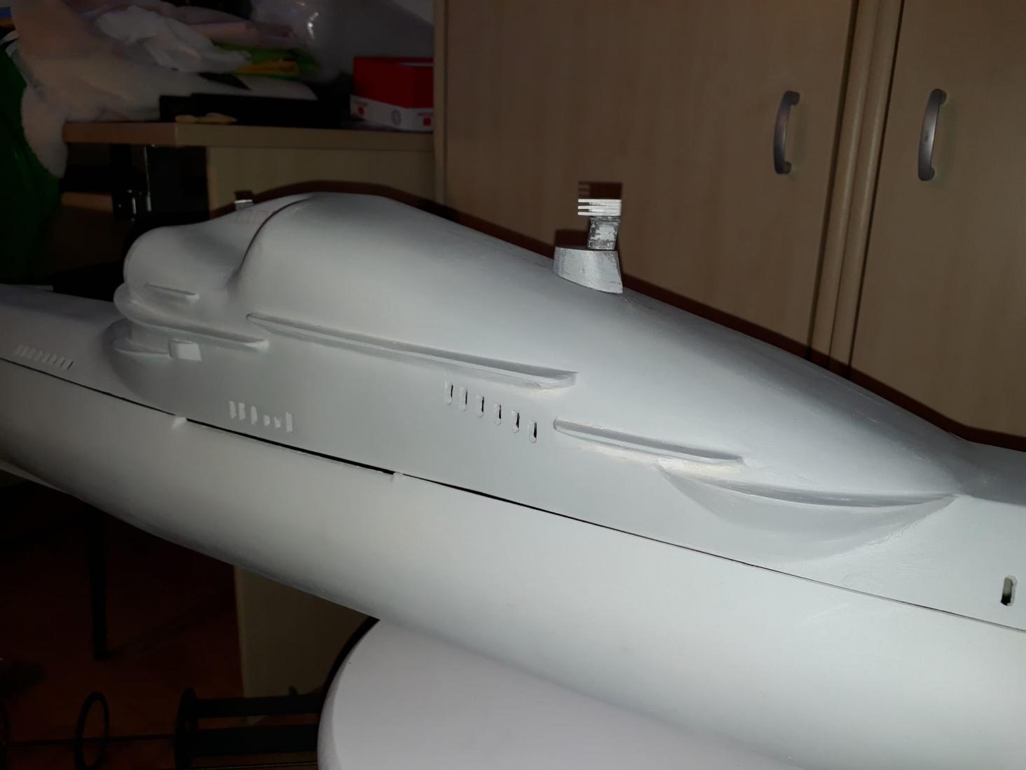

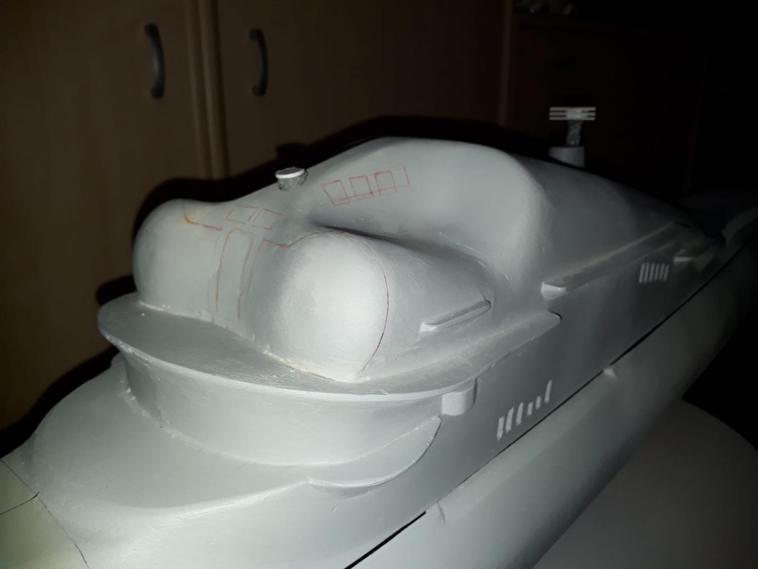

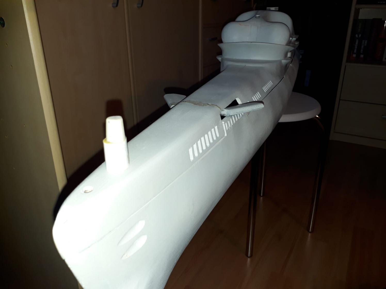

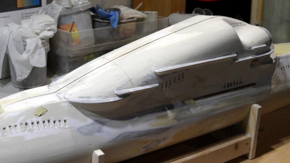

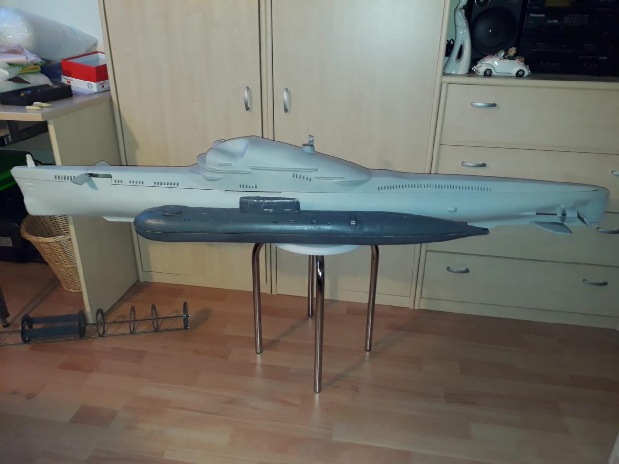

                  Dug these pics out from my previous mobile. From 2018, i remade the sail lantern, forward underice sonar and exhaust.
ID:	173077Click image for larger version
ID:	173078Click image for larger version
ID:	173079Click image for larger version

                    I admire the ability of Ruissians to design every bit of elegance out of a submarine...
                      Did he intend to make the launchers functional (pyrotechnically) ?
                      • JHapprich
                        • Oct 2017
                        • 1121
                        Yup. Every bit of function of the launchers was to be at display. You'd look for the 651 juliett he made, search on youtube
                          Found it. Wow! He even has a Golf https://youtu.be/3CgdrDgvoeY

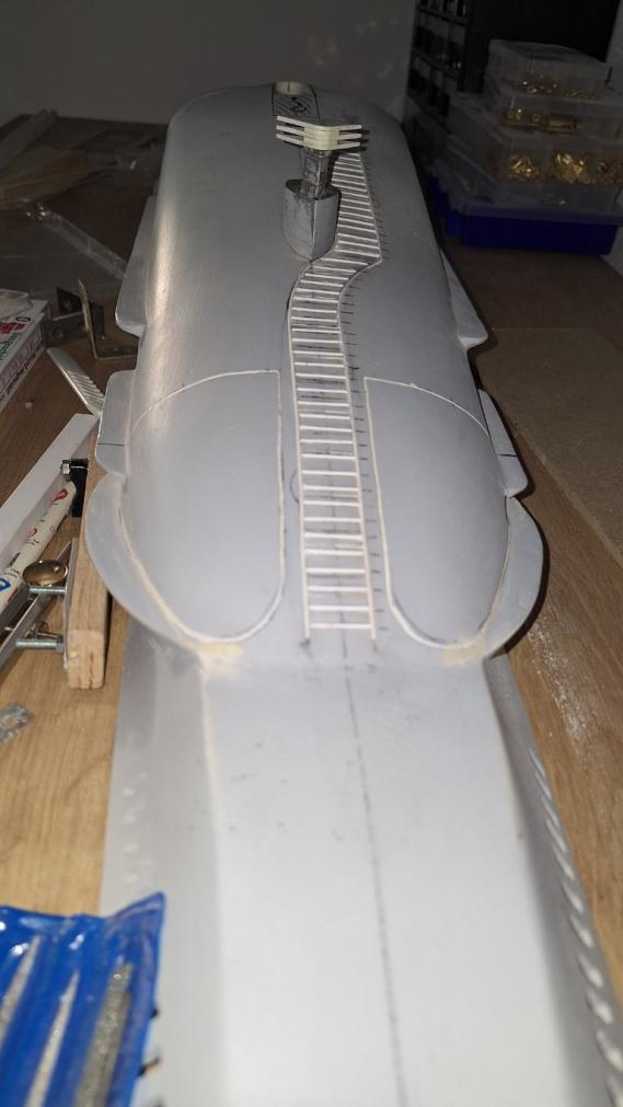

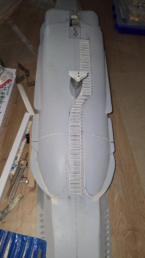

                            Distinctive walkway... Click image for larger version
ID:	183606 Click image for larger version
                              I have never seen that kind of boat before. Very unusual looking and a very good job.
