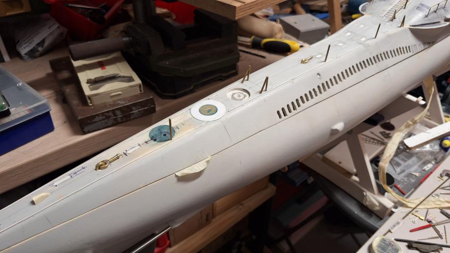

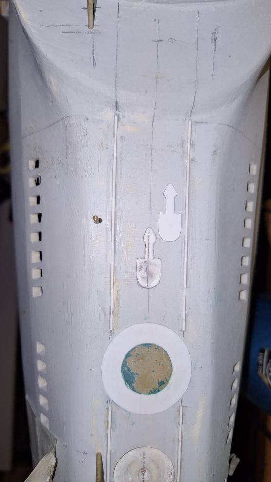

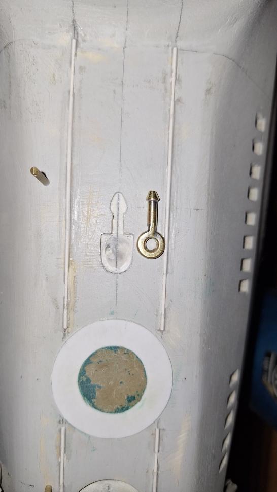

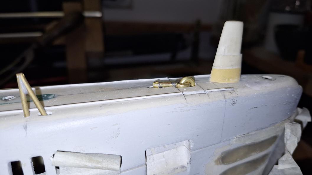

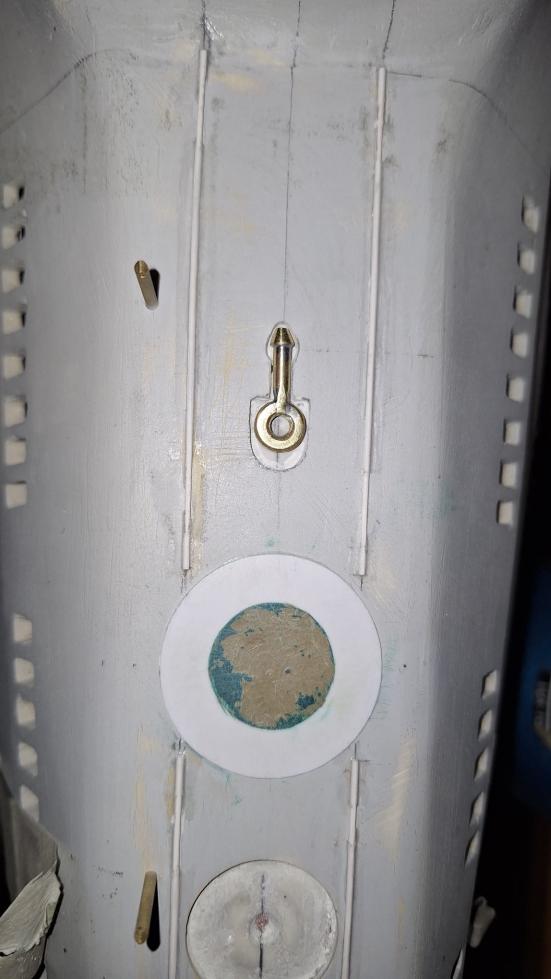

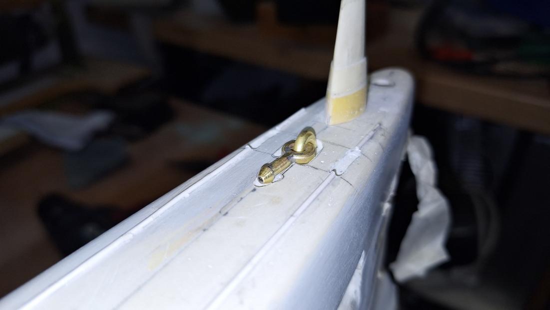

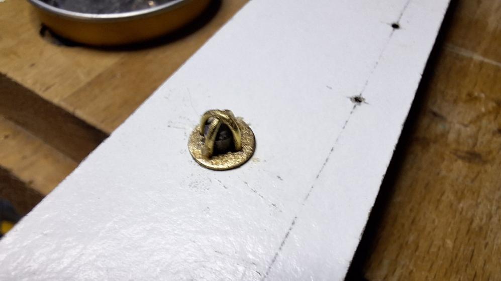

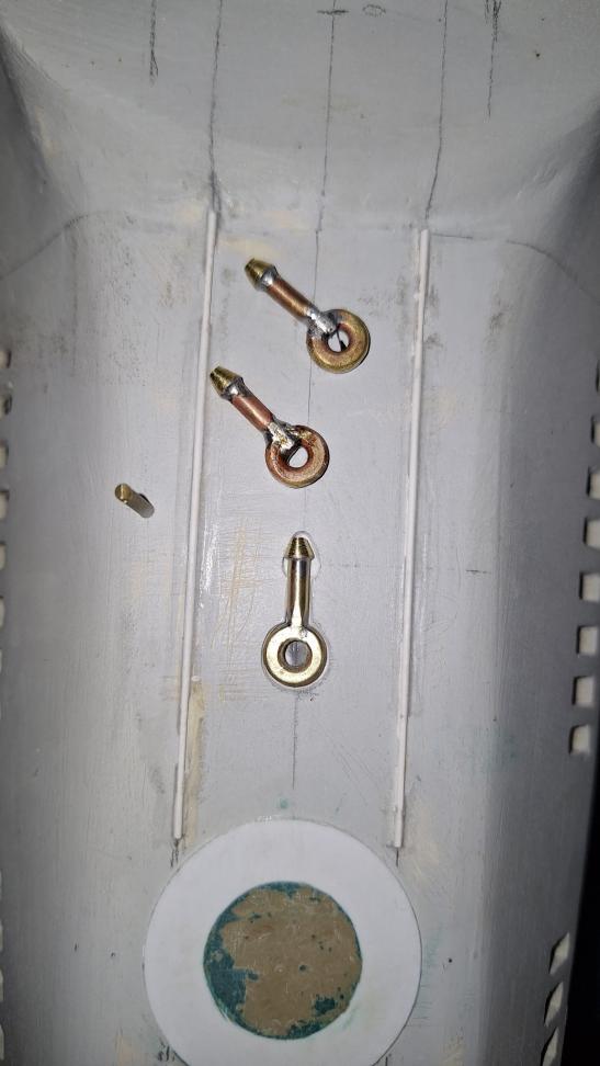

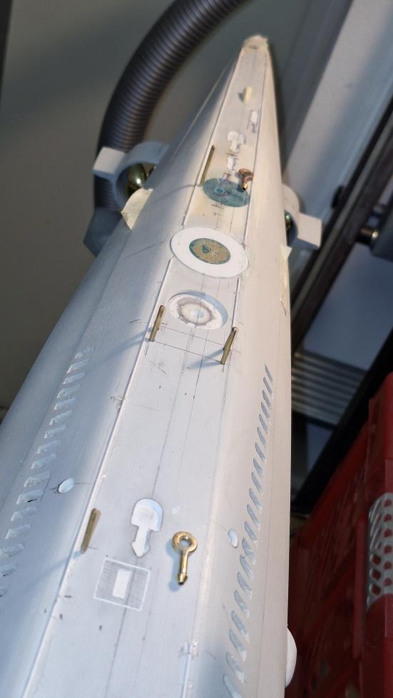

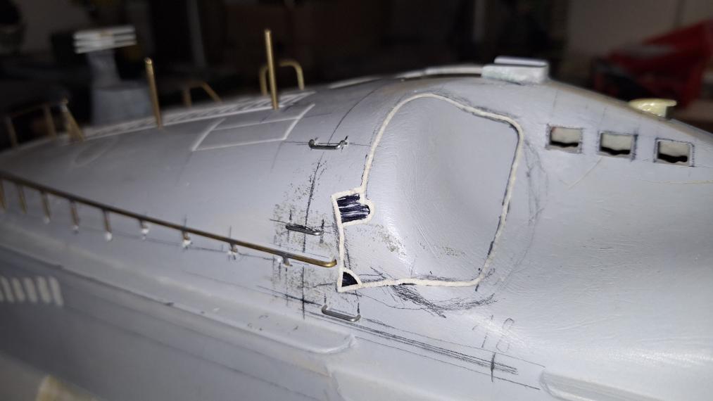

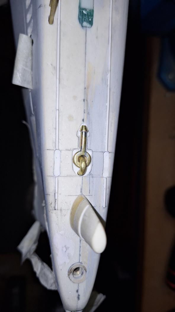

    Searched for pictures of the recesses for the salvage anchors. Found no clear ones from the Whiskey, but from the follow-on Romeo SSK and adjusted the opening accordingly. Made a template from plastic sheet for the other three and carved them out via rotary tool.thick brass rod for the clamp.
    Click image for larger version  Name:	27-3758618-img-6398.jpg Views:	0 Size:	51.7 KB ID:	192583 Click image for larger version  Name:	20251209_154842_copy_1148x2040.jpg Views:	0 Size:	45.9 KB ID:	192584 Click image for larger version  Name:	20251209_160010_copy_1148x2040.jpg Views:	0 Size:	45.6 KB ID:	192585 Click image for larger version  Name:	20251209_160018_copy_1148x2040.jpg Views:	0 Size:	44.0 KB ID:	192586 Click image for larger version  Name:	20251210_174616_copy_1148x2040.jpg Views:	0 Size:	44.4 KB ID:	192587

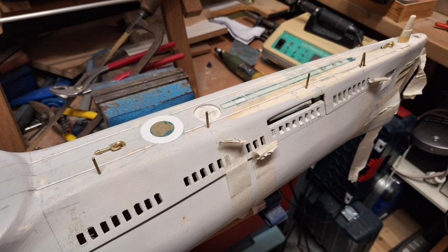

          All four are in place:

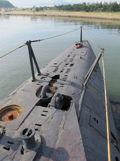

            Closeup of the sail...not too bad!

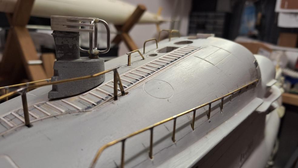

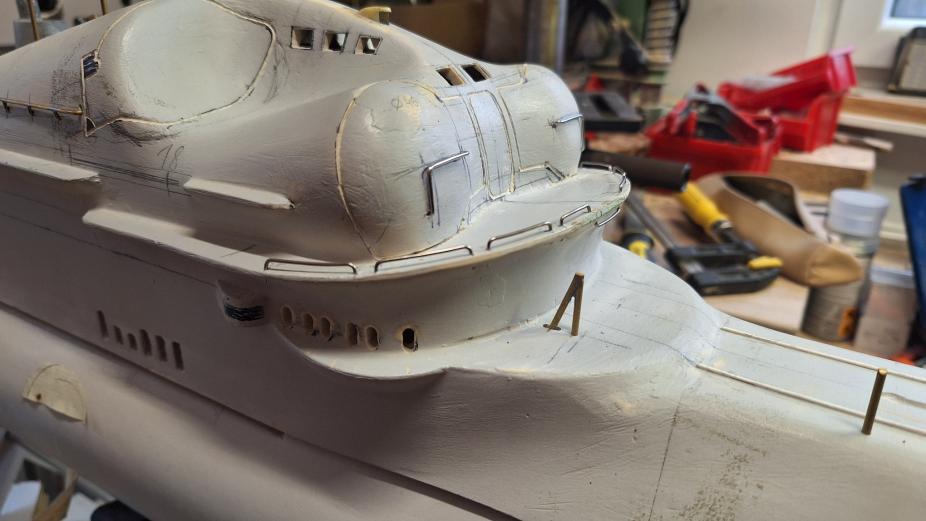

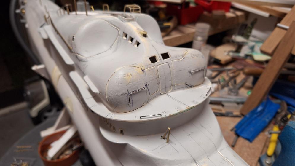

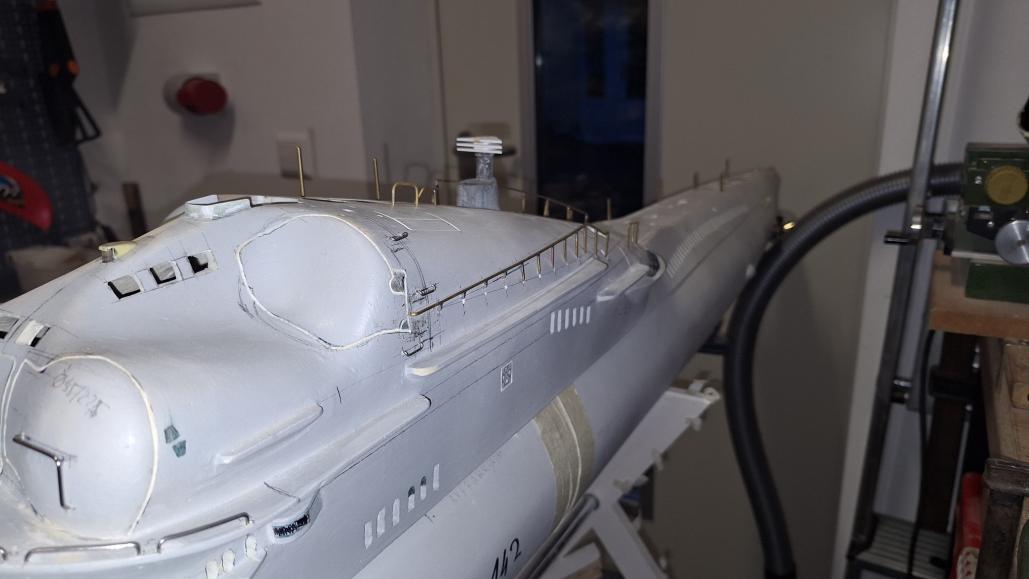

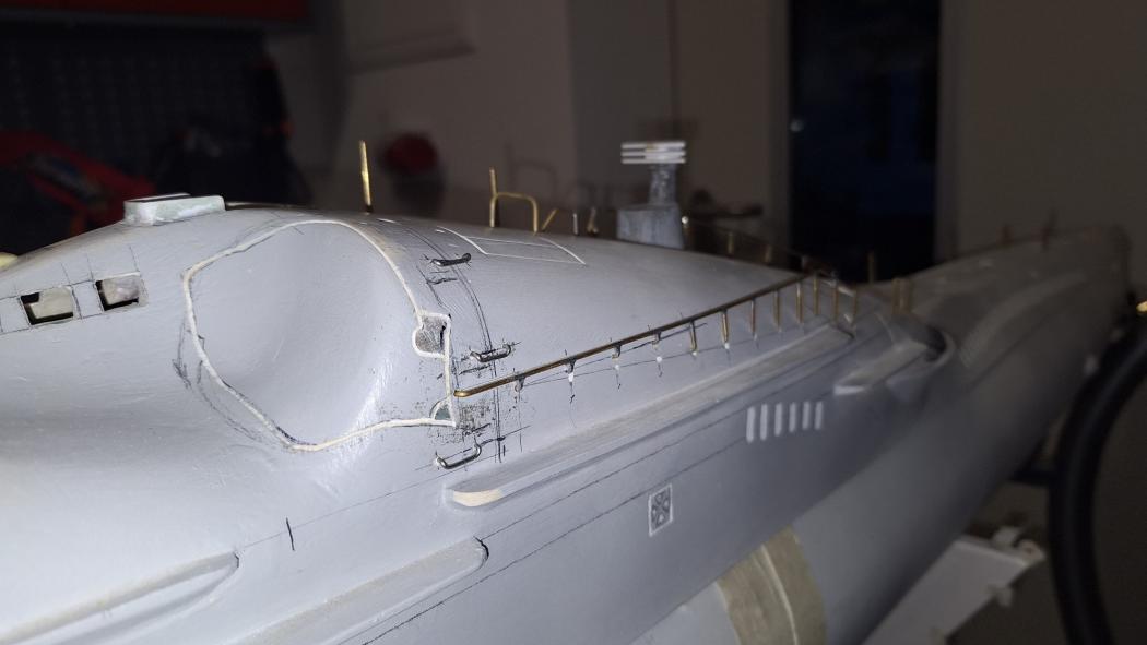

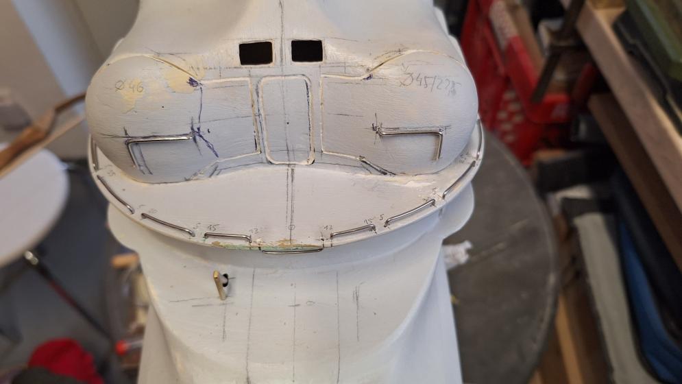

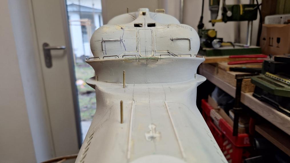

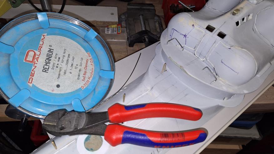

              Hello! Did some work on the remaining relings, this time in solid stainless wire since there will no soldering be required.

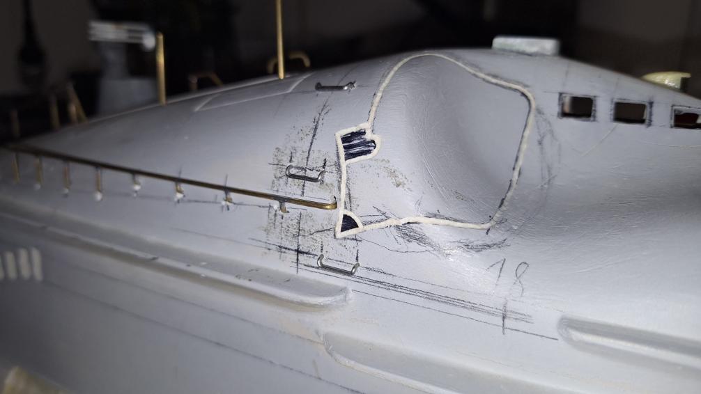

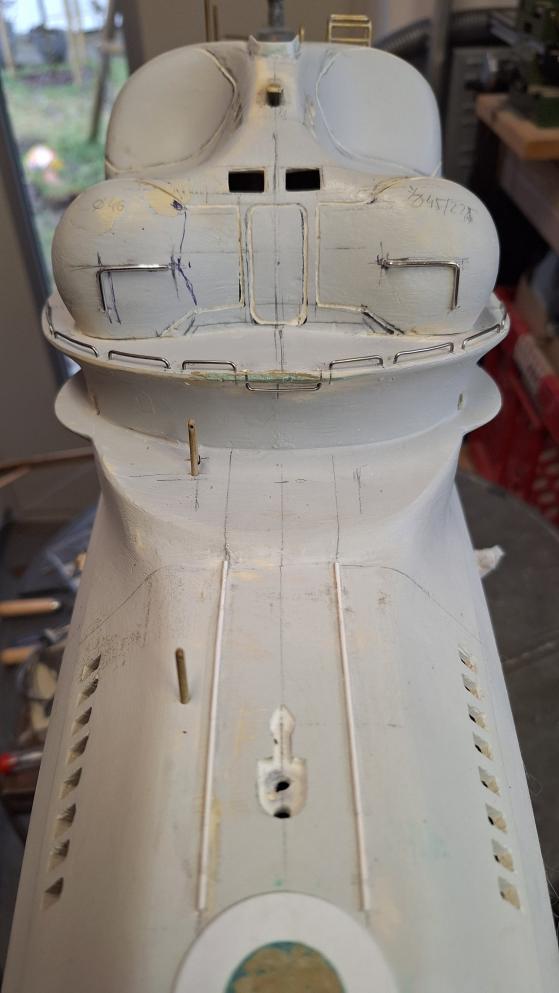

                Next the reling on the splash shield:

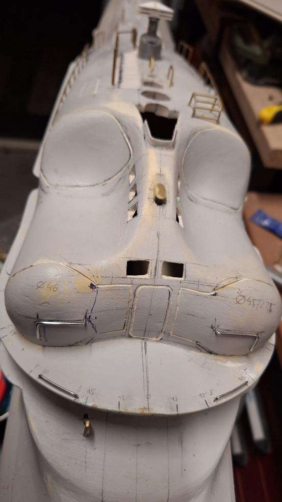

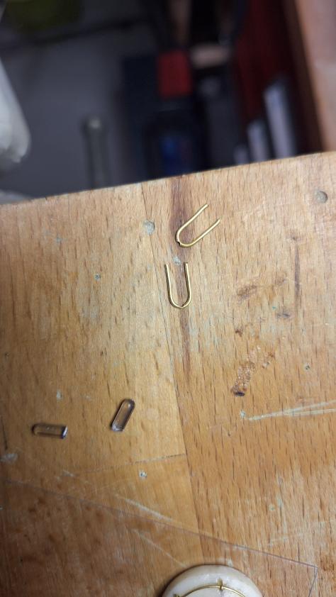

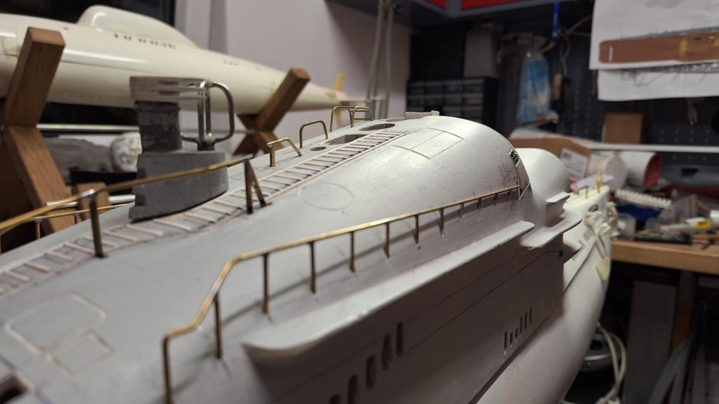

                  And the handle bars behind the upper missile battery :

                    Both sides done!

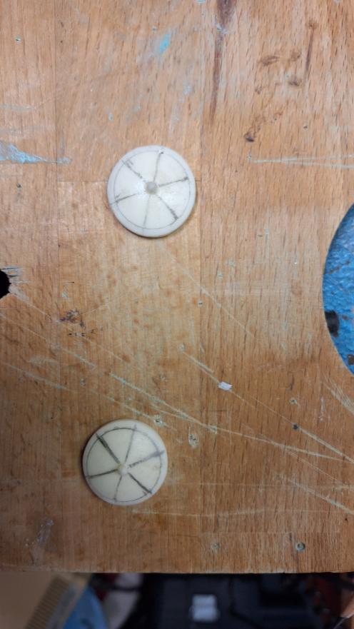

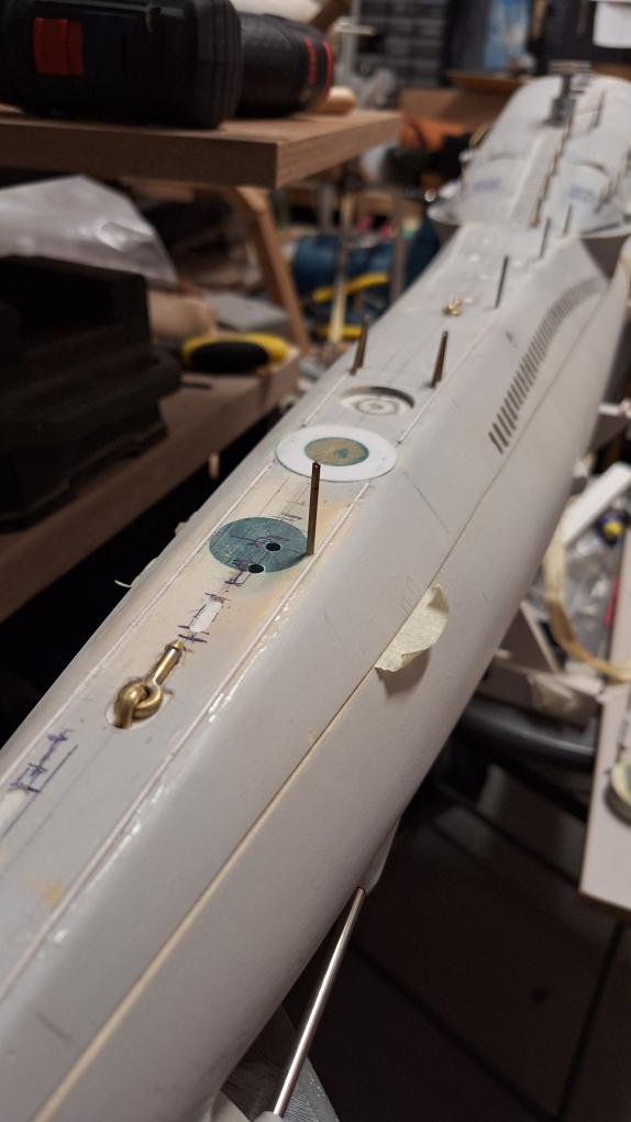

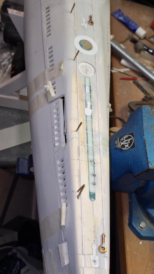

                      Finished detailing of the emergency buoys:
                      Click image for larger version  Name:	20260104_183055_copy_1148x2040.jpg Views:	0 Size:	54.7 KB ID:	193026 Click image for larger version  Name:	20260101_231651_copy_1148x2040.jpg Views:	0 Size:	51.6 KB ID:	193024 Click image for larger version  Name:	20260101_230718_copy_2040x1148.jpg Views:	0 Size:	44.8 KB ID:	193023 Click image for larger version  Name:	20260101_230010_copy_2040x1148.jpg Views:	0 Size:	58.4 KB ID:	193025

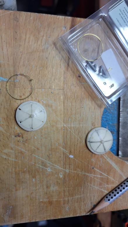

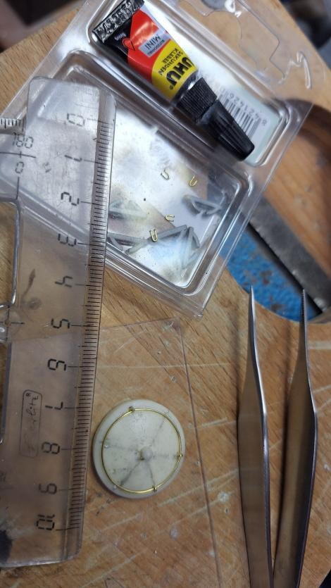

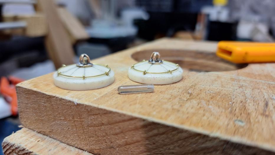

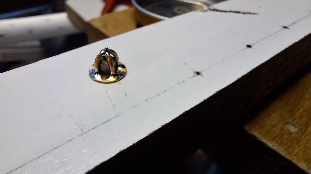

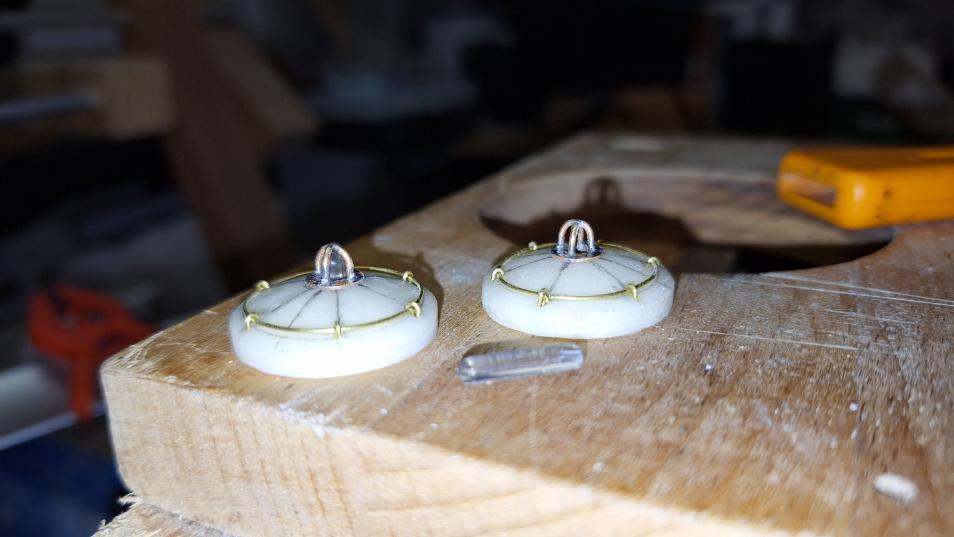

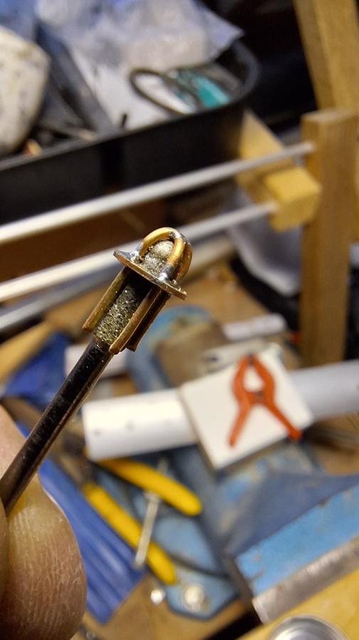

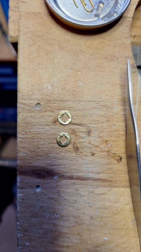

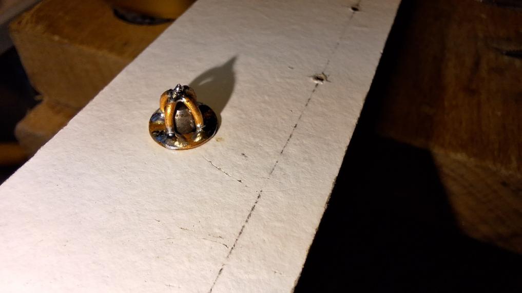

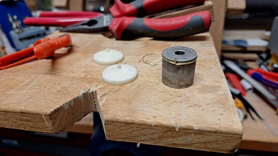

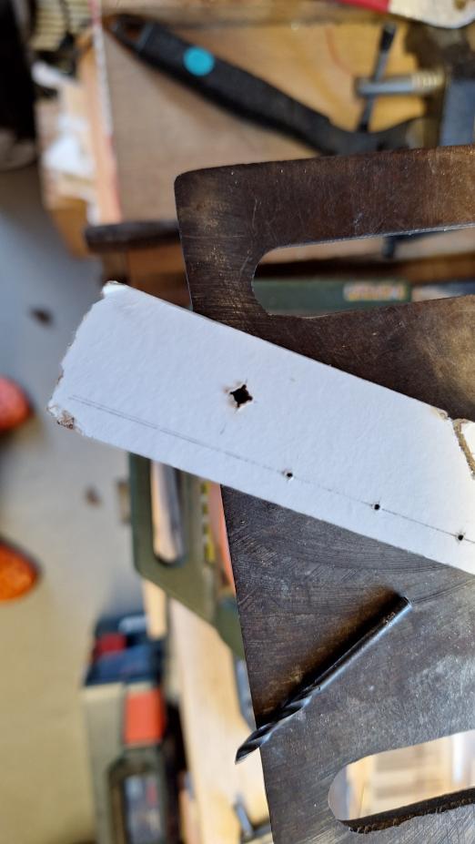

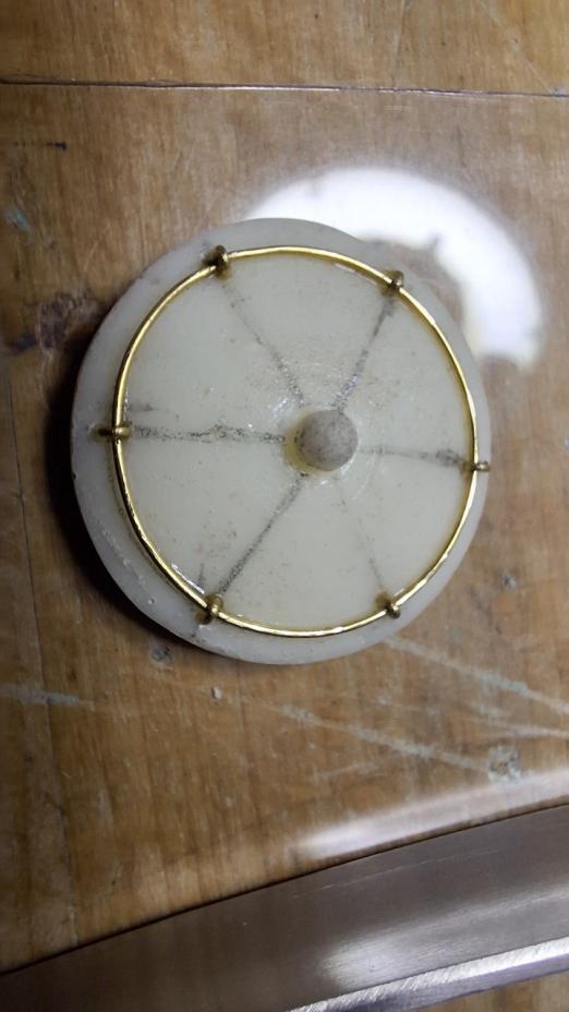

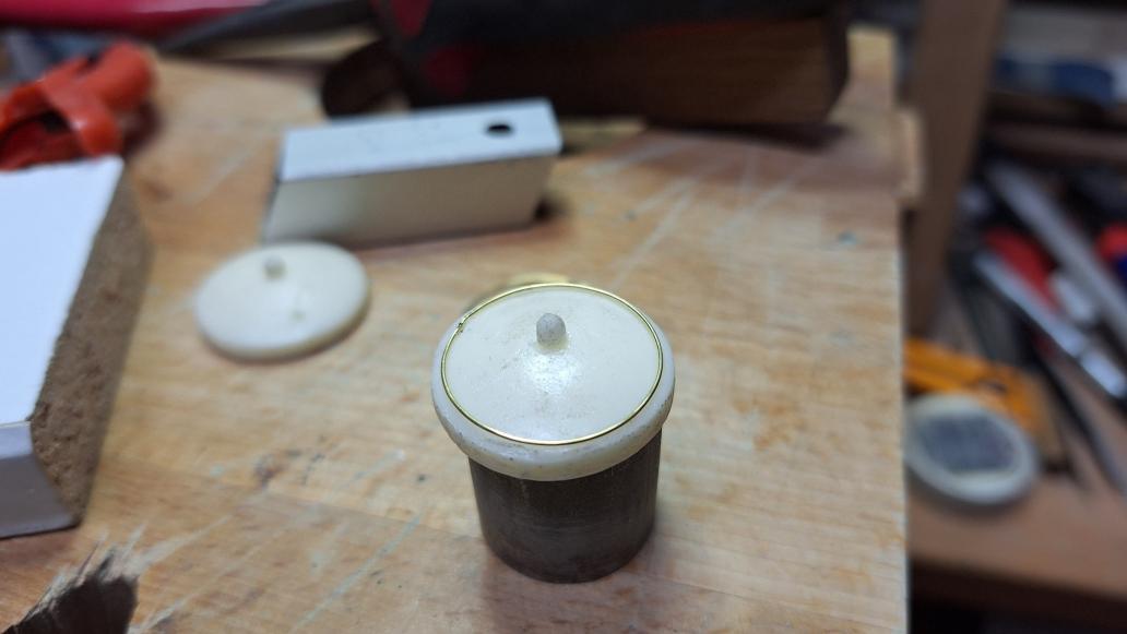

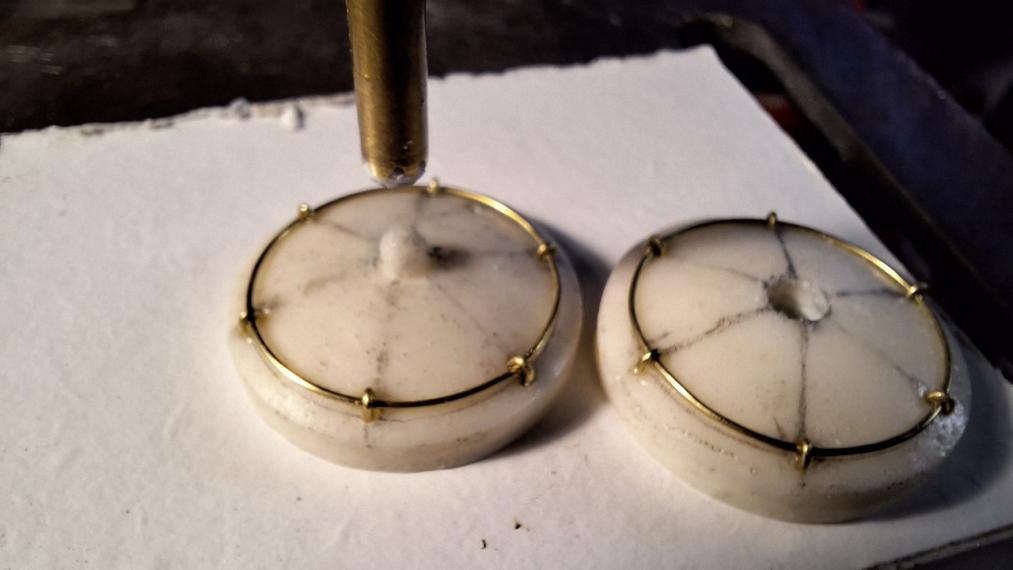

                          The signaling lights got a "bulb" from clear acrylic sprue and a frame from brass, soldered together on a jig. The resin "bulb" on the cast buy was cut out with a small circular saw to receice the new parts.
