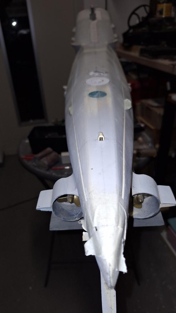

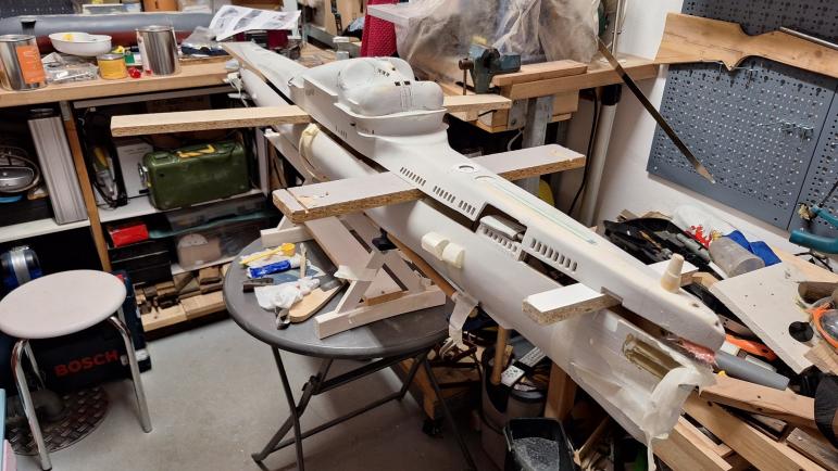

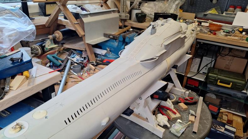

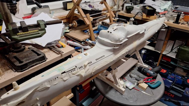

    Right. As said before, this was designed as a dry-hull like the classic Engel Kits.
    That boat eats Sandpaper and Drill bits!!!

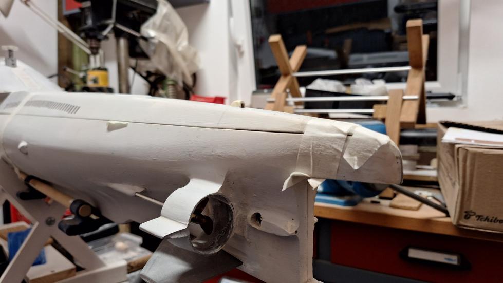

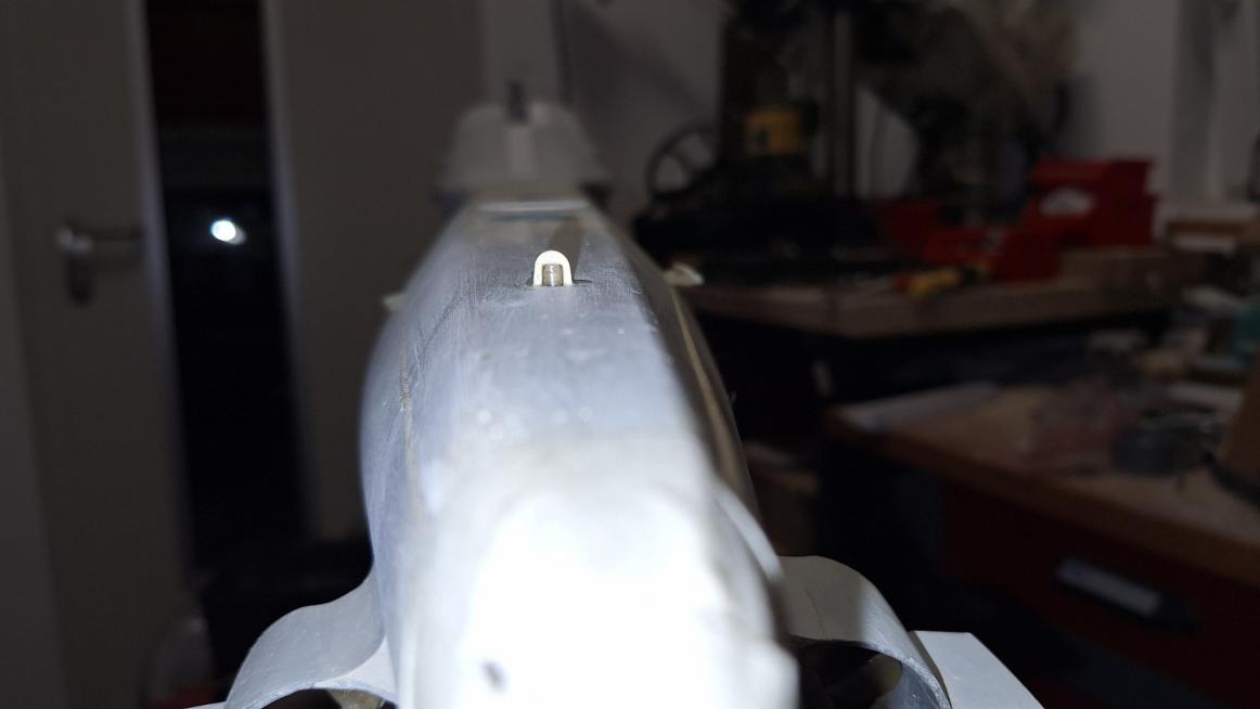

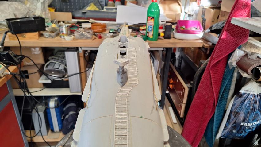

      Stern lantern done! Same as the bow lantern, a casing from PU and a rod from clear acrylic to both mimic the glass and forming a pin to secure it in a hole through the deck.

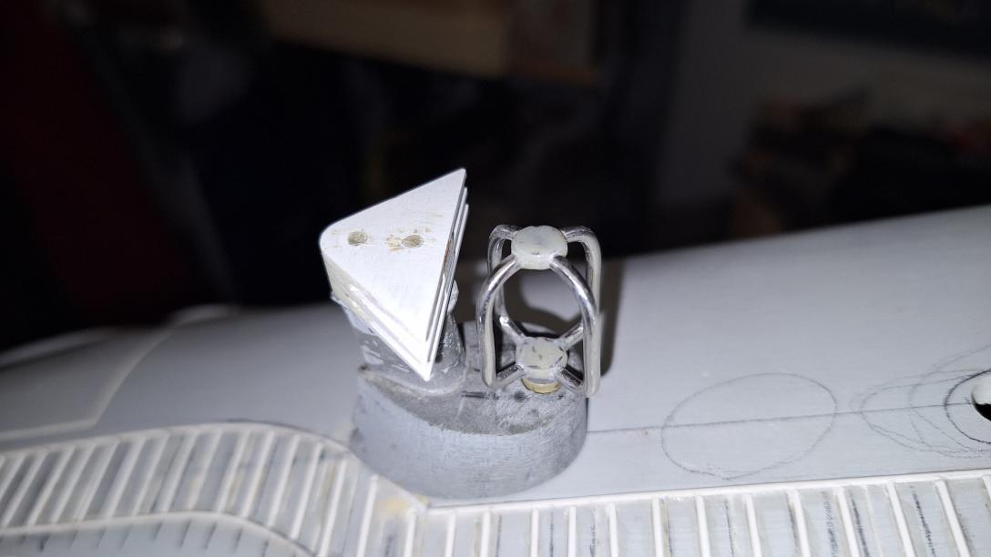

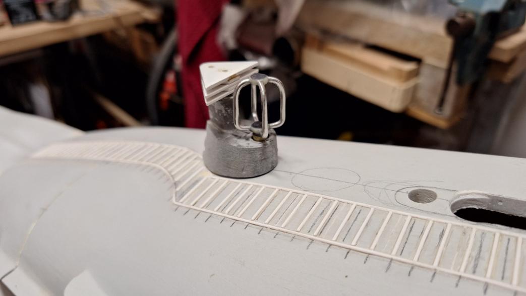

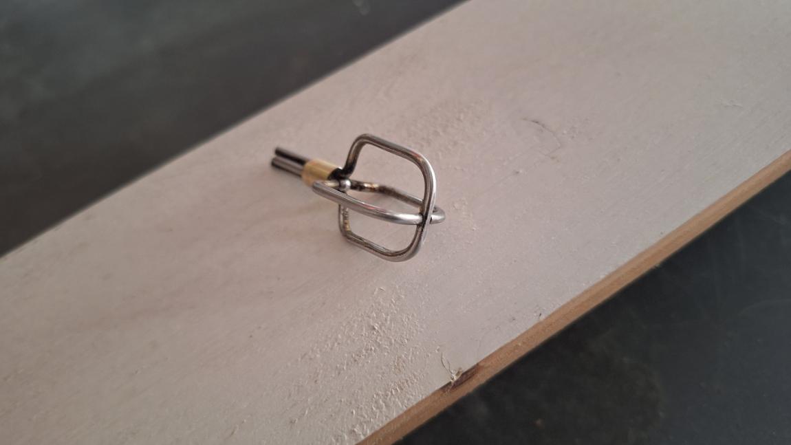

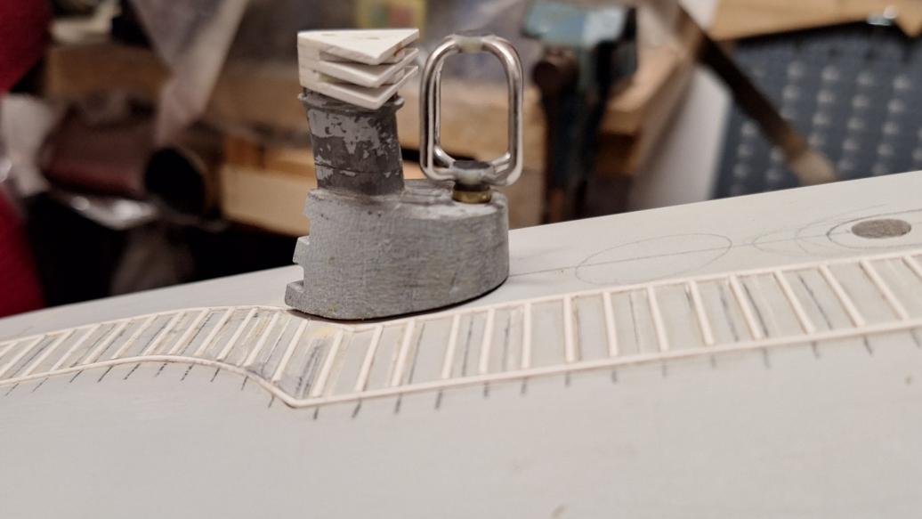

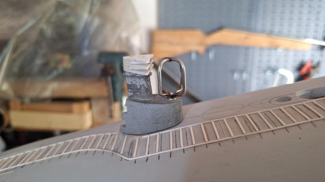

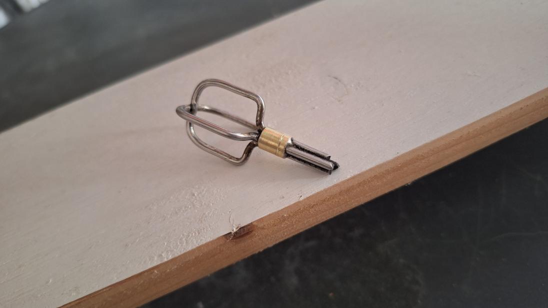

      • JHapprich
        • Oct 2017
        • 1114
        #33

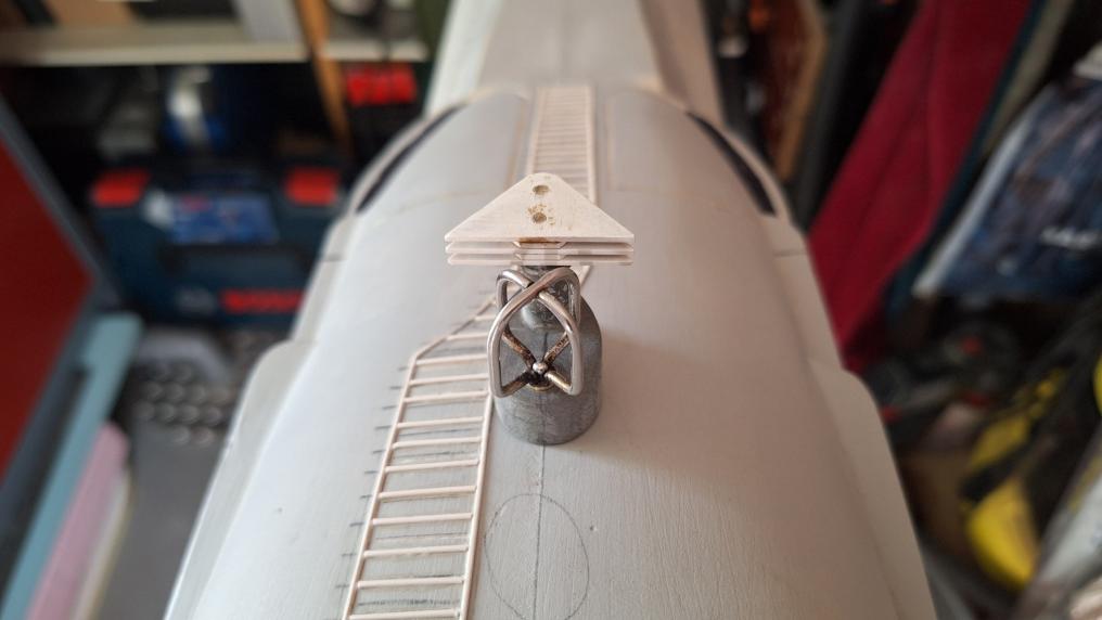

        The characteristic direction finder antenna, made from stainless steel:

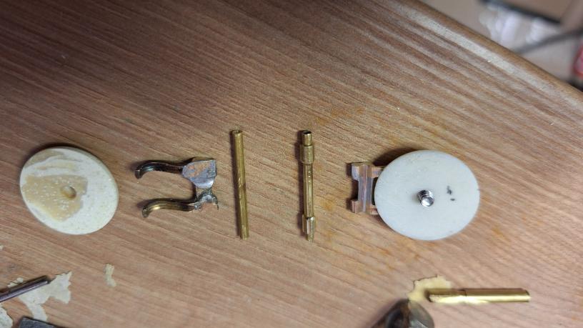

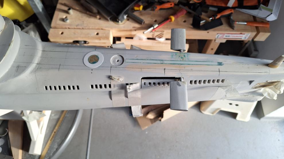

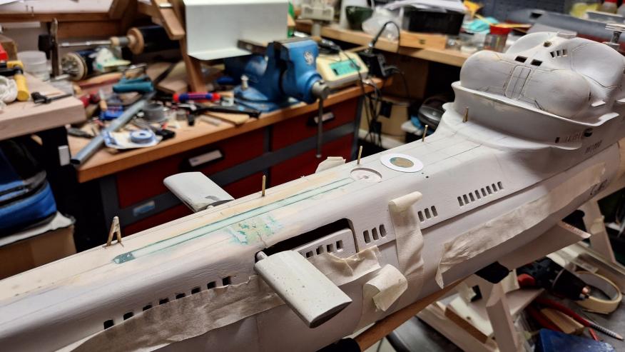

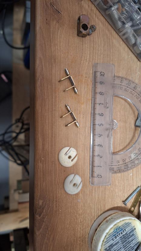

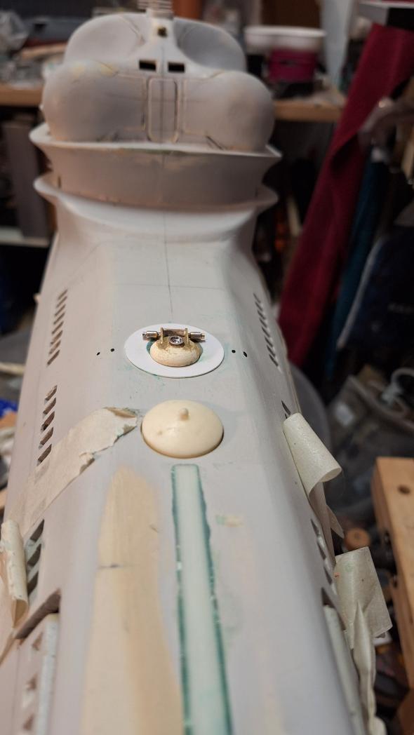

            Filed the resin discs to shape. They're made from tough light curing dental filling composite ;-)
            Click image for larger version  Name:	20250922_215048_copy_2040x1148.jpg Views:	0 Size:	46.3 KB ID:	190583
            Click image for larger version  Name:	20250922_215056_copy_2040x1148.jpg Views:	0 Size:	43.2 KB ID:	190582

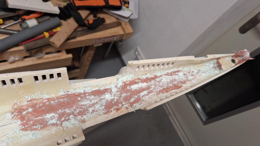

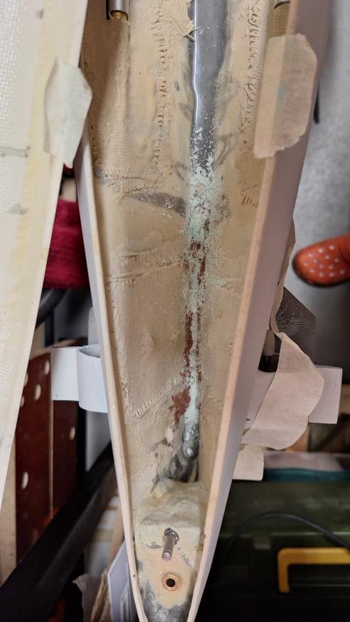

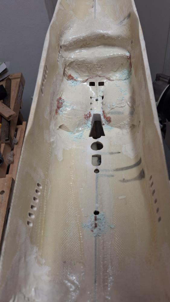

            Mixed up epoxy filler and filled several gaps that could catch air bubbles on the inside of the upper hull. Also finished up laminating of the gfk rod on the bow, added a further strip of thick glass on top.
            To prevent the filler from flowing, i brushed over powder collected from sanding grp parts. Originally intended to be used with CA, i now regularly keep clean portions of that"waste" to stiffen fillers/resin etc. Universally useful...
            Click image for larger version  Name:	20250922_230352_copy_1148x2040.jpg Views:	0 Size:	51.5 KB ID:	190587 Click image for larger version  Name:	20250922_230359_copy_1148x2040.jpg Views:	0 Size:	53.0 KB ID:	190585 Click image for larger version  Name:	20250922_230342_copy_2040x1148.jpg Views:	0 Size:	54.2 KB ID:	190586 Click image for larger version  Name:	20250922_230650_copy_2040x1148.jpg Views:	0 Size:	71.2 KB ID:	190584

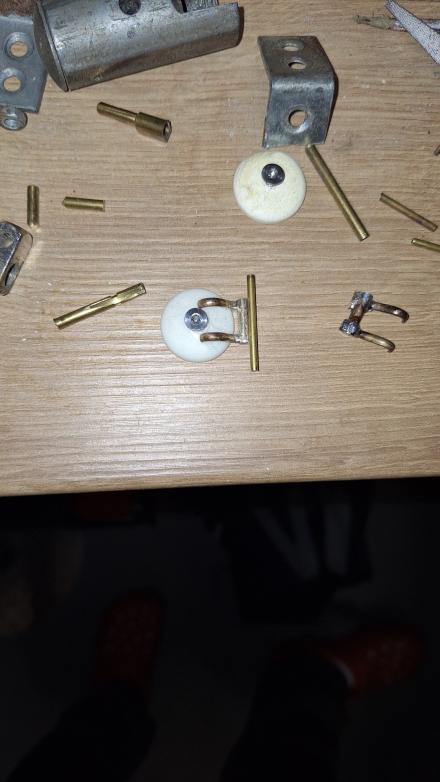

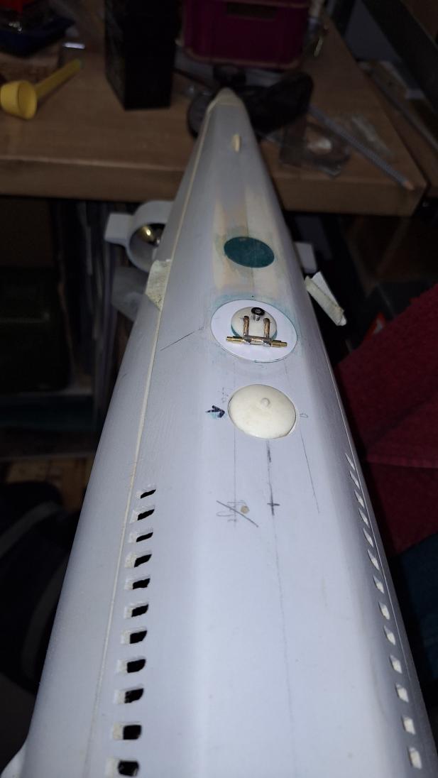

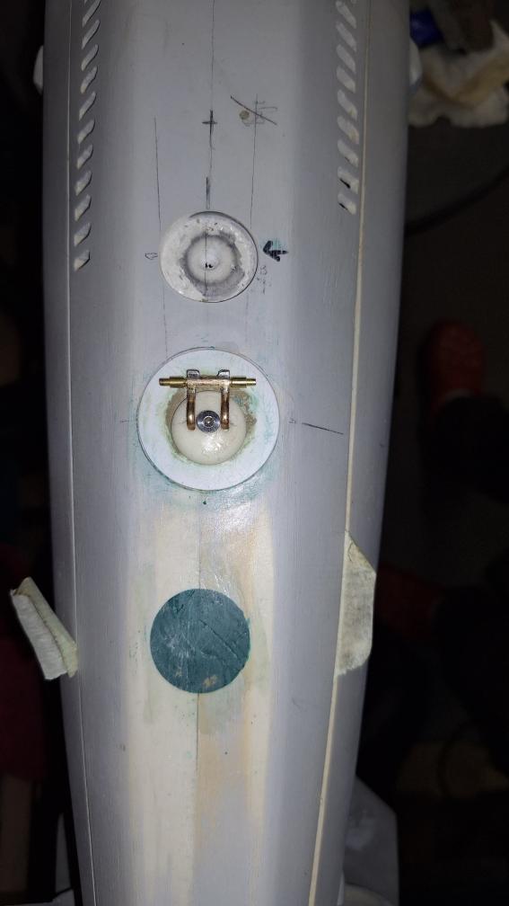

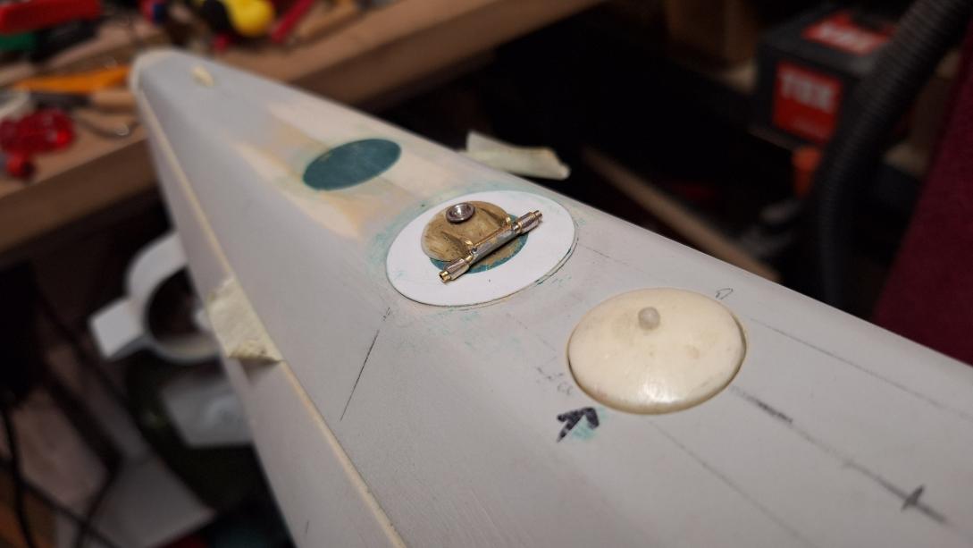

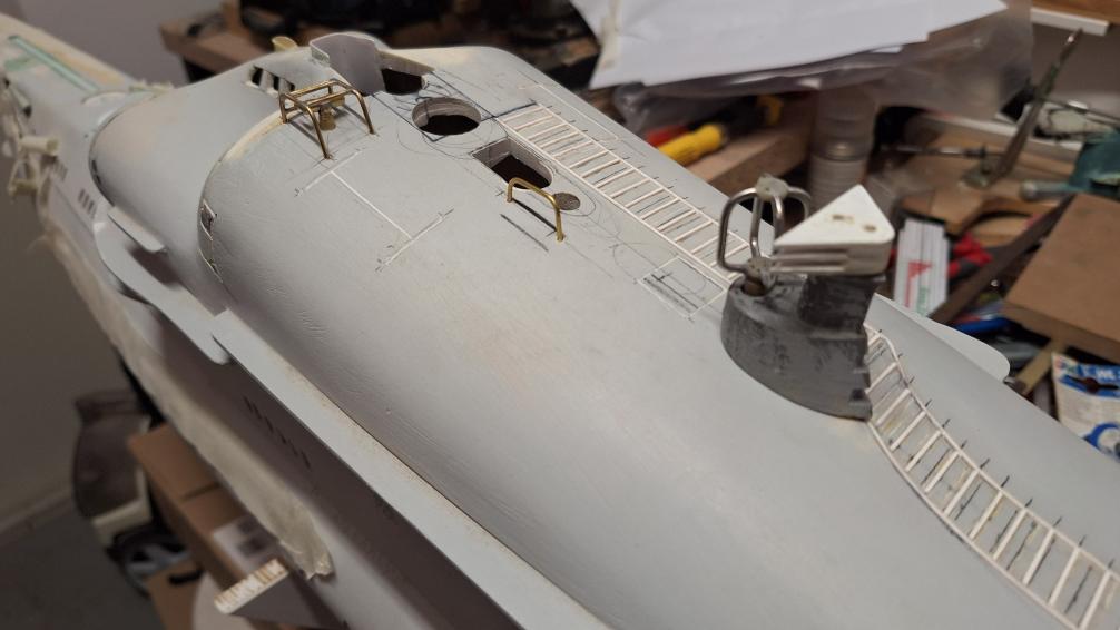

              First attempt on making the hinge for the deck hatch:

              Still a looong way to go...
ID:	190603 Click image for larger version
ID:	190604 Click image for larger version
ID:	190605 Click image for larger version

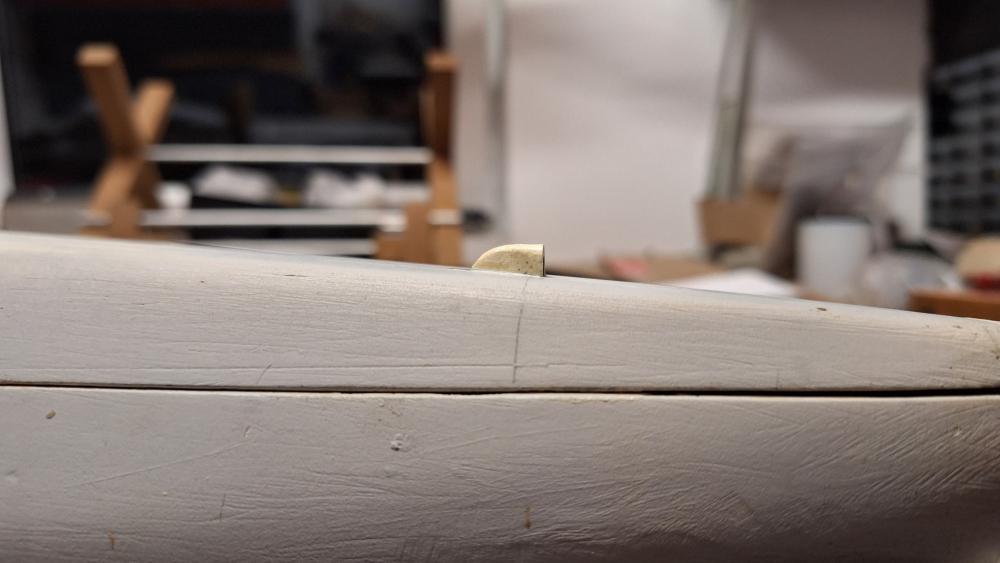

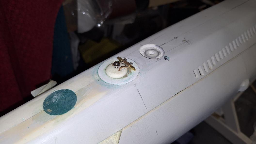

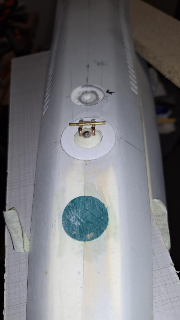

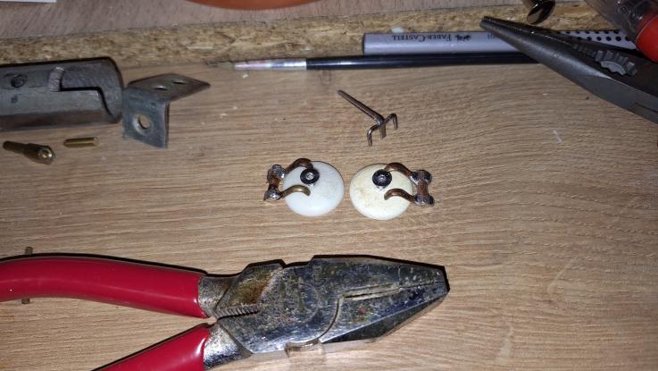

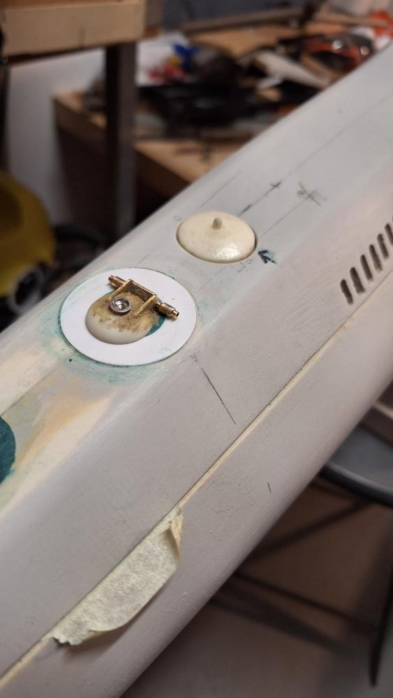

                Filled up the deck sockets, they were wrong. Modified the hinge..

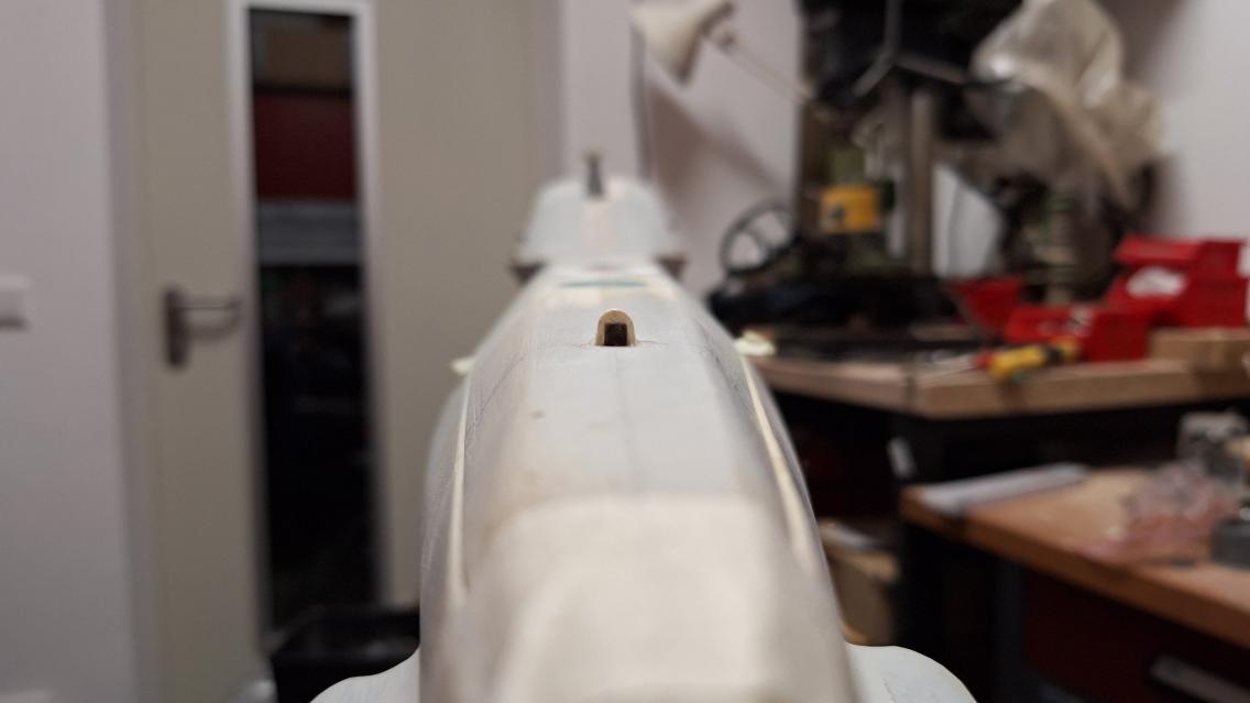

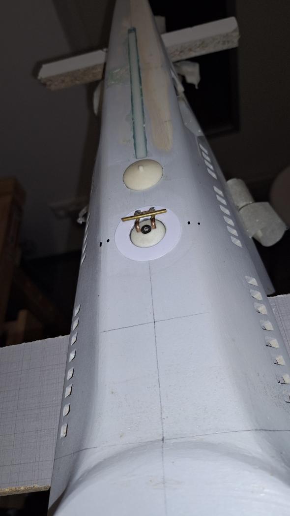

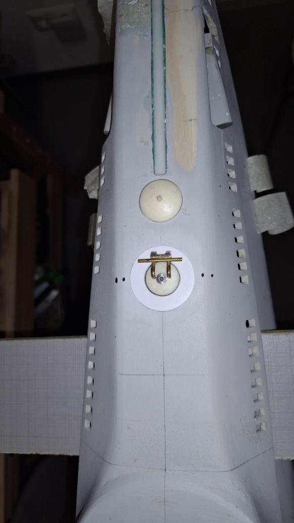

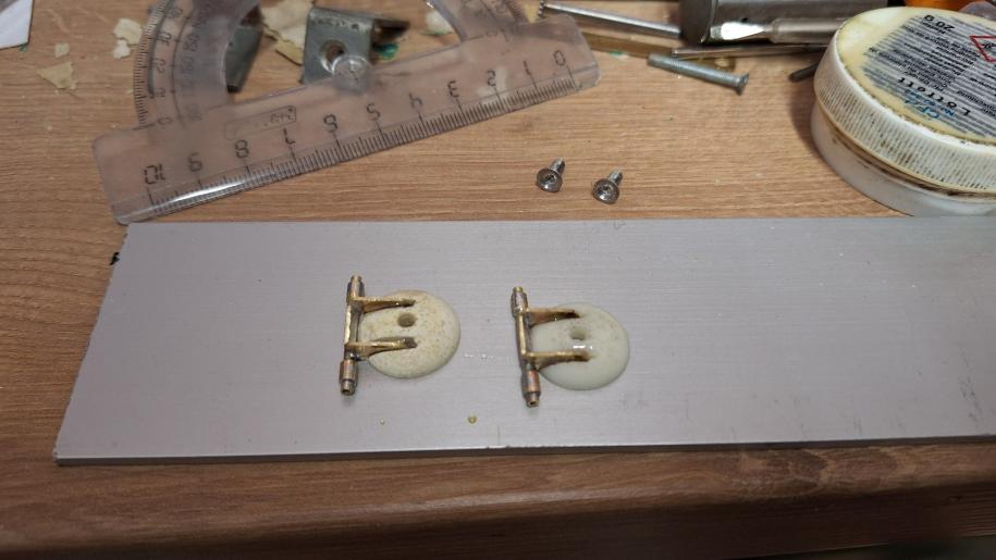

                  Scaled down and new hinge...and done!

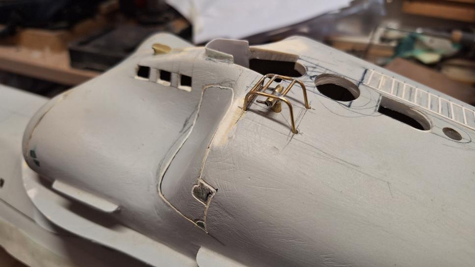

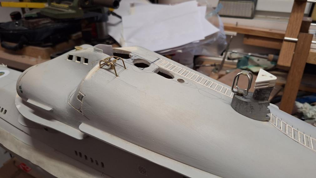

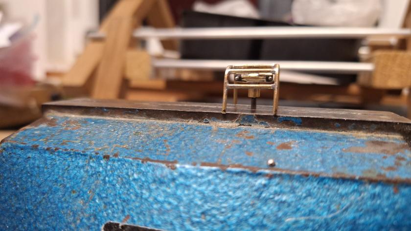

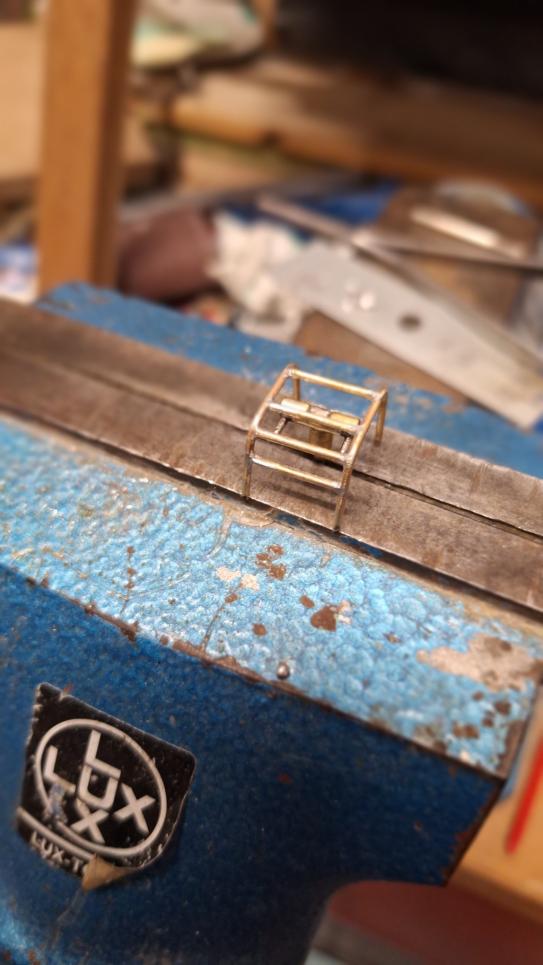

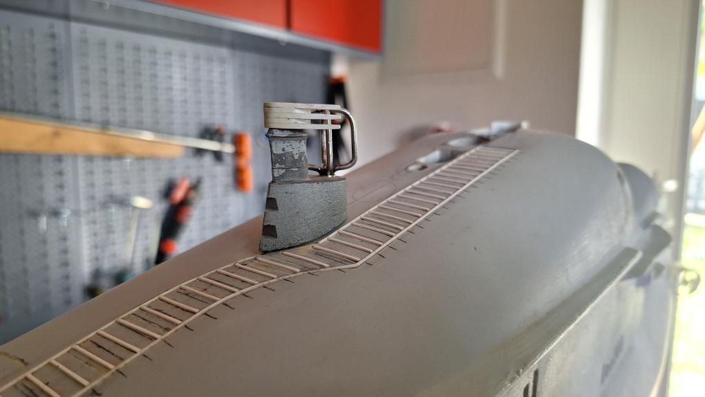

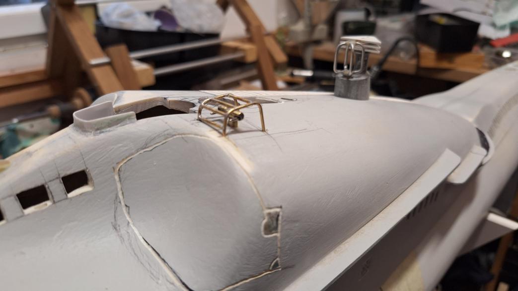

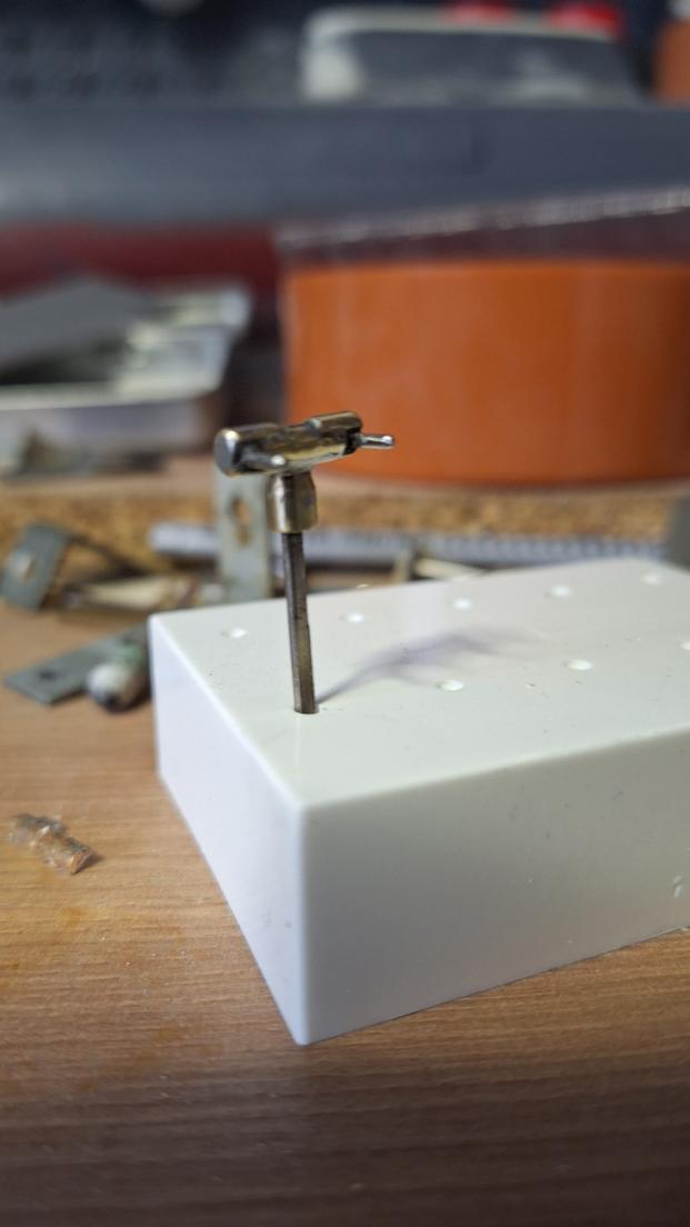

                    More sensors... the cage around that acoustic range detector(?) Will be soldered next
ID:	190809 Click image for larger version

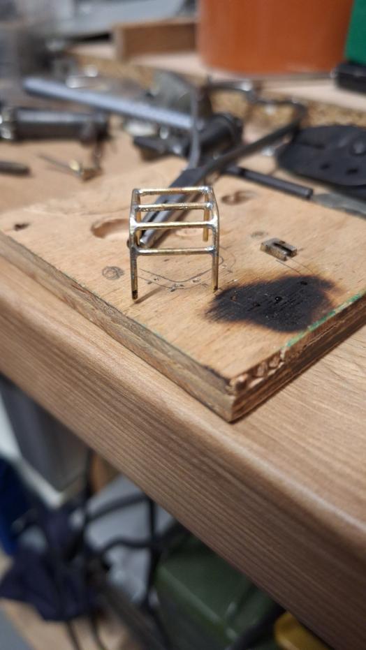

                      #40

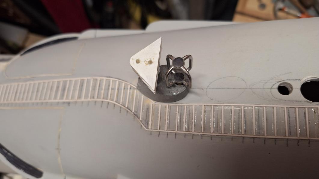

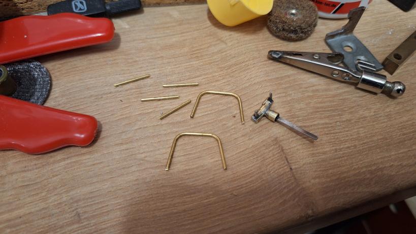

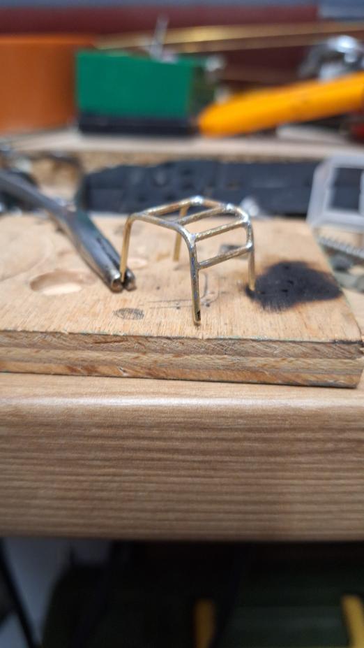

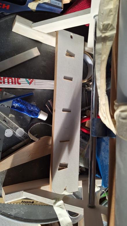

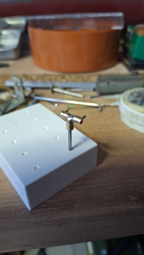

                      Done! I made a simple wooden jig to stick the pins into and an aluminum clamp to position the outer frame on on of the sticks.Click image for larger version

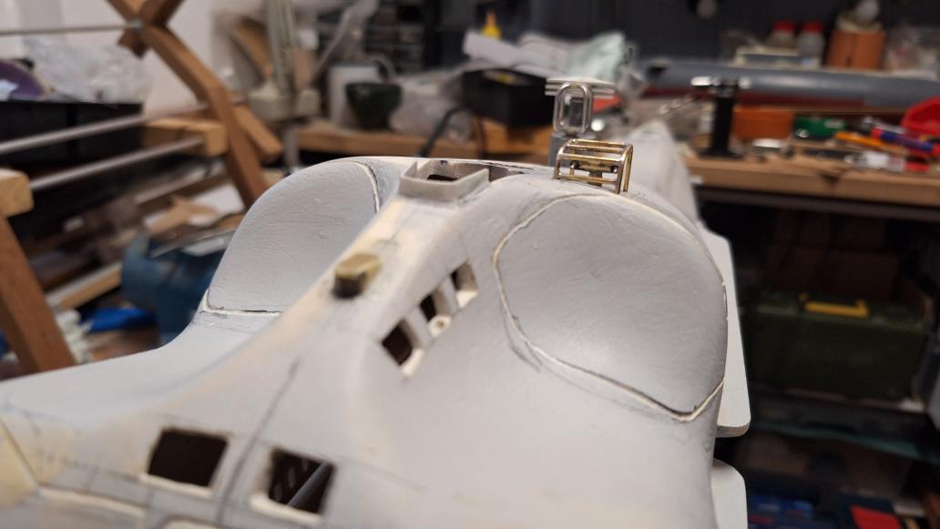

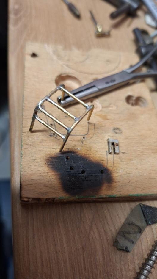

                        The bird is in the cage:
                        Click image for larger version  Name:	20251010_175706_copy_2040x1148.jpg Views:	0 Size:	53.6 KB ID:	190886 Click image for larger version  Name:	20251010_175631_copy_2040x1148.jpg Views:	0 Size:	50.2 KB ID:	190885 Click image for larger version  Name:	20251010_175724_copy_2040x1148.jpg Views:	0 Size:	50.5 KB ID:	190884 Click image for larger version

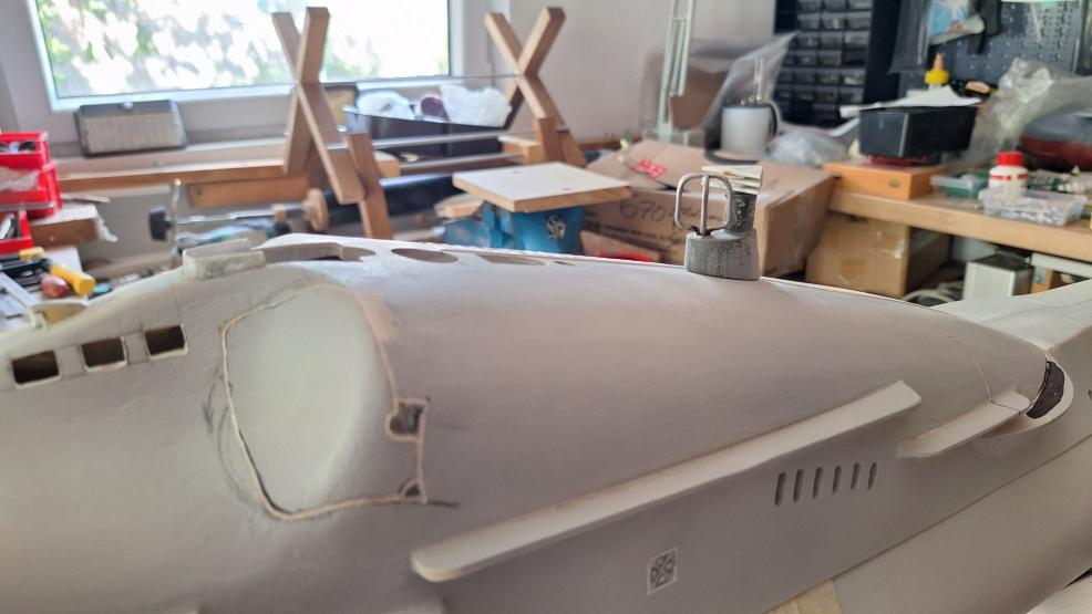

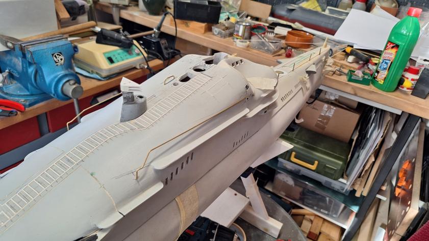

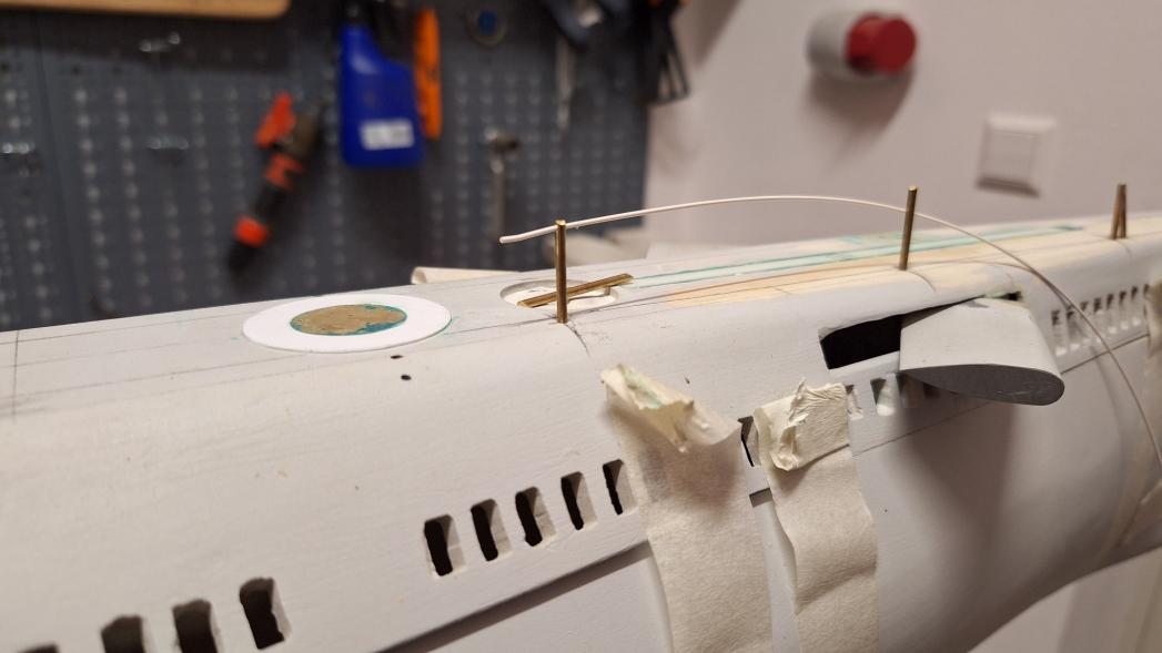

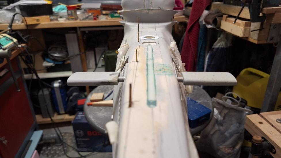

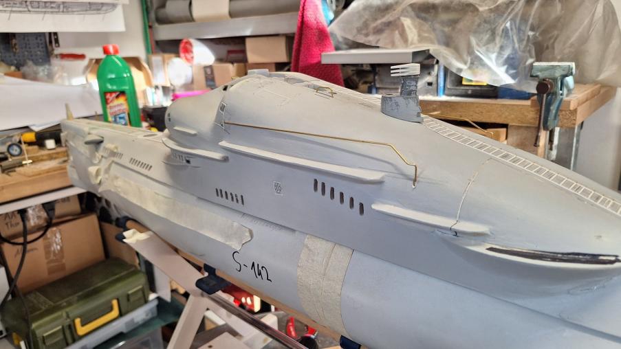

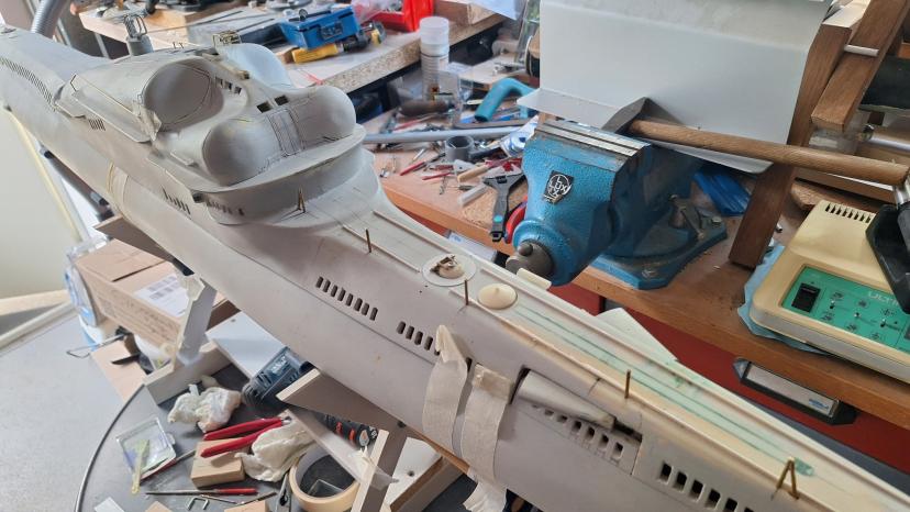

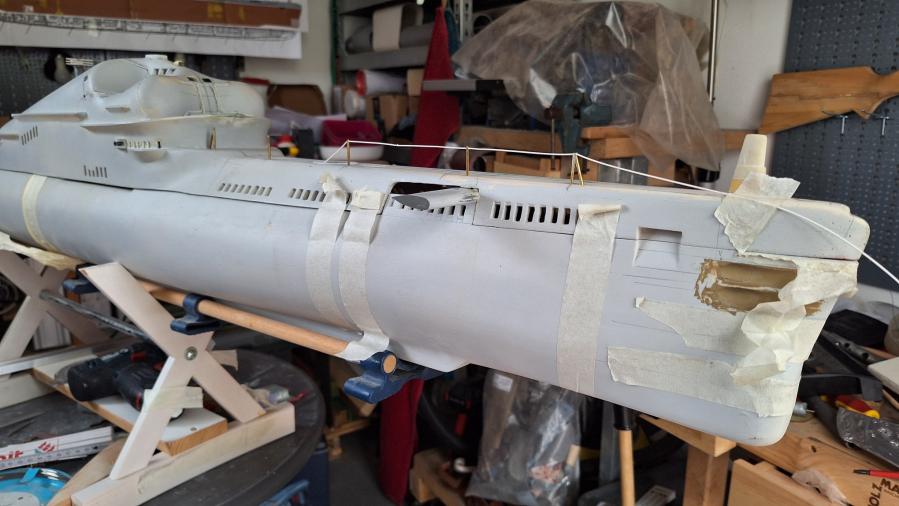

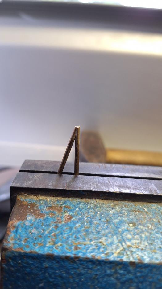

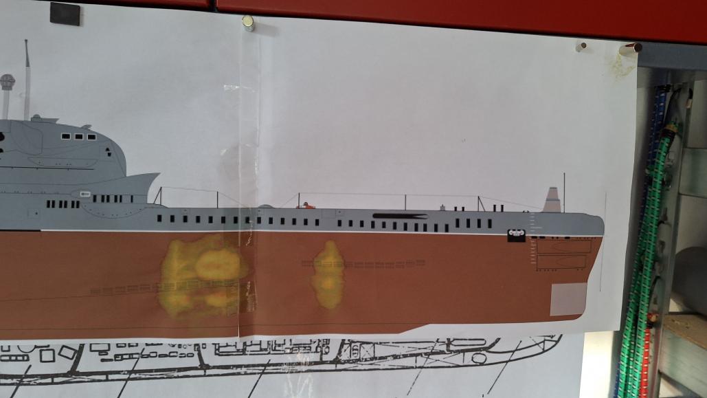

                          Greetings! Today i started constructing the forward deck reling. Nothing special here, soldering two v-shaped posts BUT again lots of research in photo reference to determine the right position. Not sure yet what i will be using to represent the handrail, 1mm brass rod/ stainless steel wire/ABS rod.
                          The posts are from 2mm brass rod. Everything on the external details is slightly thicker than scale, since i want to have all of it in good shape when i surface back again in one of our local lakes...
                          Click image for larger version  Name:	20251020_161816_copy_2040x1148.jpg Views:	0 Size:	53.0 KB ID:	191021 Click image for larger version  Name:	20251020_153601_copy_1148x2040.jpg Views:	0 Size:	50.3 KB ID:	191022 Click image for larger version  Name:	20251020_161811_copy_1148x2040.jpg Views:	0 Size:	54.0 KB ID:	191024 Click image for larger version  Name:	20251020_180721_copy_2040x1148.jpg Views:	0 Size:	66.9 KB ID:	191025 Click image for larger version  Name:	20251020_161824_copy_2040x1148.jpg Views:	0 Size:	59.1 KB ID:	191020 Click image for larger version  Name:	20251020_180752_copy_2040x1148.jpg Views:	0 Size:	56.2 KB ID:	191023

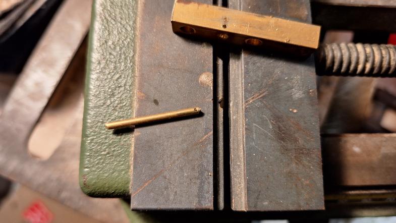

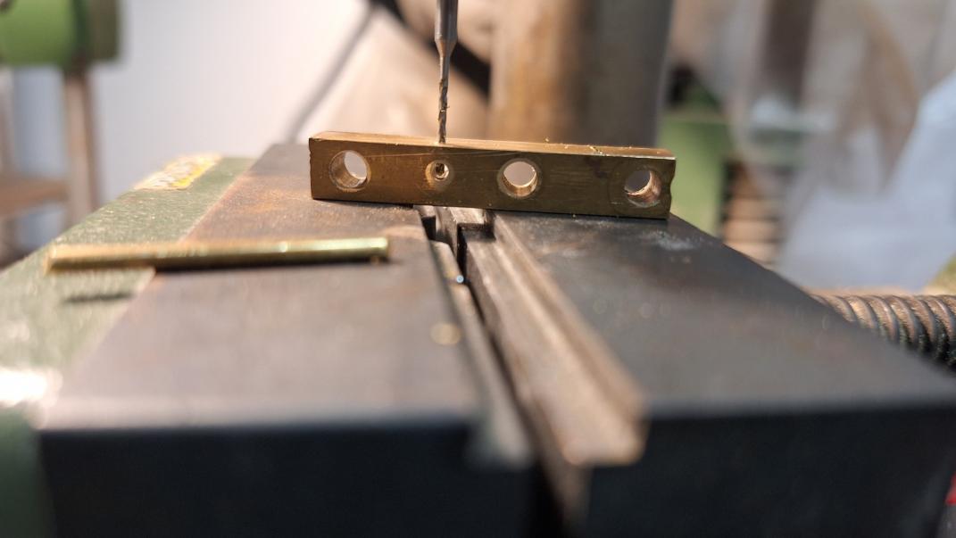

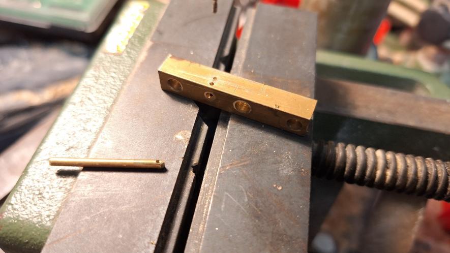

                            Made a small jig to drill centric 1mm holes into the 2mm posts. Ordered thin brass wire, will try abs and otherwise solder the brass wire in case abs won't look nice...
                            Click image for larger version  Name:	20251020_215022_copy_2040x1148.jpg Views:	0 Size:	51.8 KB ID:	191036 Click image for larger version  Name:	20251020_215052_copy_2040x1148.jpg Views:	0 Size:	43.1 KB ID:	191037 Click image for larger version  Name:	20251020_215244_copy_2040x1148.jpg Views:	0 Size:	49.0 KB ID:	191038 Click image for larger version  Name:	20251020_215059_copy_2040x1148.jpg Views:	0 Size:	54.7 KB ID:	191039

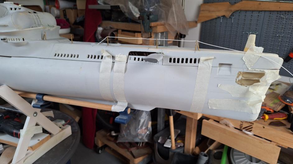

                              Test fit with ABS-rod. Ordered a proper 0,5mm braided stainless steel cable for the real job. On to the next 20+ posts...
                              Click image for larger version  Name:	20251021_125526_copy_2040x1148.jpg Views:	0 Size:	61.1 KB ID:	191041 Click image for larger version  Name:	20251021_125521_copy_2040x1148.jpg Views:	0 Size:	62.4 KB ID:	191042
