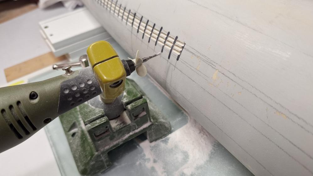

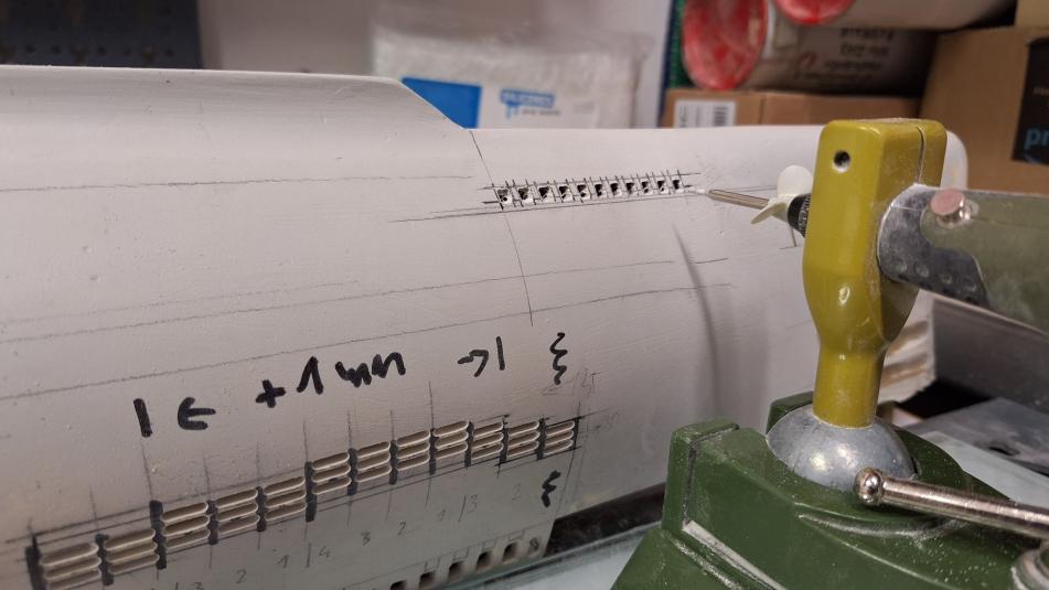

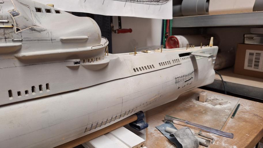

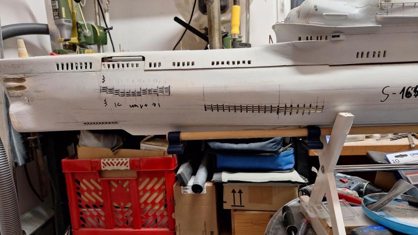

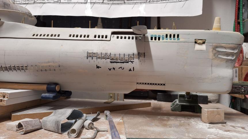

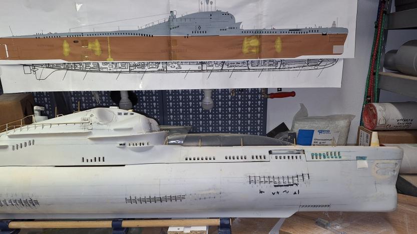

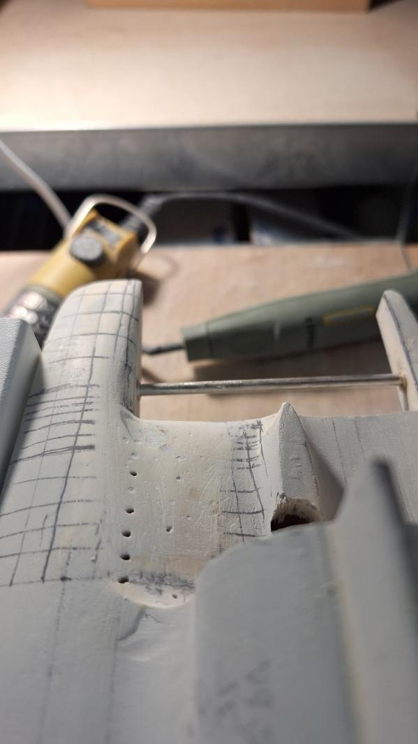

      After checking with my reference pictures, i extended the floodholes under the sail. Some minor work done. An old propeller stuck onto the rotary tool effectively blows away all the dust during the milling so one can see the drawing.
      Click image for larger version  Name:	20260120_223556_copy_2040x1148.jpg Views:	0 Size:	62.6 KB ID:	193224 Click image for larger version  Name:	20260120_220931_copy_2040x1148.jpg Views:	0 Size:	51.6 KB ID:	193225 Click image for larger version  Name:	20260120_211303_copy_2040x1148.jpg Views:	0 Size:	52.3 KB ID:	193223
      Next will be finishing the torpedo shutters.

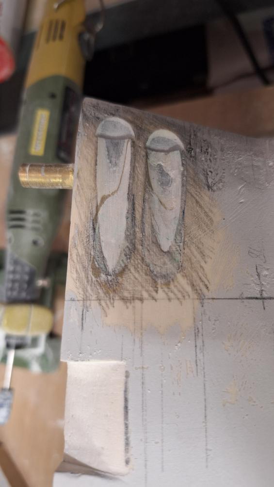

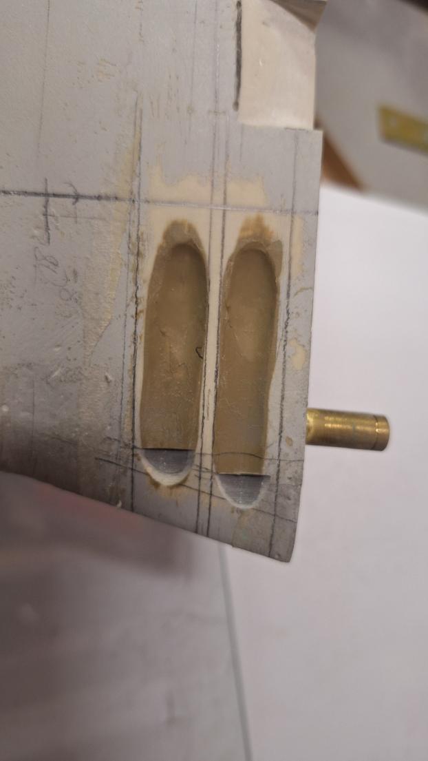

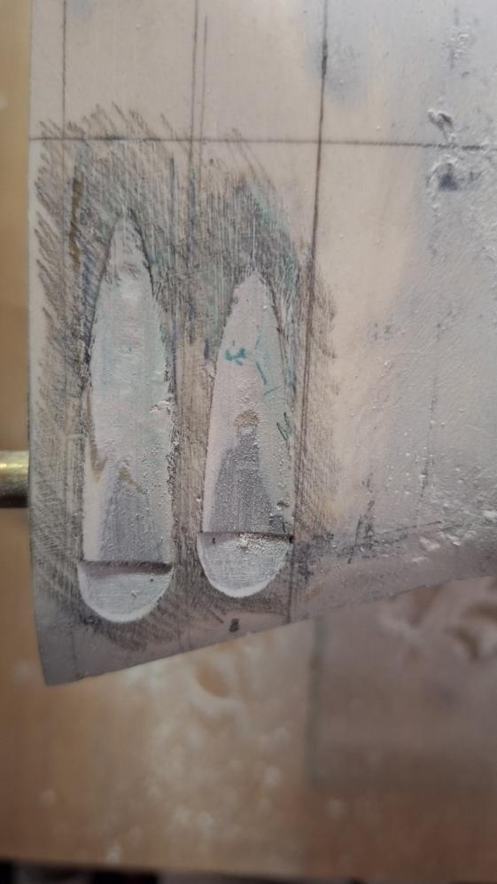

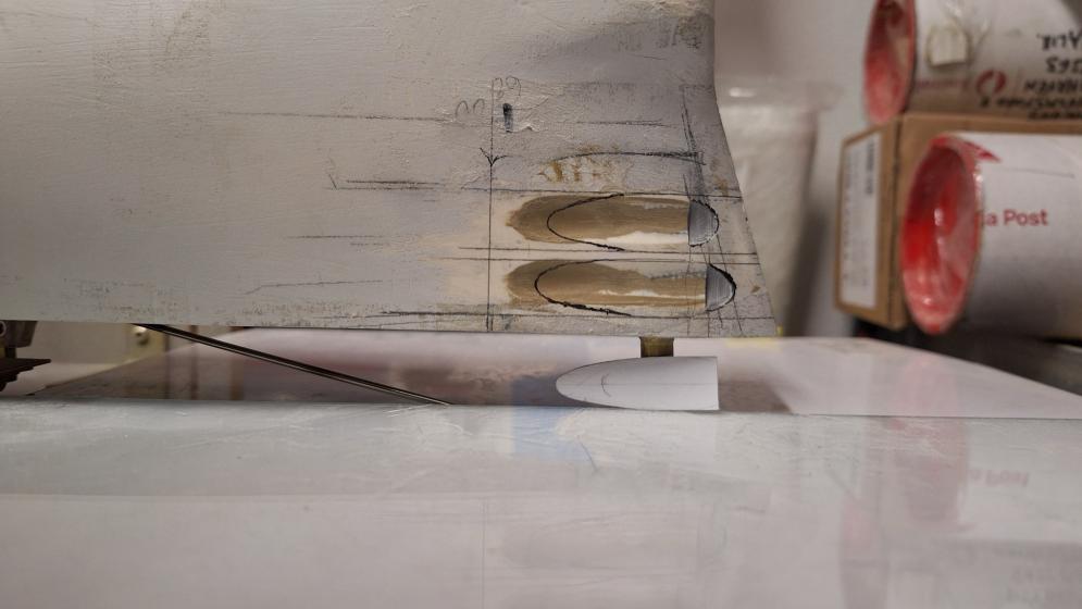

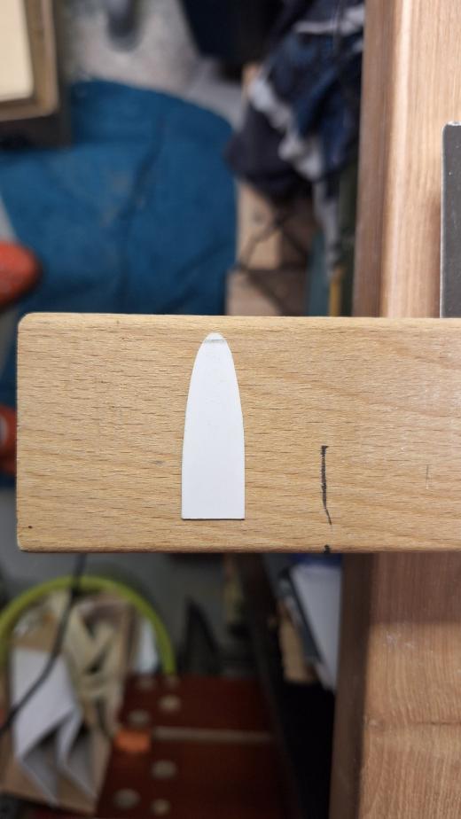

        Started on the shutter doors. The front part was easy. Made a template for the rear section and found my original error: the depht of the tube muzzles as made with the kit are already too deep plus they're entirely wrong shaped.I should have filled them flush and made them all new from the start. Will remove the brown nitro-filler, make a rounded stencil from a piece of pipe with appropriate diameter and push it into fresh filler applied to the recess to produce the channel. Otherwise, it's filling all up again and grinding in a new channel...
        Click image for larger version  Name:	20260121_180148_copy_2040x1148.jpg Views:	0 Size:	49.1 KB ID:	193236 Click image for larger version  Name:	20260121_212222_copy_1148x2040.jpg Views:	0 Size:	41.6 KB ID:	193237 Click image for larger version  Name:	20260121_212216_copy_1148x2040.jpg Views:	0 Size:	46.8 KB ID:	193234 Click image for larger version  Name:	20260121_213450_copy_2040x1148.jpg Views:	0 Size:	46.2 KB ID:	193235

          The tubedoors and some groups of the floodholes below the fwd sail were filled up again. The channels were that made by grinding in an initial groove with the machine and than using the template and a grinding drum by hand. Slight corrections are necessary, yet i think it looks about right now.
          Click image for larger version  Name:	20260123_232230_copy_1148x2040.jpg Views:	0 Size:	50.4 KB ID:	193290 Click image for larger version  Name:	20260124_000559_copy_1148x2040.jpg Views:	0 Size:	52.5 KB ID:	193288 Click image for larger version  Name:	20260124_000742_copy_1148x2040.jpg Views:	0 Size:	50.2 KB ID:	193289

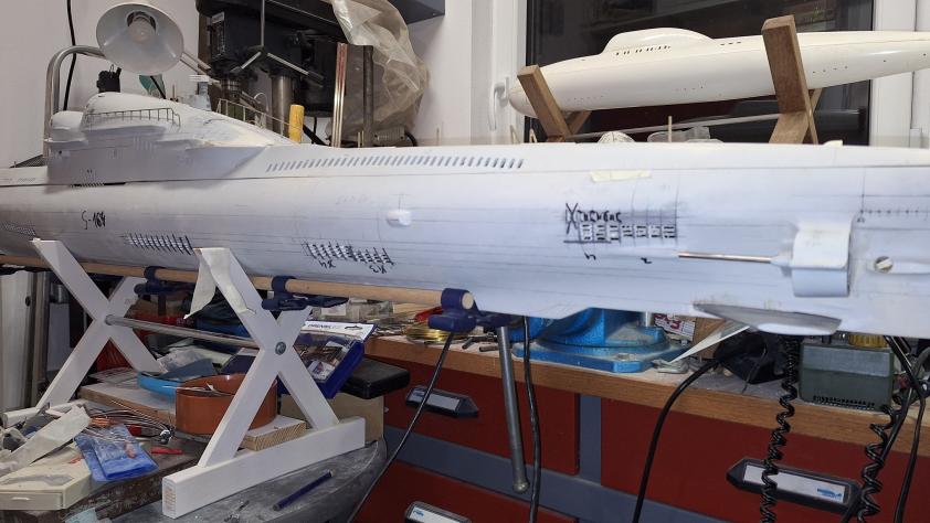

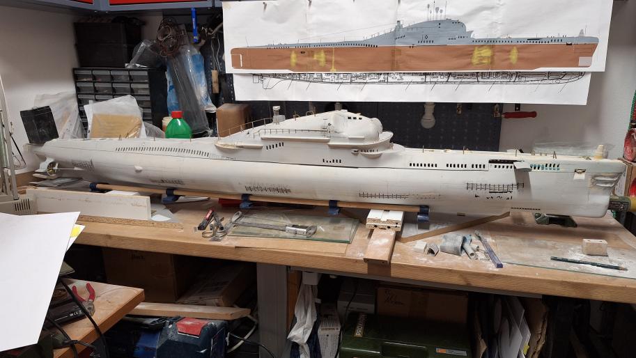

            Putting things back together to check the overall look

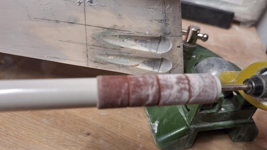

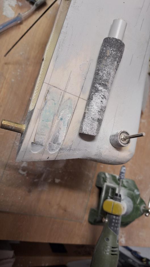

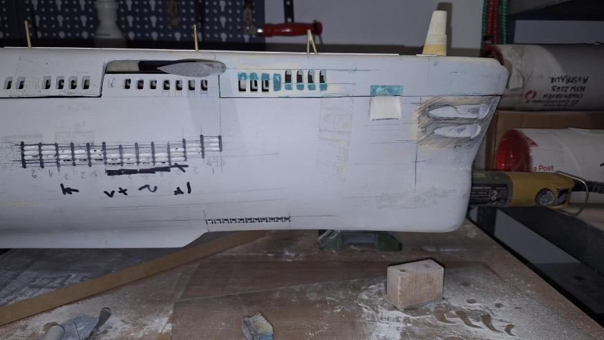

                  I made a custom grinding drum for fine tuning of my hand-ground tubedoor channels to achieve a perfect semilunar groove. Worked well, applied a thin coat of nitrofiller afterwards to cover the tool marks (no picture).
                  Click image for larger version  Name:	20260125_082429_copy_2040x1148.jpg Views:	0 Size:	52.2 KB ID:	193311 Click image for larger version  Name:	20260125_111425_copy_2040x1148.jpg Views:	0 Size:	51.7 KB ID:	193310

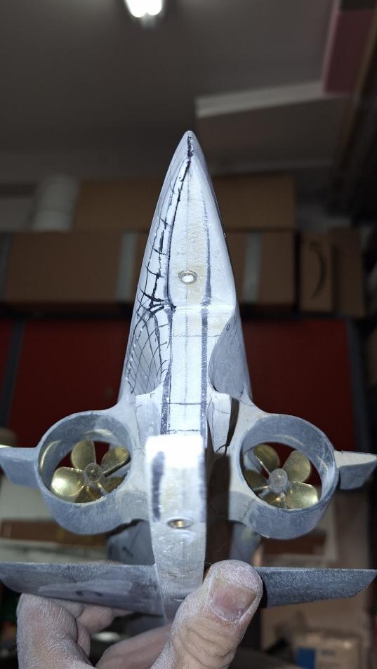

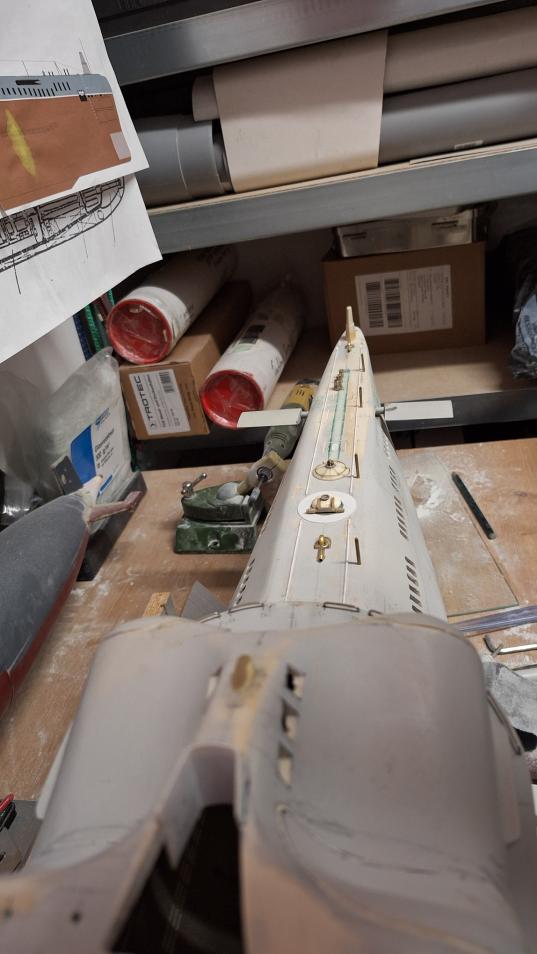

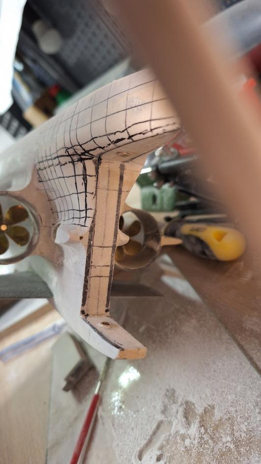

                  The stern end of the model is sadly far off the original and i am trying putting it to shape without carving holes into the sides that will need backing up laminating from the inside. Not yet sure about this.
                  Problem: the stern is way to fat just in front of the rudder and the kit seem to simply beeing cut out. No streamlining, cross-section is wrong. Knife-stern turned to axe-blade. Stupid stupid stupid...
                  Am sure i will not be able to turning this into scale shape without tebuilding this entirely since here, the wall thickness is only "normal", compared to 5mm midships. Not much tolerance to remove material. So i step by step am trying at the moment to grind in a credible taper, the rest will be coveted by the massive rudder itself...hopefully...

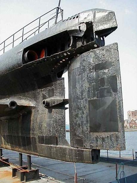

                  So this is what a whiskey looks like in general, though the 665 had a Foxtrot-layout with shrouded props and no stern tubes:
                  Click image for larger version  Name:	projekt-613-S359-stern.jpg Views:	0 Size:	59.1 KB ID:	193309

                    Now my model, started with trimming the edge:

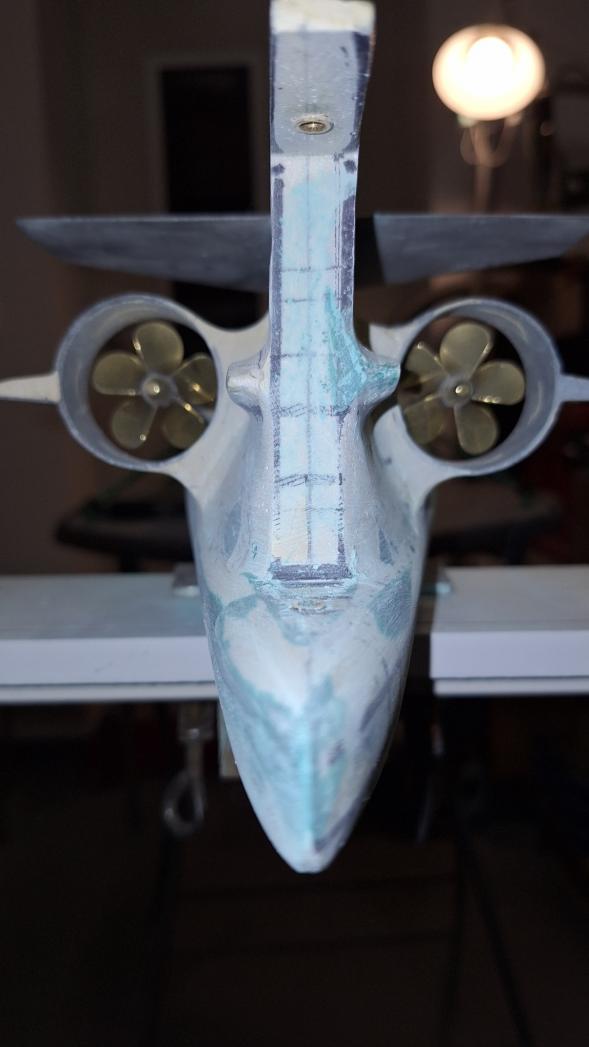

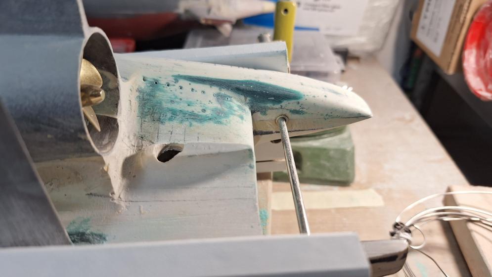

                              Greetings! The current state of streamlining the stern. Backing everything up with filler was necessary as there occuredsevereal perforations as espected. Will apply primer or flat black to check symmetry, not finished yet.
