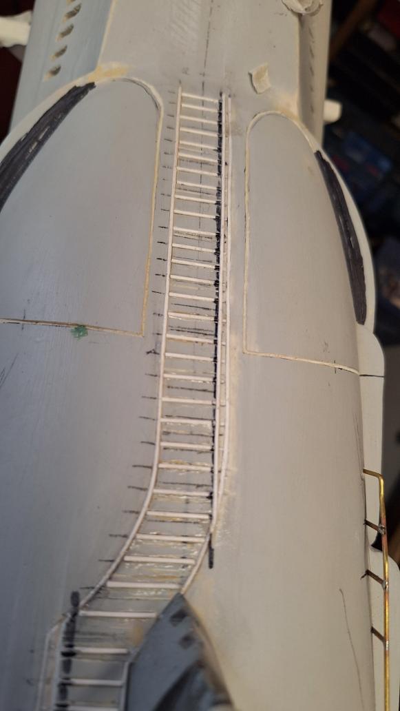

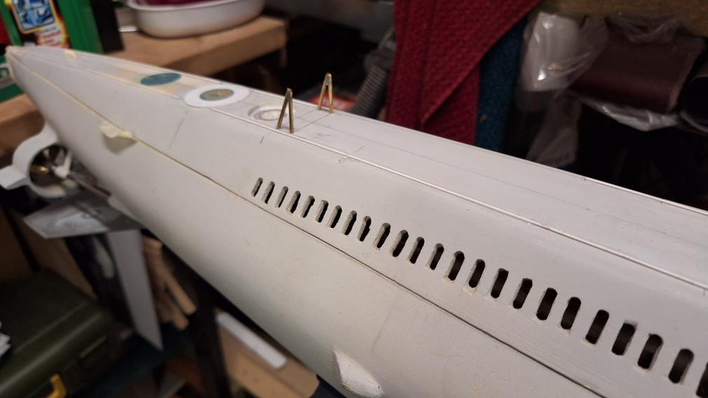

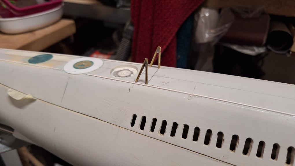

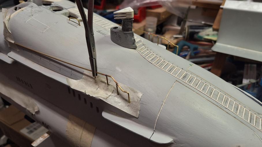

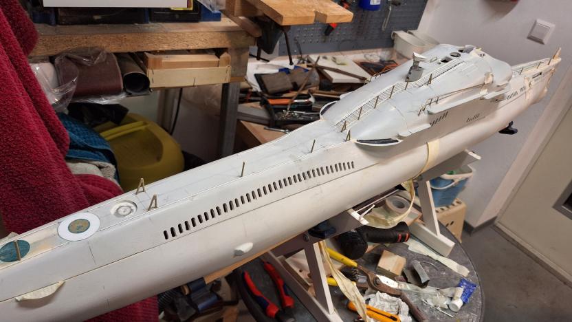

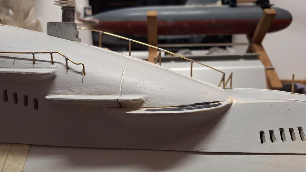

    Soldering directly on the model with a fine hot tip at 450 degr.C was much easier than expected.again, figuring out where those struts go was the bigger effort... the fore, much shorter ones will be dummys from abs rod,glued on the hull.

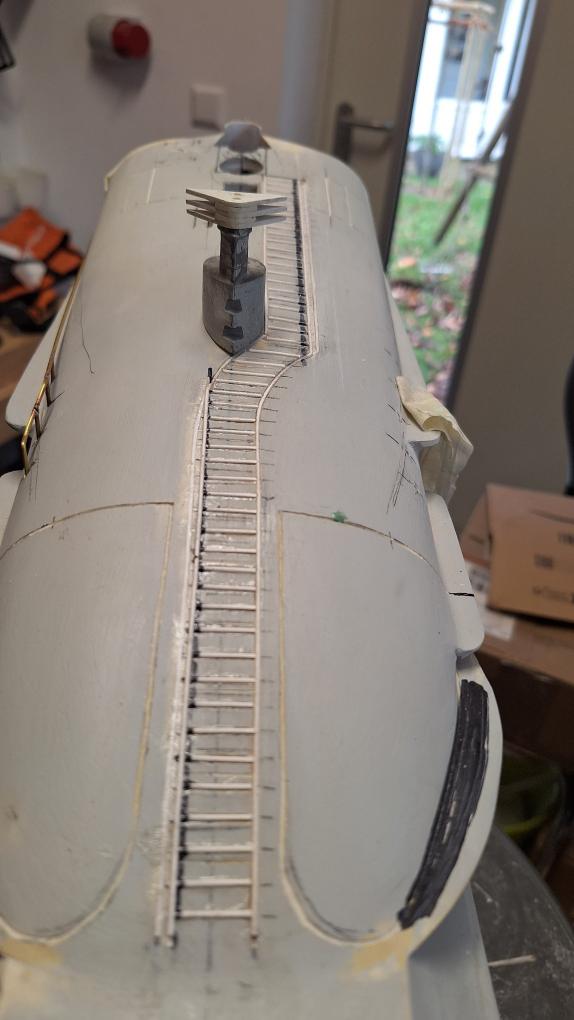

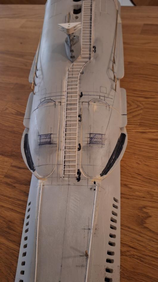

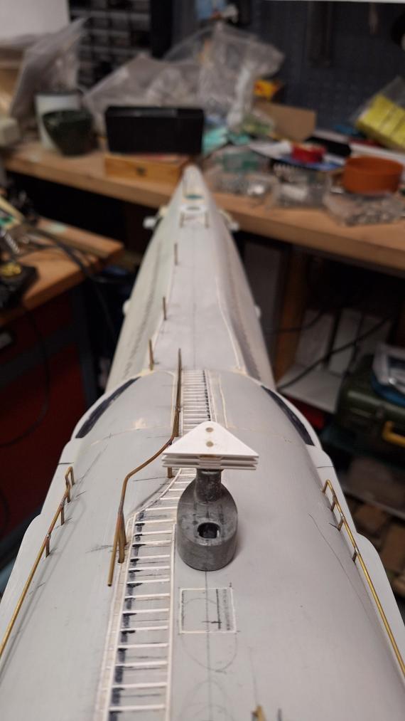

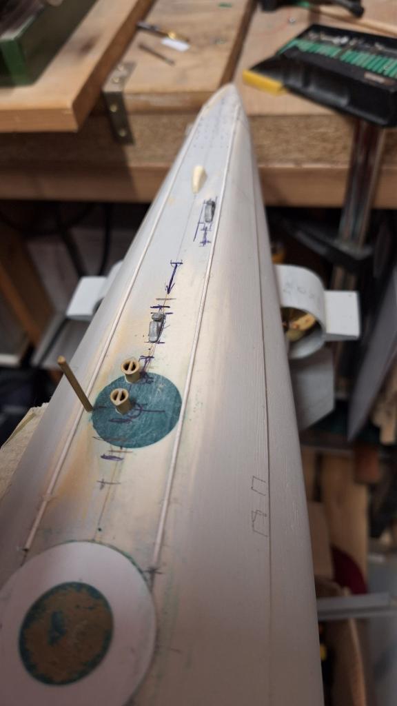

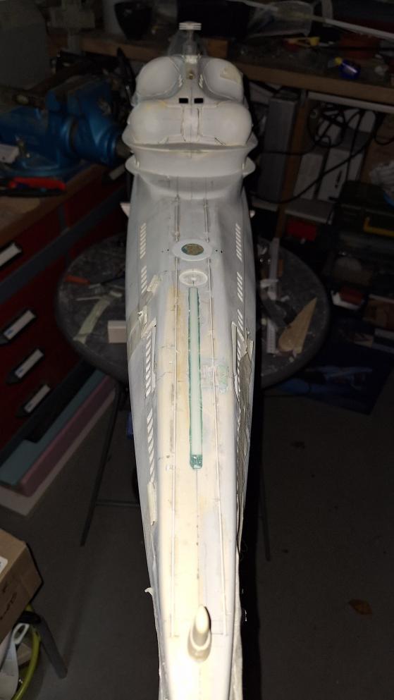

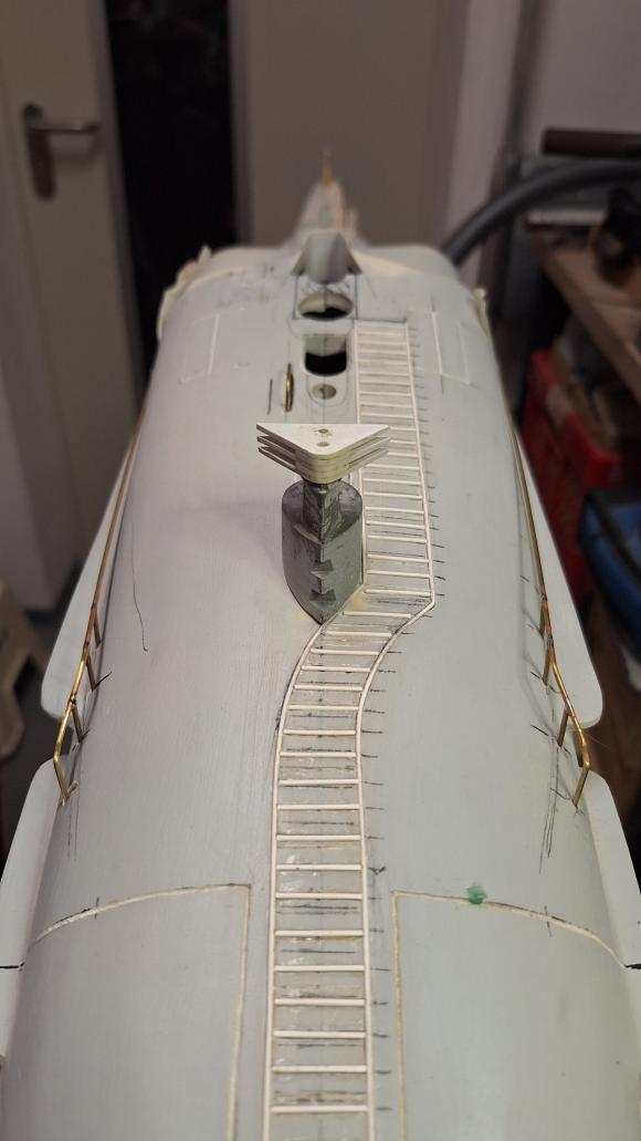

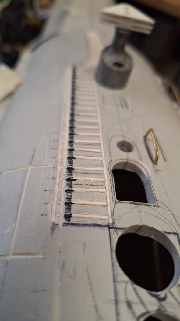

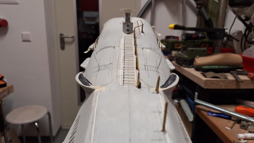

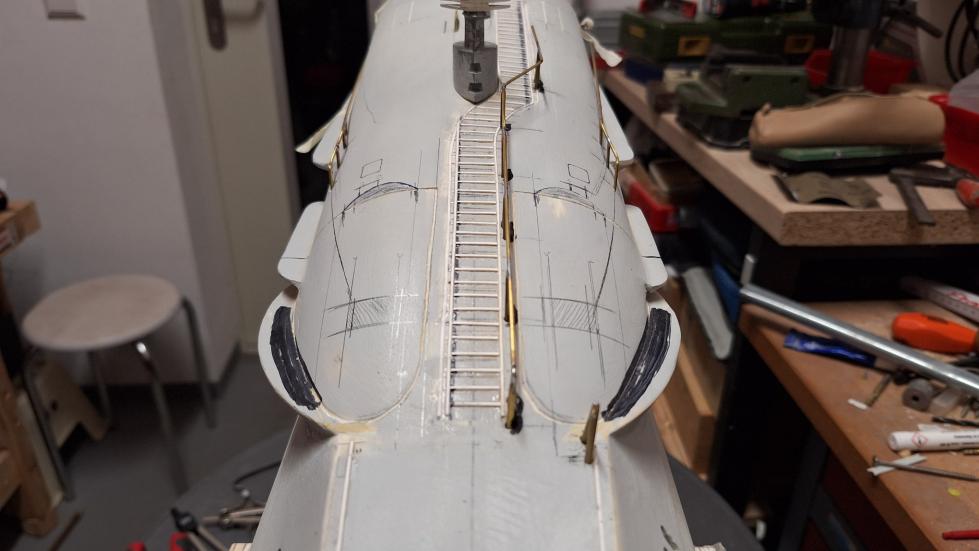

      Replaced the 2mm diameter safety tracks on the bow with 1mm rods to a more realistic measure. Also made the ladder-like gangway on the sail some mm narrower and put it to the right, where it should be instad of along the centerline.

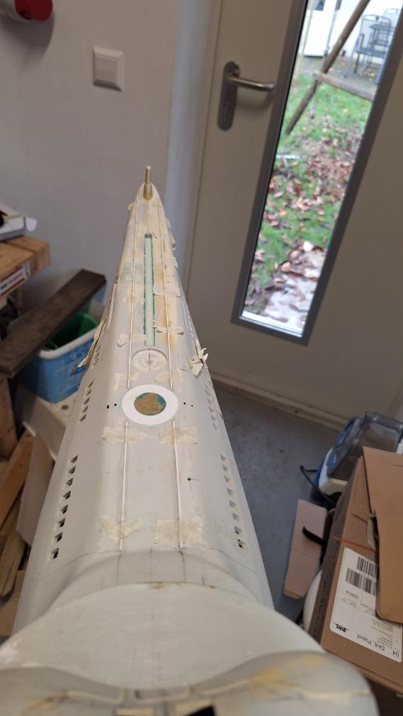

        Aft deck safety tracks:

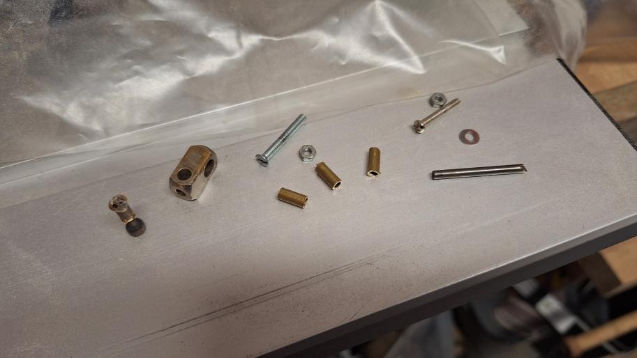

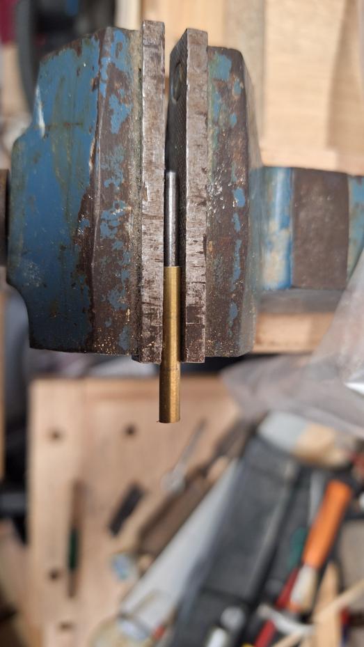

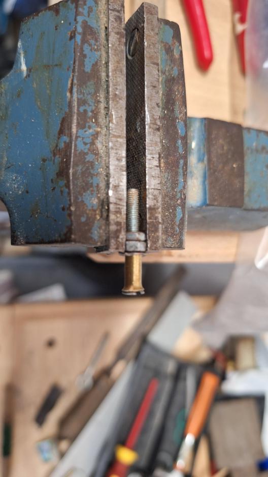

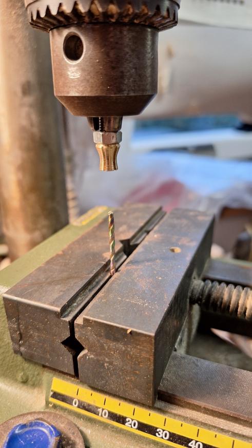

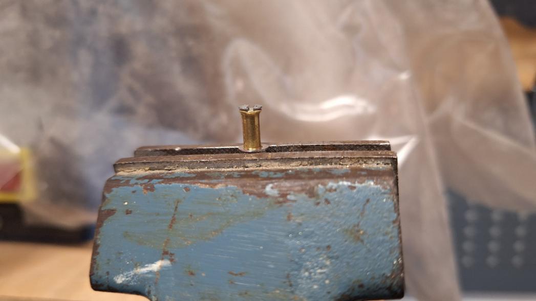

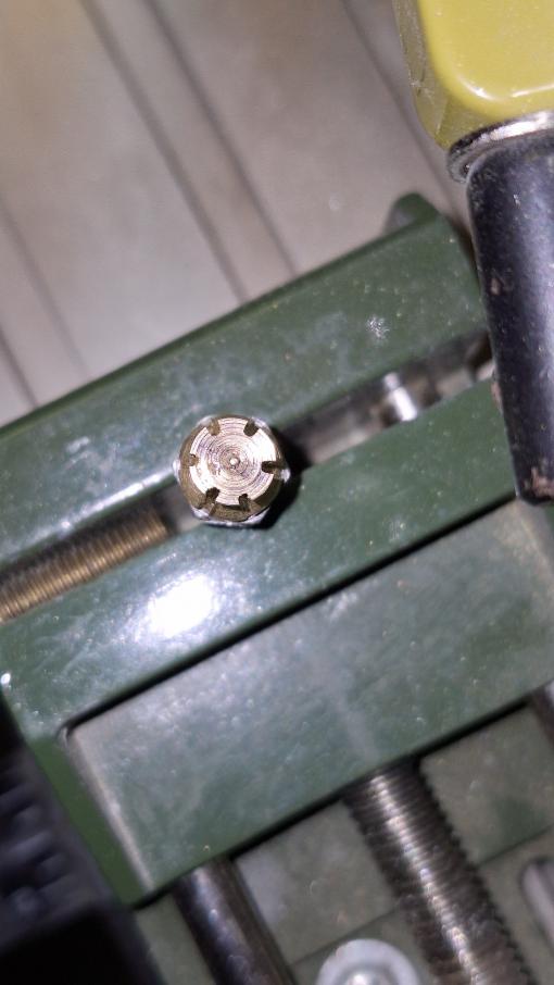

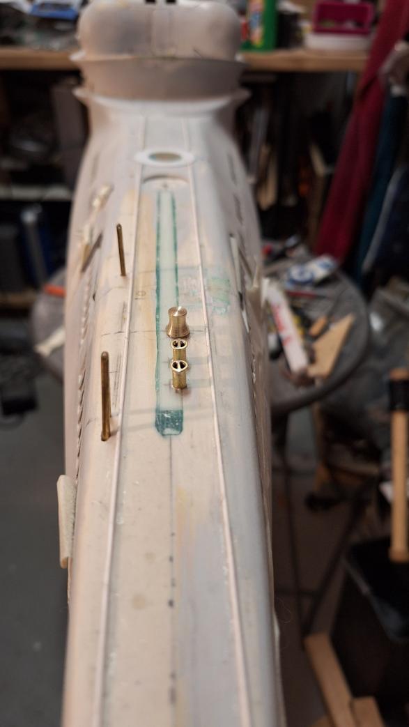

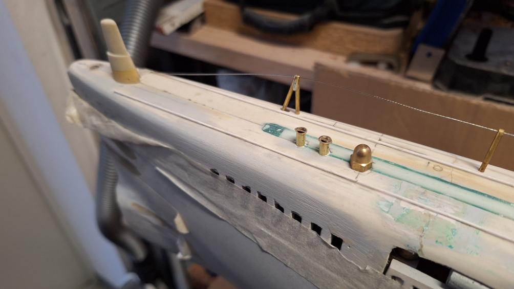

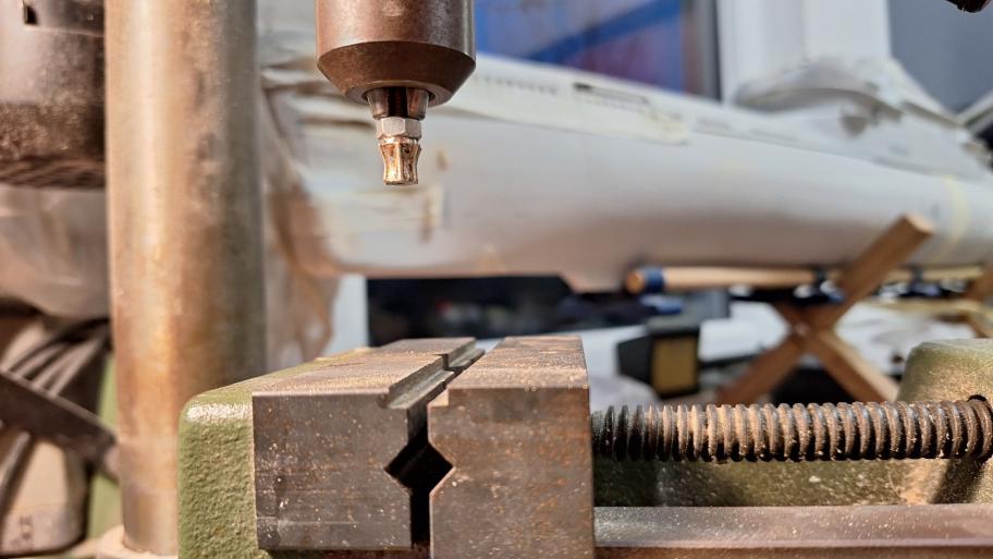

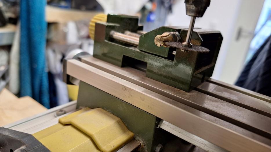

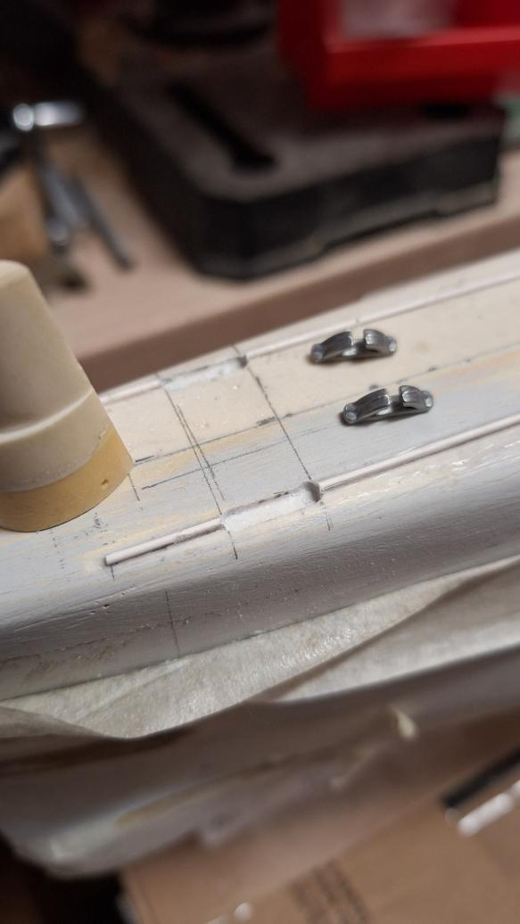

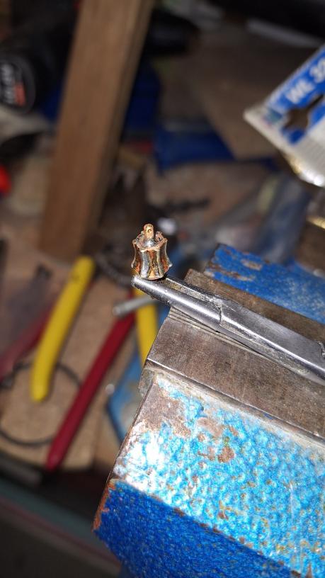

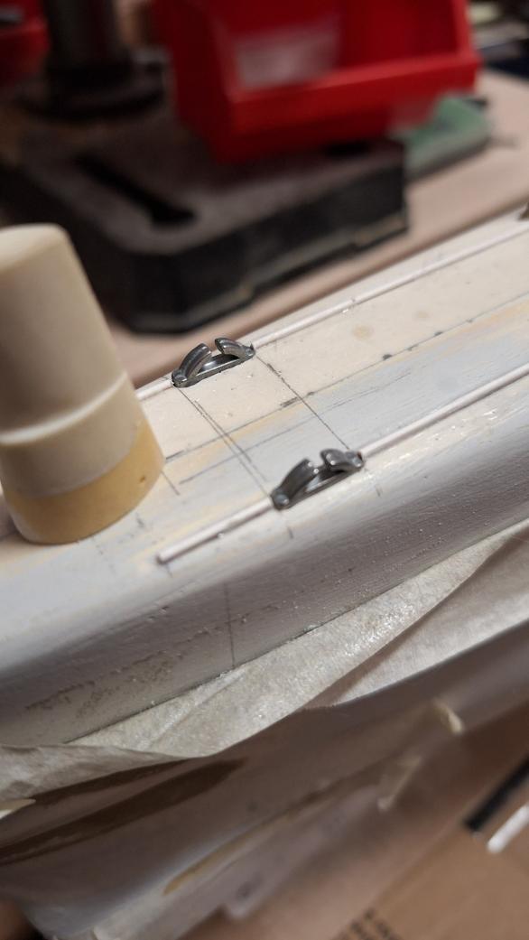

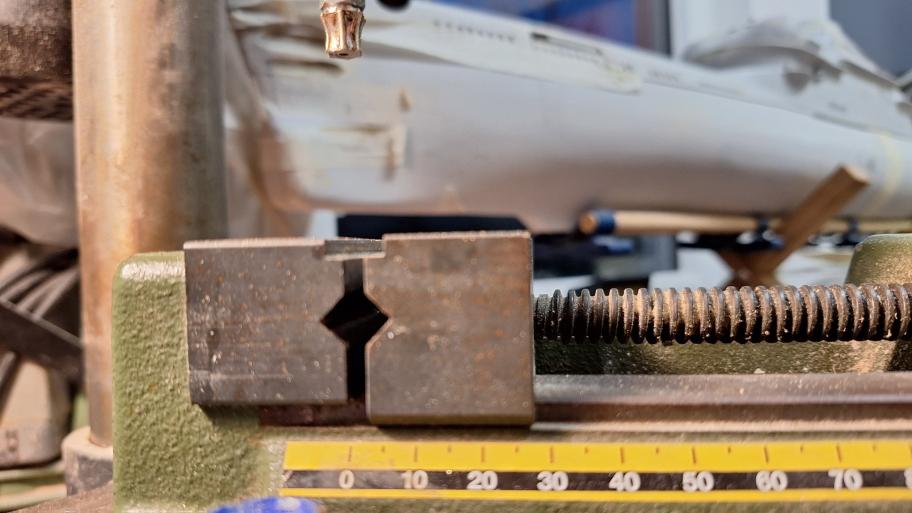

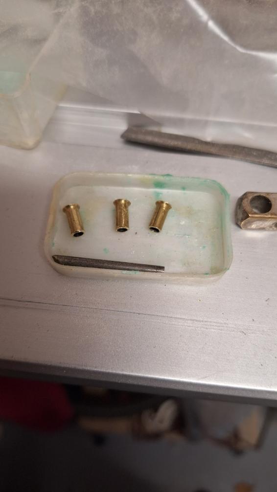

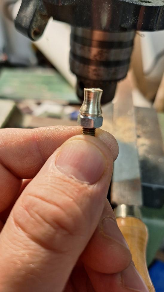

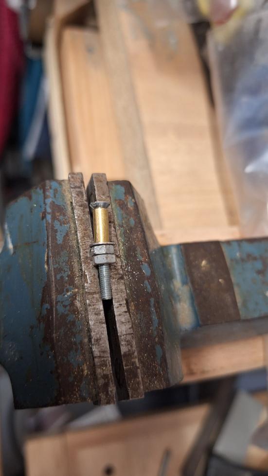

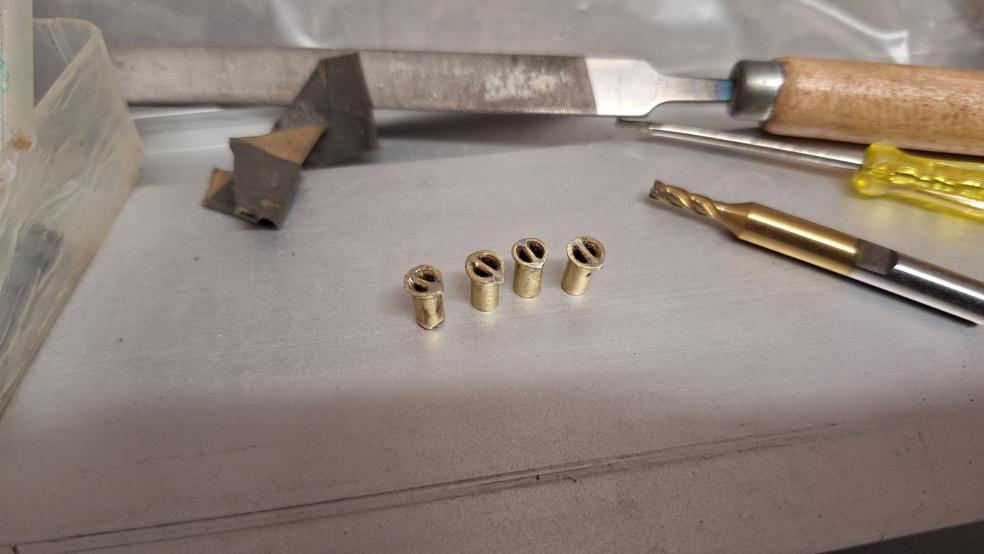

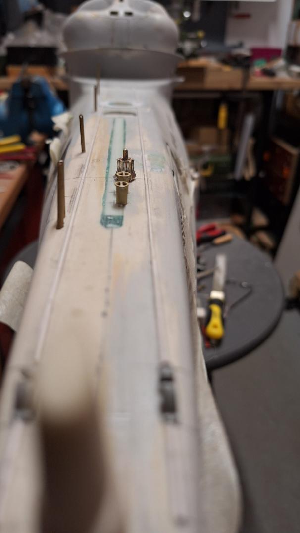

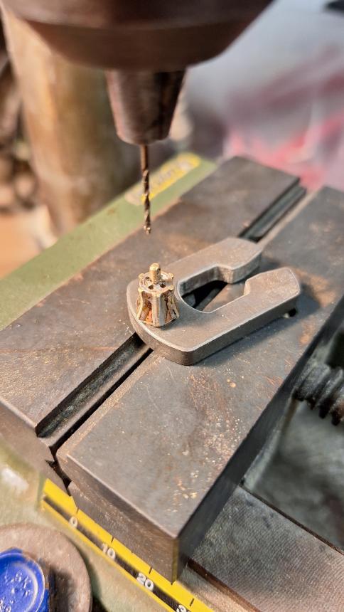

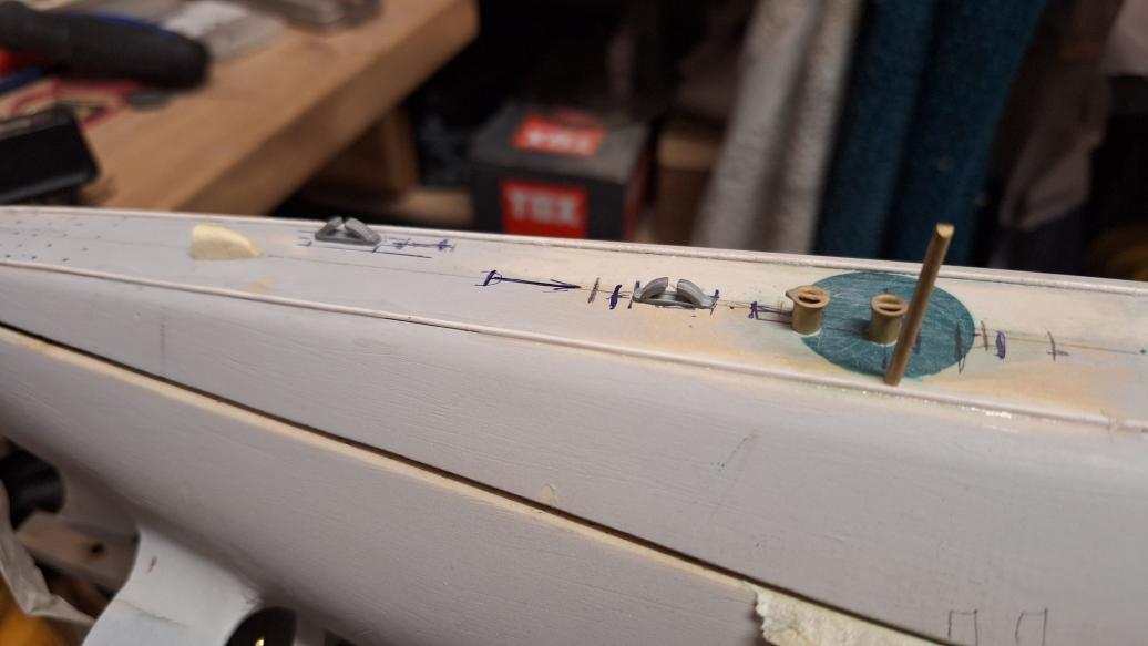

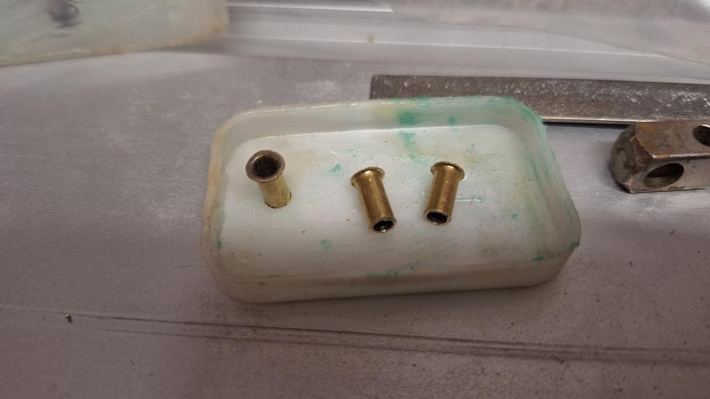

          Making the bollards:
          Click image for larger version  Name:	20251026_101415_copy_1148x2040.jpg Views:	0 Size:	53.6 KB ID:	191183 Click image for larger version
ID:	191202 Click image for larger version
ID:	191203 Click image for larger version
ID:	191204 Click image for larger version  Name:	20251026_101724_copy_2040x1148.jpg Views:	0 Size:	45.5 KB ID:	191192 Click image for larger version  Name:	20251026_102234_copy_1148x2040.jpg Views:	0 Size:	49.0 KB ID:	191189 Click image for larger version  Name:	20251026_102335_copy_2040x1148.jpg Views:	0 Size:	46.9 KB ID:	191193 Click image for larger version  Name:	20251026_103424_copy_1148x2040.jpg Views:	0 Size:	55.6 KB ID:	191188 Click image for larger version  Name:	20251026_103910_copy_1148x2040.jpg Views:	0 Size:	41.4 KB ID:	191190 Click image for larger version  Name:	20251026_143133_copy_1148x2040.jpg Views:	0 Size:	52.3 KB ID:	191191 Click image for larger version  Name:	20251026_143303_copy_2040x1148.jpg Views:	0 Size:	47.9 KB ID:	191179 Click image for larger version  Name:	20251026_144021_copy_2040x1148.jpg Views:	0 Size:	54.4 KB ID:	191184
          Click image for larger version  Name:	20251026_144519_copy_1148x2040.jpg Views:	0 Size:	57.1 KB ID:	191185 Click image for larger version  Name:	20251026_145638_copy_1148x2040.jpg Views:	0 Size:	54.5 KB ID:	191187 Click image for larger version  Name:	20251026_150825_copy_2040x1148.jpg Views:	0 Size:	49.5 KB ID:	191180 Click image for larger version  Name:	20251026_153512_copy_2040x1148.jpg Views:	0 Size:	50.1 KB ID:	191182 Click image for larger version  Name:	20251026_155225_copy_1148x2040.jpg Views:	0 Size:	44.9 KB ID:	191178 Click image for larger version  Name:	20251026_160041_copy_1148x2040.jpg Views:	0 Size:	54.4 KB ID:	191181 Click image for larger version  Name:	20251026_160049_copy_2040x1148.jpg Views:	0 Size:	52.2 KB ID:	191186

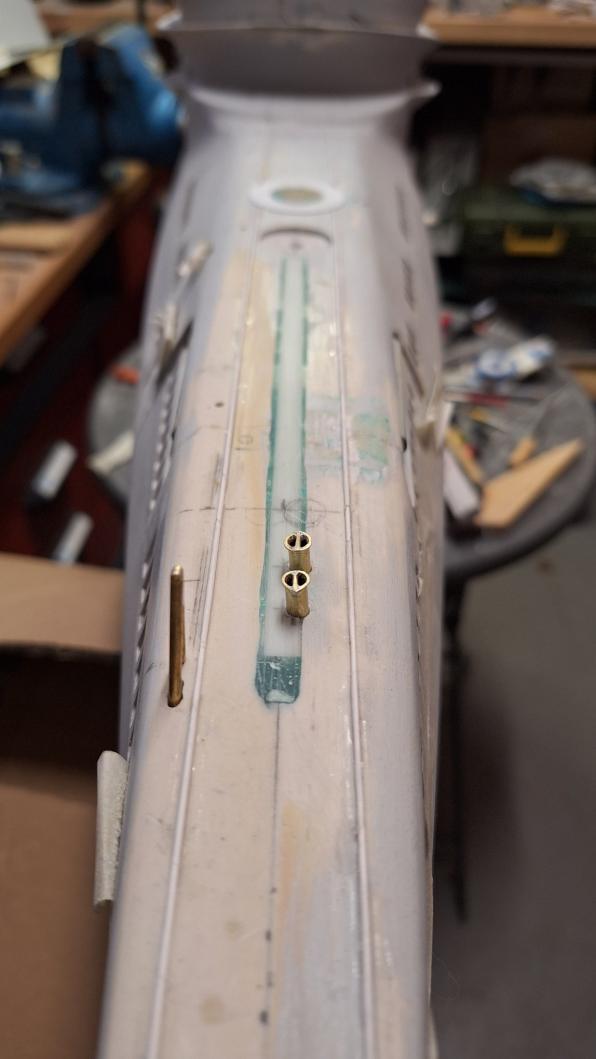

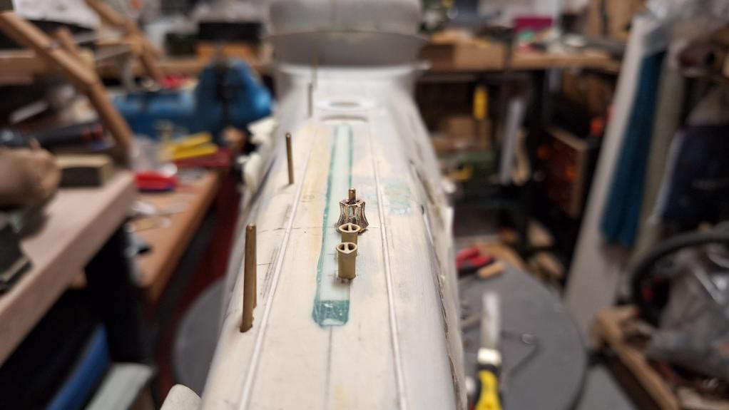

            #50

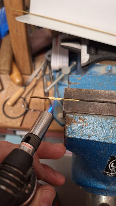

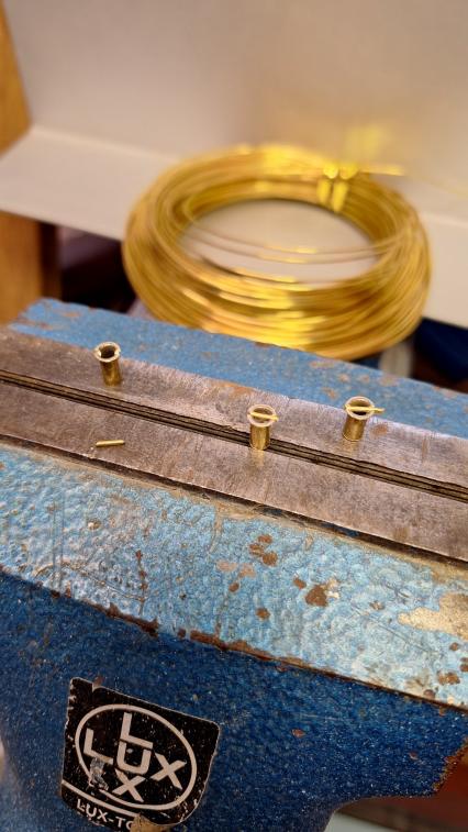

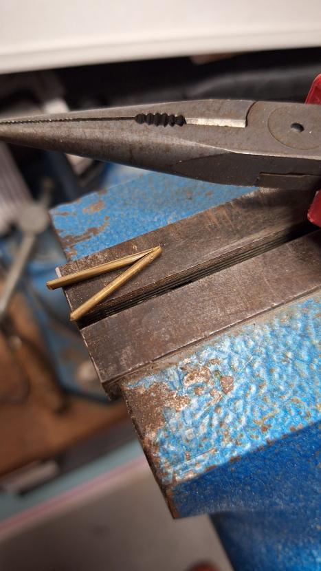

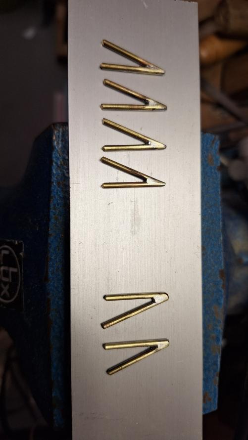

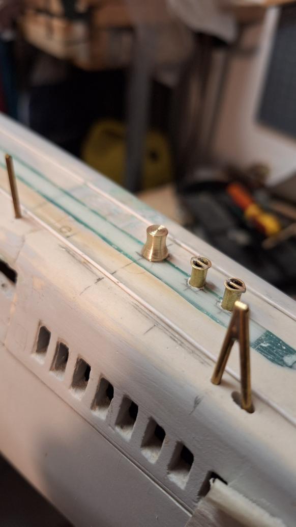

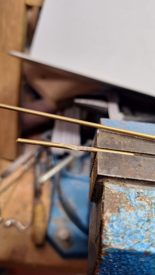

            Next group of posts for the aft deck reling. New way to make them:
            Click image for larger version  Name:	20251028_212220_copy_1148x2040.jpg Views:	0 Size:	49.0 KB ID:	191310 Click image for larger version  Name:	20251028_212310_copy_1148x2040.jpg Views:	0 Size:	53.3 KB ID:	191311 Click image for larger version  Name:	20251028_212616_copy_1148x2040.jpg Views:	0 Size:	54.0 KB ID:	191312 Click image for larger version  Name:	20251028_213016_copy_1148x2040.jpg Views:	0 Size:	43.4 KB ID:	191313 Click image for larger version  Name:	20251028_213405_copy_1148x2040.jpg Views:	0 Size:	40.7 KB ID:	191305 Click image for larger version  Name:	20251028_215004_copy_2040x1148.jpg Views:	0 Size:	47.6 KB ID:	191304 Click image for larger version  Name:	20251028_215011_copy_2040x1148.jpg Views:	0 Size:	49.5 KB ID:	191307

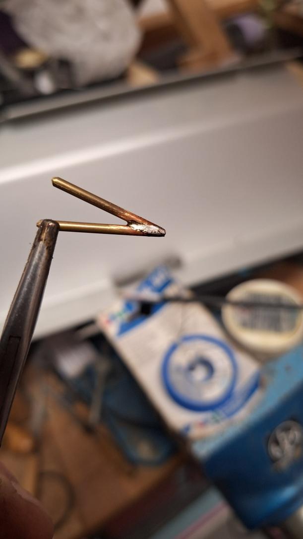

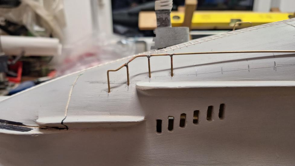

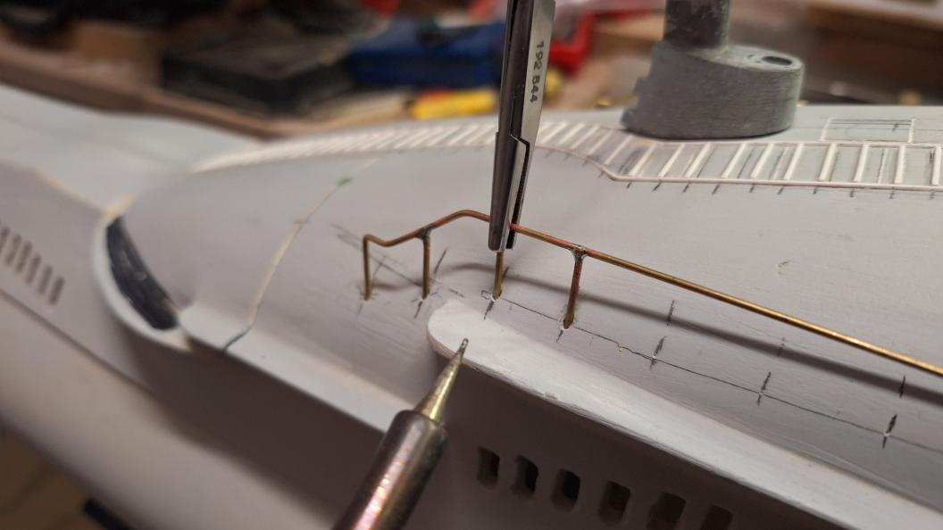

              Soldering the handrails next. The brass parts have been sandblasted.

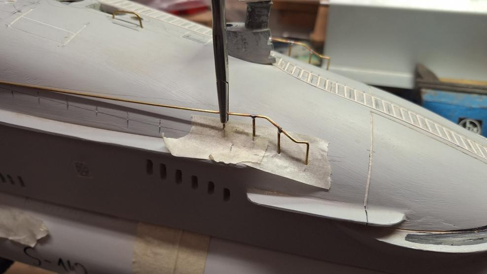

              • JHapprich
                • Oct 2017
                • 1031
                #52

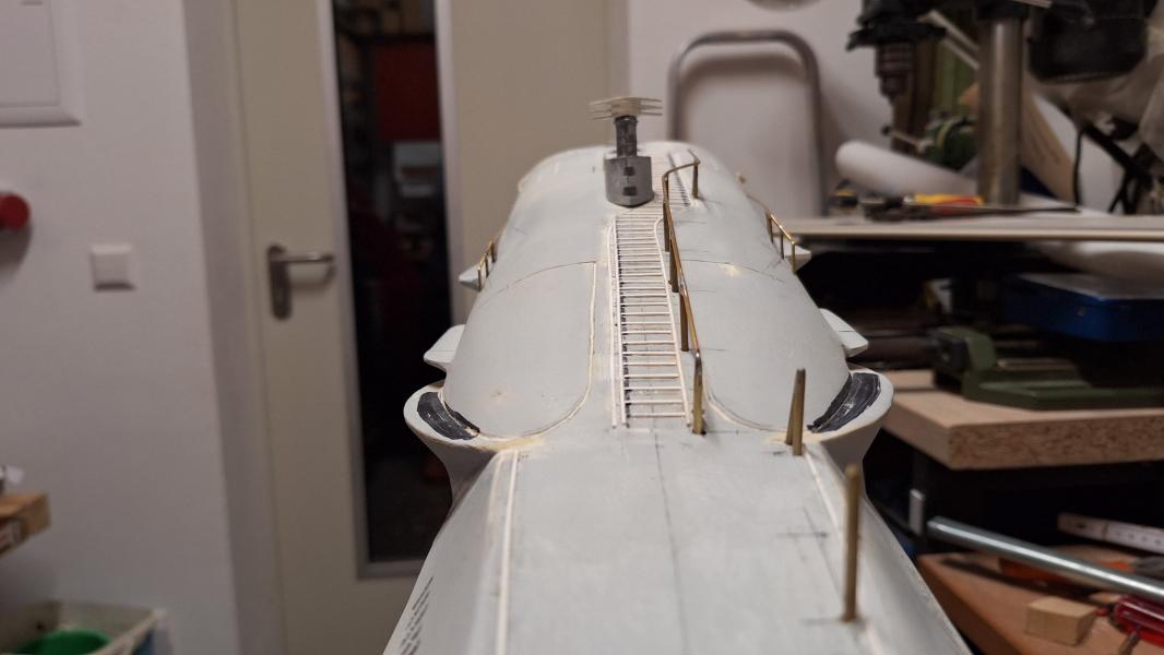

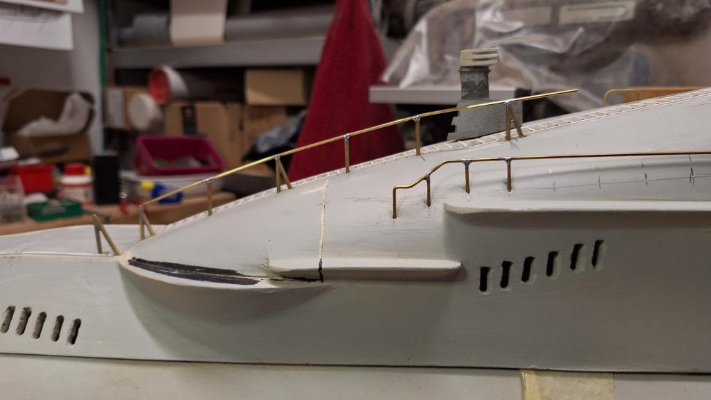

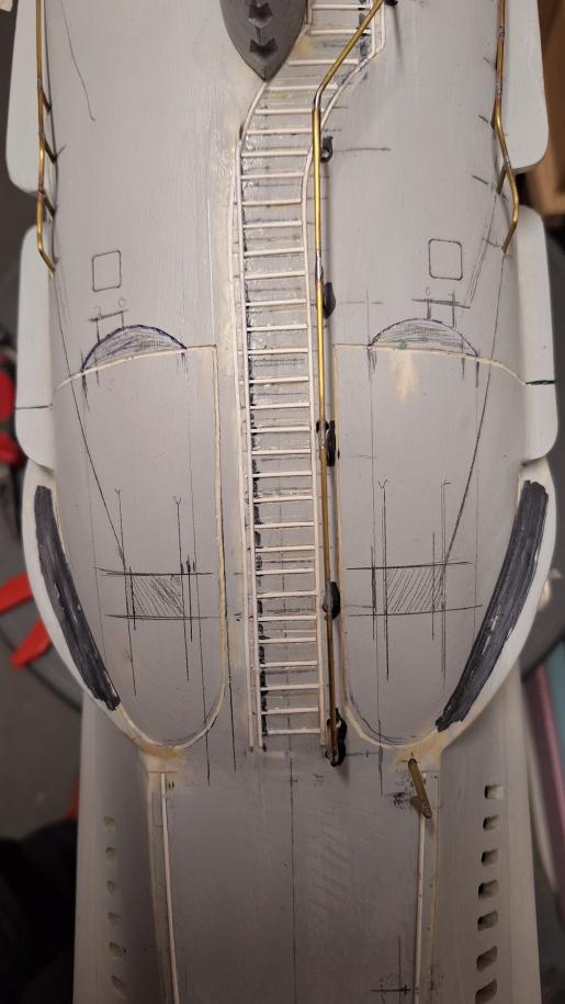

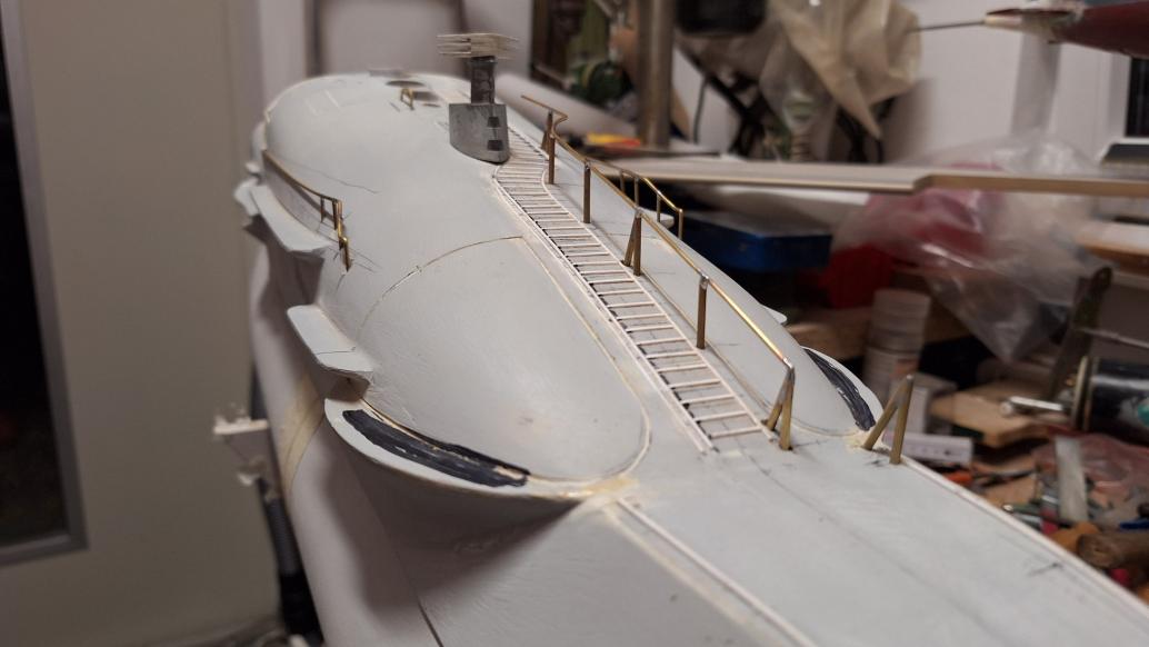

                Click image for larger version  Name:	20251105_221435_copy_1148x2040.jpg Views:	0 Size:	51.7 KB ID:	191584 Handrail is on. Will flatten everything straight and correct one post's position, but otherwise i like the look. With all those railings, no wonder those boats were the noisiest! Click image for larger version  Name:	20251105_221443_copy_2040x1148.jpg Views:	0 Size:	51.4 KB ID:	191578 Click image for larger version  Name:	20251105_221832_copy_2040x1148.jpg Views:	0 Size:	50.3 KB ID:	191579 Click image for larger version  Name:	20251105_221435_copy_1148x2040.jpg Views:	0 Size:	51.4 KB ID:	191580 Click image for larger version  Name:	20251105_221822_copy_2040x1148.jpg Views:	0 Size:	46.8 KB ID:	191581 Click image for larger version  Name:	20251105_221809_copy_2040x1148.jpg Views:	0 Size:	48.0 KB ID:	191582 Click image for larger version  Name:	20251105_221443_copy_2040x1148.jpg Views:	0 Size:	51.4 KB ID:	191583

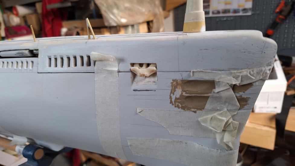

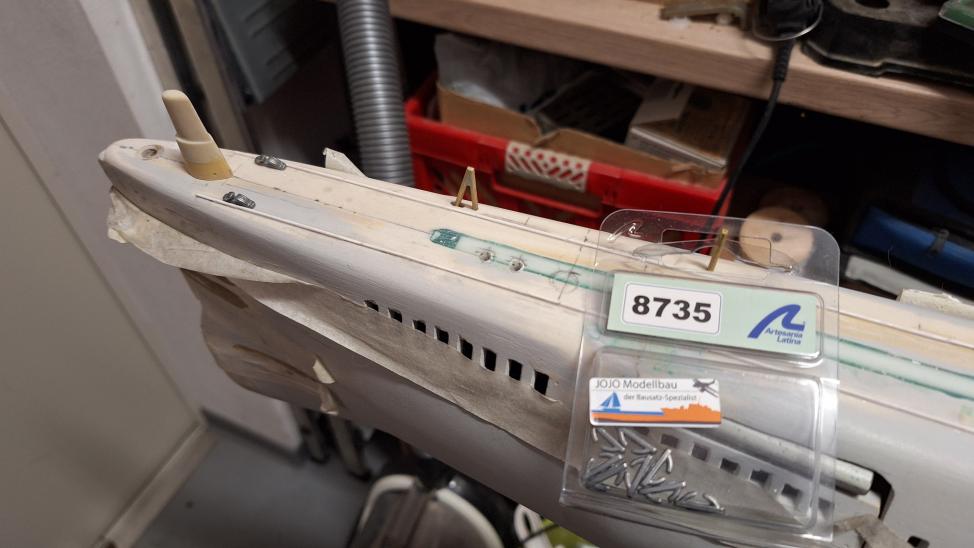

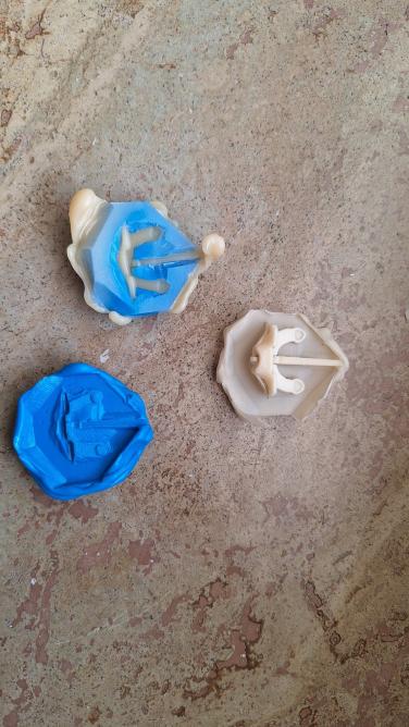

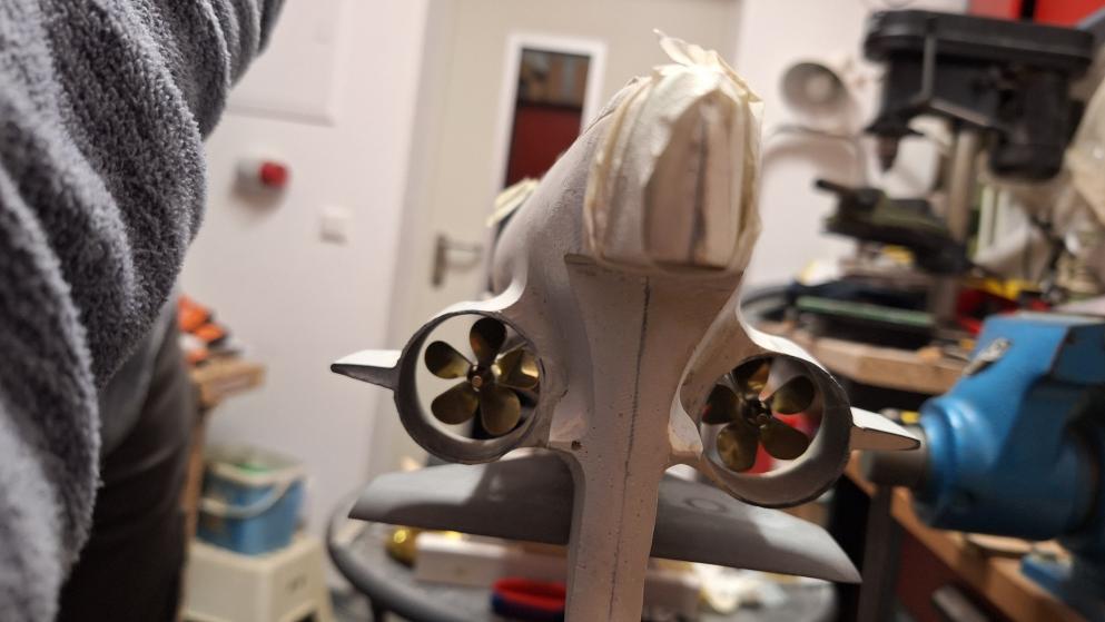

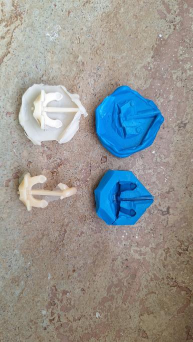

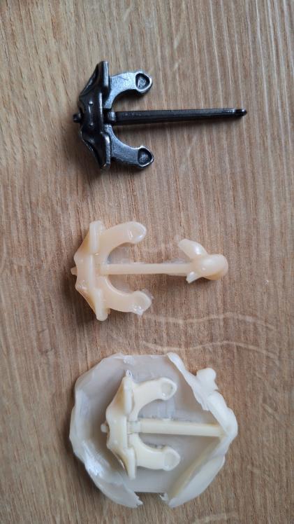

                        Ordered some small parts for little money that i found easier to buy rather to make them. The anchor deemed a bit heavy so i made a copy from resin. More brass rods arrived for the missing relings... changed the props from 3 to 5 blades. Did not find a proper 6-blader...
                        Click image for larger version  Name:	20251112_154226_copy_2040x1148.jpg Views:	0 Size:	53.7 KB ID:	191701
                        Click image for larger version  Name:	20251108_184127_copy_1148x2040.jpg Views:	0 Size:	52.5 KB ID:	191695 Click image for larger version  Name:	20251108_184703_copy_2040x1148.jpg Views:	0 Size:	57.1 KB ID:	191697 Click image for larger version  Name:	20251112_131219_copy_1148x2040.jpg Views:	0 Size:	51.3 KB ID:	191698 Click image for larger version  Name:	20251112_143022_copy_1148x2040.jpg Views:	0 Size:	48.9 KB ID:	191699 Click image for larger version  Name:	20251112_130423_copy_1148x2040.jpg Views:	0 Size:	50.0 KB ID:	191700 Click image for larger version
ID:	191710 Click image for larger version
ID:	191711 Click image for larger version

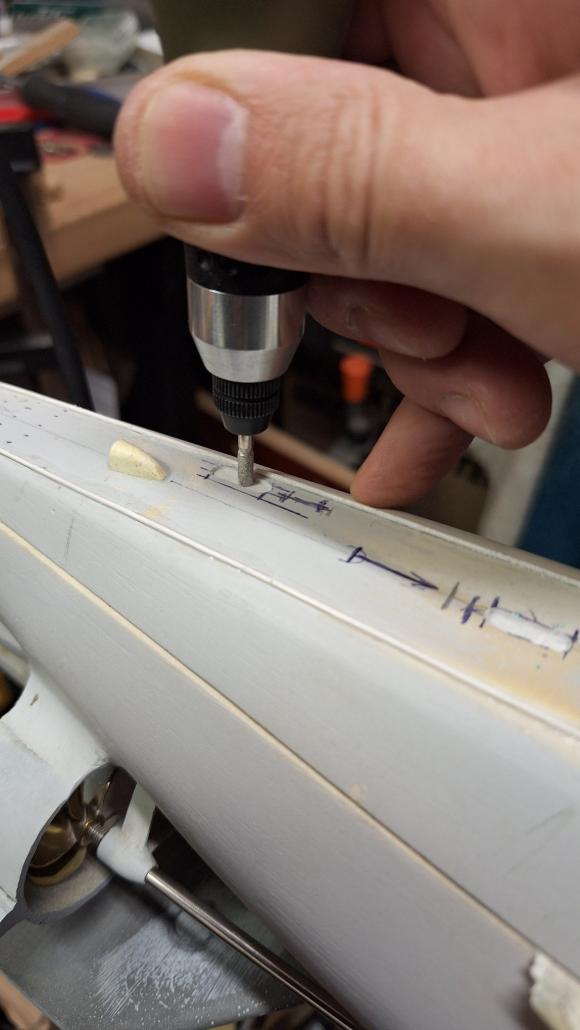

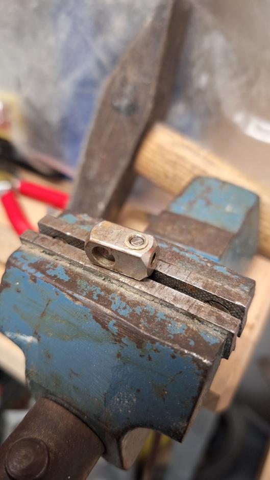

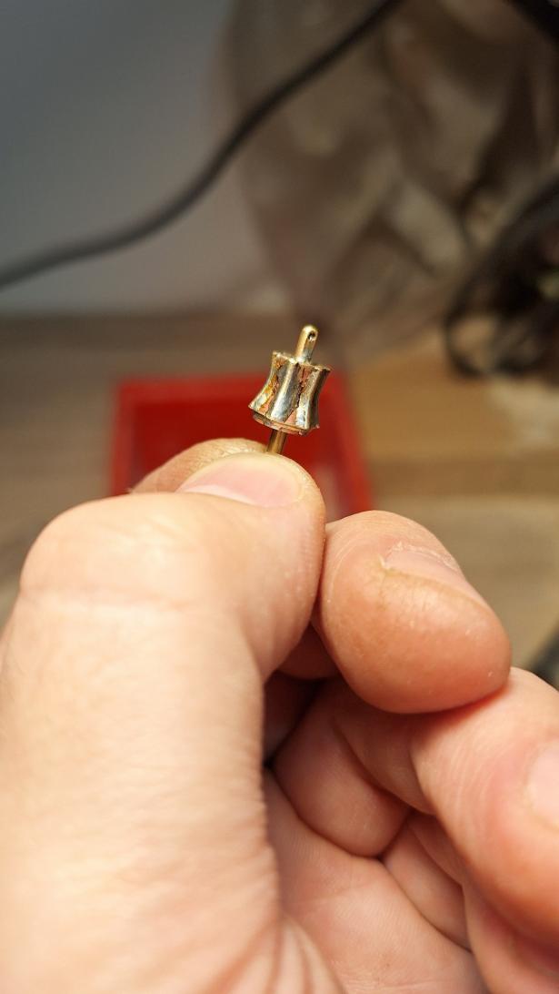

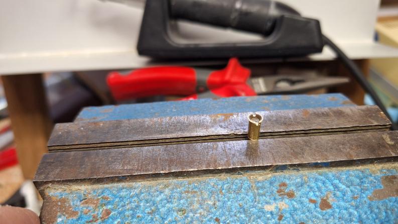

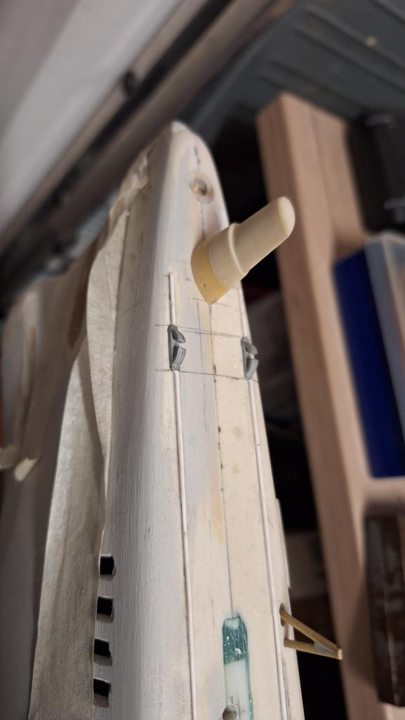

                          Some more pictures of the fwd deck and the construction of the anchor winch. I used the hex-nut on the holding bolt as orientation for the 6 cuts. Soldering the small brass-wire inserts proved to be difficult and i have to remove quite som excess solder. Tried sweating them on, what did not work out at all as the brass boday was way to massy to take the heat, so soldered one after another what took ages Afterall, am happy with the result. That should have been the last complicated part of the deck details, safe the masts that will come later. Next "big" thing to do is marking and opening up the lower floodholes. The diesel exhausts are in the wrong place and need detailing, too.
                          David M., acid arrived today. Once again, i cleanup my soldering spots, wipe with steel wool, degrease and apply acid until i see sufficiant oxidation, rinse with water and dry, apply primer straight afterwards, right? I use 42% ferric acid solution, how long should i expose the brass?

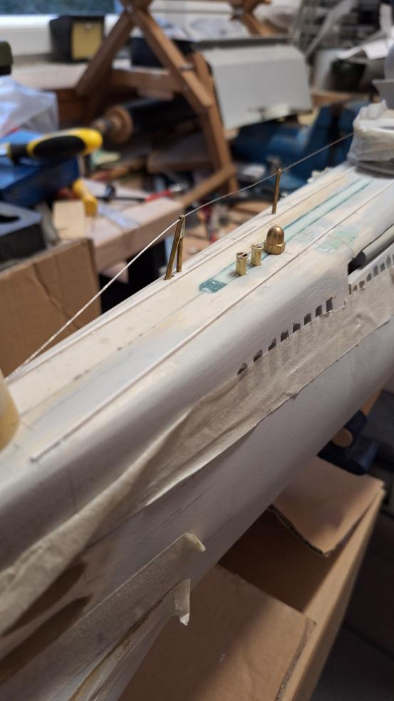

                            #58

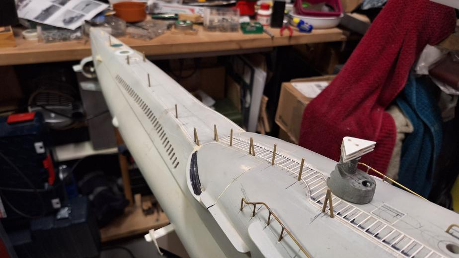

                            Details of the aft deck. Again, hours of cross-checking pictures for the proper position and 10 minutes working on the hull...
                            Sidenote, i am building the model as the S-142/pennant No. 570 as below. That boat was build as Project 665 from the keel instead of being a modified 613' Whiskey.
                            There were numerous differences and changes on the class over time, so safety tracks, hatches, floodholes etc. are not uniform between the submarines.

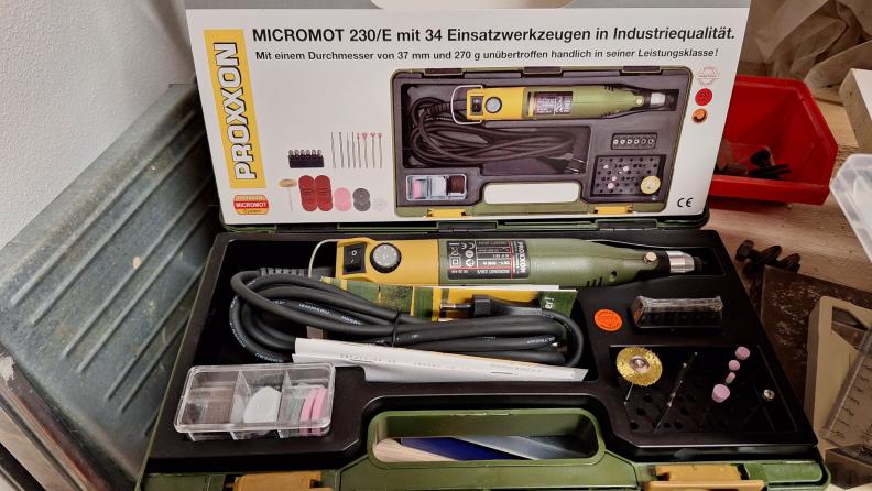

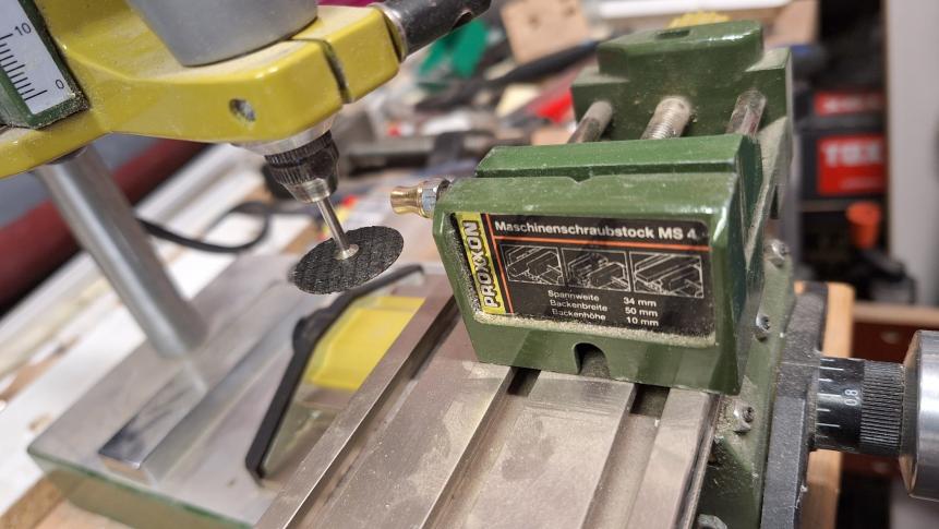

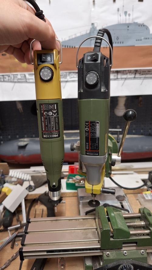

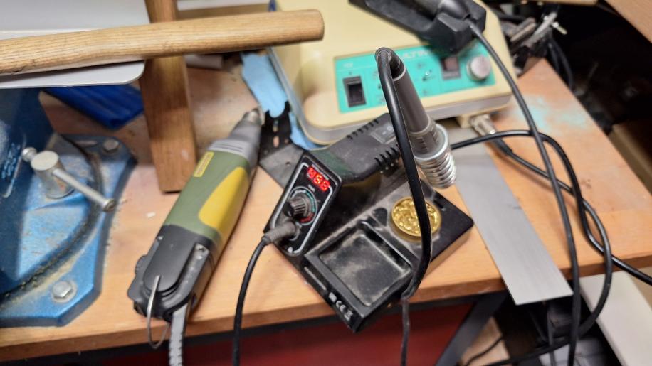

                              New tool arrived! Since my old Dremel did not survive minor woodwork(again!) I decided for the small brother of my superb Proxxon industral grinder that i rather use stationary. Holdable like a pen at 270 gramms, its great! I now have my old dental technician's micromotor for 2,35mm shaft bits and the new Proxxon for 3,2mm bits around for quick switching between the tools!

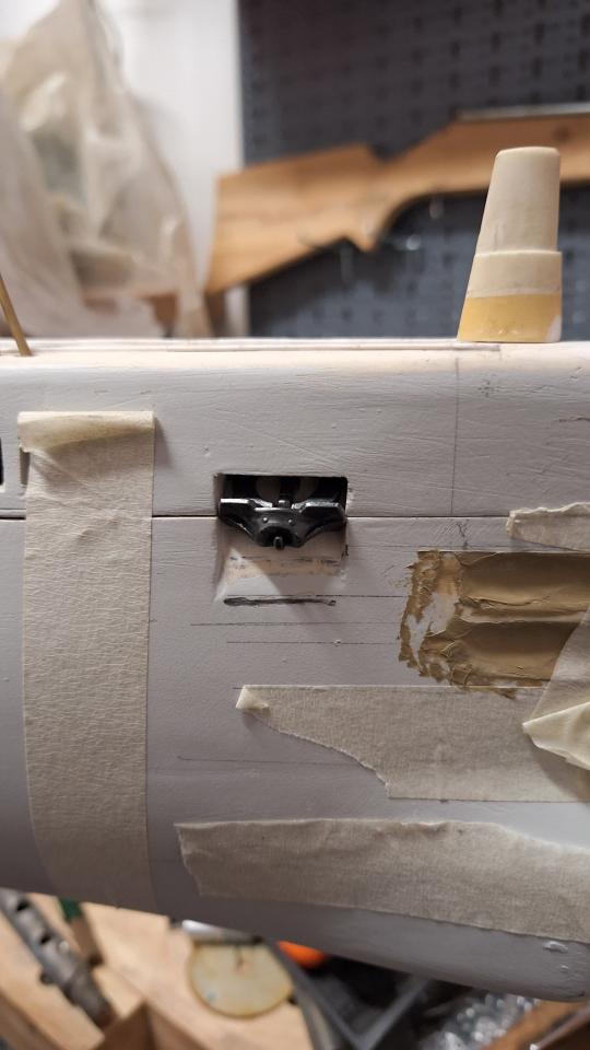

                                Started detailing of the sterward sailsection housing the rear doors of the missile tubes. Flaps and hatches and more of them... when finished, all the outlines will be scribed.this is just the first step needing a lot more work and some corrections. The semilunar mark will be cutout completely and receive a (non-funcional) hinge.
                                Click image for larger version  Name:	31-4561329-s-164-na-razborke-v-inkermane-11-1979_copy_1600x1067.jpg Views:	0 Size:	58.1 KB ID:	191871 Click image for larger version  Name:	665_170308_08_copy_770x1067.jpg Views:	0 Size:	55.3 KB ID:	191873 Click image for larger version  Name:	26-3846020-vopros._copy_1600x1002.jpg Views:	0 Size:	72.8 KB ID:	191876 Click image for larger version  Name:	15-3710493-bf-_copy_1570x1067.jpg Views:	0 Size:	66.6 KB ID:	191877 Click image for larger version  Name:	20251118_182559_copy_2040x1148.jpg Views:	0 Size:	51.0 KB ID:	191872 Click image for larger version  Name:	20251118_182545_copy_1148x2040.jpg Views:	0 Size:	53.8 KB ID:	191874 Click image for larger version  Name:	20251118_182604_copy_2040x1148.jpg Views:	0 Size:	54.0 KB ID:	191875
