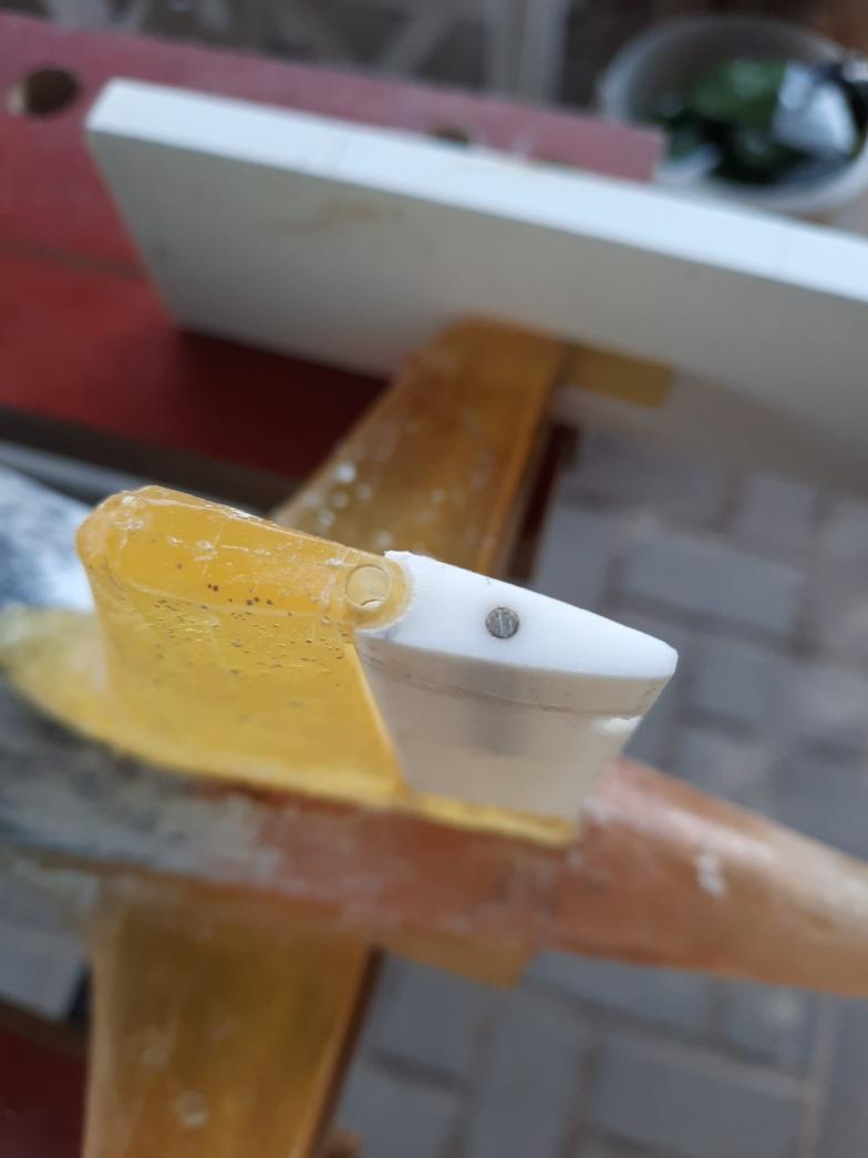

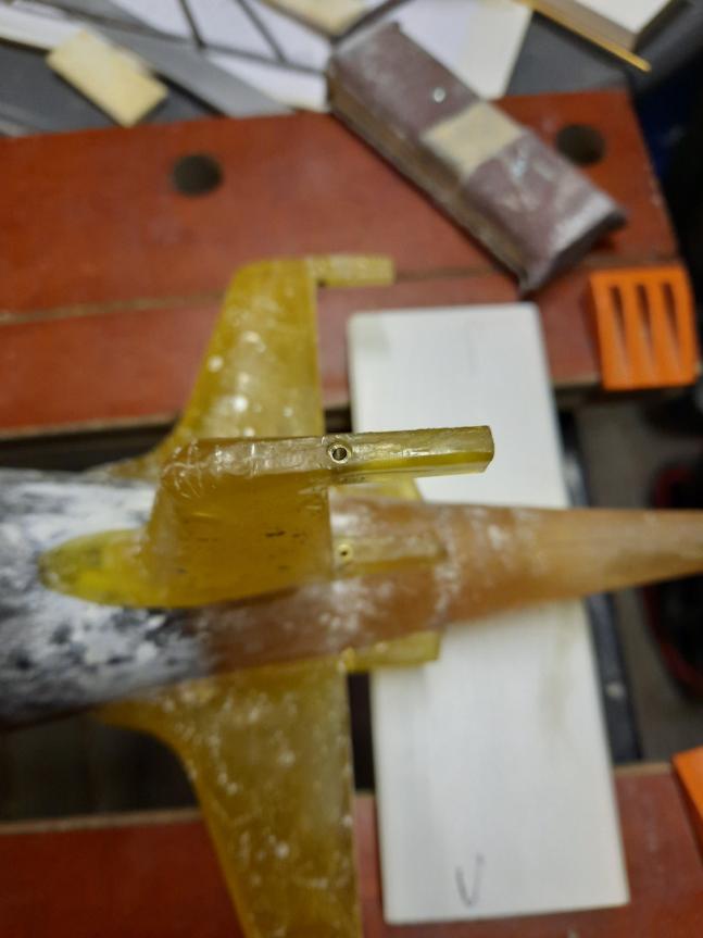

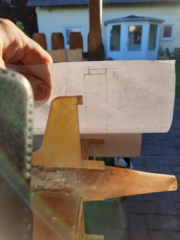

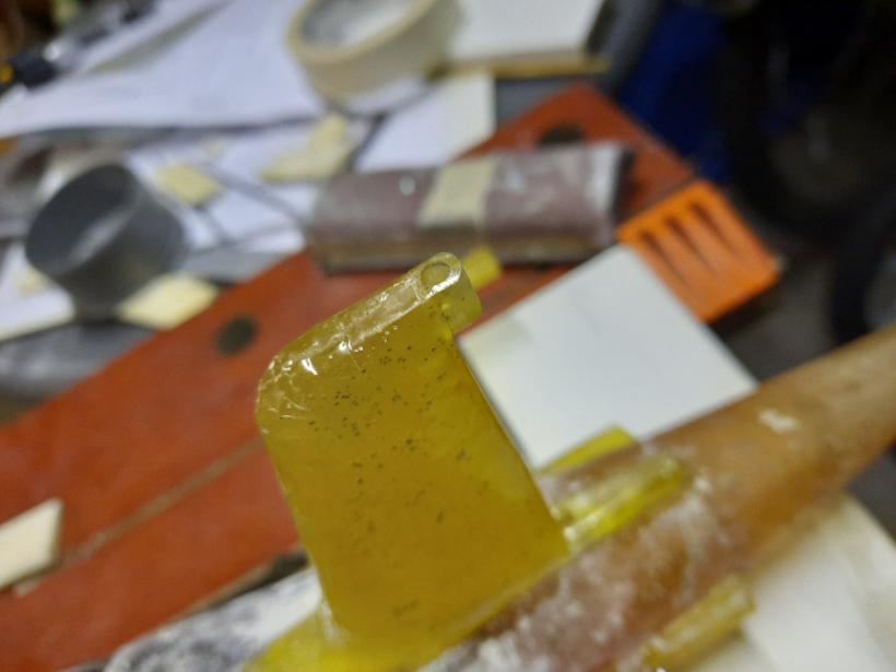

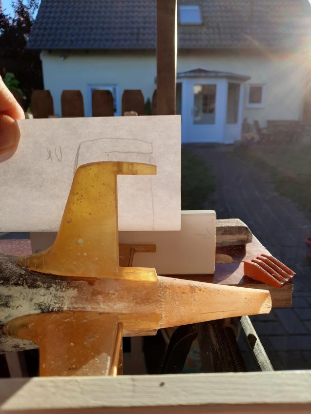

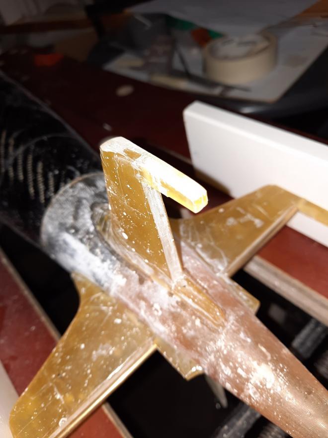

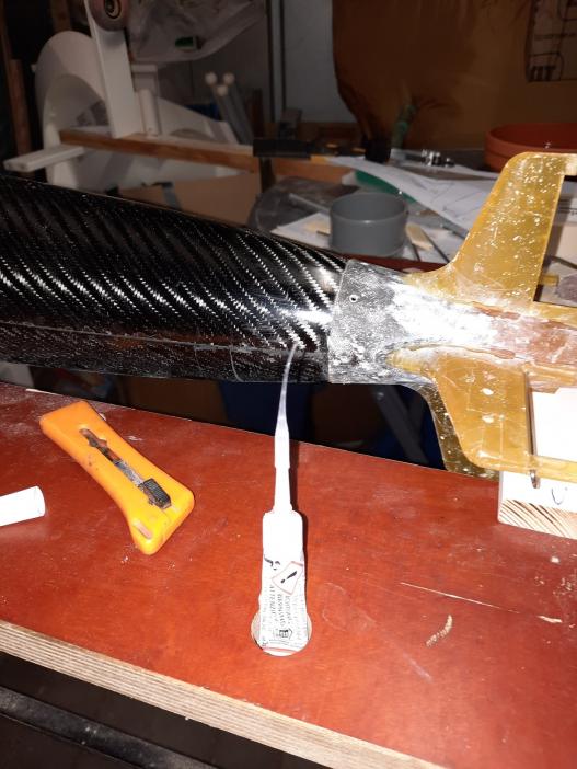

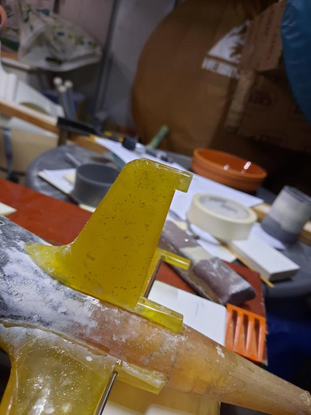

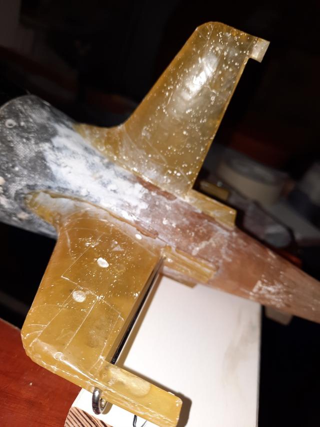

        A little progress: i finished milling out the hollow grooves at the fins for fitting the planes - i should have included that in the master a long time ago! Started to invidualize the rudder as well, made the lower rudder.

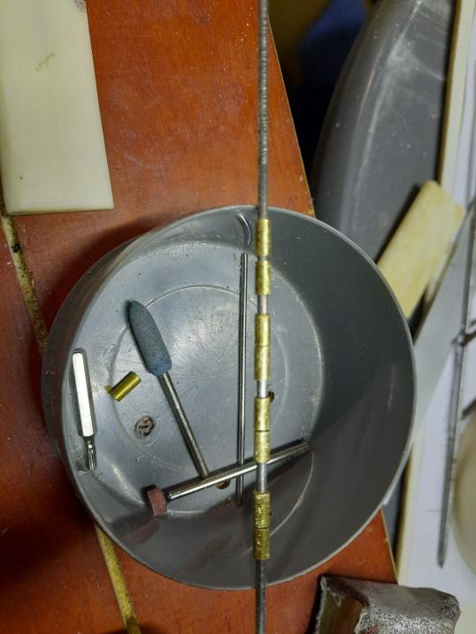

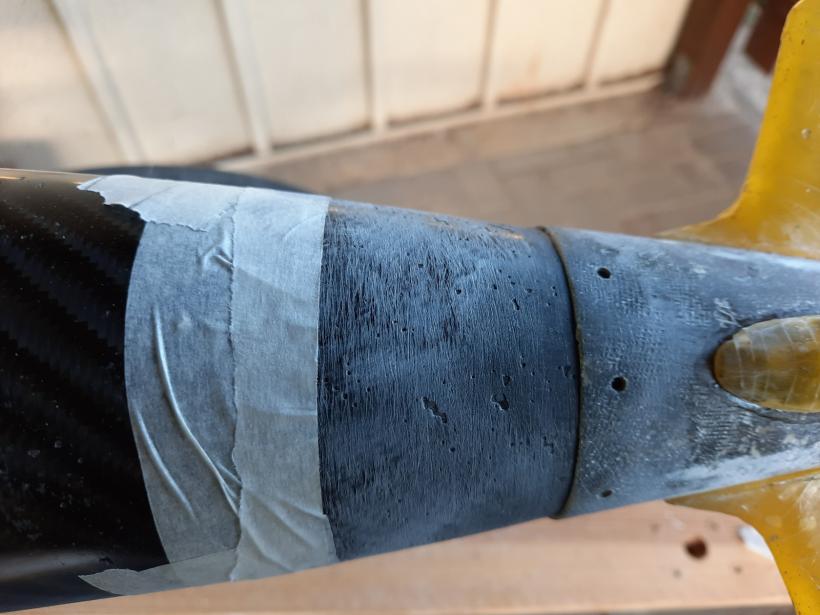

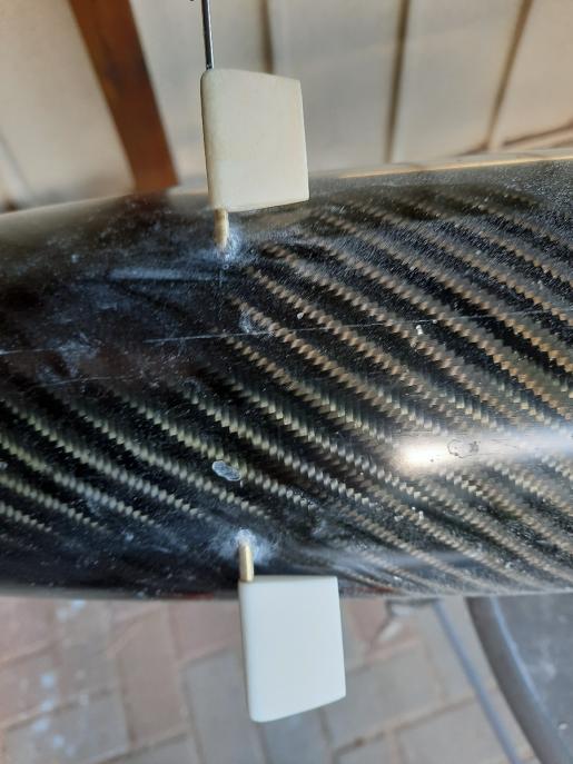

            Thank you! Slow progress today: Installation of the plane bushings.
            3mm brass rod was cut to length and glued into the fins with CA. To do so, i drilled a tiny hole into each opening from one side of the fin, cleaned everything with alcohol and used a steel rod to align the bushings. Once properly placed, i injected the CA through the small holes. This saved me from having to hurry before the glue was cured and kept my fingers clean!

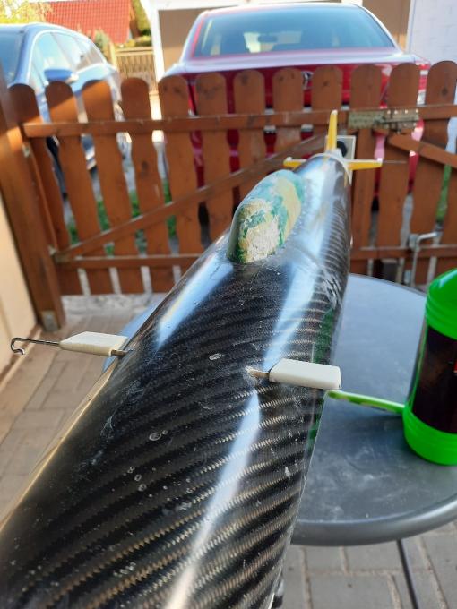

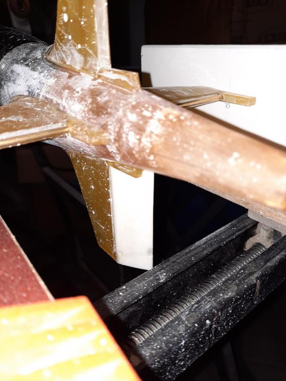

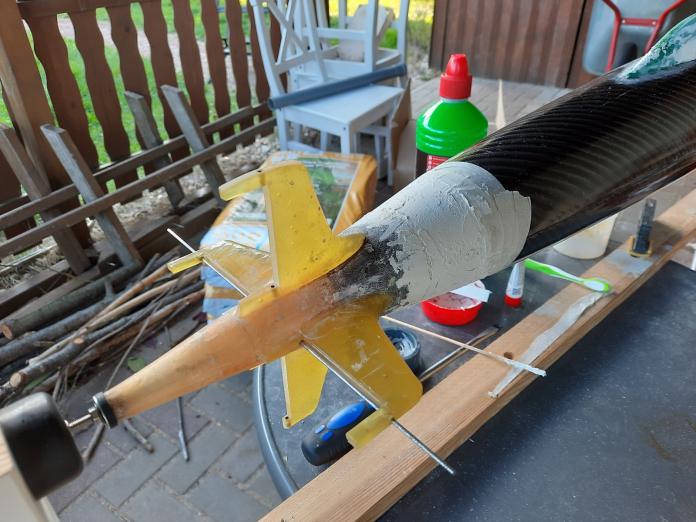

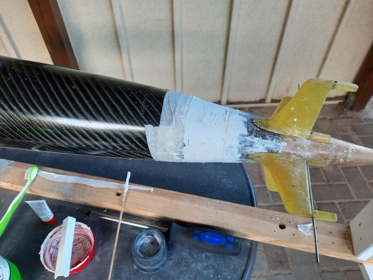

              Yesterday: Installation of the fwd diveplanes and basic filling of the transition from the old hull to the new stern cone.
              Jörg
