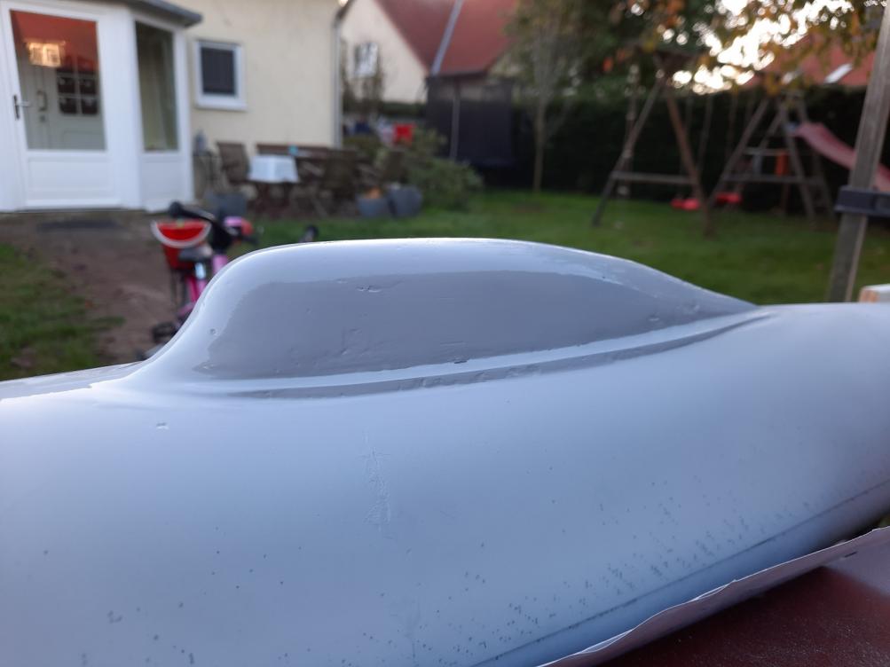

                      Starting to shape up. This thing will go like blazes once you unleash the speed-controller.
                        • 1121
                        Jupp. The grey paint will help spotting uneven areas and symmetrie checking.
                        Cold here, last sunny afternoons so i need to hurry up with the basic resin works. Have to wait until tomorrow so i can finish sanding.
                        Jörg

                          Fill-grind-repeat.
                          That sail shape is not easy to replicate!
                          A solution to produce even "channels" for the planes to rotate without binding: insert shaft, put over a proper piece of tube and sanding paper and start...grinding.

                            From what was the worst, vile looking collision of varied substrates, glue smears, and tool-marks... emerges a stunning butterfly!
                            The magic of a unifying coat of light-colored primer well demonstrated sir. Invigorating, isn't it?
                            Sure. It still has flaws, but now they are more apparent, and will soon suffer your terrible wrath.
                            The Commie Speed-Demon is coming to life.
                            Go get 'em, Tiger!
