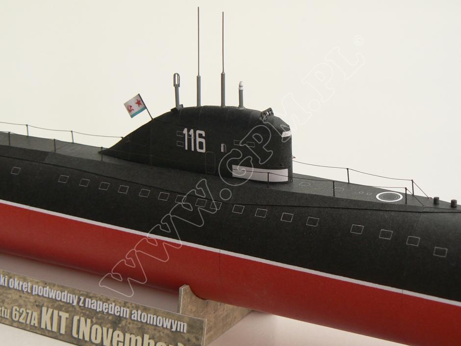

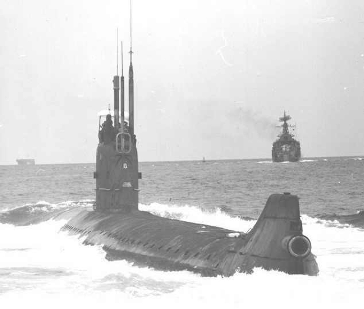

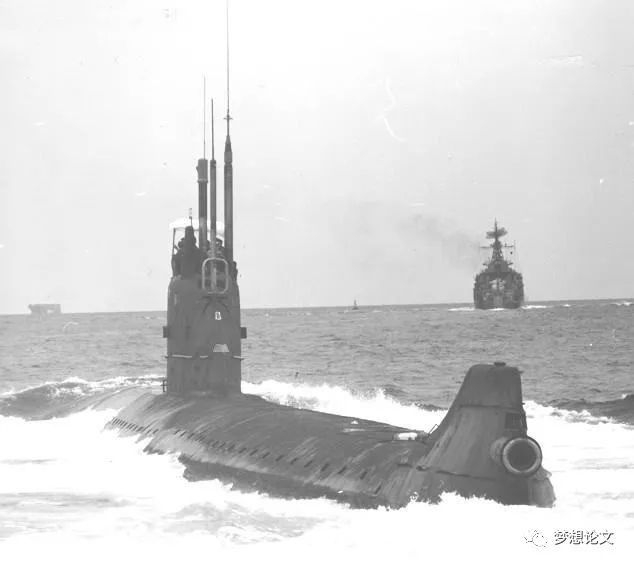

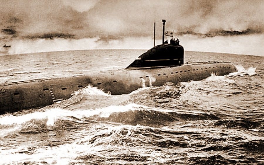

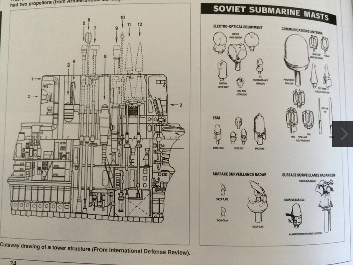

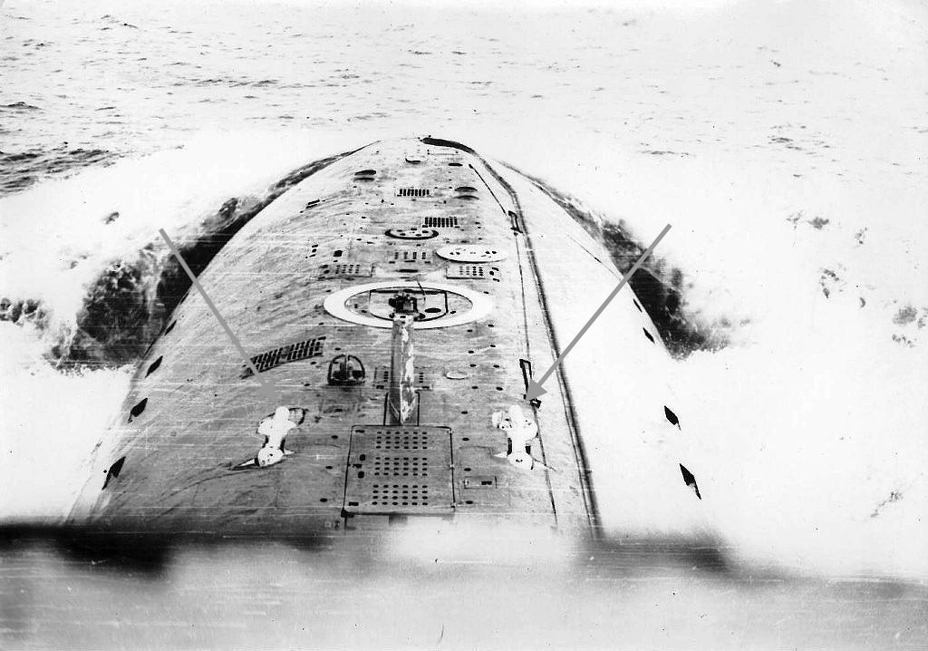

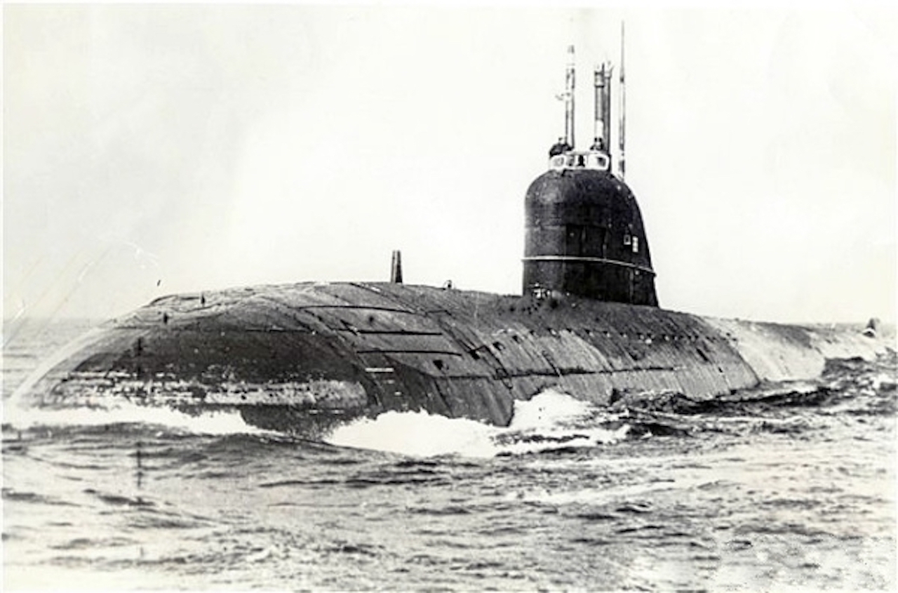

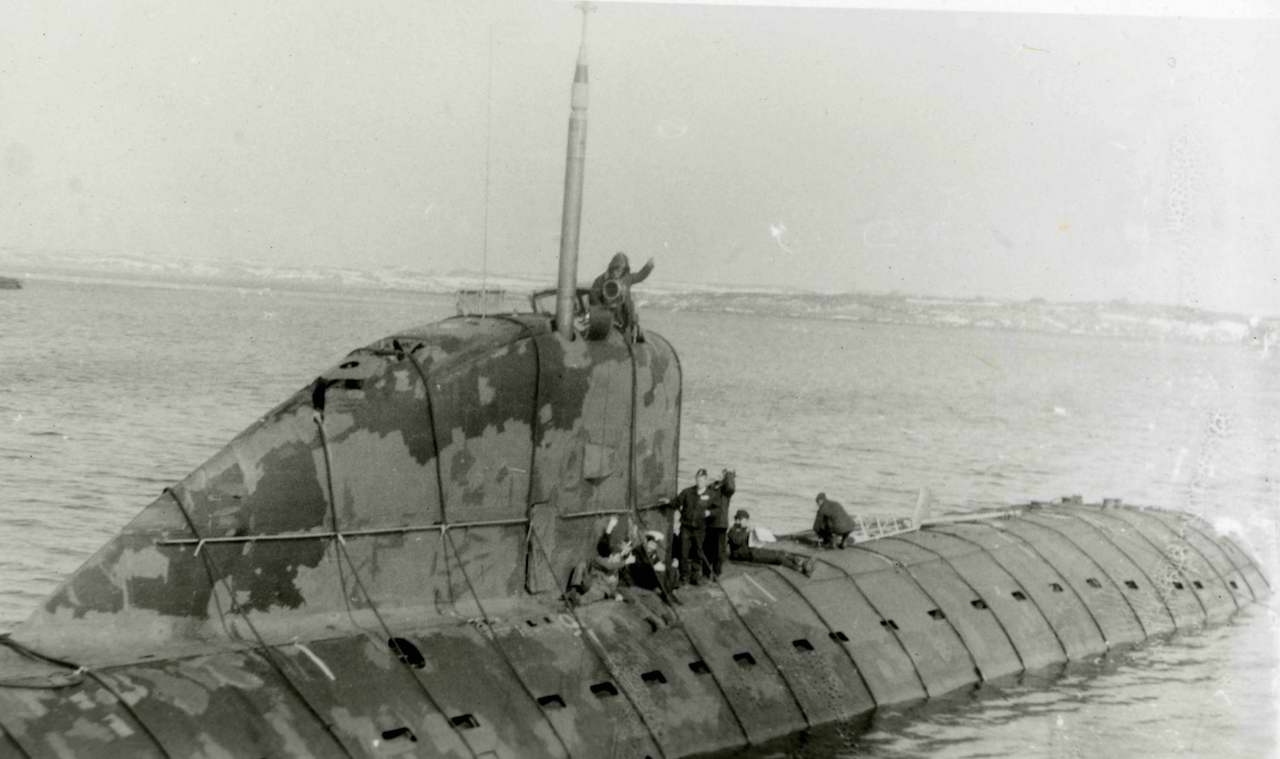

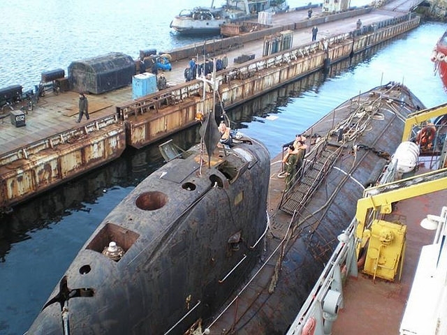

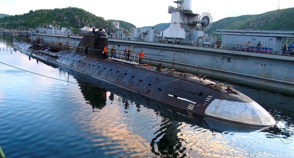

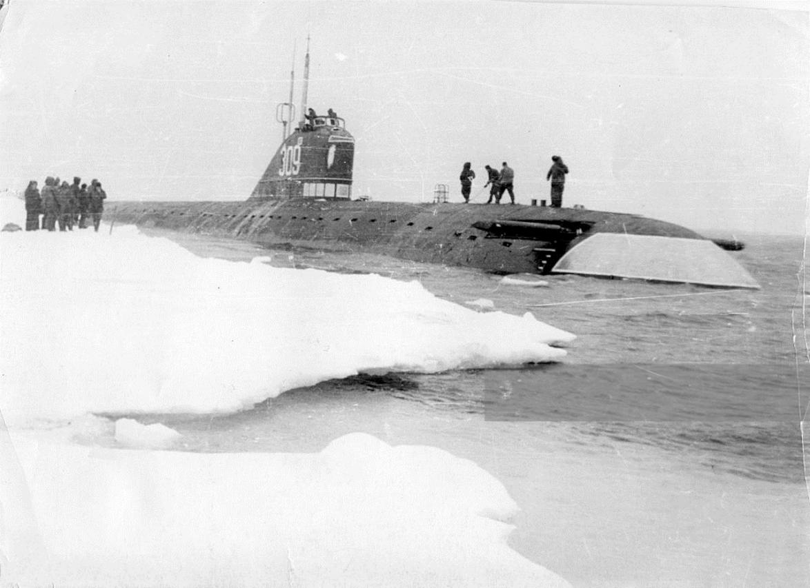

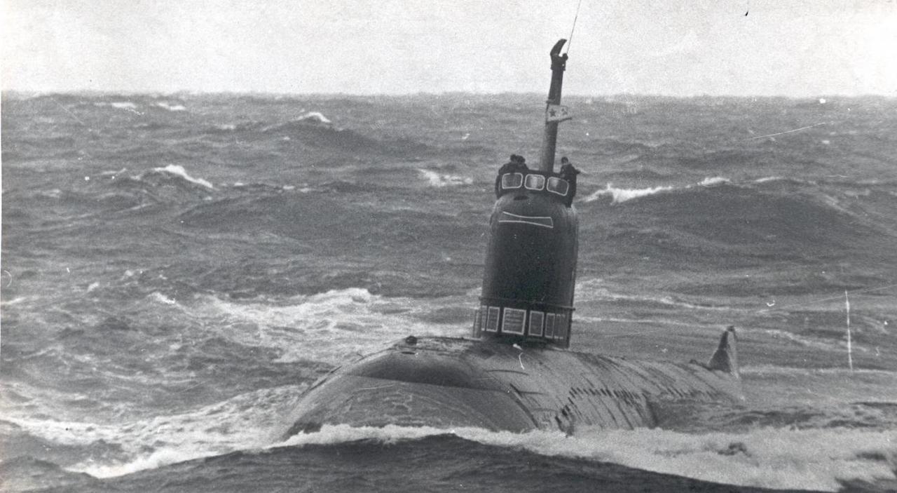

                Also, David you may have already seen all of these, but here are a few photos I found online. Click image for larger version  Name:	35212647145_1c1003f4bd_z.jpg Views:	1 Size:	241.6 KB ID:	131035
                Click image for larger version  Name:	DrGCAksWoAEuqW5.jpg Views:	1 Size:	605.7 KB ID:	131042
                Click image for larger version  Name:	November Illustration.jpg Views:	1 Size:	79.1 KB ID:	131043
                Click image for larger version  Name:	5dc3792f313441b6b1948f8bcbb959d7.jpeg Views:	1 Size:	73.4 KB ID:	131036
                Click image for larger version  Name:	1e06d9017fad4dab3f7f1d99049ae0c8.jpg Views:	1 Size:	322.0 KB ID:	131037
                Click image for larger version  Name:	3_129565.jpg Views:	1 Size:	321.8 KB ID:	131044
                Click image for larger version  Name:	November ill 2.jpg Views:	1 Size:	18.0 KB ID:	131045
                Click image for larger version  Name:	masts.jpg Views:	1 Size:	237.0 KB ID:	131046

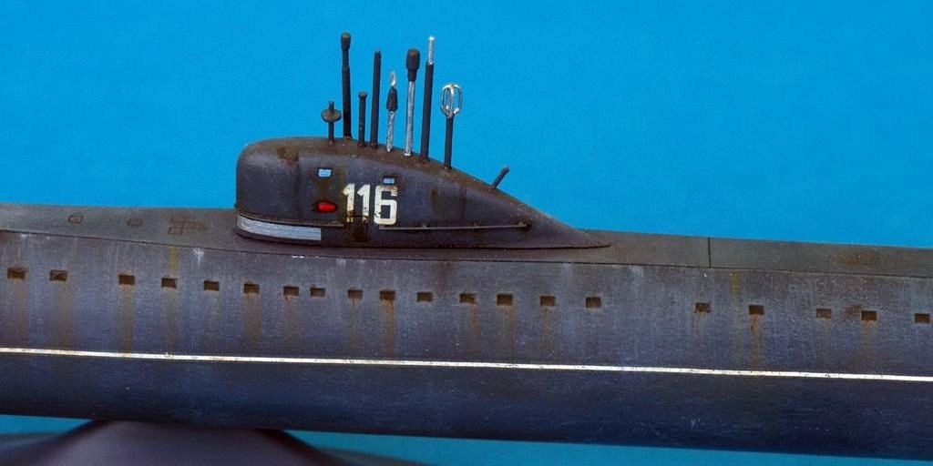

                I know these are models, so that doesn't mean squat in terms of accuracy, but still... Click image for larger version  Name:	7450_11-auto_downl.jpg Views:	3 Size:	53.4 KB ID:	131040
                Click image for larger version  Name:	p9112326.jpg Views:	1 Size:	158.4 KB ID:	131041

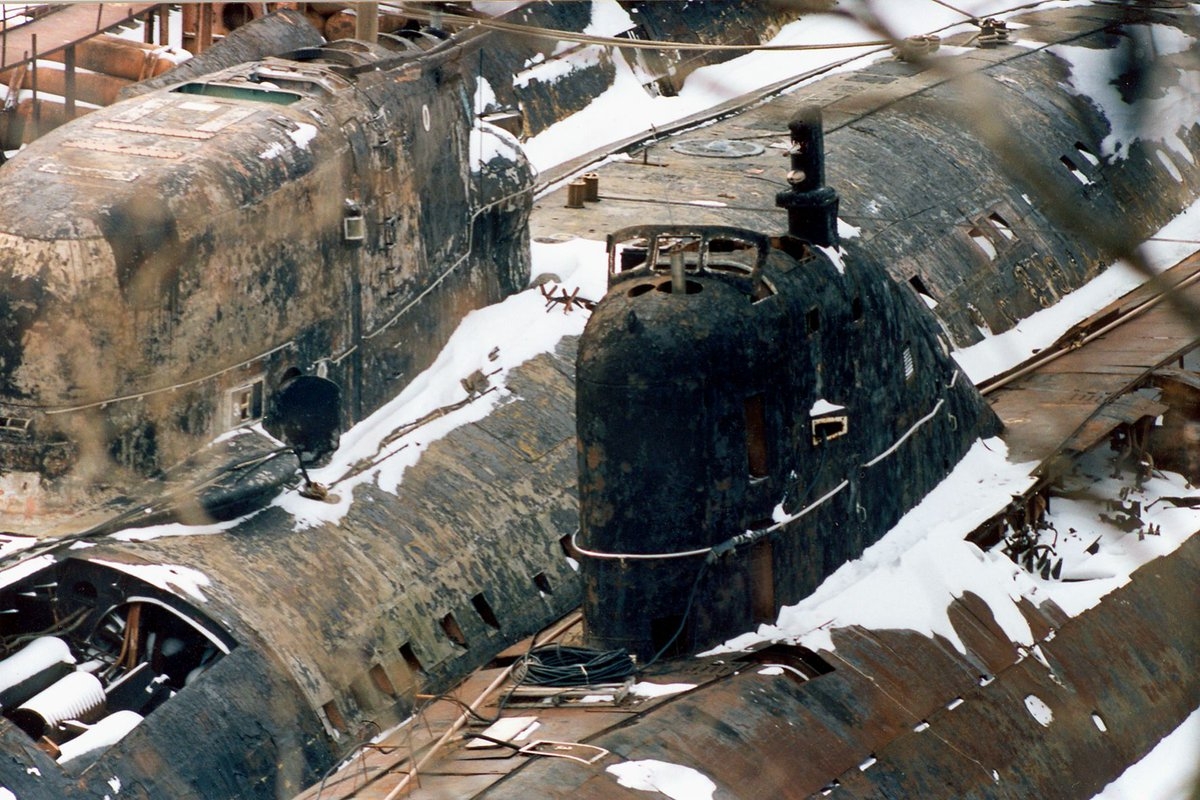

                Do you have any editions of Guide to the Soviet Navy by Norman Polmar? Published throughout the 80's in at least 5 editions. Let me know if you don't and I'll get you hooked up.

                    Some mast photographs;

                        [QUOTE=HardRock;n131048]Some mast photographs;
                        Good stuff, I just filed them away. Thanks, Scott. Snoop-tray radar, and quad-DF I got (from the recent 1/96 KILO work), All others I need to make.
                        Get me a sail asap so I can work up the mast foundation, bridge, and SAS snorkel.
