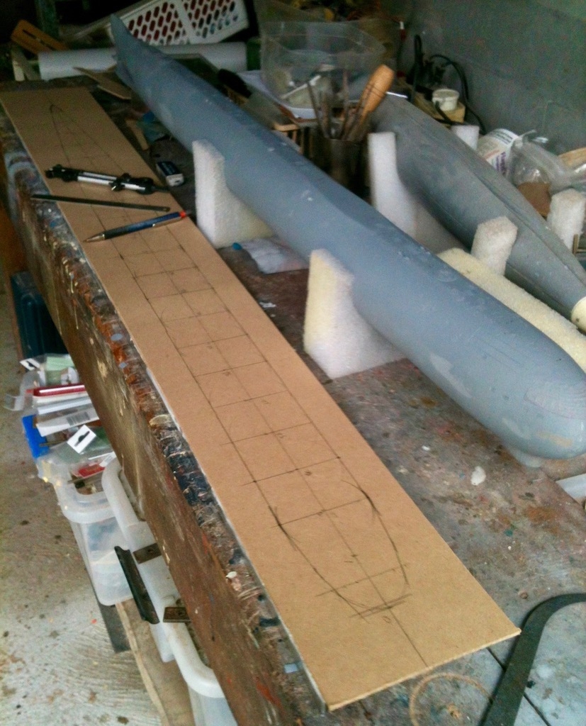

          #274
          Getting on with the parting board. This is going to fit along the waterline to split the boat into upper and lower sections.

              #276
              Brilliant work Scott. Just curious, since you are doing a waterline split, will that reflect the November’s somewhat angled, tail-low stance?
              Dead men tell no tales...
                #277
                Thanks Men. The answer is yes, Brady; the waterline runs at a slight upward angle toward the stern (relative to the centre line). I had to chock up the rear end when I scribed that line.

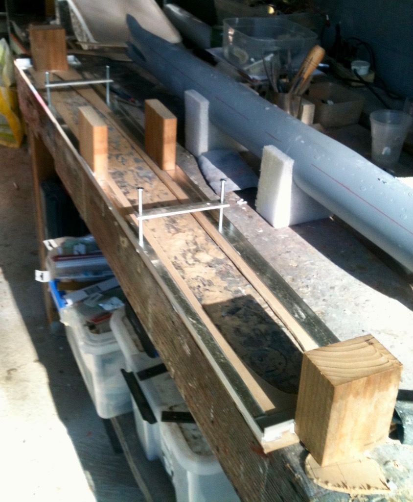

                  #278
                  The parting board. I usually use a laminated shelf for this; cheap, straight and relatively stable. This time I'm trying a much thinner board with aluminium channel sections glued to the underside to provide strength and stability. Seems OK so far.

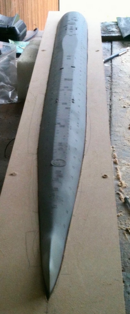

                      #280
                      The underside of the splitter board.

                        #281
                        Good, solid engineering here, Scott. Keep chugging!
