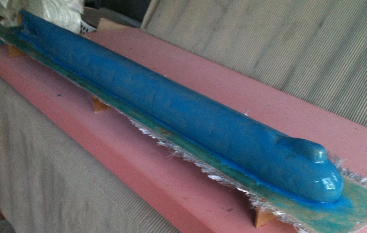

                Its a crappy photo. I had to shut the shed doors to keep out the sunlight. The moulding clay interface between the plug and the splitter board kept melting. Have to wait a few hours while this skin coat goes off before adding thickened gloop to make up the full thickness mould.

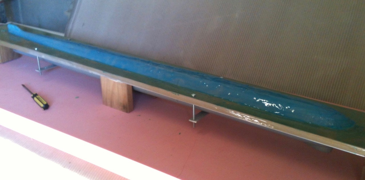

                  That was the top; this is the bottom.

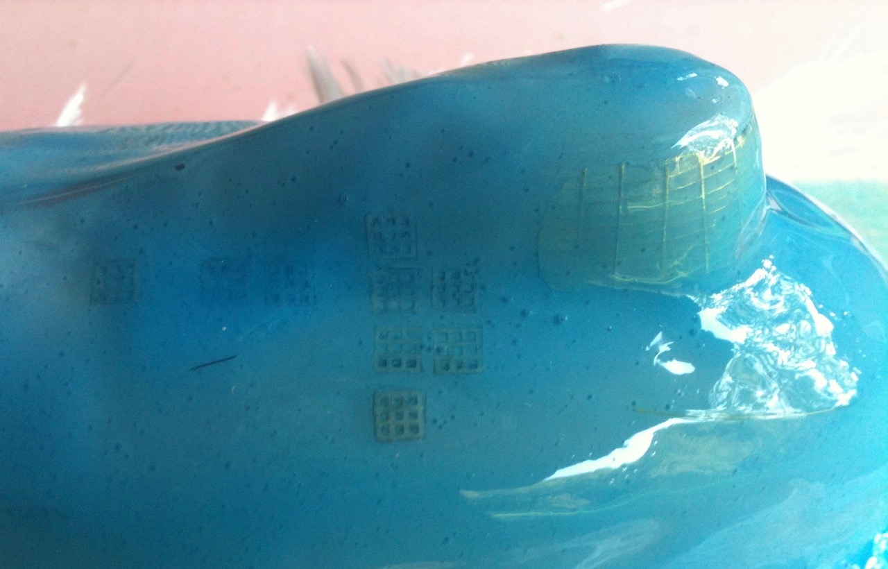

                  I'm having a small problem with trapped air bubbles. They are small but persistent. I'm using a brush to paint over the rubber to release the bubbles but if you miss a few and the rubber goes off, you're done.

                    Do you vacuum the mix before application? If not, the alternative is to slip the work into a pressure pot and take it down an atmosphere and keep it there till the rubber changes state.
                      #310
                      Nope. I'd need a 1.2 metre long pot to do that. I've found that the best practical method is to brush on the first two coats of goop to pull the bubbles out. I missed the bit near the bottom sonar dome and it set up before I could get back to it. Hopefully the bubbles are in the matrix and not on the surface of the plug. More glooping tomorrow.

                        Yeah, I think you'll get away with it. You do hand lay-up without a pressure assist, so internal bubbles will not be an issue. Looking good! And shoot for a very thick glove with this tool, up to 3/8" to 1/2" thick!

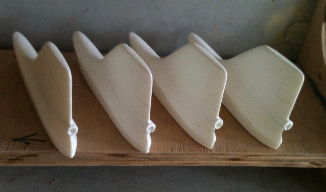

                          Waiting for more rubber to arrive (Friday) so I've been casting the rear planes.
