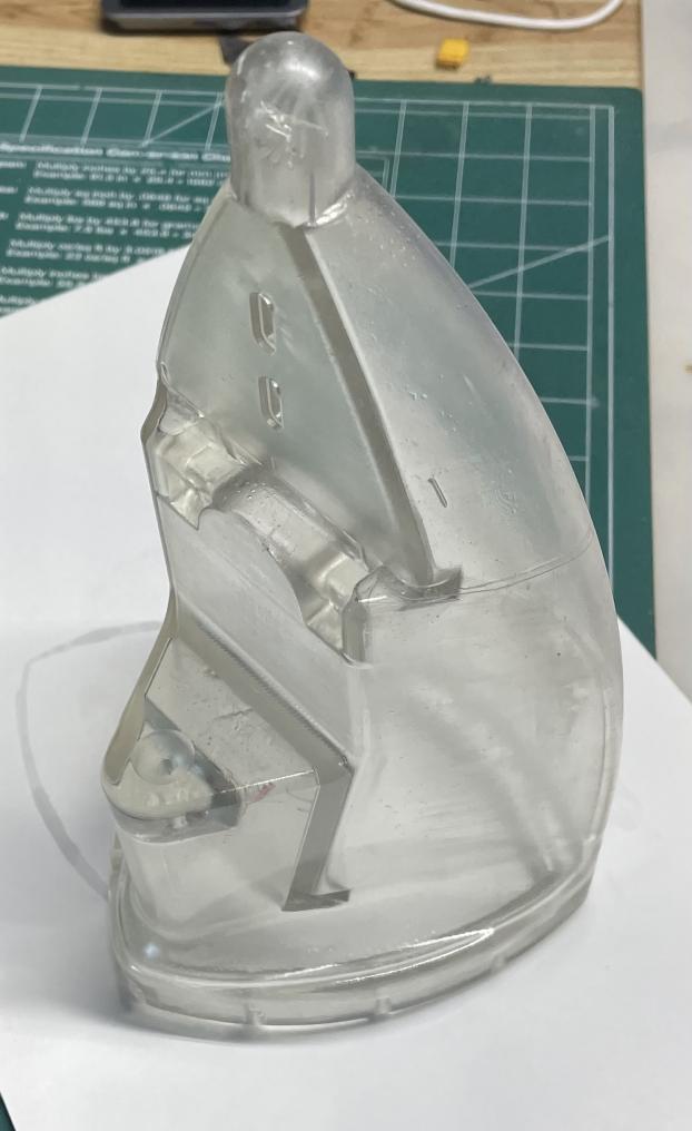

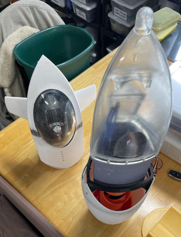

                            Along with CAD comes methods, 3D printing, scanning, allowing us to fabricate some pretty wild things not easily produced via hand crafting. You use WTC Water Tight Cylinders where I'm creating a Water Tight Container printing in clear resin, (can see power indicator thru it). Nothing but respect for all the hand crafters out there, so many tips and tricks to learn from them.

                                Thank you. I use a Any Cubic 3D Max already (seen in these forums in my Suffren thread). I had a hard time learning curve in beginning, but now I use without difficulty.
                                Glad the STL files provided also will print resin too. Yes indeed. the "3D resin printers have far more thinner layers (higher resolution) for very smooth exterior surfaces, which is a game-changer in sanding reduction". Very happy with its performance now. Very high resolution and can accommodate printing large parts.
                                It has to be operated in a room with 70 degrees F minimum temp. So, if in a garage, it's too cold to operate in winter even here in California. The other issue is any dive module or WTC made- the resin is still too porous. Fine for the free flooding parts. The parts would be turned on a lathe with McMaster Carr PVC bulkheads and Lexan tubing.
