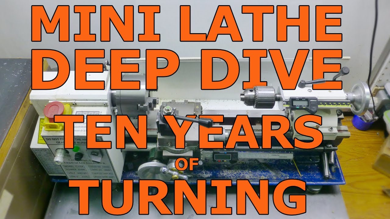

                  This video came across my Youtube feed. I thought it was interesting. It was well done and had some good ideas. Although if you are really into customization of your lathe, the lathe can be a full project just like building a model.
