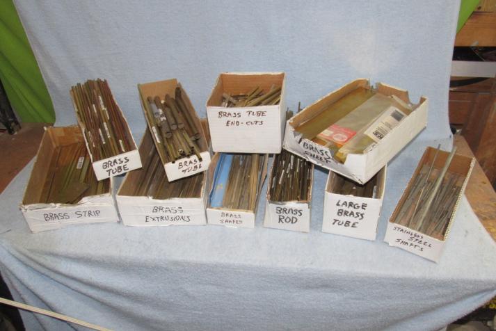

        Twenty-years ago I shifted from K&S as source for my metal needs, to McMaster-Carr. To answer your question, I have gobs of various K&S rod, tube, sheet, and strip stock.
        All the stuff below is K&S. All 260 cartridge brass. Yuck!

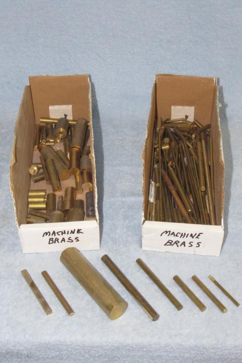

        However, now I have an adequate amount of the 'good stuff' -- that round stock, bottom-right, is 360 machinable brass -- most suitable for production work.

        360 machinable brass end-cuts are kept at the machines for use on items of relatively short length.

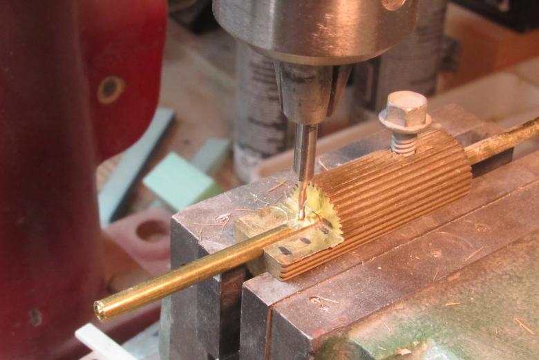

        Almost all specialty shapes produced for commercial sale were worked from 360 brass, as was the case on the square and gear sectioned length of brass, in foreground, extreme left. It goes without saying that it's good shop practice to keep specific alloys of your metal segregated and identified. Nothing ****es me off more than to do all my lay-out and chuck up chores on the metal only to find I have the wrong alloy on the chopping-block. (I well understand why surgeons sometimes throw an instrument -- handed to them in error -- across the operating room!)

        Trouble with K&S is (discounting their copper, tin, and aluminum shapes) is that all thy market is 260 brass, AKA 'cartridge brass', which is hard and awful to machine.
        Before our involvement with Mr. Caswell, and later Bob Martin, we were only doing lathe and mill work on an occasional bases (prototype and detail one-off parts) and would put up with overheating and slow feed rates demanded by the hard 260 brass. However, as Ellie and I got into a serious production mode with our lines of WTC/SD's we had to shift to use of 360 brass, AKA 'machinable brass'.
        Machine brass is unique in that it is alloyed with a bit of lead, which alters the otherwise 'hard' nature of the brass -- from a brittle, tough to machine alloy of copper and zinc -- to an easy to machine form of brass.
        How to tell the difference between the 260 and 360 brass, is this: You do a 'scrape test'. Simply scrape the surface of the brass in question. if you liberate little shards of metal, you have machine brass. If you cannot liberate any scrapings -- or those that are raised are long and brittle -- you're dealing with some form of brass that has little or no lead in it, making that alloy unsuitable for production machining.

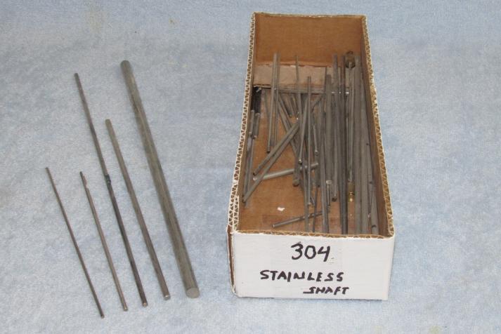

        Typically, I only use sheet aluminum worked into product that is either pop-riveted or fastened together with machine screws. However, I use a lot of 304 stainless steel round stock for propeller shafts, pushrods, and the like. 304 is a bit low on the Chromium content, has little if any Carbon, so is about as 'workable' as stainless steel can get, which makes it the preferred alloy on this Ranch. You're looking at a box of end-cuts. The stuff I get from McMaster-Carr comes in six-foot lengths and stays, until needed, on the wall.

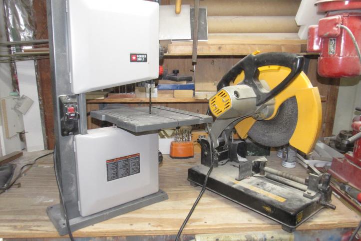

        Stainless can be cut with a small or big carbide or diamond cut-off wheel, or hacksaw. Below are some of the tools used to cut brass, aluminum, and brass.

        Only the diamond wheel on the table-saw, carbide wheel on the moto-tool, and hacksaws are suitable for slicing 304 Stainless Steel (SS)

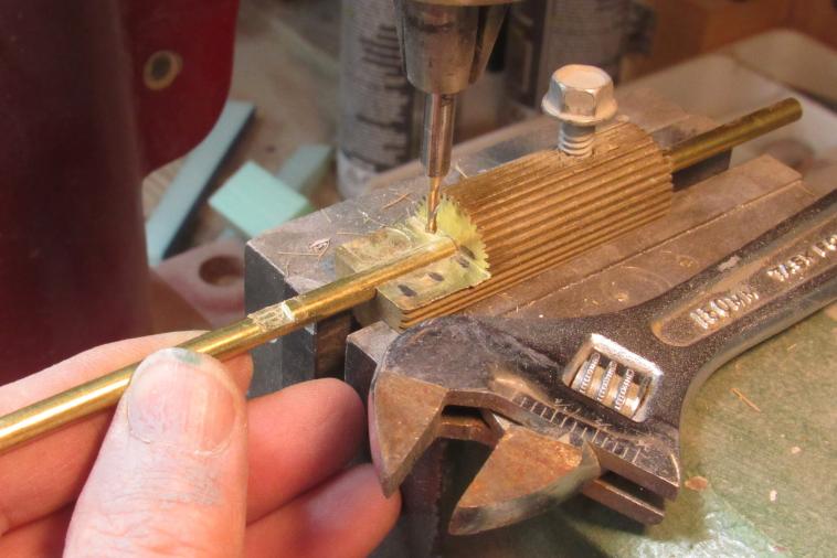

        You can machine 304 SS with high-speed tools, be they drill bit, lathe tool, or mill. Tooling steel is rich in carbon which makes it very, very tough, but brittle. Properly aligned and fed high-speed tools go through machine brass like a hot knife through butter, but you have to keep you RPM's and feed rate low when plunging your tool into 304 SS. and it's a good ideal to squirt some 3:1 oil on the work when working the 304 SS.

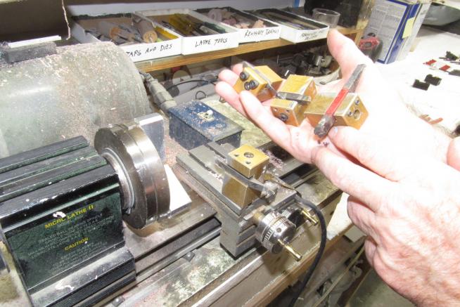

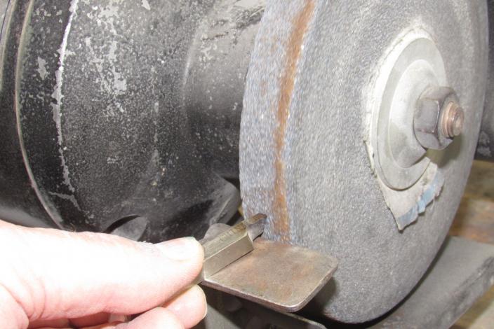

        To re-dress the tips and flutes of mills and drill/boring bits you're best served to take them into town and have a pro do that work. But, for lathe tools: start with a blank (and for this discussion I'm talking high-speed steel) and grind its cutting head to the proper shape with a monster grinding wheel. truing up the edge on a smaller, finer stone wheel. Final honing is done with a stone. An acquired skill! Work at it.
        Going mid-evil with the roughing wheel to achieve the initial, rough shape of the tool.

        A kinder, gentler wheel is used to make the lathe tool all pretty and suitable for polite society.
        No matter how exacting your work on the finishing wheel there will always be a microscopic 'burr' at the cutting edge of the tool. This is knocked off with a single pass over a finishing stone.

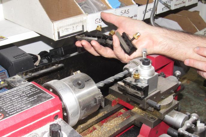

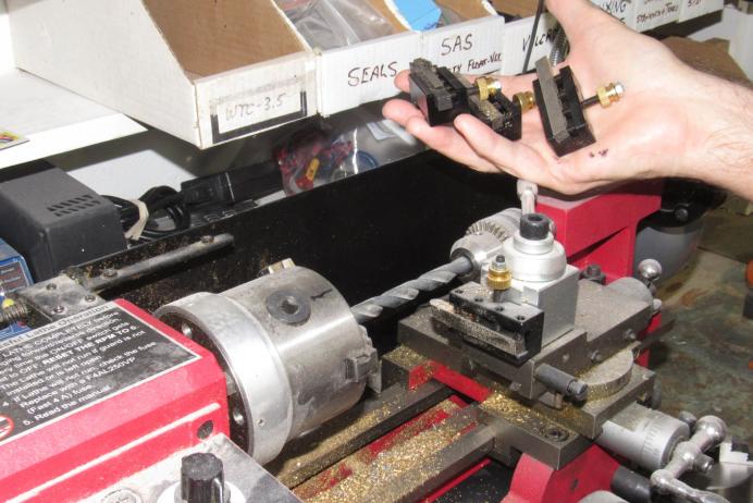

        Ready for war! Tools in their tool-holders. One set for the little Taig lathe, the other for my big, nasty, Chinese mini lathe (mini being a relative term!).
