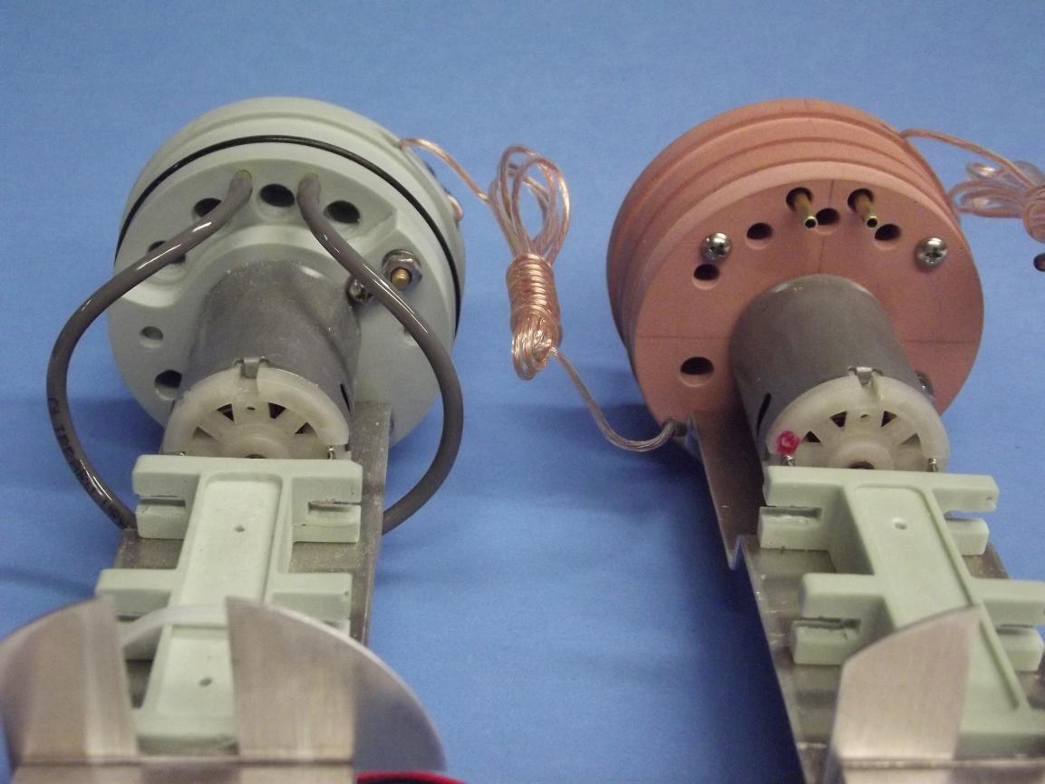

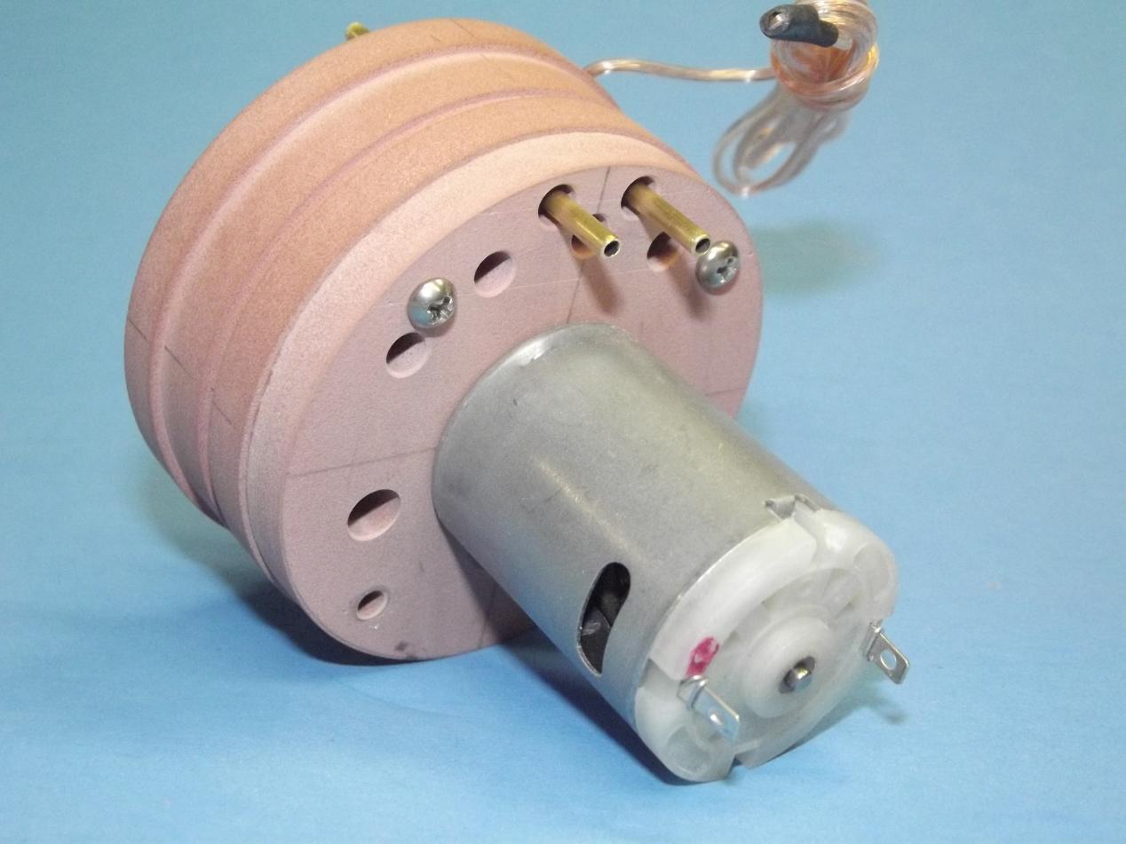

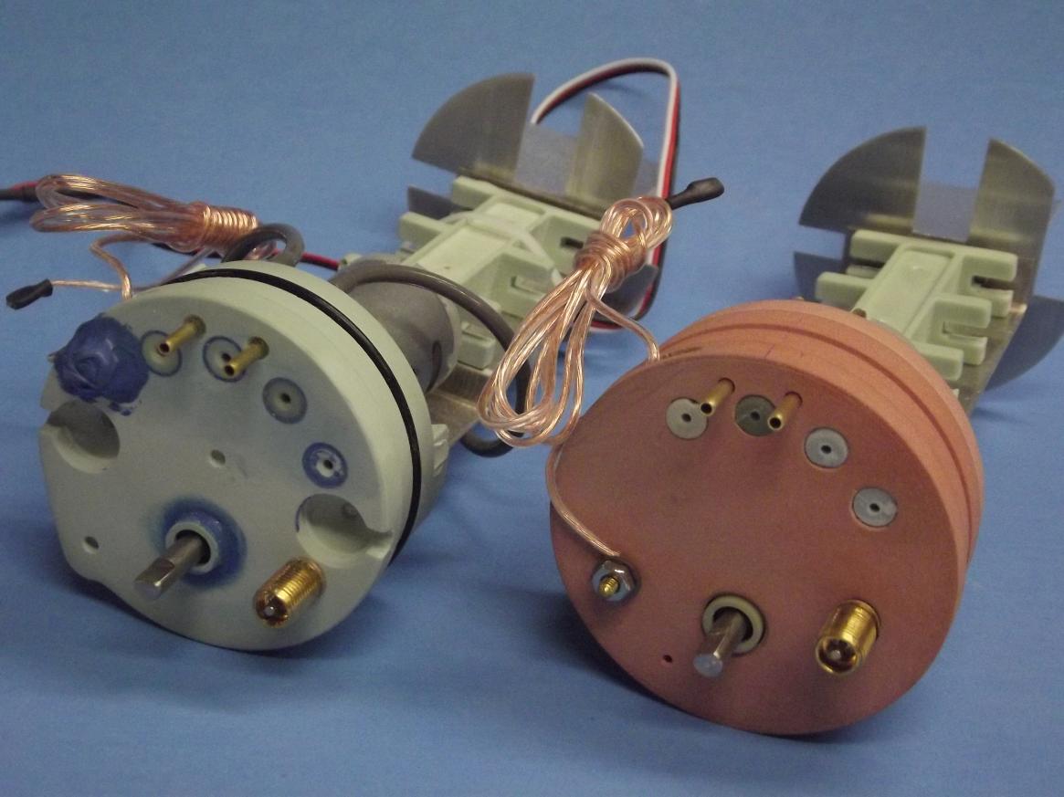

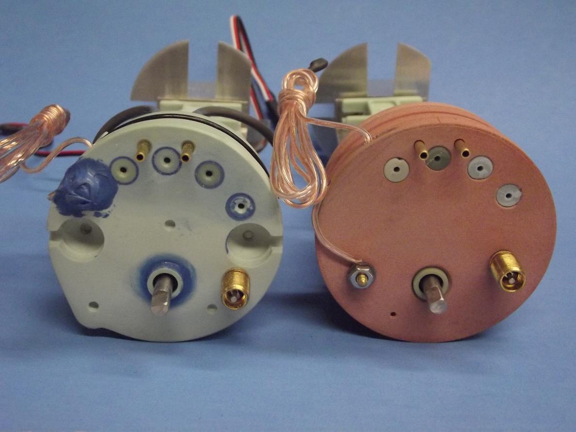

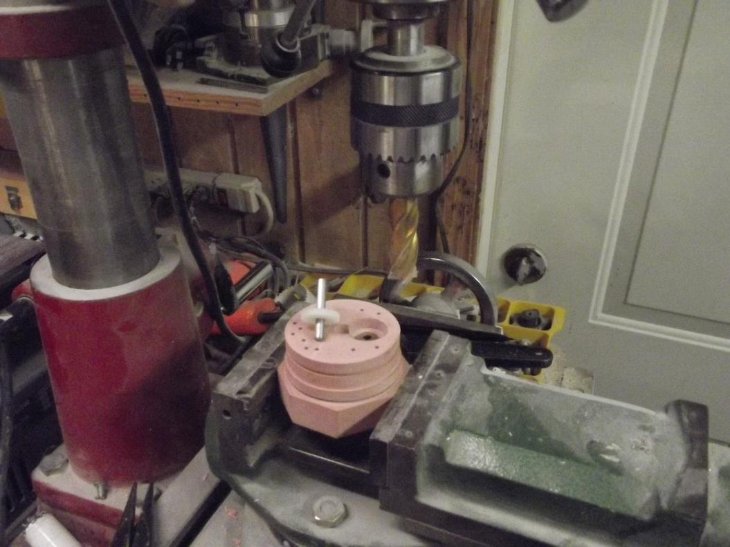

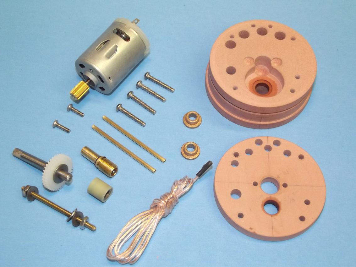

ID:	91736 While the Dragon Lady is on the mend I'm working to make a new, improved 2.5", single-motor motor bulkhead -- resulting in parts that will be less labor intensive to manufacture, set-up, and test.

ID:	91739 Here I'm showing the mocked-up 'new' motor-bulkhead master next to the current production 2.5" single-motor motor bulkhead. Not much obvious difference between the two, but the changes are significant.

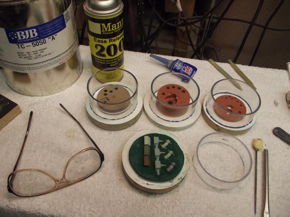

ID:	91740 The RTV tools are curing now. Film at Eleven!

                          The holes around the brass tubing for the air induction and venting is it large enough to push the hose into and small enough to act as a compression fitting?
                          Looks like you did simplify, always thinking aren't you?
                              No need for hose retainers in this application, Tom -- the differentual pressure of the SAS is not that high. No hose is going to flip off its nipple do to over-pressure.
