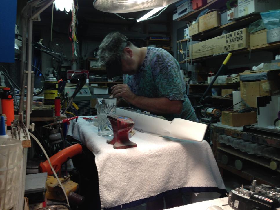

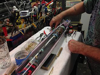

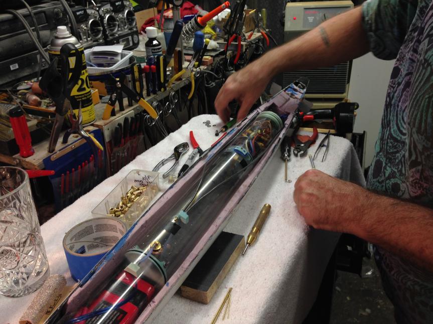

    Here he is working on sorting out all my screw-ups on my M1. It took the best part of the day, but we had a good chat.

      Or wearing Crocks and smoking weed, that M1 looks more like a foamy to me, newer knew you can stuff that much foam inside.
        Ah! Well! Um! That foam is a result of me making a keel from lead shot and epoxy. Not having the faintest idea how much ballast would be needed, I made the entire keel of this stuff - in a special mold.
        Unfortunately, I made it too heavy, hence the foam. BUT HWSNBN put a slightly longer Sub-driver in, from a GATO, whereas my was 3" shorter. He thinks that should help the buoyancy.
        My next job is to put it in the pool and trim it, and I am hoping I shall be taking out quite a bit of that foam.
          • 1647
          Hmm, leadshot and epoxy, that's one way to create a monster if you got too much weight, i always prefer flat lead untill i know the exact weight needed, if needed i'll melt some solid blocks for permanent use.
          I'll hope the trick with a longer SD will work, that M1 is not often seen at the pond, me like strange models.
            Well! I certainly did create a problem. I've been drilling and grinding on that keel for ages. Won't do THAT again in a hurry. What's annoying is I have loads of lead sheet at work. We use it for chrome plating as anodes.

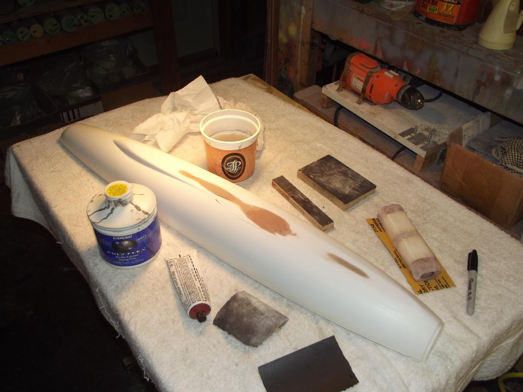

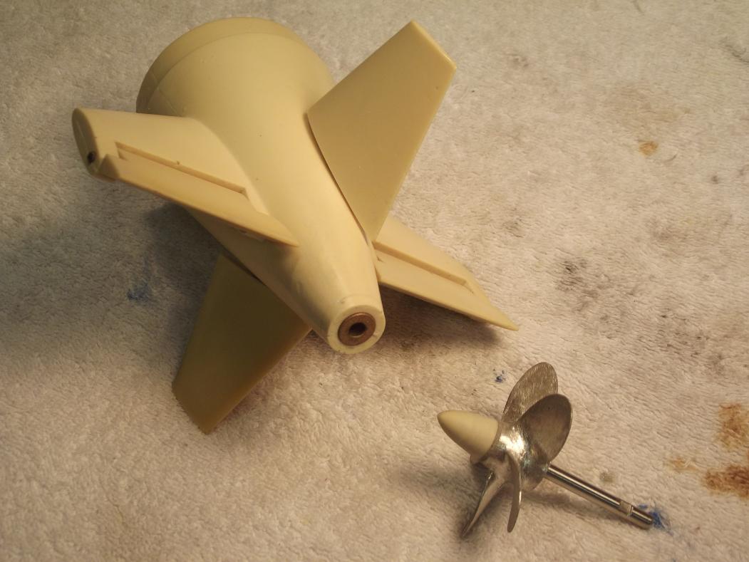

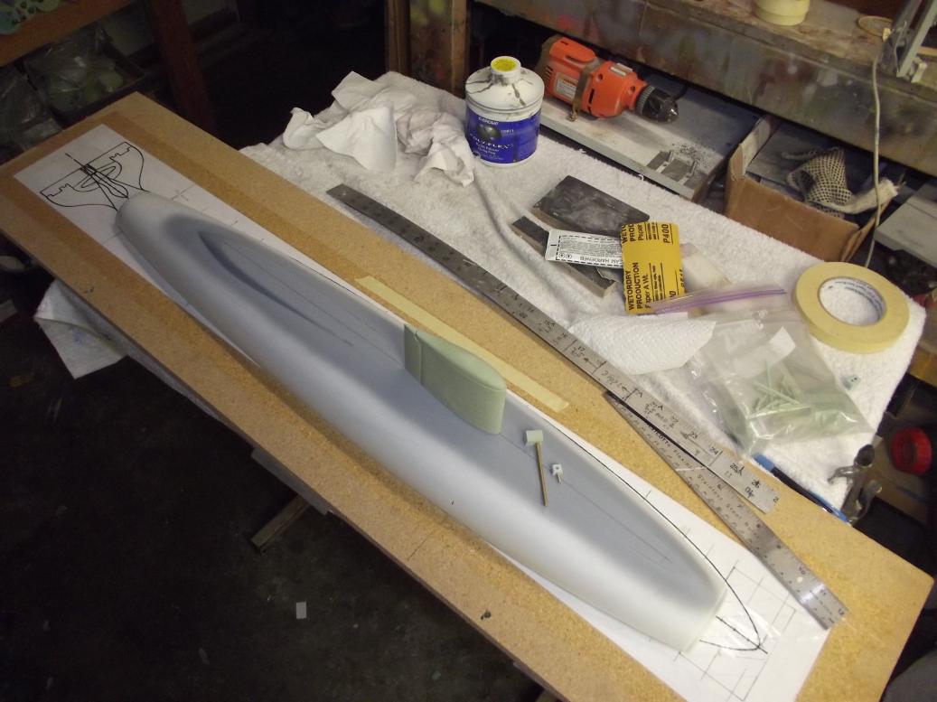

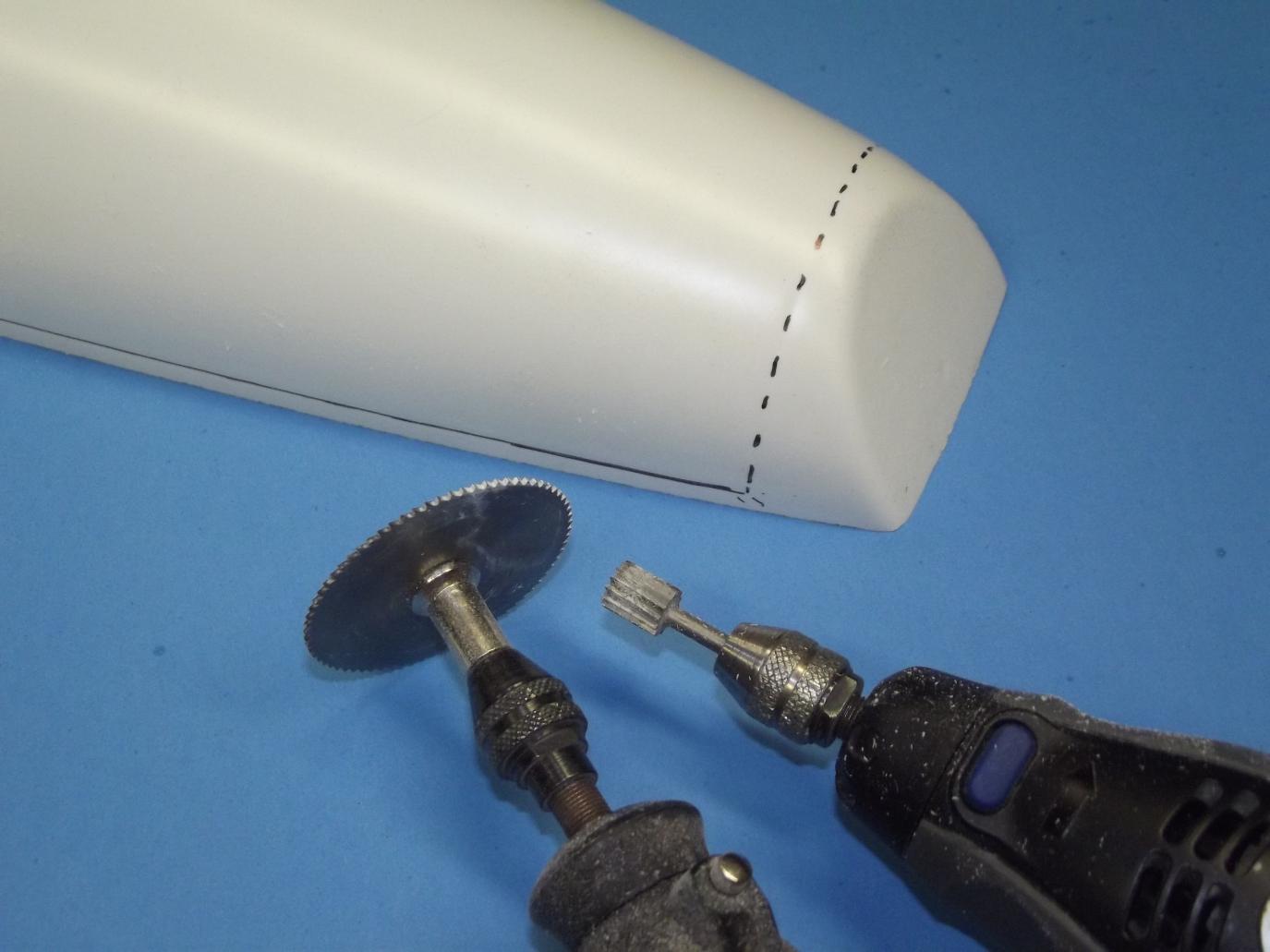

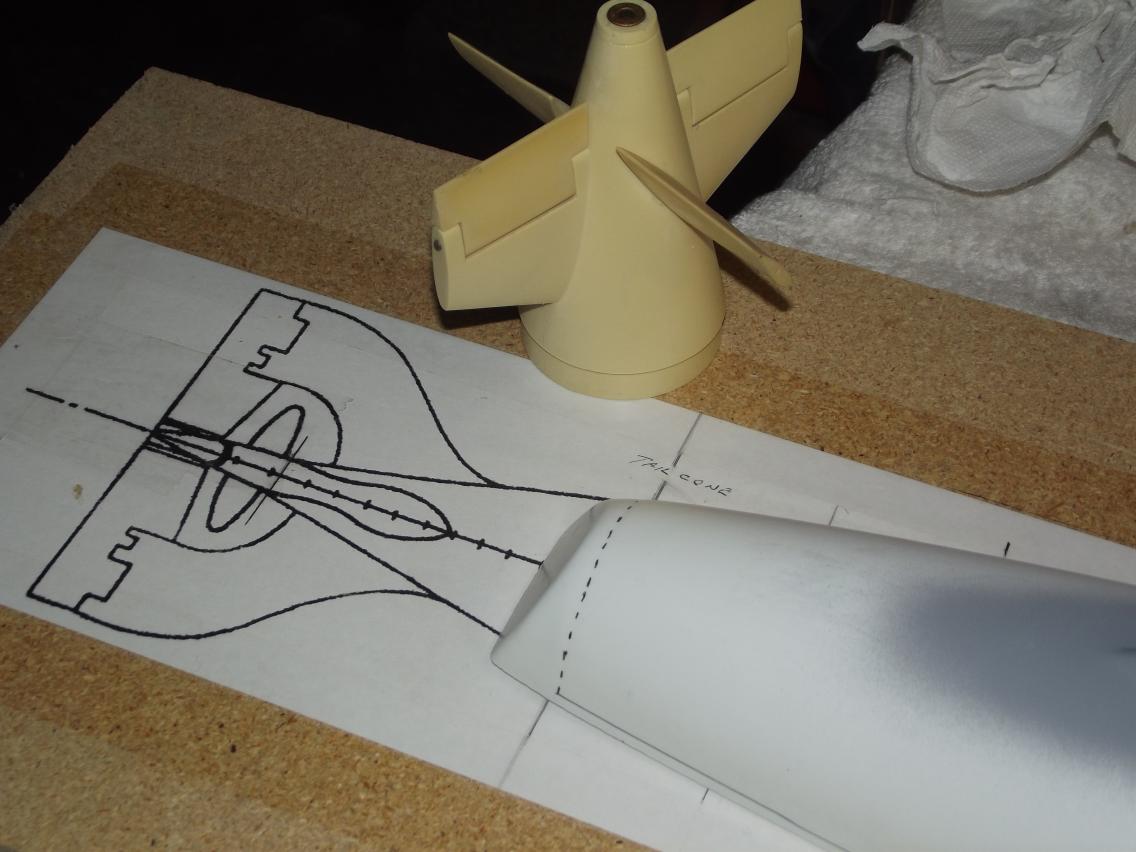

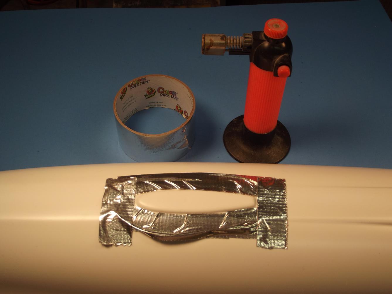

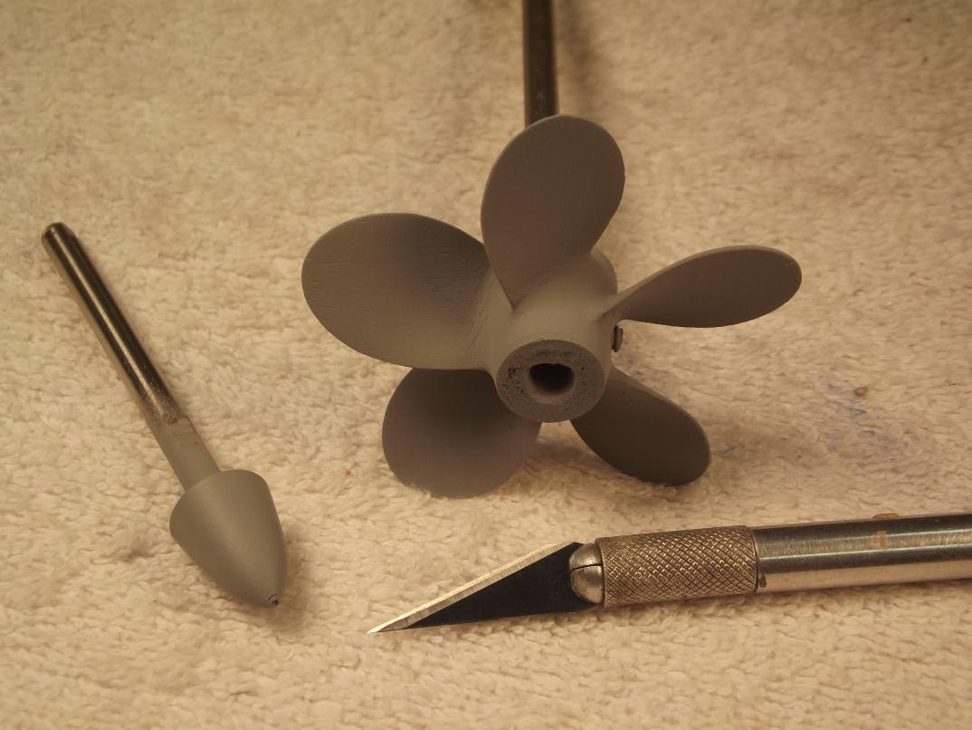

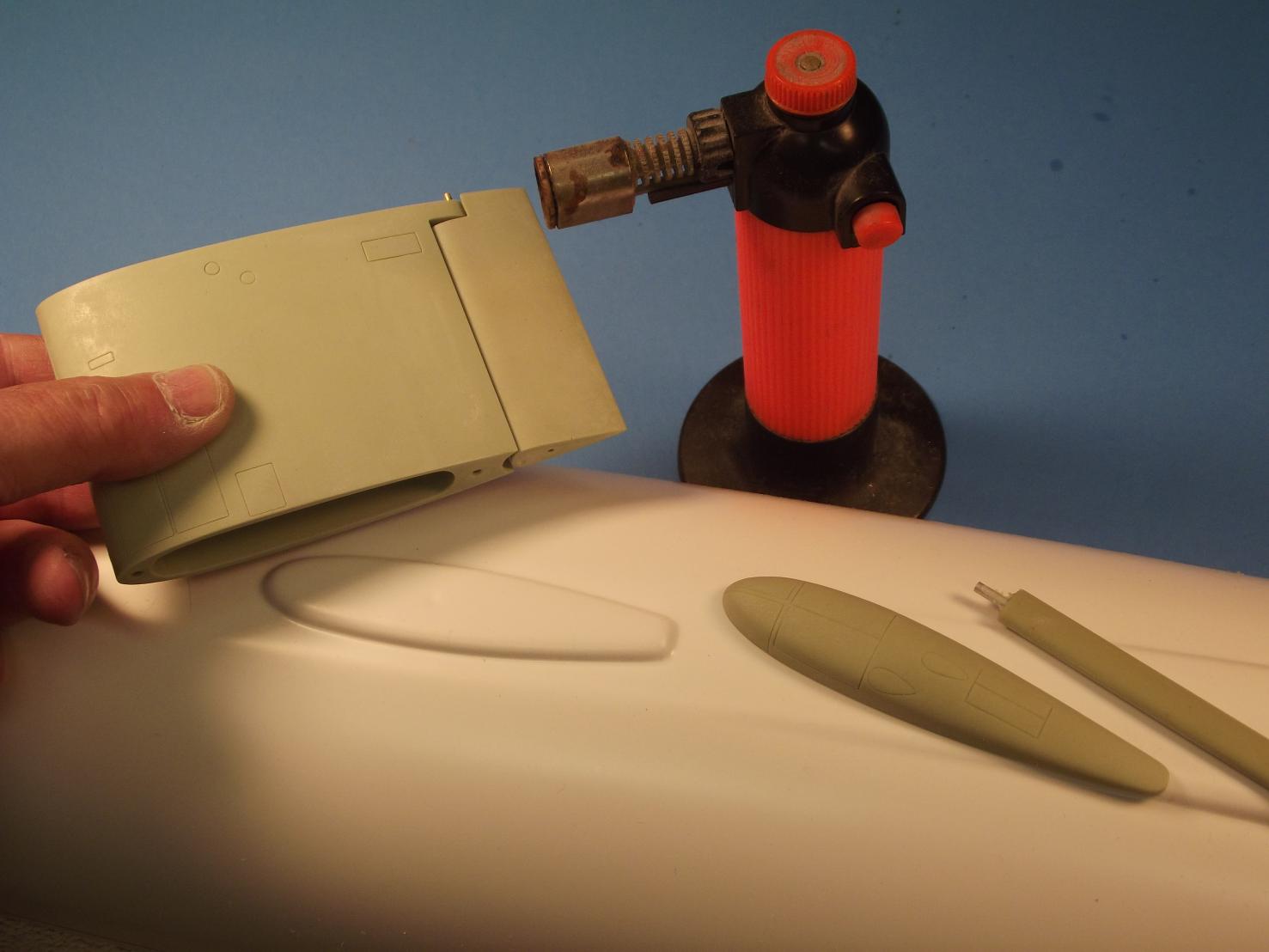

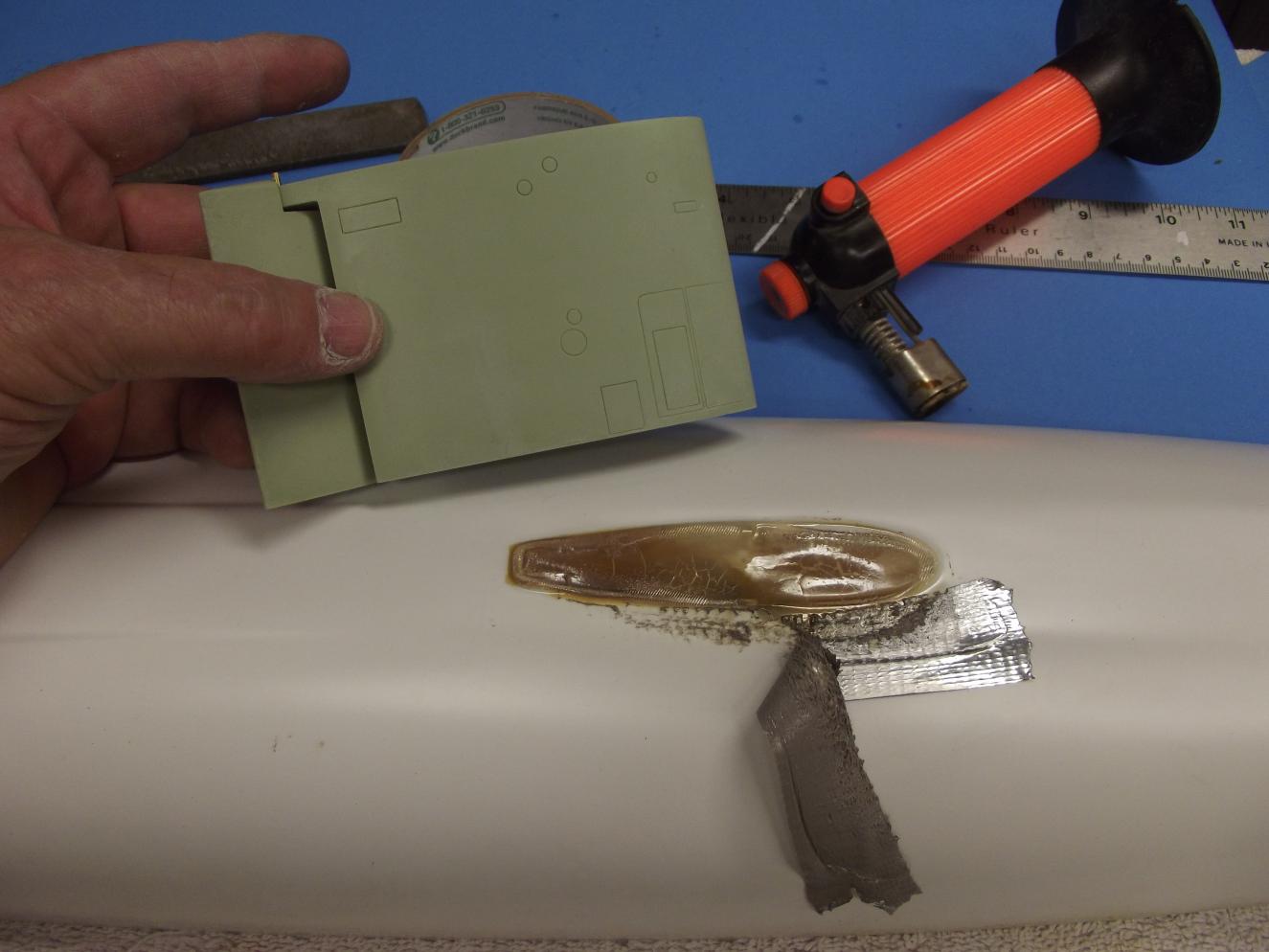

                            Albacore stuff! Thats a new hull.
                              • 13982
                              Yeah, that's one of the old Sub-Tech vacuformed hull. I'm assembling it to qualify the new fittings I'm working up for a new Caswell-Merriman kit. Note the phase-3 stern and dorsal rudder.
