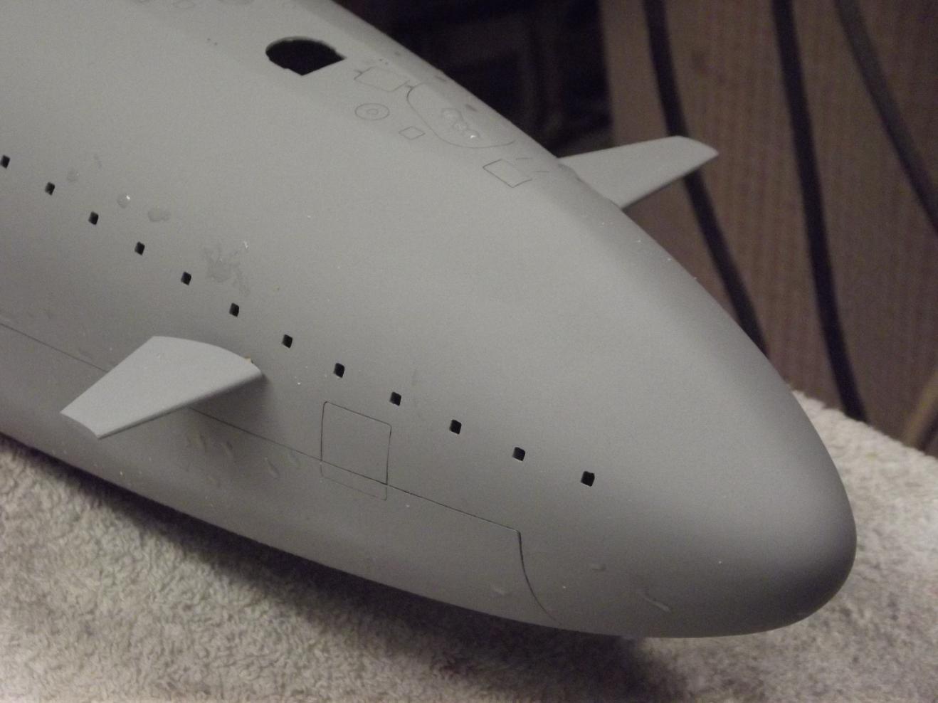

    David- wondering what this tool is?
    sigpic
      • 13982
      #47
      http://forum.sub-driver.com/attachme...4&d=1384036465

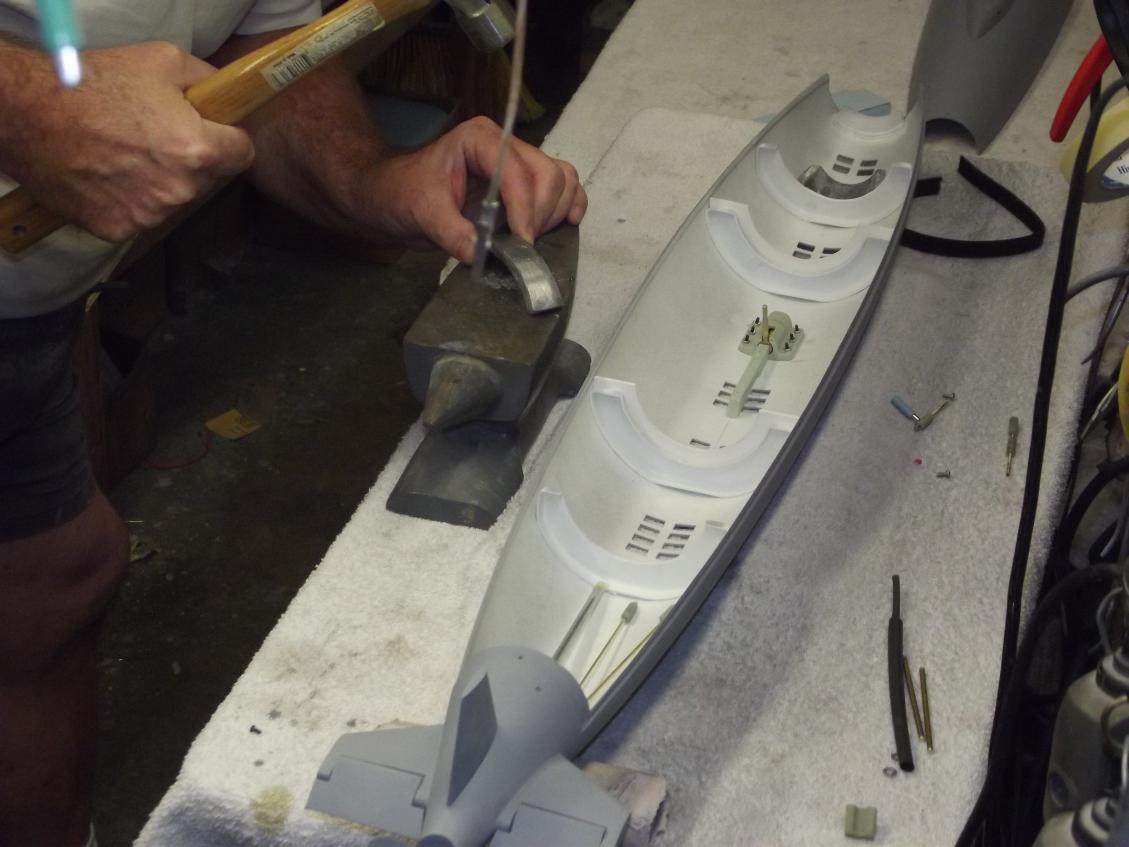

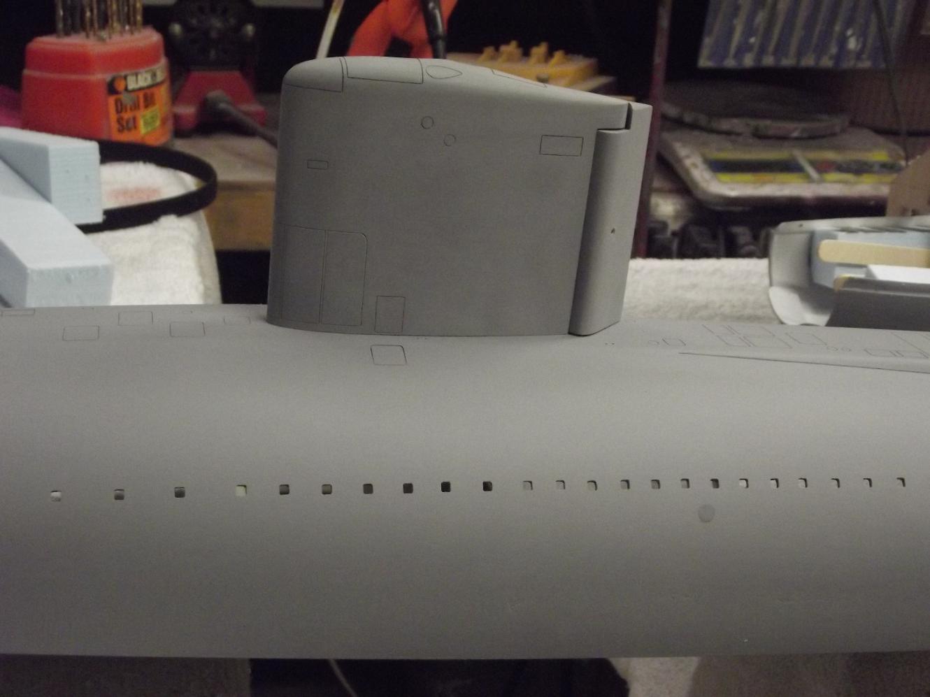

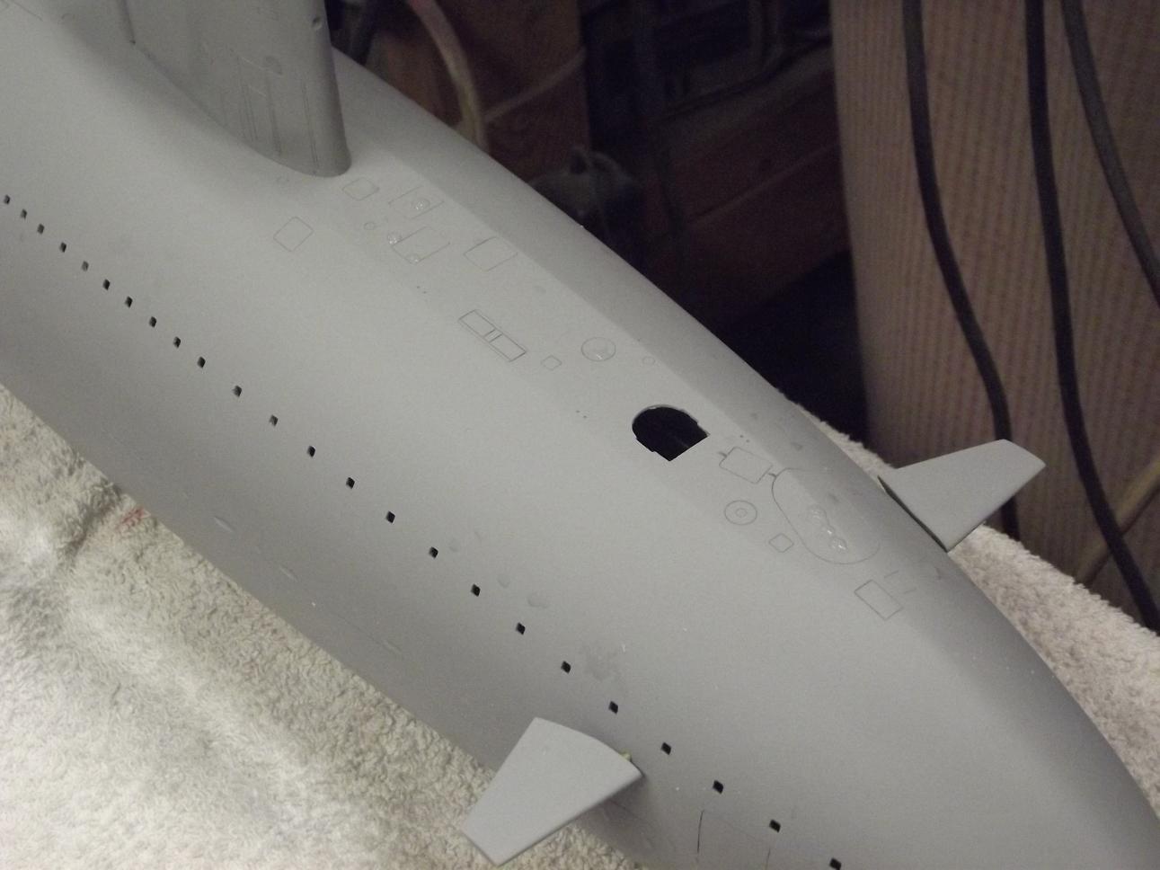

      I found that it was much easier to transition the round holes drilled into the hull to the required square holes shape by chucking up a square sectioned needle-file to a jigsaw and blasting away without regard to protocol or safety. Work went very fast. I started the square holing with the machine, and finished off the holes with a hand-file. Halve a day and all square limber holes were done!
      Me much smart, make model good.
        • 13982
        #48
        I found that it was much easier to transition the round holes drilled into the hull to the required square holes shape by chucking up a square sectioned needle-file to a jigsaw and blasting away without regard to protocol or safety. Work went very fast. I started the square holing with the machine, and finished off the holes with a hand-file. Half a day and all square limber holes were done!
          #49
          Thats Funny! I thought you guys were just being funny with the Jig Saw.
          • Scott T
            • May 2009
            • 414
            #50
            What if you mount the jig saw in a vice with the file/blade pointing up. Use a foot switch for
            power control. Hold the model piece over the file. Move the model piece around to file to outlines?
            Don't forget the eye protection.
            Scott
              • 13982
              #51
              Other than the lathe, band-saw, drill press, bench grinder, sanding and milling machines I prefer to maneuver the tool, not the work.
              Eye protection?!.....

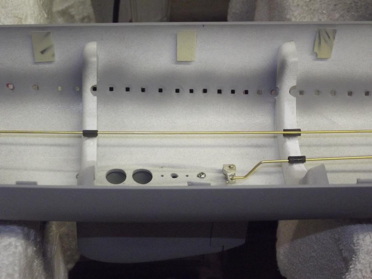

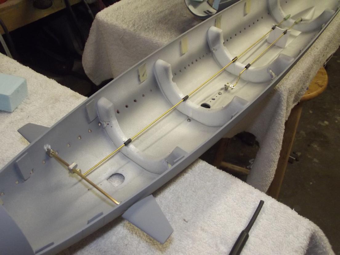

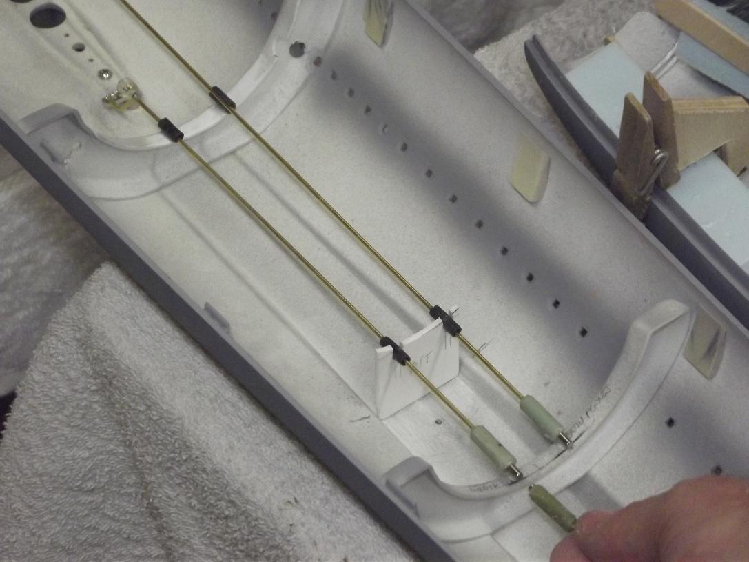

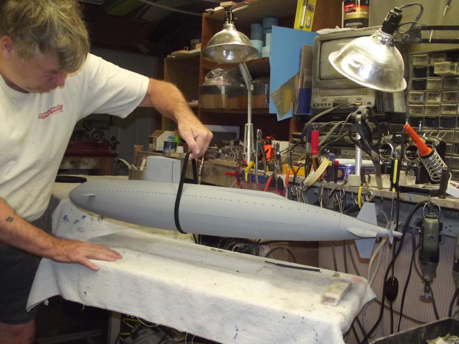

ID:	84488Click image for larger version
ID:	84489Click image for larger version
ID:	84490Click image for larger version
ID:	84491Click image for larger version
ID:	84492Click image for larger version
ID:	84493Click image for larger version
ID:	84494Click image for larger version
ID:	84495Click image for larger version
ID:	84496Click image for larger version
ID:	84497Click image for larger version
ID:	84498Click image for larger version
ID:	84499Click image for larger version
ID:	84500Click image for larger version
ID:	84501Click image for larger version
ID:	84502Click image for larger version
ID:	84503Click image for larger version
ID:	84504Click image for larger version
ID:	84505Click image for larger version
ID:	84506Click image for larger version
ID:	84507Click image for larger version
ID:	84508Click image for larger version
ID:	84509Click image for larger version
ID:	84510Click image for larger version
ID:	84511Click image for larger version
ID:	84512Click image for larger version
ID:	84513Click image for larger version
ID:	84514Click image for larger version
ID:	84515Click image for larger version
ID:	84516Click image for larger version

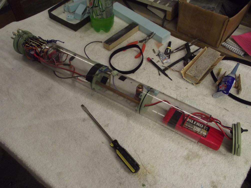

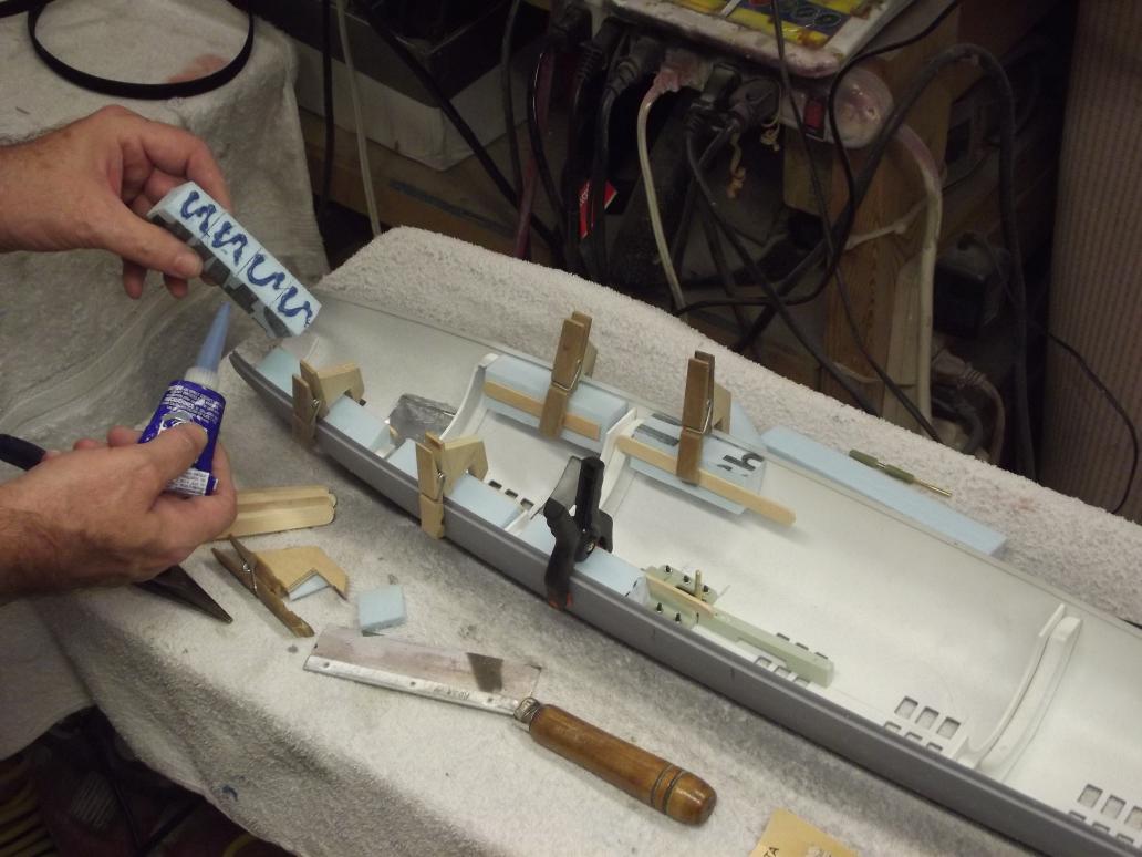

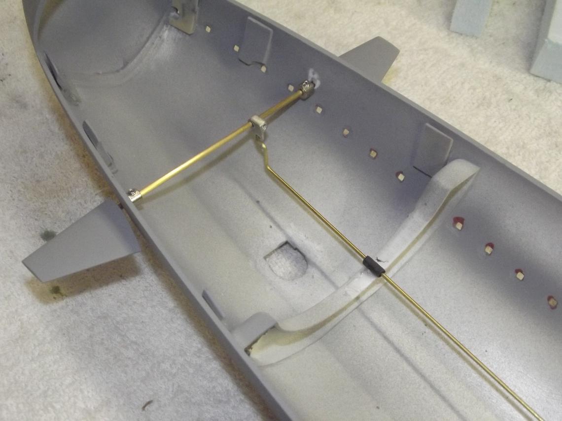

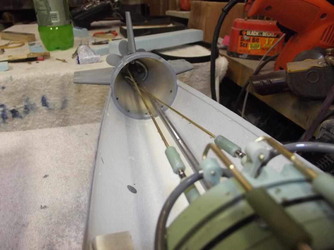

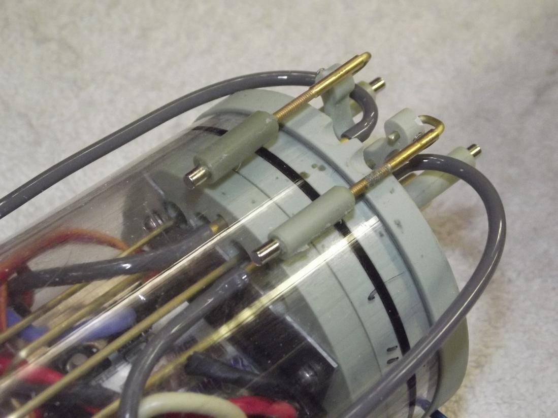

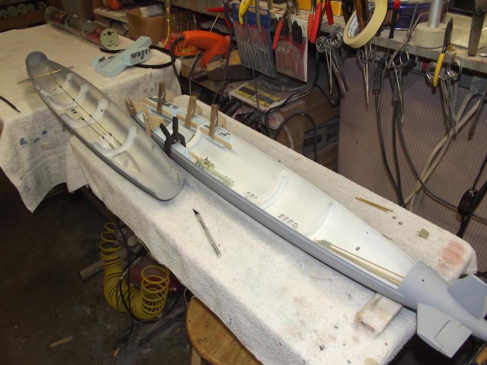

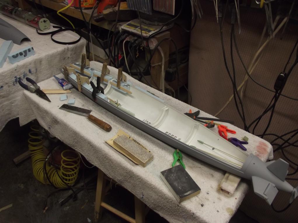

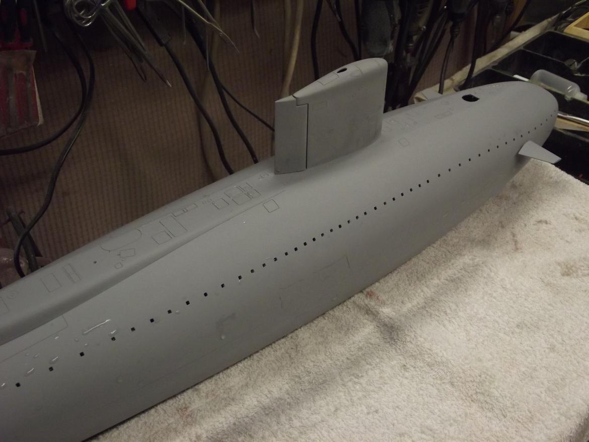

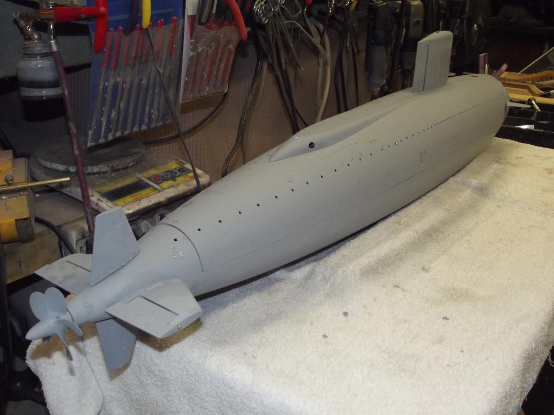

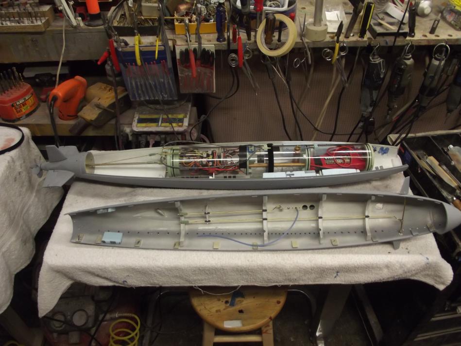

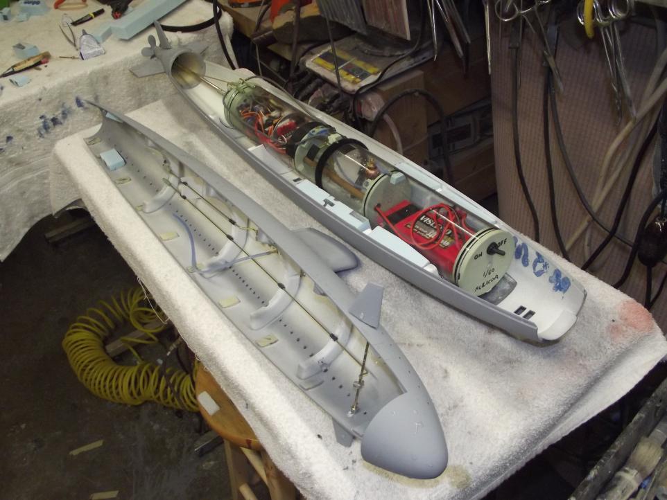

                  I think I need a cold shower. Another the chapter in the annals of Sub Assesmbly coming together.
                  And to think this is done boys and girls using a plastic vac formed kit as the back bone of the project.
                  I was going to wait for the GRP version and retire the kit I have to the back shelf but I think I'll be getting on this soon.

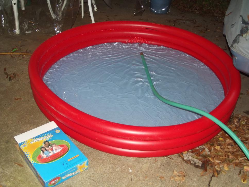

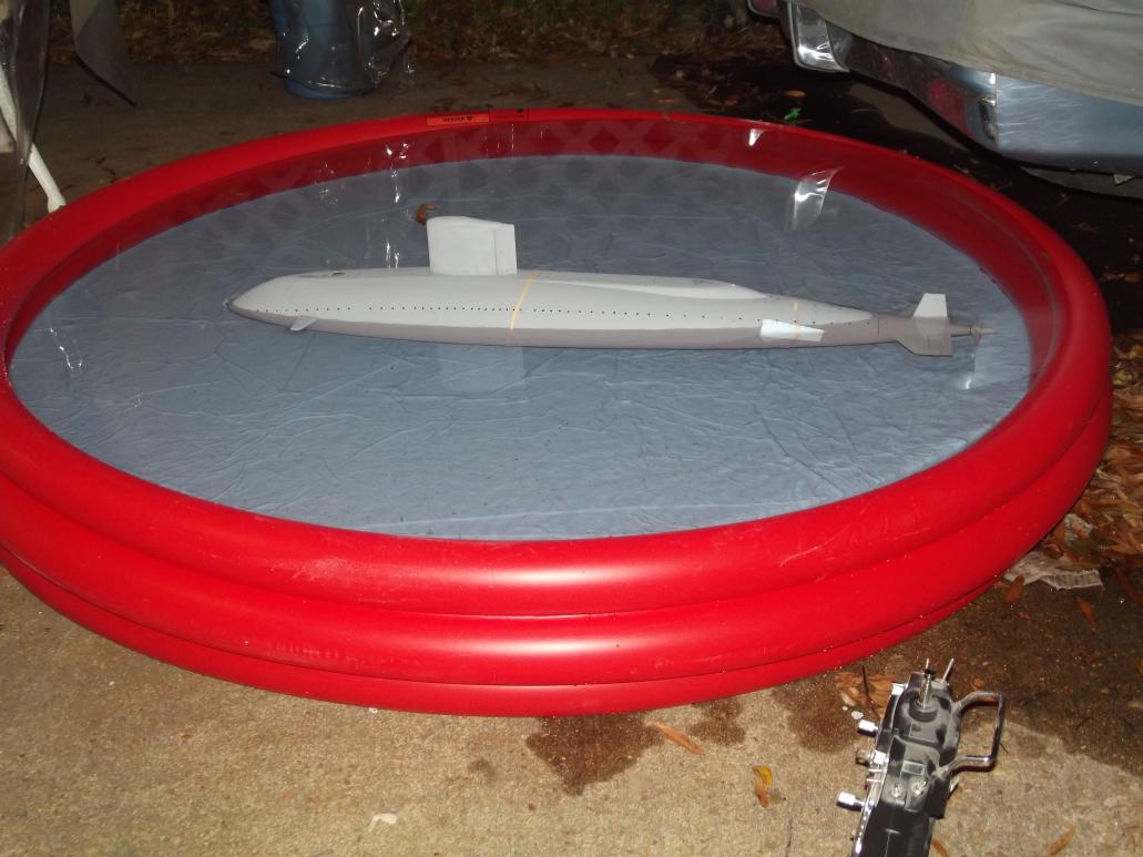

                  I like the kiddy pool David, but you'd think after all these years that the Virginia Beach skunk works would have a purpose built test tank.
                  Is that kiddies pool deep enough for a static dive test?
                  sigpic
                    • 13982
                    #54

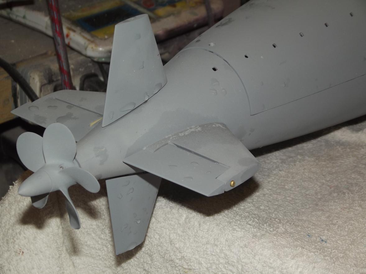

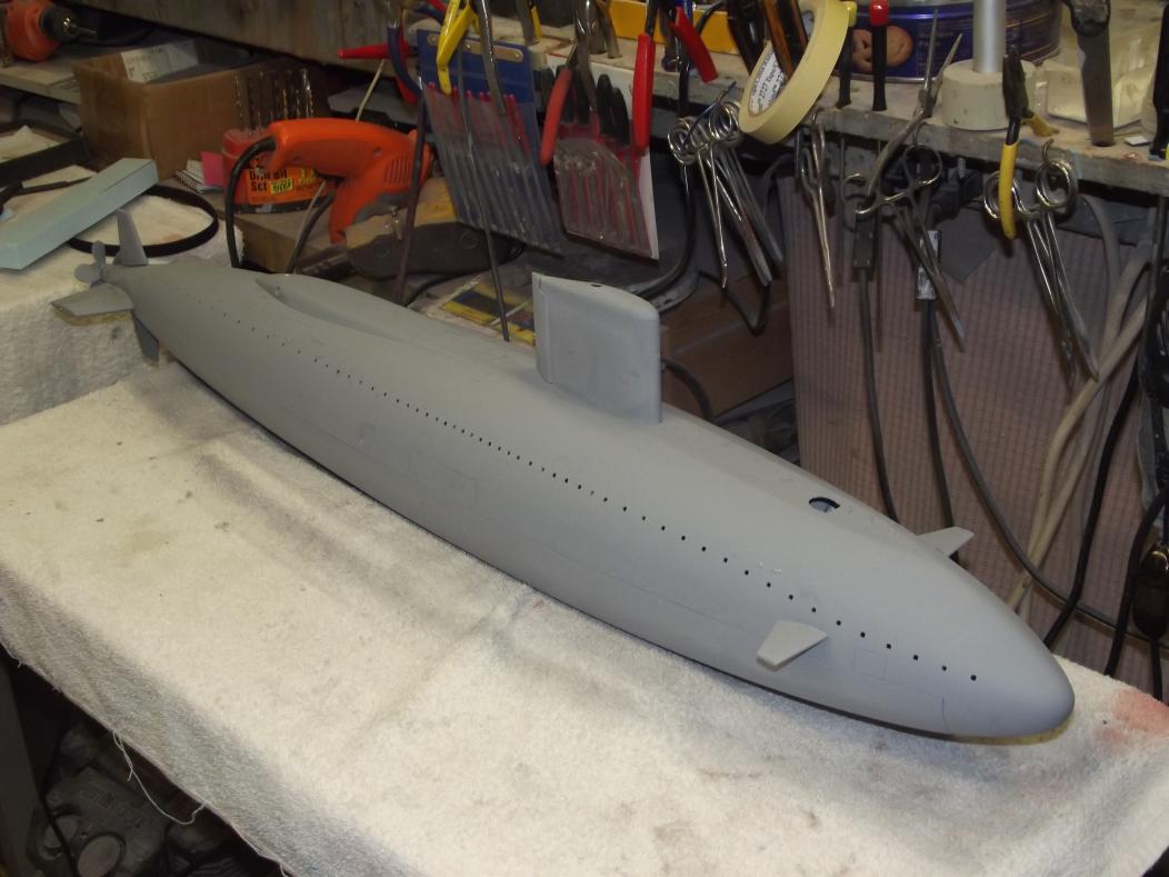

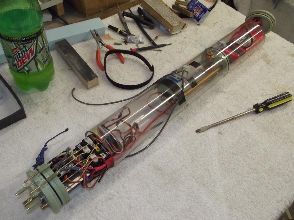

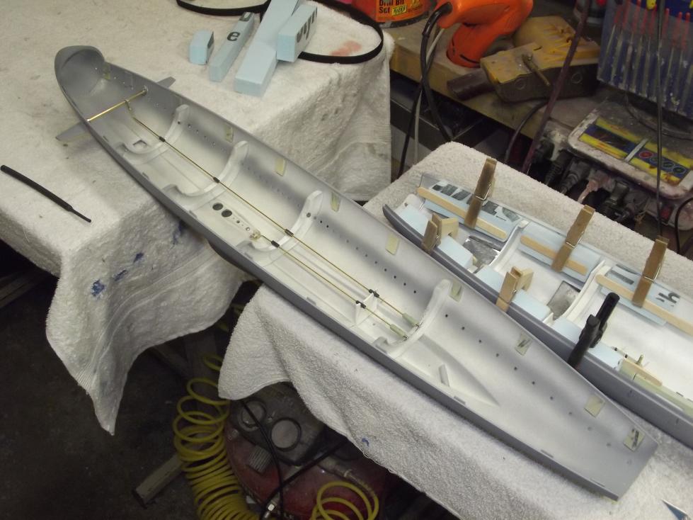

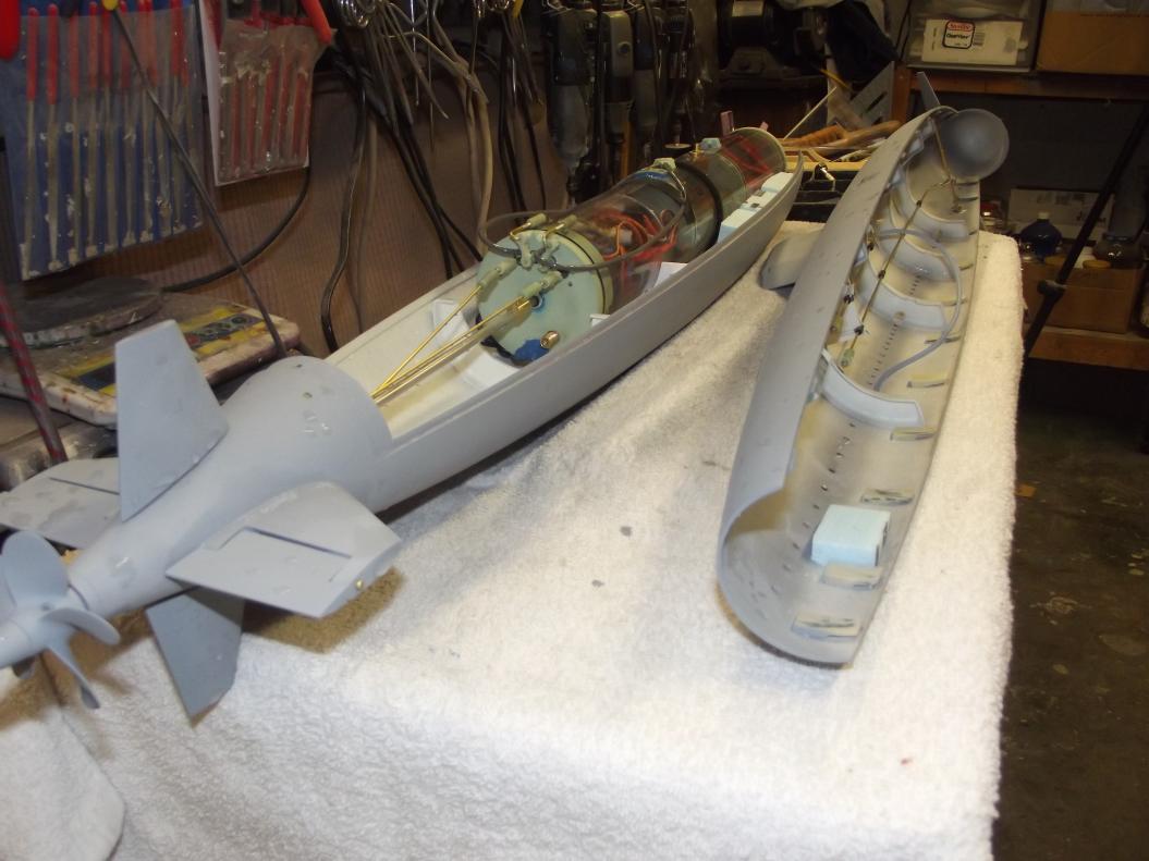

                    I've gone with Skip's old kit just to serve as a mule to proof the fit of the 'new' stern, sail, propeller, yokes, SubDriver and some other items that will go into the eventual Caswell-Merriman 1/60 GRP-resin ALBACORE kit.
                    Sure, that sows ear can be turned in to a silk purse (Bono!) -- but much work is required to make that transformation. Something, by the way, John, you could pull off.
                    Anyway -- as you can see I've qualified the 'new' 3" SD in this thing. Works like a charm. Well along getting the model trimmed out. Will finish that task tomorrow morning. Maybe there will be time to take it to the local Dive Shop pool for some video. We'll see.

                      Im loving it. Dave, before you put it in the large swimming pool, any predictions on how you think that the sail rudder will work? I would think that it would cause the hull to rotate about its axis.

                          Well, Mark, just got back from the local Dive Shop pool, and the ALBACORE performed very well.
                          Started out with 30% throttle, each end. Later in the session I got crazy and took things to 50% both ends. Wow!
                          With the dorsal rudder active I had to learn how to do high speed submerged turns all over again -- I initially involuntarily cranked in too much 'rise' on the planes in the turns to compensate for what (in any other boat) I would expect: a rolling boat turning the hard-over rudder into dive planes at 'dive'. However, on this Ride, the dorsal rudder negated the roll and I had to un-learn the 'up planes' normally needed to counter the diving-turn.
                          Damn this boat turns sweet! And response to stern and bow planes is immediate a sure.
                          No water in the SD. Got video above and below the surface. And this beast is ready for paint!

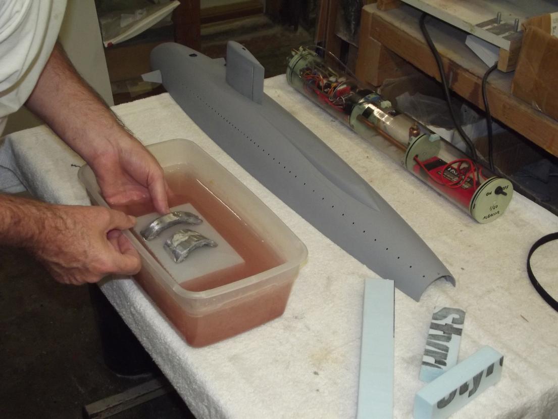

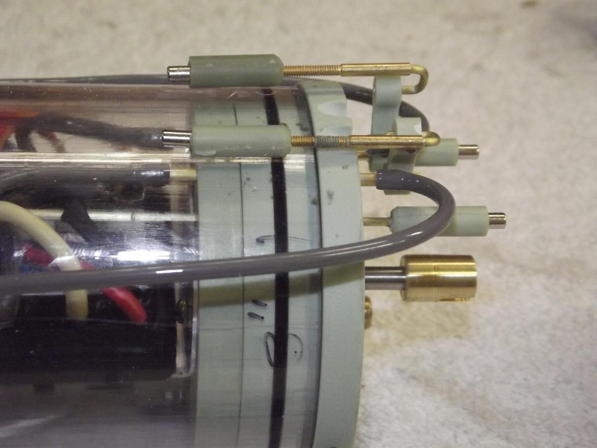

                              Proof of Tom's genius is this neat cast resin, two-piece 808 video camera watertight housing. He was kind enough to share a copy of this thing with me. He did so a couple of months ago. Now, needing a video study of the 1/60 ALBACORE dorsal rudder effects on roll attitude, it comes in handy.
                              I modified it a bit so I can turn the little HD video camera (a wonderful thing in itself!) on and off without breaking into the case or removing the assembly from the back of the model submarine. I modified one of the plugs to serve as a pressure fitting -- so I can validate watertight integrity of the case.
