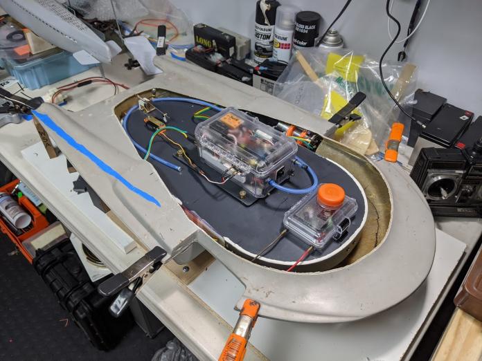

            FWIW, physically and mechanically, ALVIN is best off with a Modular Box build than a WTC. See David's photo of Bob Martin up above. Easier to layout, build and suit to taste, and do maintenance on. Look at S3 T2500 or T3000 Sizes (Clear Polycarb) Here's another submersible using them...
            Click image for larger version  Name:	IMG_20191128_103515.jpg Views:	0 Size:	63.8 KB ID:	171921
            Click image for larger version  Name:	IMG_20181226_122557635.jpg Views:	0 Size:	68.2 KB ID:	171922
