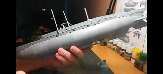

          I have the 1/35 scale kit from Merit similar to this Click image for larger version
ID:	169250 (screen grab from Youtube)

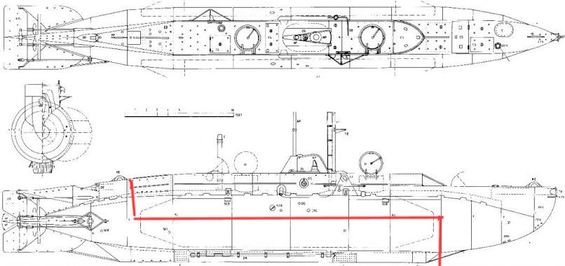

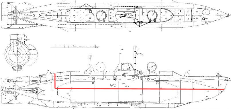

          Will cut the hull similar to Rob's boat.

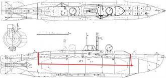

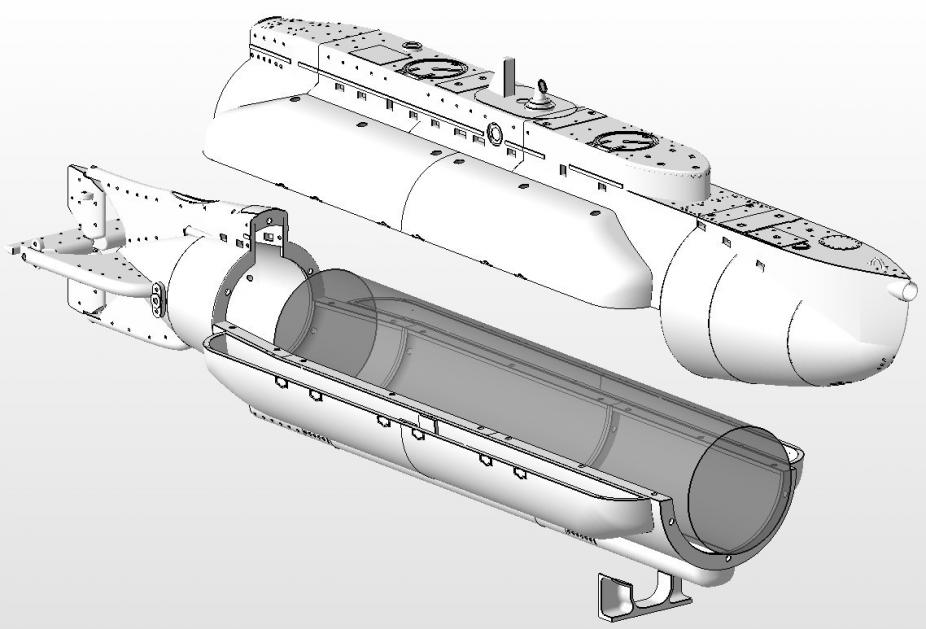

                  • 3497
                  Originally posted by rwtdiver
                  I have the hull sections on the X-Craft all glued up, including the side charges.
                  The stern section will be attached later after all the control surface linkages and the propeller shaft has been installed. Leaving it off at this point will allow better access to the linkage installations.
                  "Firemen can stand the heat."
                  Going with a radial hull separation instead of the traditional longitudinal L, U, or Z cut? Click image for larger version
