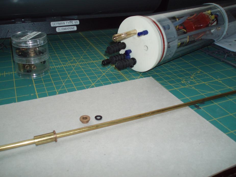

                I ran into an issue with the 80mm WTC for my Type Vll build!
Name:	ARKMODEL shaft seal 2.jpg
                The caps on the original drive shaft bushing would come unscrewed during operation. The cap with seal on the shaft are threaded. When the motors turned in reverse or forward one or the other caps would unscrew themselves! Bob had a suggestion on his YouTube build up of the 80mm WTC, that you apply CA (just a little) to the cap and the thread. It did not work! If you applied to much CA and it would be impossible to change the seal if it ever required replacement!

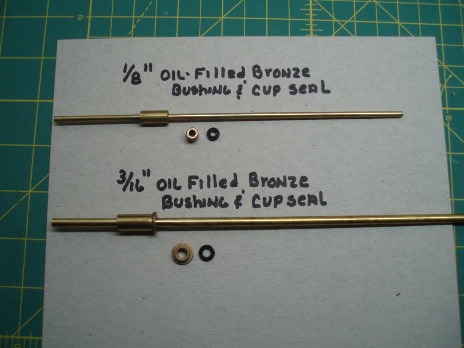

                So needless to say I did remove both drive shaft bushing and I will replace them with a new drive shaft seal system!

                My question? Could I use either the 1/8" or 3/16" oil filled bronze bushing with cups seals to use as my drive shaft seals?

                  Sure, but may i ask you are using brass for the shaft instead of stainless steel?
                    #84
                    Jorg, thank you for chiming in!
                    I have seen brass used as shafts, but if stainless is better I would for sure go that route, no problem there. Could you give me your reasoning as to why one would be better than the other? I could see that the brass might bend or twist in a stressed situation!?
                    "Firemen can stand the heat"
                      #85
                      I was helping a gentleman who had an issue, as he ran his sub, he was seeing the motor begin to struggle up to the point of seizing. I recommended he change from brass to stainless steel because I believed he was having a metal expansion issue. As the brass heated up from friction it was causing more binding. He switched over to SS and issue disappeared. There are other things like corrosion, but I want to see Joerg’s reason.

                        It is simply too soft and you cannot have its polish ramain stainless. It is not rigid enough, it could bend on higher rpm's. The shaft seal will cut a groove into the shaft around the sealing (yes, rubber cuts brass! It will polish/grind out the sealing surface).better Go for proper stainless rod and make your own shaft or use rtr shafts.
                        Trout, i believe you are right. Should that brass shaft fit tight in the bearing, it would cause binding right there.
                        Try a brass sheet with a hole, a brass rod of the same hole diameter, put that in the drillpress and punch through the sheet at say 1000 rpm. Will bind and go "knarrzz"
                        Jörg

                            Jorg, Trout, and David, thank you all for the input here!
                            I have ordered up the polished K & S stainless steel for my new shafts.

                              I have a question about the "cup" seal itself?
                              Click image for larger version  Name:	ARKMODEL SHAFT SEAL 3.jpg Views:	0 Size:	64.0 KB ID:	161097
                              Would it enhance the sealing effect to install two cup seals with the oil-filled bronze bushing? Or will one be adequate? Also, would putting another oil-filled bronze bushing in the outboard end of the bushing be advised? Or will this be overkill?

                                One cup seal will be fine, two bushings will be good, but not necessary. It would be beneficial to have one in the prop strut or one between the WTC and motor. I remember someone, might have been David or another founding father type that recommended at least two bushings along a. prop shaft.
