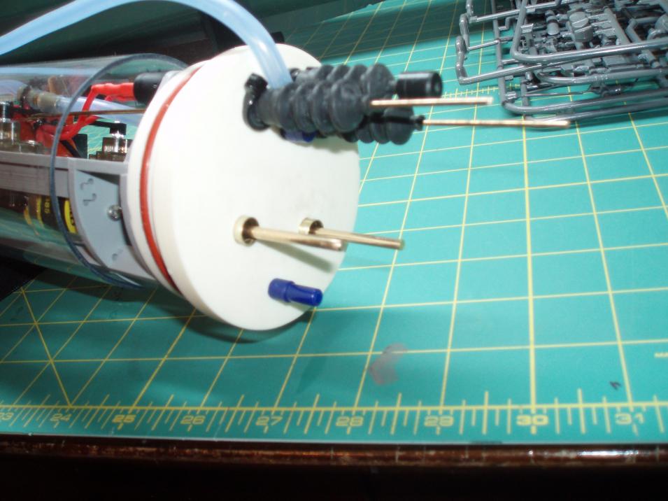

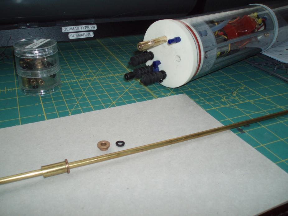

      I just completed the complete replacement of the two existing drive shafts on my 80mm WTC!
Name:	ARKMODEL shaft seal 2.jpg
      In my opinion the drive shaft system on the 80mm WTC is a poor design! I explained it in a previous post if you want to know why.
Name:	ARKMODEL NEW SHAFT 1.jpg
      I used two new oil-filled bronze bushing and cup seals for the new drive shafts! They run very smooth with no vibration at all. I did a complete water test on the shafts at about 3' underwater and for about 8 to 10 min. run time. Reverse and forward at low speeds and high speeds! The end results, no vibrations, smooth operation, and most important NO LEAKS!

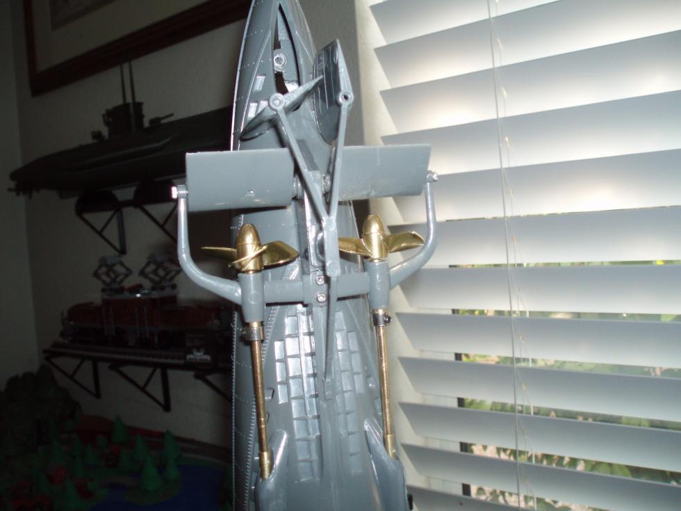

              Today I finished up the drive shaft system on my Type Vll.
              Click image for larger version  Name:	ARKMODEL BRASS 1 PROP.jpg Views:	0 Size:	63.7 KB ID:	161171Click image for larger version  Name:	ARKMODEL NEW SHAFT 1.jpg Views:	0 Size:	77.0 KB ID:	161172
              I installed new brass sleeves to replace the existing. The new prop shaft now match up to the new motor shaft design in the end cap!
              I forgot to add! I did a quick test run in the pool on the new shaft design and it ran as smooth as glass!!

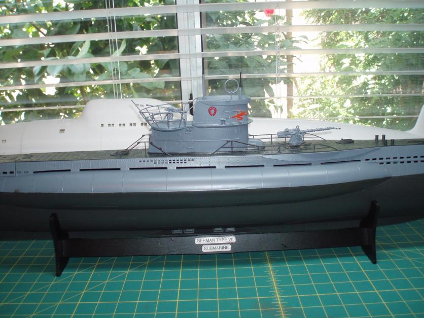

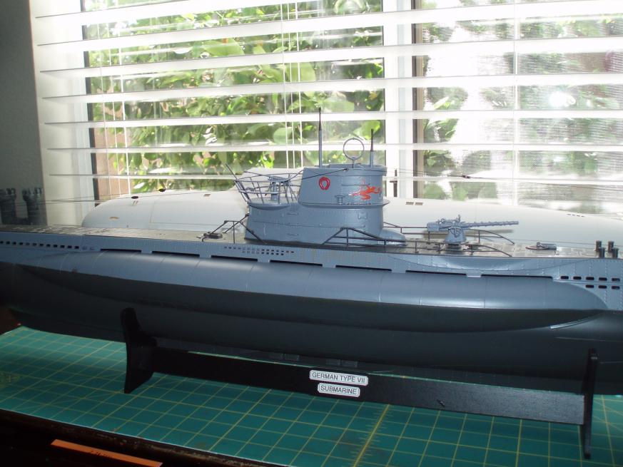

                My Arkmodel Type VII boat is complete and in the final paint stage.
                Click image for larger version  Name:	ARKMODEL PAINT 1.jpg Views:	0 Size:	81.5 KB ID:	161388Click image for larger version  Name:	ARKMODEL PAINT 3.jpg Views:	0 Size:	78.8 KB ID:	161389
                Click image for larger version  Name:	ARKMODEL PAINT 2.jpg Views:	0 Size:	83.8 KB ID:	161390
                I chose to go with the Early U-552 detail and color scheme. The kit came with the decal for this boat. Before anyone gets into a huff as to whether or not I have it all correct or not (it's close enough for me) Those of you that have seen some of my builds, I am not into the total exact detail, or the weathering paint schemes at all!
                Note: The 80mm WTC did not work out well for me in this model. If you followed this build, you noticed that I had an issue with the motor shaft exist from the end cap. My solution to the problem did not work as planned. I would rather not go into the other issues that I had, so I am caulking up this build to total INEXPERIENCE on my part! Someone with more abilities than I have at this point will take that 80mm WTC and make it work very well with the Arkmodel Type VII.
                As it stands! I am completely satisfied with my end results. The Arkmodel Type VII is a great kit that went together well, and the 80mm WTC in the right hands can be made to work well with this model.
                I still have a few more little details to do on the kit after which I will post more photos! Also, check out my 1:72 ALFA build to see what may become of my 80mm WTC!! Never a dull moment! :-))

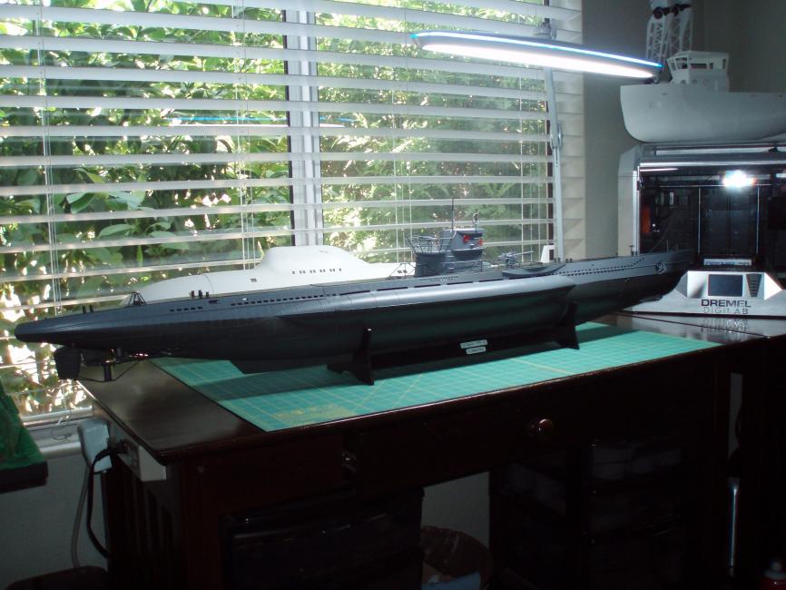

                  Final Arkmodel Type Vll finished photos!
Name:	ARKMODEL FINISHED 3.jpg
ID:	161407Click image for larger version
Name:	ARKMODEL FINISHED 2.jpg
Name:	ARKMODEL FINISHED 4.jpg
                  Even though I did not get this boat in the water, it was still a fun build! Over and out on this project!!
