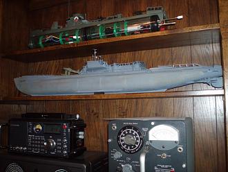

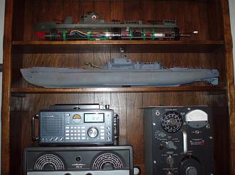

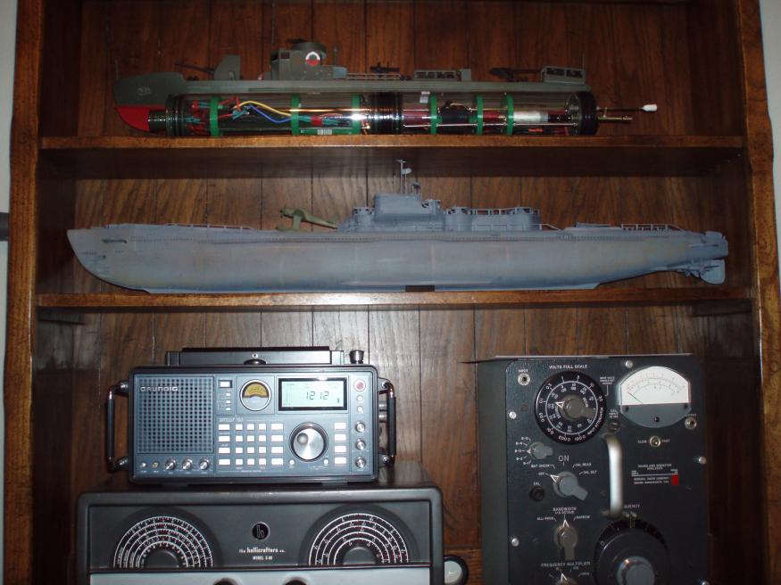

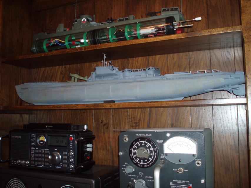

        The i-401 is complete and siting in its assigned spot!
Name:	Finished i-401.jpg
ID:	156314Click image for larger version
Name:	Finished i-401 2.jpg
        I really enjoyed the build process on this submarine. I really appreciated all the information that was posted on the blog about this submarine. Thank you all!

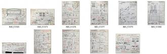

          Congratulations to you sir, on the successful completion of this submarine. I also really like the I-400 class submarine, for which I did a lot of research and did not miss every detail of this submarine. I have a lot of references on the I-400 submarine, lots of historical pictures, lots of reference books (I have to admit that the I-400 submarine is detailed by the Japanese) and I will share them if needed. Time is precious to me, so my ideas may not be quite the same as others, I don't have much time to make rc submarines, so I will try to make as few and complex as possible, each submarine is carefully selected by me and very representative, for example I-400 I think it can represent most WWII submarines in terms of function, because it really has many functions and complex, for that I even designed 1/72 rc I-400 submarine, which has all moving parts on board and almost fully automatic control. So complex structure that took me almost a week to design the structural sketches.

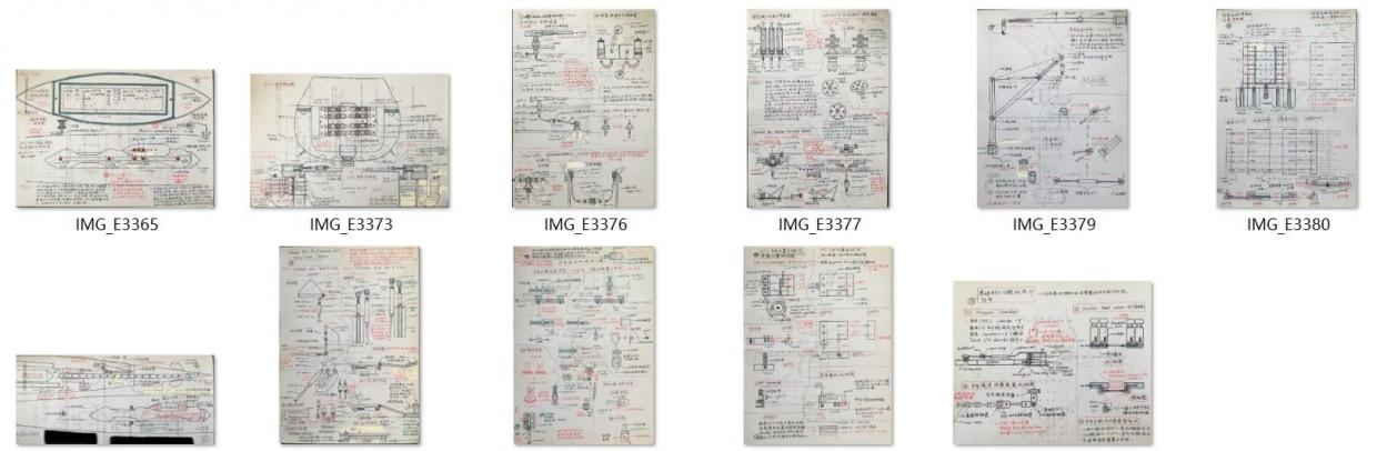

                    I'm sorry I didn't send the pictures one by one, because considering the picture above the description text is not in English, so it is difficult for all of you to read what is written on it. Here is the side view and top view of the boat, my design makes all the parts on it movable, if you are interested in the function of any part of this boat, please let me know and I will share my design with you.

                      #115
                      Nope, your sketches.
                      • Sam Victory
                        • Sep 2021
                        • 391
                        #116
                        The annotations on the images are basically in Chinese, with a few in English, are you sure you still want to read it? I think it's a bit embarrassing if I send the design out with the possibility that people won't understand it (for Chinese annotations).
                        V
                          #117
                          It's okey. If it's like the previous sketches you posted the pictures can speak for themselves. Besides, can always use google translate.
                          • Sam Victory
                            • Sep 2021
                            • 391
                            #118
                            Well, I'll try to post them... The resolution of my pictures is very high, but there is a limit to the resolution of pictures on this forum, so I can't post my original pictures, I have to take screenshots one by one.
                            V
                              #119
                              Thanks Sam.
                              From my initial scan, slide #2 looks like plans for a working deck gun.
                              • Sam Victory
                                • Sep 2021
                                • 391
                                #120
                                These sketches I'm afraid are not that well understood, the I-400 submarine is different from other WWII submarines, it just has too many features. In terms of perspective, I drew mainly side view, top view, and main view. The ship has a dry hull structure, but the principle of the ballast system is similar to the SAS system, only the structure is different. I set the ballast water tank between the hull and WTC (same as the real submarine), the tank is separated by many bulkheads, so as to increase the damping of water, after all, a long water tank is easy to be unstable, the WTC is hollowed by the bulkheads, I don't know if you can imagine what I said, because I didn't draw the design too specific.
