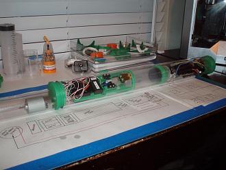

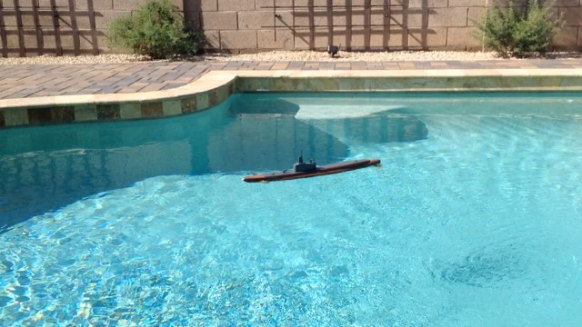

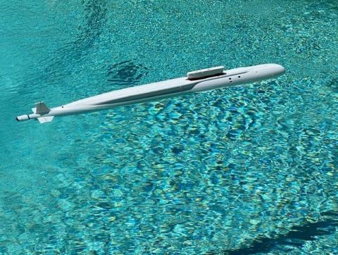

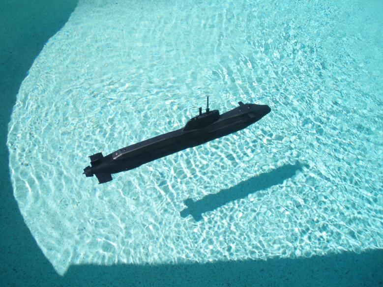

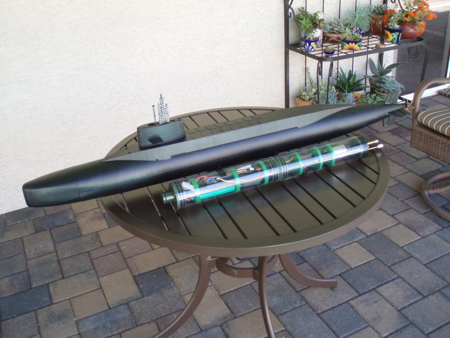

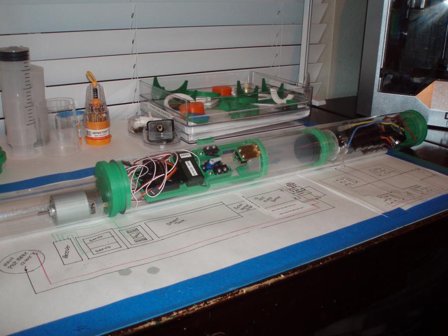

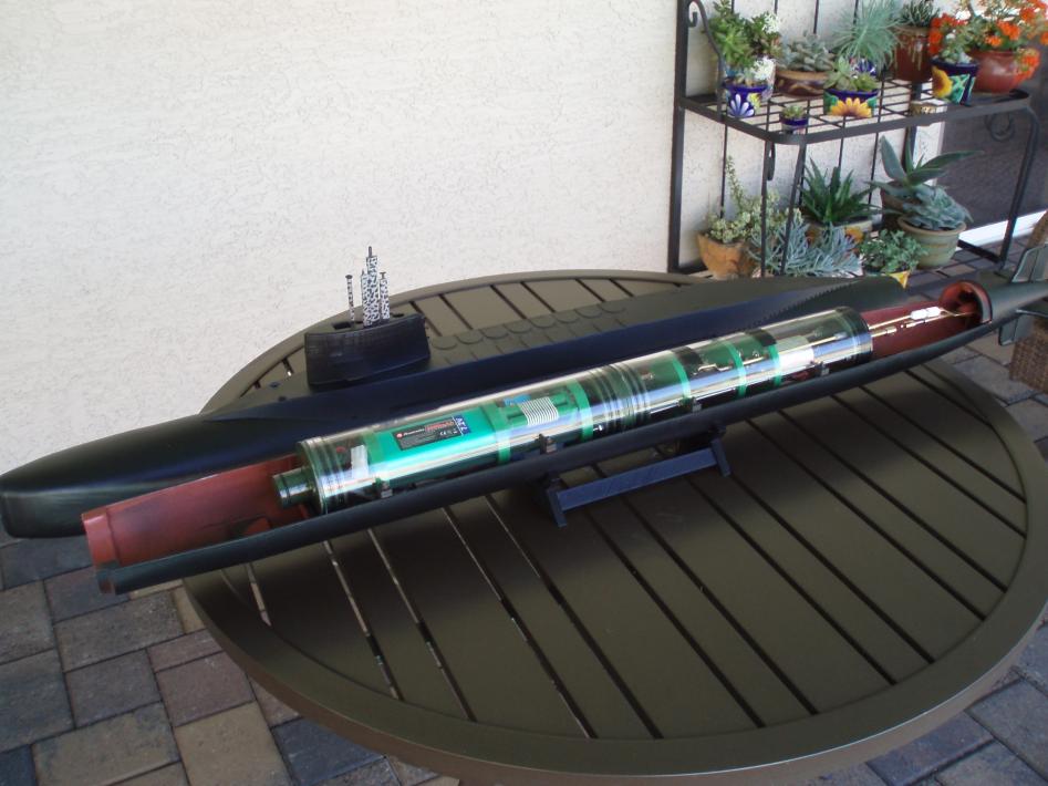

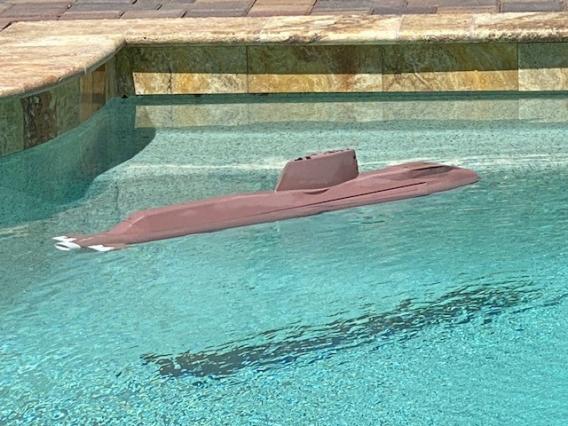

      As some of you are aware on this forum! I run all my submarines in a swimming pool. I have one sub (Thunder Tiger Neptune) That can actually static dire, the rest of them are dynamic divers and surface runners at best! I do enjoy designing and fabricating my own WTC power systems as per say for each of my subs. I am not a rivet counter or into much of any detail work like most of you are! Black or dark grey hull with a little red/orange on the bottom and some detail on the sail components the just out of the factory fresh and clean, that's great for me! It's just the engineering and building that I enjoy!
Name:	Final WTC 1.jpg
ID:	155621Click image for larger version
      If it moves in the water I am totally happy with my work! As for the i-401, if I can design and just put power to her, and she moves in the water, I will be satisfied!

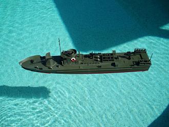

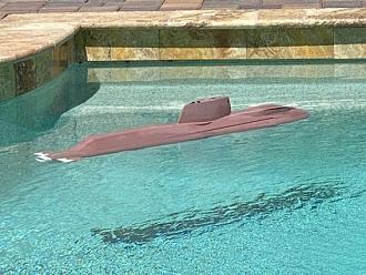

        Click image for larger version  Name:	HL Hunley.jpg Views:	0 Size:	51.6 KB ID:	155625Click image for larger version  Name:	Nautilus one.jpg Views:	0 Size:	68.6 KB ID:	155626
        Click image for larger version  Name:	P4190001.jpg Views:	0 Size:	87.7 KB ID:	155627Click image for larger version  Name:	photo[5405].JPG Views:	0 Size:	52.0 KB ID:	155628
        Click image for larger version  Name:	photo[7761].JPG Views:	0 Size:	50.3 KB ID:	155629Click image for larger version  Name:	Sub.jpg Views:	0 Size:	72.5 KB ID:	155630
        Click image for larger version  Name:	Borei 955.jpg Views:	0 Size:	52.1 KB ID:	155631Click image for larger version  Name:	Redoutable.jpg Views:	0 Size:	46.7 KB ID:	155632
        Click image for larger version  Name:	PA030001.jpg Views:	0 Size:	74.4 KB ID:	155633 Click image for larger version

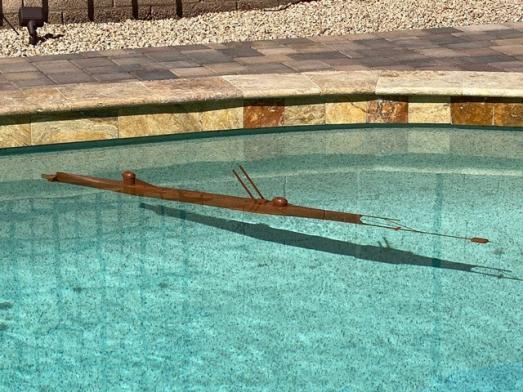

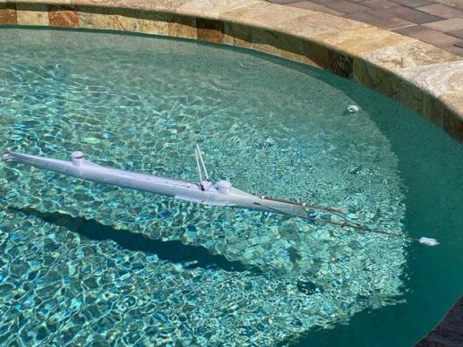

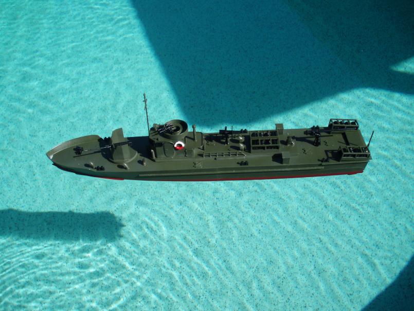

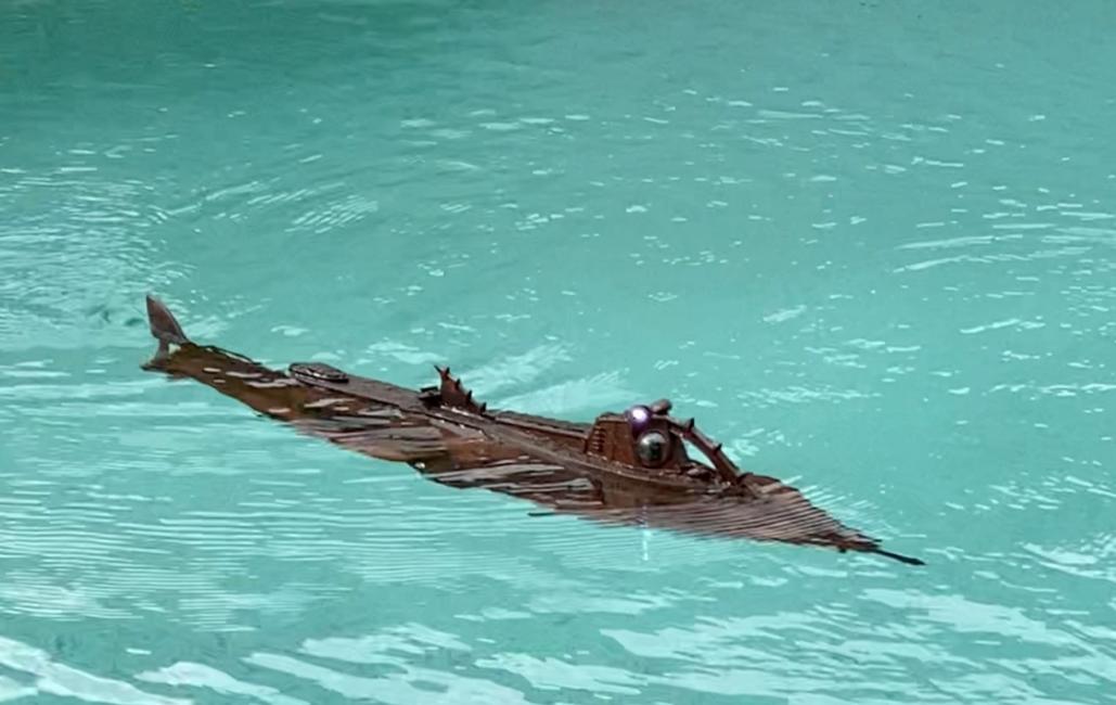

        I have over 15 boats at this point! They are all 3D printed, and do move in the water! I have one (photo above) surface boat, it's called a sub chaser! This is where this hobby is for me! I enjoy the engineering and building (3D printing) of all kinds!

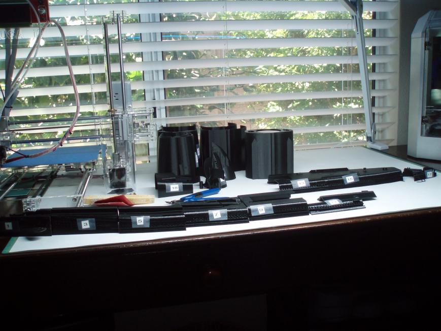

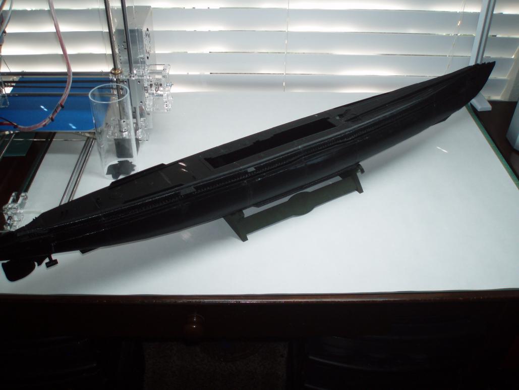

                The upper and lower hull sections are complete!
Name:	i-401 hull 2.jpg
ID:	155660Click image for larger version
                I am now working on the upper deck aircraft storage area and top sail! Ounce these are complete, I will start on the actual build. I do have items, such a deck guns and such to do as well!

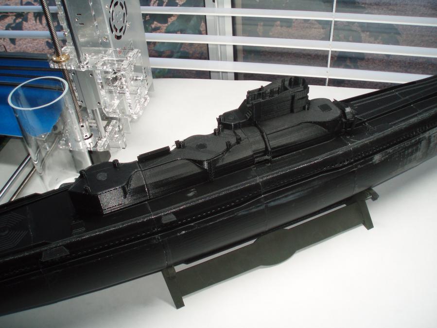

                  #68

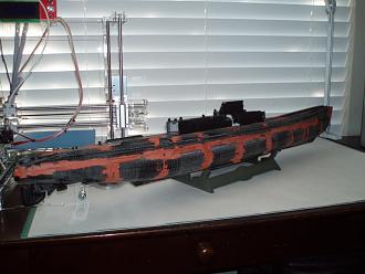

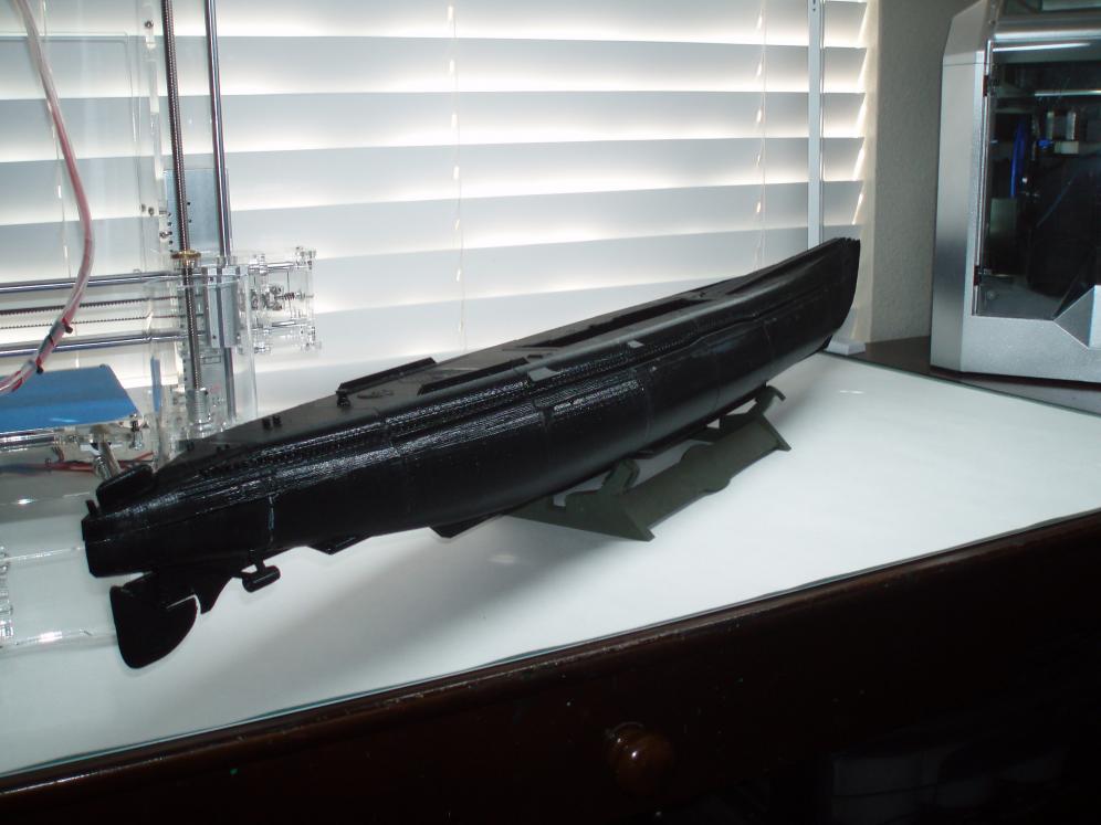

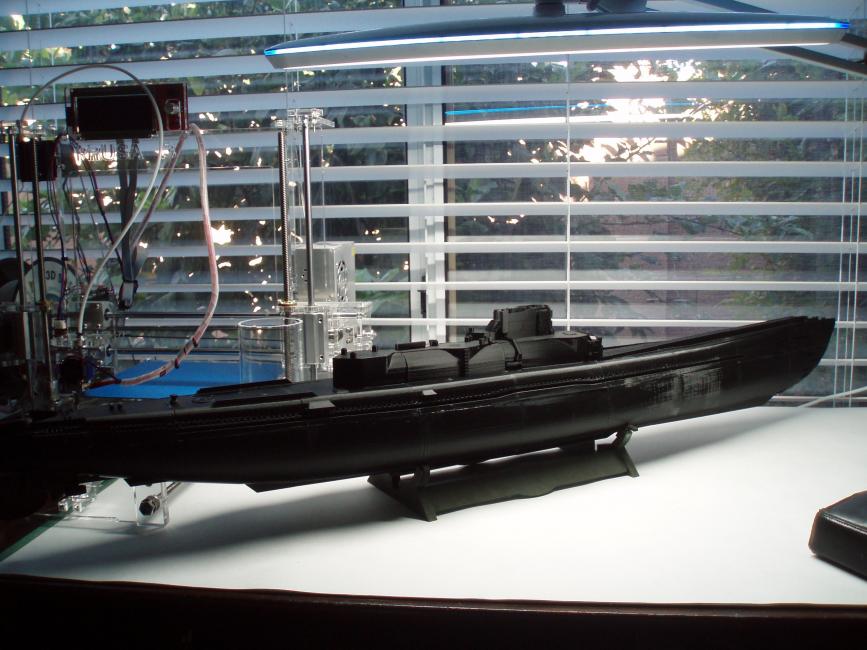

                  The upper hull and lower hull are glued up and put together!
Name:	i-401 hull 3.jpg
ID:	155663Click image for larger version
Name:	i-401 Hull 4.jpg
                  At this point, the i-401 boat is going to be static boat only! As stated above I am currently printing out the super structure!

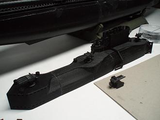

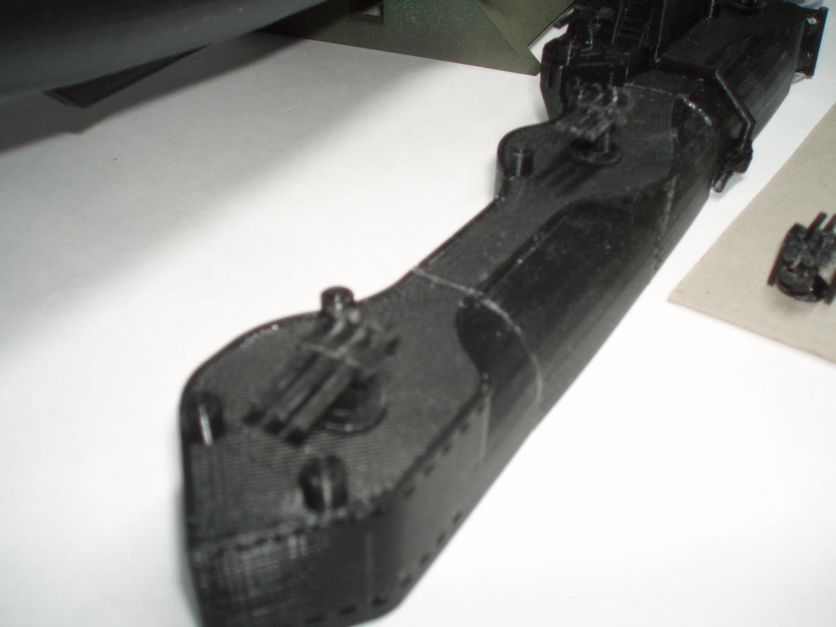

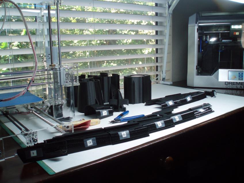

                      Finished up the Superstructure and sail parts last night! Even with changing the scale of this boat they came out quite well!
                      Click image for larger version  Name:	i-401 superstructure 2.jpg Views:	0 Size:	75.0 KB ID:	155704Click image for larger version  Name:	i-401 superstructure.jpg Views:	0 Size:	83.8 KB ID:	155705
                      I have a few more top deck items to finish printing!

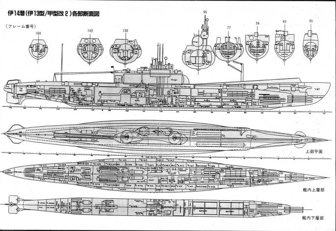

                        You really do have a number of submarines sir, that's super cool! All these submarines could make a fleet, couldn't they?
                        V
                        IJN I-13/ I-14 sub diagrams:

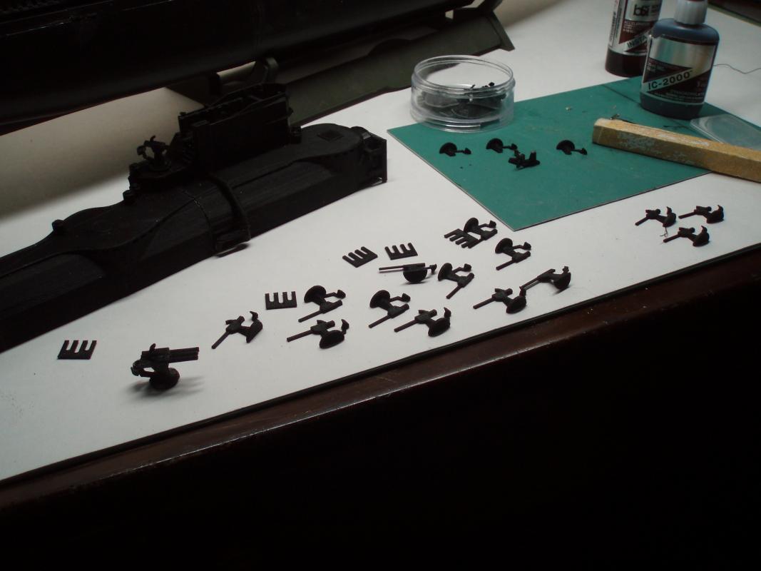

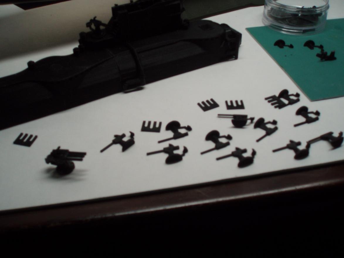

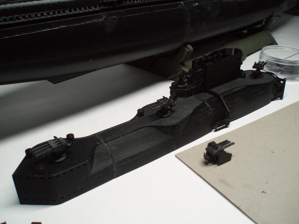

                            I have started on the super structure (sail) detail items. The deck guns have will not print out on a standard 3D printer at the scale I need! I will be fabricating the smaller guns using parts and pieces from different types of guns to achieve a reasonable facsimile to the full scale!
Name:	i-401 deck guns 2.jpg
ID:	155758Click image for larger version
Name:	i-401 deck guns.jpg
                            I will be using TinkerCad to achieve what I need!
                              #74
                              In order to achieve some the scale look of the 25mm anti-aircraft gun turrets on the super structure I had to use parts and pieces of other submarine deck guns!
                              Click image for larger version  Name:	i-401 gun turret.jpg Views:	0 Size:	59.1 KB ID:	155775Click image for larger version  Name:	i-401 gun turret 1.jpg Views:	0 Size:	56.8 KB ID:	155776
                              I still have the turret shielding to fabricate and install.

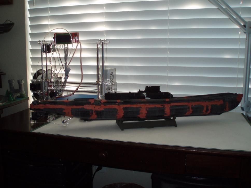

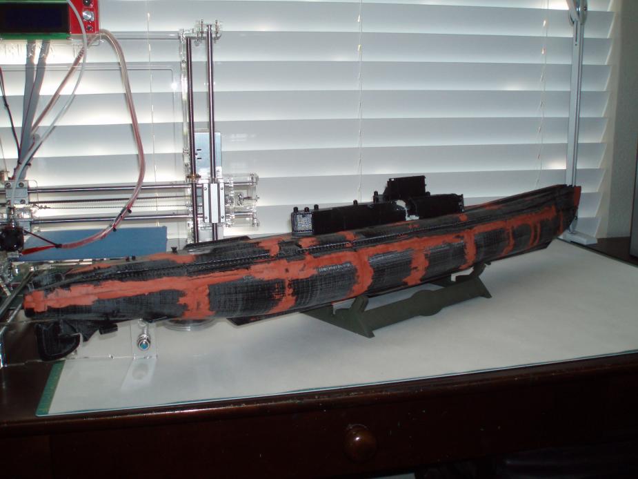

                                Today I did the first sanding on the i-401!
Name:	i-401 finish work 2.jpg
ID:	155800Click image for larger version
Name:	i=401 sub finish work.jpg
                                I also did some fill in work on the main hull with some Bondo spot putty, and some Apoxie sculpt fill in on the superstructure! After the fillers have dried I will re-sand and fill any remaining areas that may need it!
