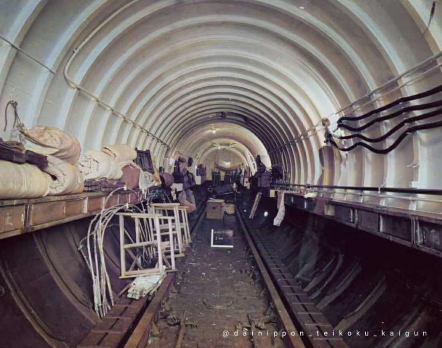

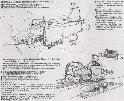

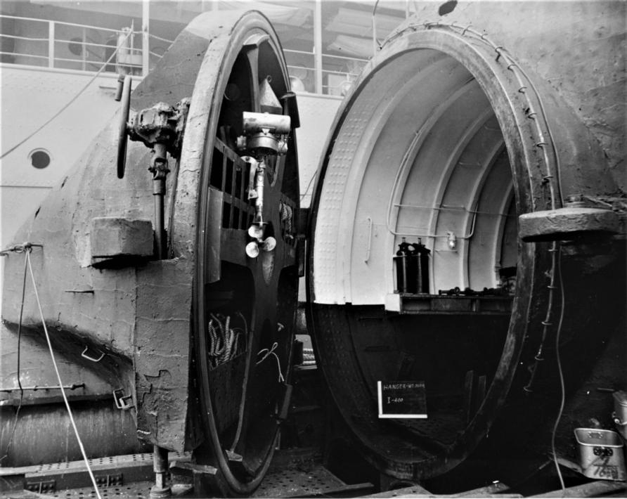

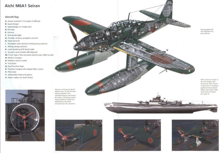

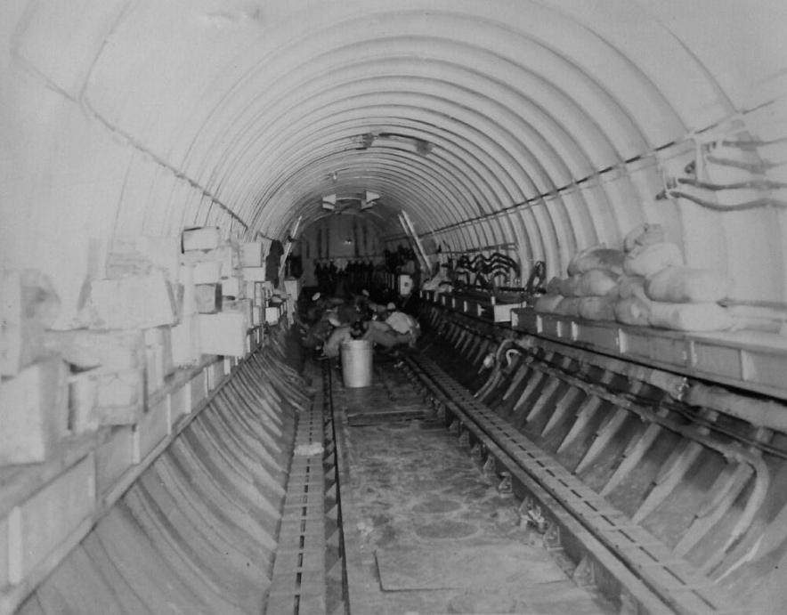

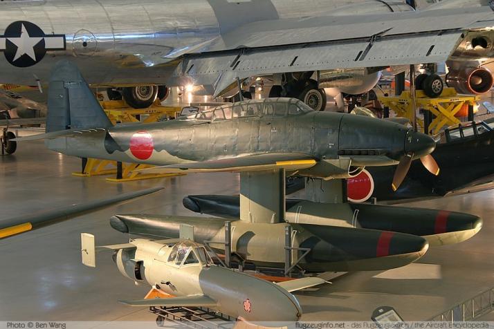

      I have very detailed information on the I-400 class submarines, many detailed aspects of their construction. It was very difficult to completely figure out the structure of this submarine (at least in appearance), and the US navy destroyed all information on the I-400 class submarines to the point that later information was based on the recollections of veterans who served on Japanese I-400 submarines after the war. So any drawings of the I-400 submarine now are not original sources, but only the memories of veterans.

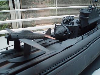

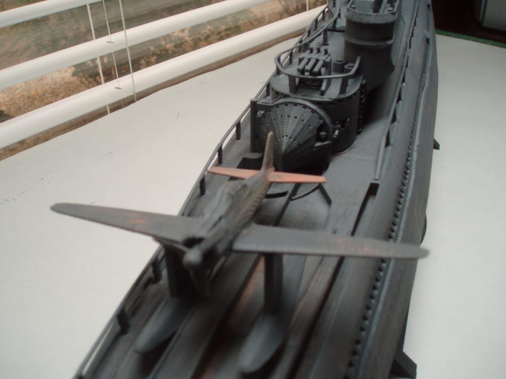

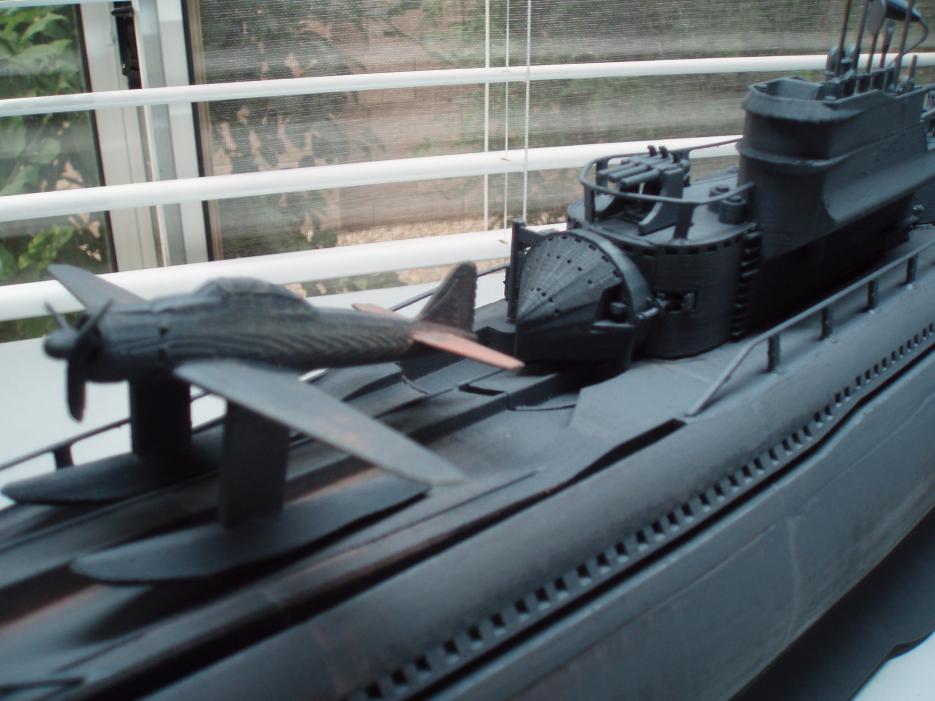

        #93
        My version of the i-401 is about as complete as it is going to be. I have a general representation of what the i-401 looked like, which was all I was looking for anyway. I am not, nor am I going to be a so called rivet counter. The aircraft that I have depicted is not the Seiran Aichi M6A1, it is a 3D printed basic Japanese Zero look-a-like. The hatch on the aircraft storage area does not open, again I just chose not to go into that kind of detail work.
        I will be doing a little more overall splash on paint work to achieve the look that I am after, and then that will be it!
        I want to really give Sam a REALLY BIG THANK YOU for all the photos and description work that you have put on my build blog. I thank all of you that have contributed as well!
          #94
          Not counting rivets either, just want to see what you did.
            #95
            Sorry Ramel!
            Did not mean to forget the photo you wanted to see.
Name:	i-401 aircraft.jpg
ID:	156084Click image for larger version
Name:	i-401 aircraft 2.jpg
            I still have some fill in and sanding to do on the aircraft, and then I will do it up in the original colors of the aircraft.

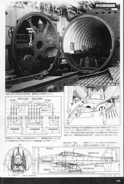

                        If I understood it correctly, the original plans of the i400 class were destroyed shortly before the arrival of the US Navy. Today's plans come from a reconstruction iuch can also deceive me is long where I had read it on the Internet. I have uploaded several pictures one shows a cad drawing there you can see the differences.
                        Regards Gantu

                            Gantu,
                            Thank you again for posted up all this great information. I see there was a difference between the i-400 and the i-401 boat. Very interesting information.
