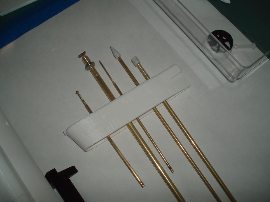

        I have started to work on the sail (conning tower) appendages (periscope, radar, etc..)
ID:	151143Click image for larger version
        I am going to use mostly brass tubing and Apoxie Sculpt to achieve the desired look! (as close to the original as possible)

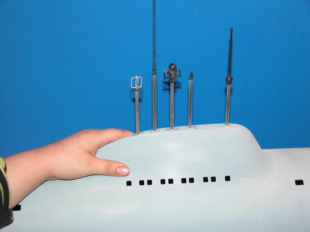

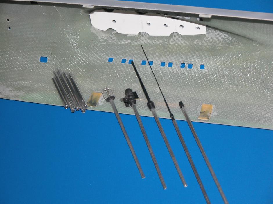

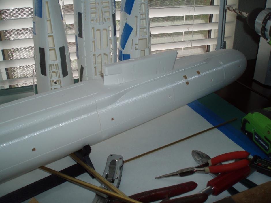

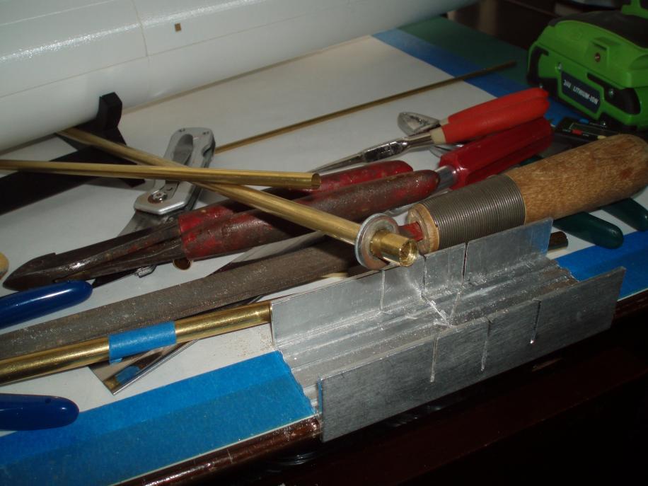

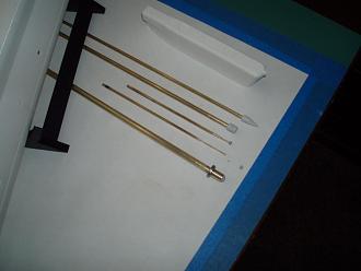

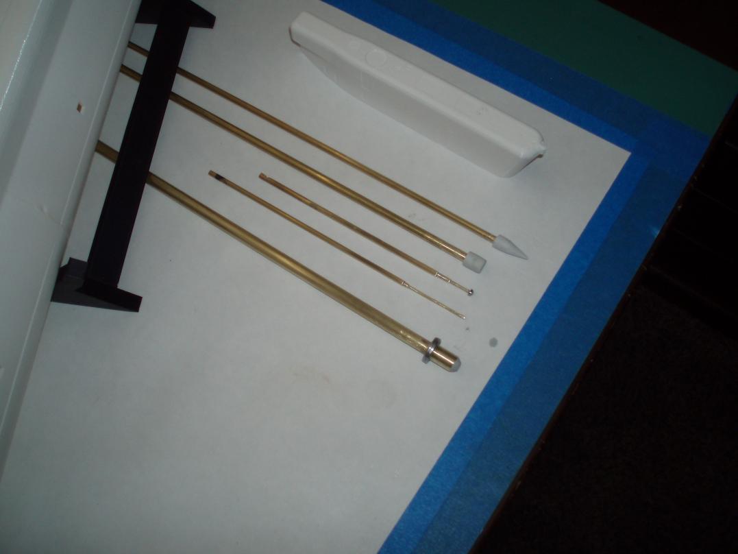

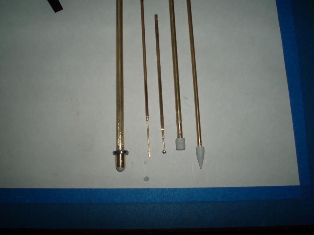

                        Worked on the Borei sail today!
ID:	151164Click image for larger version
                        I have a good start on the sails array of different antennas! I picked four of the most dominate antennas that I found on some original photos and went with those!
                        I stayed with the original BRASS tubing, because that is what I started with, plus I have a lot of hand work done to get them to this point. I realize the photos show a sort of dirty alum. color, and I will be able to get that effect with paints. These are not complete yet, because I still have little tidbits to add to them, and also the final sanding and clean up work prior to adding the detail painting!

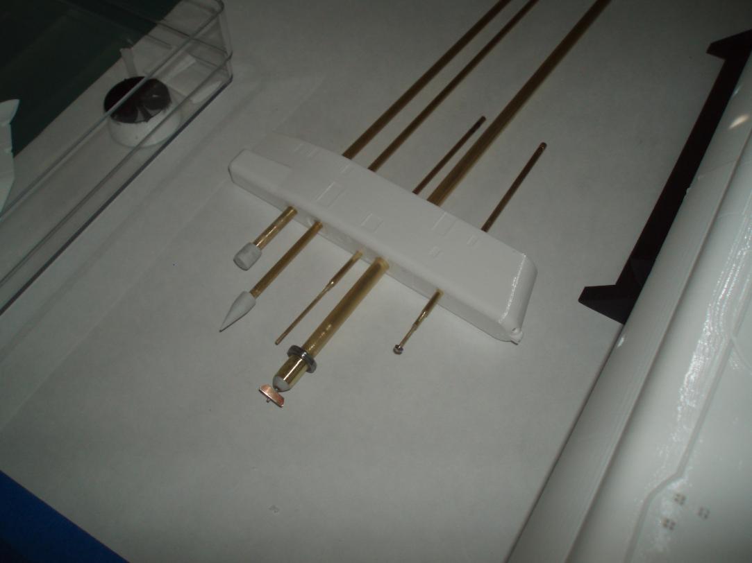

                              #59

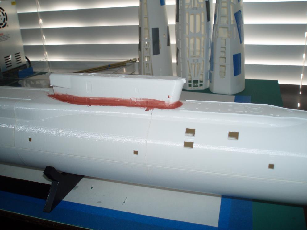

                              Temporally bored the holes and mounted the sail arrays just for fit!
                              Click image for larger version  Name:	P1010000.jpg Views:	0 Size:	51.2 KB ID:	151197Click image for larger version  Name:	P1033333.jpg Views:	0 Size:	48.3 KB ID:	151198
                              They will be mounted after the sail is secured to the hull and basically finished!
                              Before anyone jumps in please note they are not finished yet!!!
                              "Firemen can stand the heat"

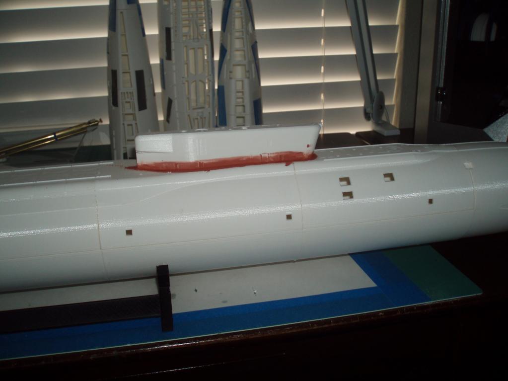

                                #60

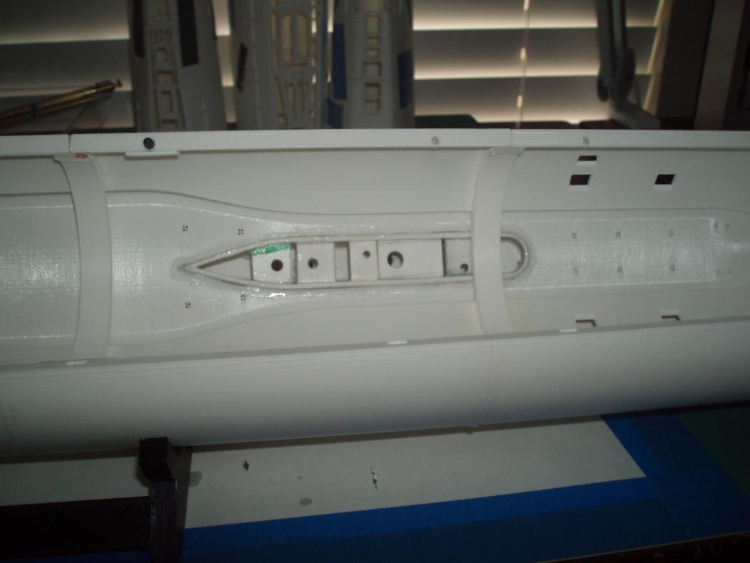

                                Today I finished up the sail and mounted it to the hull!
ID:	151227Click image for larger version
                                The above photo shows the underside of the sail, and the bottom support holes for the sails antennas! This will allow me to completely finish the sub hull inside and out, and then install the antennas through the top and down through the support holes (which line up perfectly) secure them and we are done with this build!
                                What's next will be the prep work and final finish work! Time to start the next 3D printing project! The Russian Typhoon!
