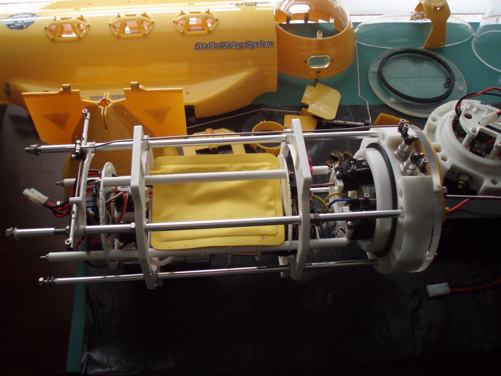

        Most of yesterday spent finalizing the mods to the MSD for the 48th Type VII and getting her dialed in perfectly for trim. This boat will forego the full static dive ability in favor of a dynamic setup for simplicity, reliability and safety. It is ballasted slightly positive. The pump circuit is a closed loop with no internal access to the dry compartments, unlike the full static version which draws air from the electronics compartment to blow ballast.

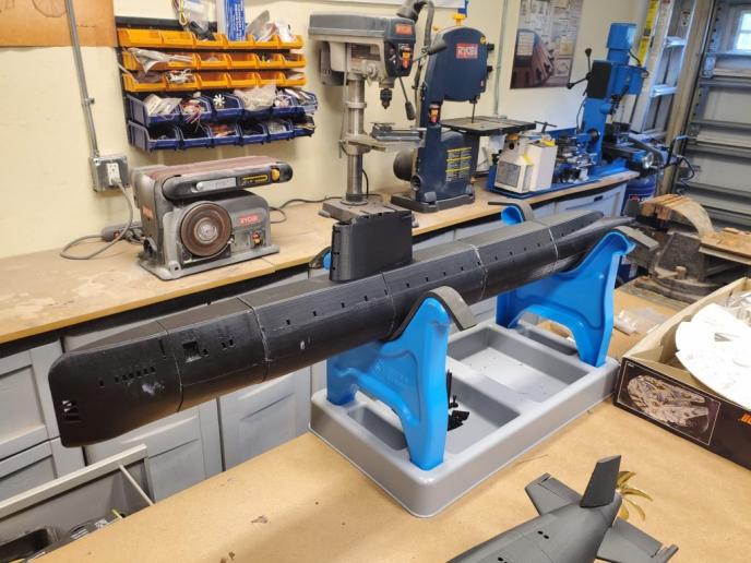

        Nearing completion of printing of the 1/250 LXG sub. Assembly is going well and there is sufficient room in the stern for electronics and drive components if I get creative. One of the first printing flubs on my Dremel printer in a loooong time. It wasn't the printer's fault, but an error in the file that I discovered post-mortem. I elected to continue the print despite the failure of the upper hull. Lost some filament, but saved about 10hrs of print time doing so. Final stern hull section is on the printer now, then it's just control surfaces and conning tower and she'll be ready for final assembly.

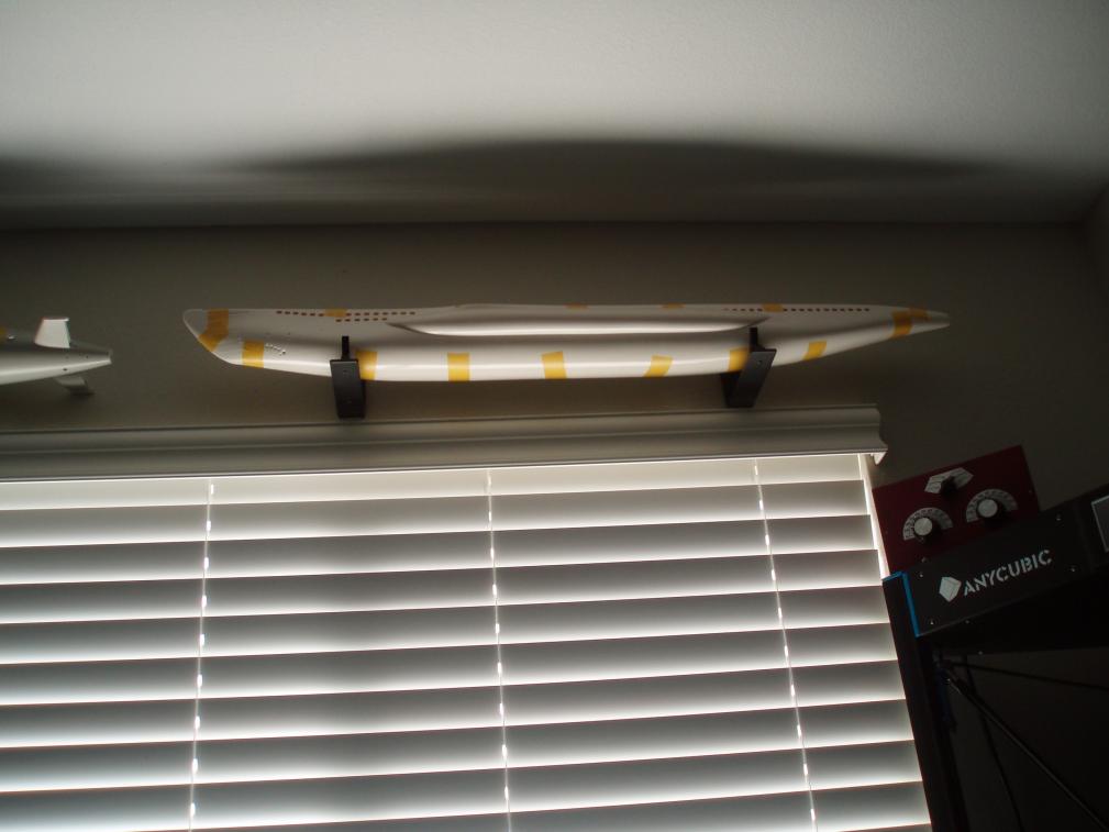

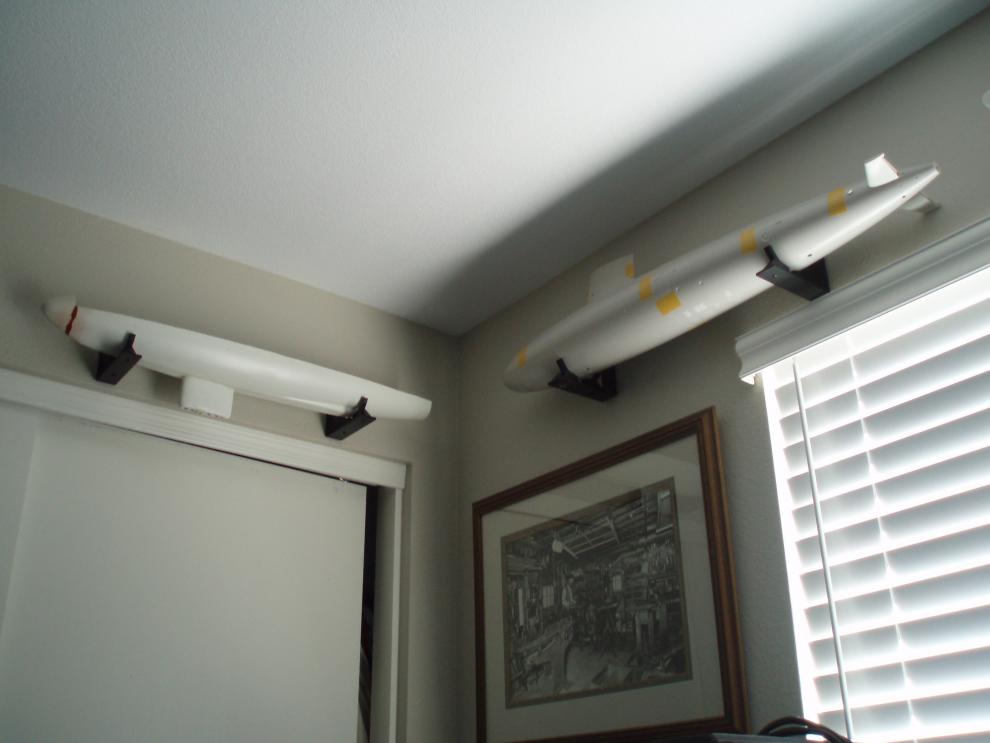

            A lazyish weekend, at least from a build perspective. Did work around the house. Lots of storms here over the weekend, so we couldn't get the Batsub into the pool for final testing and beauty shots. Hoping to do so later today if the weather holds.

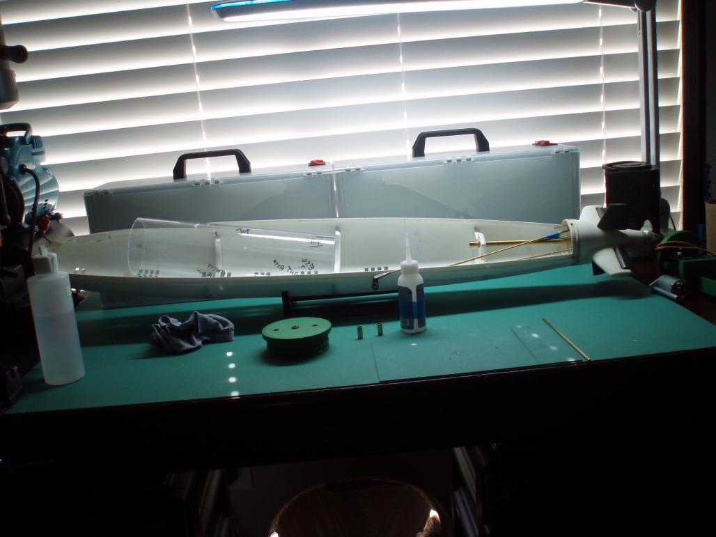

            Most of the work revolved around the LXG Nautilus. I completed the printing and did final assembly, filling, sanding and primer. I'm pretty satisfied with how the hull went together. I still have some gaps to fill that the primer brought to light, but that should be a quick process.
            I've been putting some thoughts together in regard to the control system for the boat. The access to the rear section is only about 1.5" wide. I'm thinking of building a clear acrylic box that will house the battery, air pump, receiver and four servos (rudder, rear planes, front planes and ballast). The ESC and brushless motor will live in the wet. This waterproof box will drop in from the top and seal on a foam seal at the bottom. In that way, if there is a leak at the main seal, air pressure will stop the water from advancing more than a tiny bit into the electronics compartment (think diving bell).
            Also thinking about the propulsion more. Those twin pinecones low in the hull aren't going to do anything, and rigging up twin props in a cramped space, while possible, isn't anything I want to play with if I don't have to. What I'm going to do is open up the rear of the hull and put a 30mm(ish) diameter hole in there directly in front of the really cool triple-rudder arrangement. A single direct-drive three-bladed prop will be mounted in a closed tube, drawing water from the interior of the hull and expelling it directly out the back of the boat and over the rudders. This has many advantages including simplified driveline, a stock-ish appearance, and superb rudder control thanks to the water flow going directly over the rudders at any hint of throttle.

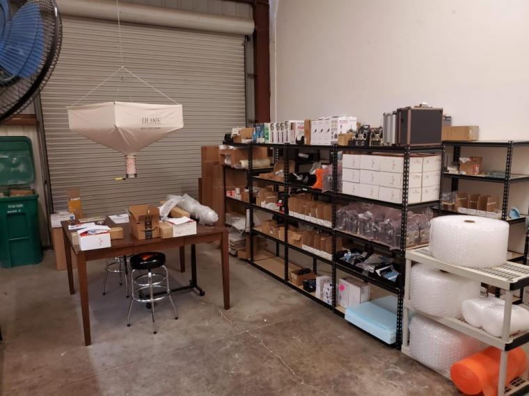

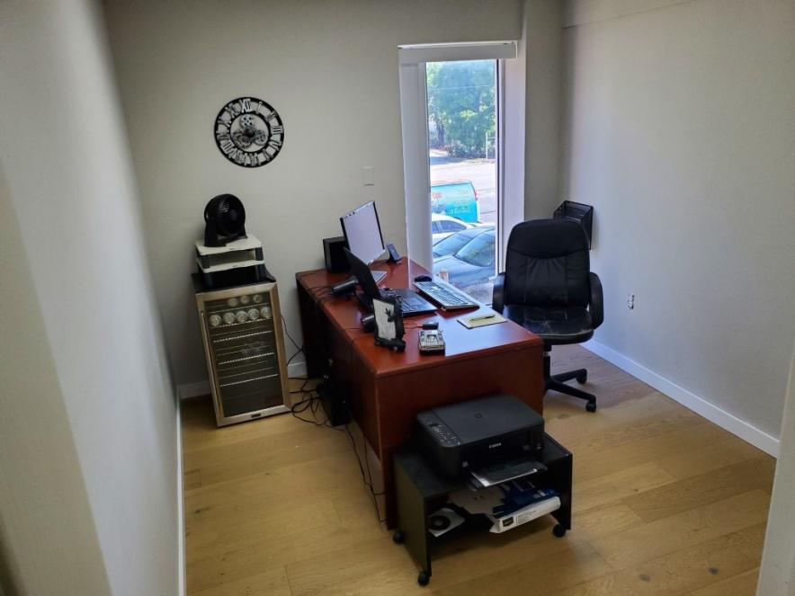

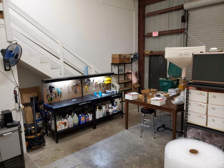

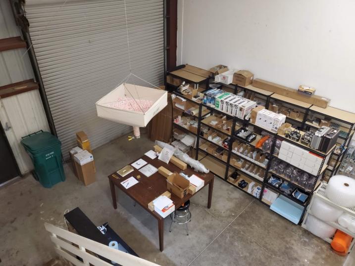

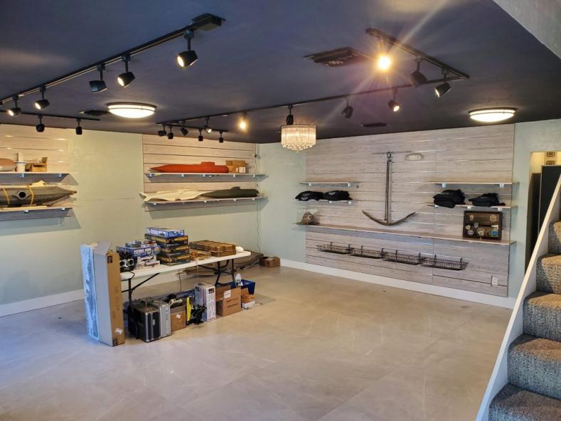

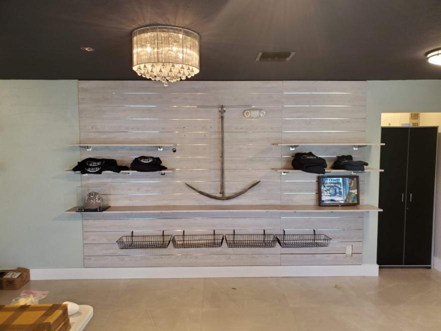

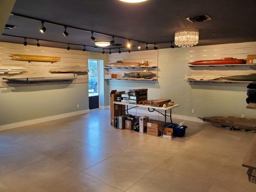

                On a lighter note, and throwing gas on the fire so to speak, I managed to secure a new shop facility. You can view the video here. But for those who don't want to watch through the 3 minutes, here are some photos.
                Hoping to hit the ground running when I return, including hiring someone to manage the shop for shipping and inventory, freeing me up for builds, new product development and new kits.

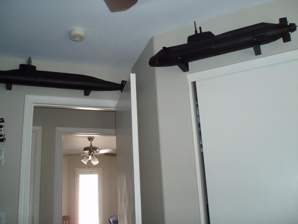

                              Click image for larger version  Name:	P5100816.jpg Views:	0 Size:	72.6 KB ID:	139099Click image for larger version  Name:	P5100817.jpg Views:	0 Size:	43.6 KB ID:	139100Click image for larger version  Name:	P5100818.jpg Views:	0 Size:	50.0 KB ID:	139101Click image for larger version  Name:	P5100819.jpg Views:	0 Size:	59.4 KB ID:	139102
                              Click image for larger version  Name:	P5100820.jpg Views:	0 Size:	67.9 KB ID:	139103Click image for larger version  Name:	P3080002.JPG Views:	0 Size:	76.2 KB ID:	139104
                              I know! The ceiling!!!!:-)) That LA looks like it would be a great build!
