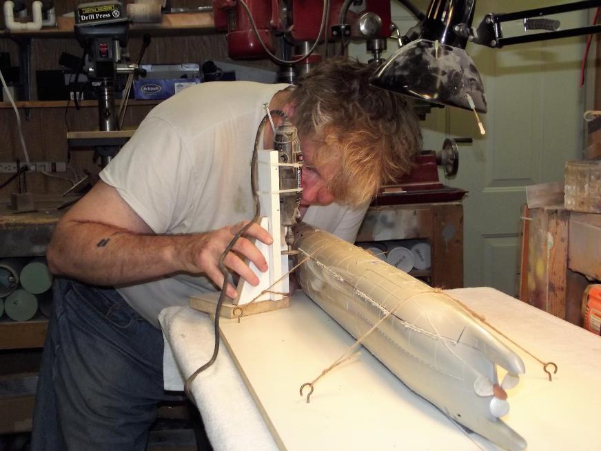

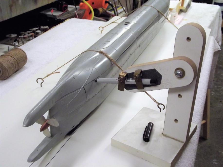

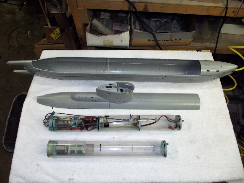

          Excellent. Your credentials are extensive and will serve you well. Send me pictures of the 1/72 Type-7 rudder mechanism -- maybe we can work out the rudder throw problem and get that boat into running shape for you.
          Since I retired from the SD business Bob is working his best to finalize his own version and will only put those up for sale once he's confident he has a reasonably priced, well working product -- as his standard of business demands. I'm sure one of his first SD's will be a two-shaft version sized for that beautiful bigger Type-7 kit.

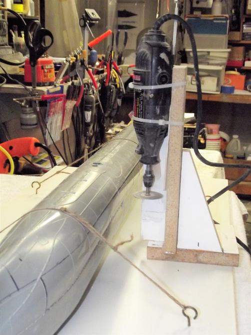

          Here's how you should have cut that break between the Type-23 hull halves:

          But that's water under the bridge -- after clobbering three expensive hull kits you've likely soured on that project. However, that SD will find application in the soon to be released 1/96 STURGEON GRP kit Bob will be selling mid-year. May I recommend that to you?
          You want a running boat by regatta time. Which will it be, sir?

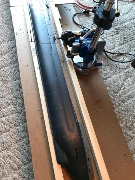

              Actually after my first attempt with the XXIII I built a rig even you'd been proud of. Much bigger installation than yours actually (that was before lumber prices went sky high) and a Dremel tool in a similar installation. Problem was that the hull of the boat is so think, it starts to flex and warp once the Dremel cutter puts pressure on it. Then the cut is no longer a perfect line. My other issue was that the little plastic sticks you made for the fittings kit didn't stick to the boat. I used a gazillion ton of Krazy glue and Epoxy and made them stick somewhat but that was still no clean way to mount the top part. That said your other parts from the fittings kit were excellent, I got the dive planes and the prop to work just fine but could never cleanly close that hull. So yes, that's an abandoned mine at this point.
              So I'm using your Caswell WTC for Ota's 1/12 Seehund. Fingers crossed. I'm in the honeymoon phase of a new sub project. Haven't reached the 7th year itch yet.
              As for your kind offer regarding the 1/72 Type VII. Yes, I'd love to get some input from you for that. My feeling is that its a bit of a lost case at this point. I think I drilled too big of a hole for one of the rudder anchors and that's why it is unstable. And honestly once I get the 1/48 Type VII to run, my interest in the smaller boat will likely be eclipsed. It was my first boat and I learned a ton. I don't even know whether I'd be willing to take it as is to Carmel. People would probably just laugh at me and it.

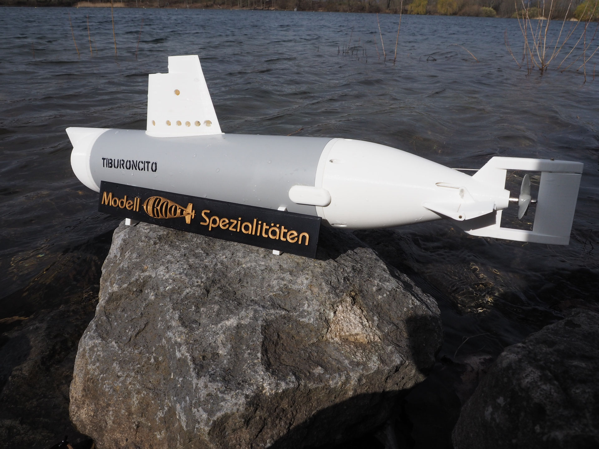

                        Here's another. About 20" long, dynamic diving and inexpensive. Pre printed parts are available if you cannot print your own.
                        https://www.tauchrobotershop.de/bausatz-tiburoncito/
                        There are also several good designs on thingiverse, free of charge, which can be uploaded to a printing bureau if you lack a personal 3d printer. Stick to the smaller models, and the costs can be quite reasonable.

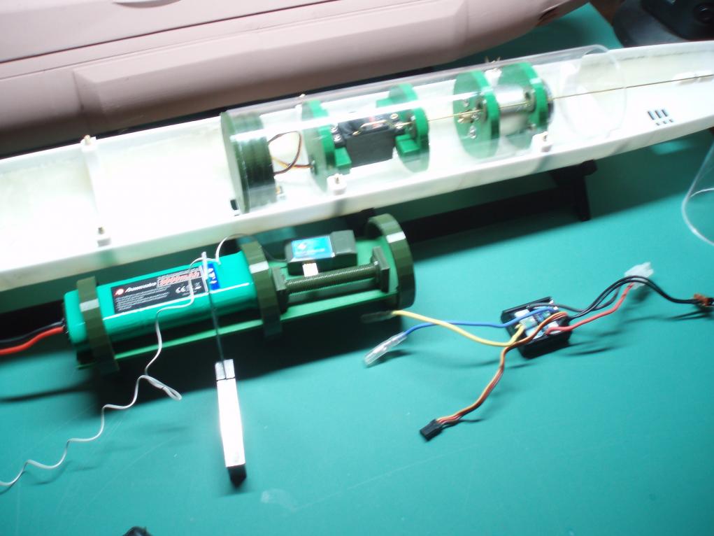

                            tifosi12,
                            I agree with everything Bob states above! I have been in this hobby about 1 1/2 years now! Totally new to it from the start. My passion is 3D printing, and building stuff! I went to Thingiverse, found a submarine called the "Gotland" I built it as just a model, and then I was hooked! Then I researched around and found Bob Martin (Nautilus Drydocks) Started asking questions (by email at first) His advice to me right off the bat, was "Crawl First Then Walk" David M. gave that same advice!
                            I now have 7 Nautilus Drydocks 3D printable subs, 3 in parts stage as I write, and 1 I just started before my Dremel took a dump! At this point in my sub hobby, I have yet to be able to put one sub under the surface! I have scratch built 6 WTC for these boats with just motor, rudder, and dive planes! Surface runners only, with only one that was capable of a dynamic dive!
ID:	149843Click image for larger version
                            Long story short! I have just reached the point where I am starting to understand how an RC Sub works! I spent hours and hours experimenting just to get my boats in the water. Experimenting with the hull preparation, how to build a WTC to house the motor and electronics!
                            tifosi12! Start from scratch, research, learn, experiment, and then build on! You will get it if you WORK at it! As your success's grow, so will you a long with your enthusiasm! Sorry for the rant guys! Just my take on this wonderful hobby we have! Thank you Bob Martin, David M. SUB Ed, just to mention many that have helped me (and are still helping me) along the way!!!!
